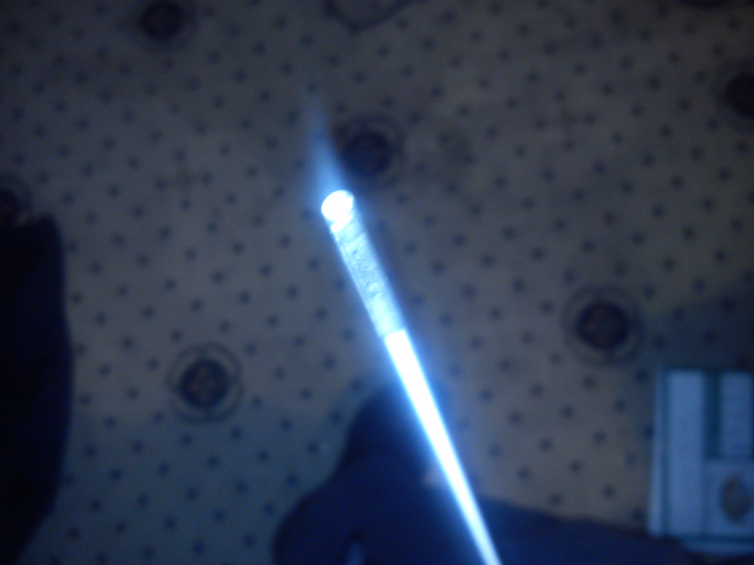

    hi does anyone know a cheap source of tubes, I have a 32 inch LCD here with a few bad, they are EEFL rather than CCFL, the panel is an LG-Philips. cant seem to find anyone who does them so thought i'd try here to see if anyone can help

    can you upload a picture of one with exact measurements of it as i parted out a 32in lg a few weeks ago and have got some tubes still

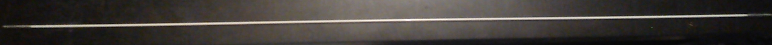

      Thanks for the reply, hope these pictures send I've not done that before, and sorry for the quality I hope it's good enough. Measurements I've taken length end to end is 75cm, diameter of the end cap is about 3mm and tube diameter about 2mm. Panel type is LC320W01 (SL)(A1) and is from a Logik TV (Vestel)
      I damaged the tubes whilst trying to repair the inverter I fitted an incorrect value SM capacitor and caused arcing, the failed tubes now only light on the ends, about 6 have failed.

              clydeuk i take it you are in the uk? regarding postage etc will find the tubes later and measure them the ones i have came out of a lg 32 so you need say 8 if i have got them?

                    looks like i have 8 of these defo 75cm long end cap length just over 3 cm let us know.
