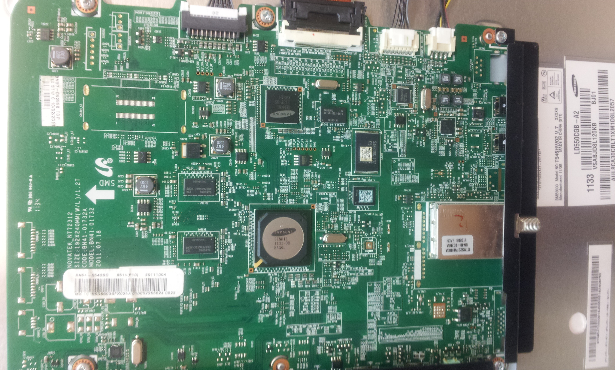

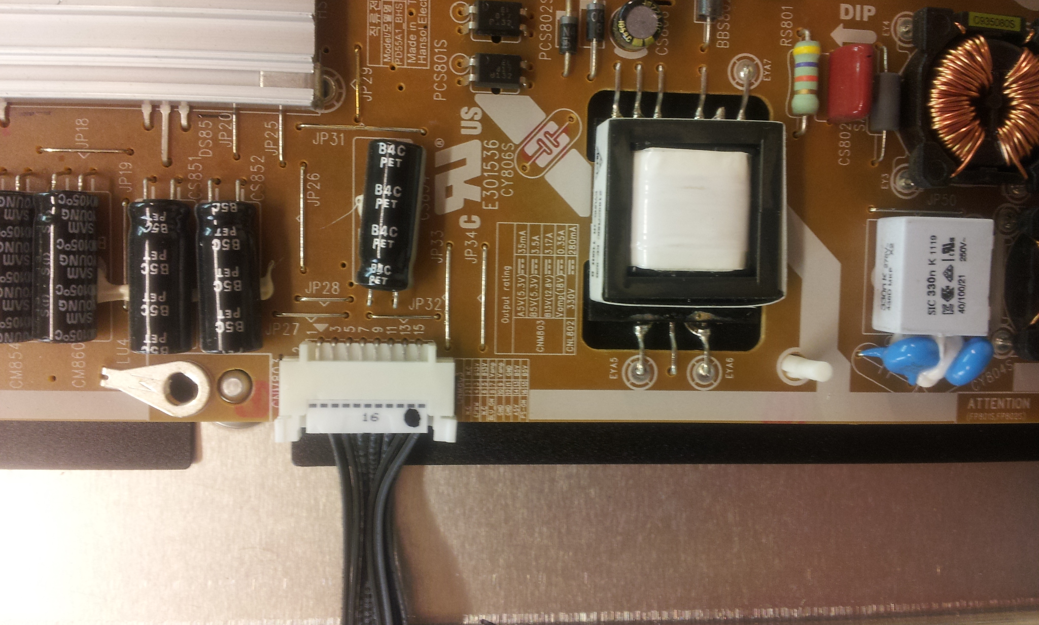

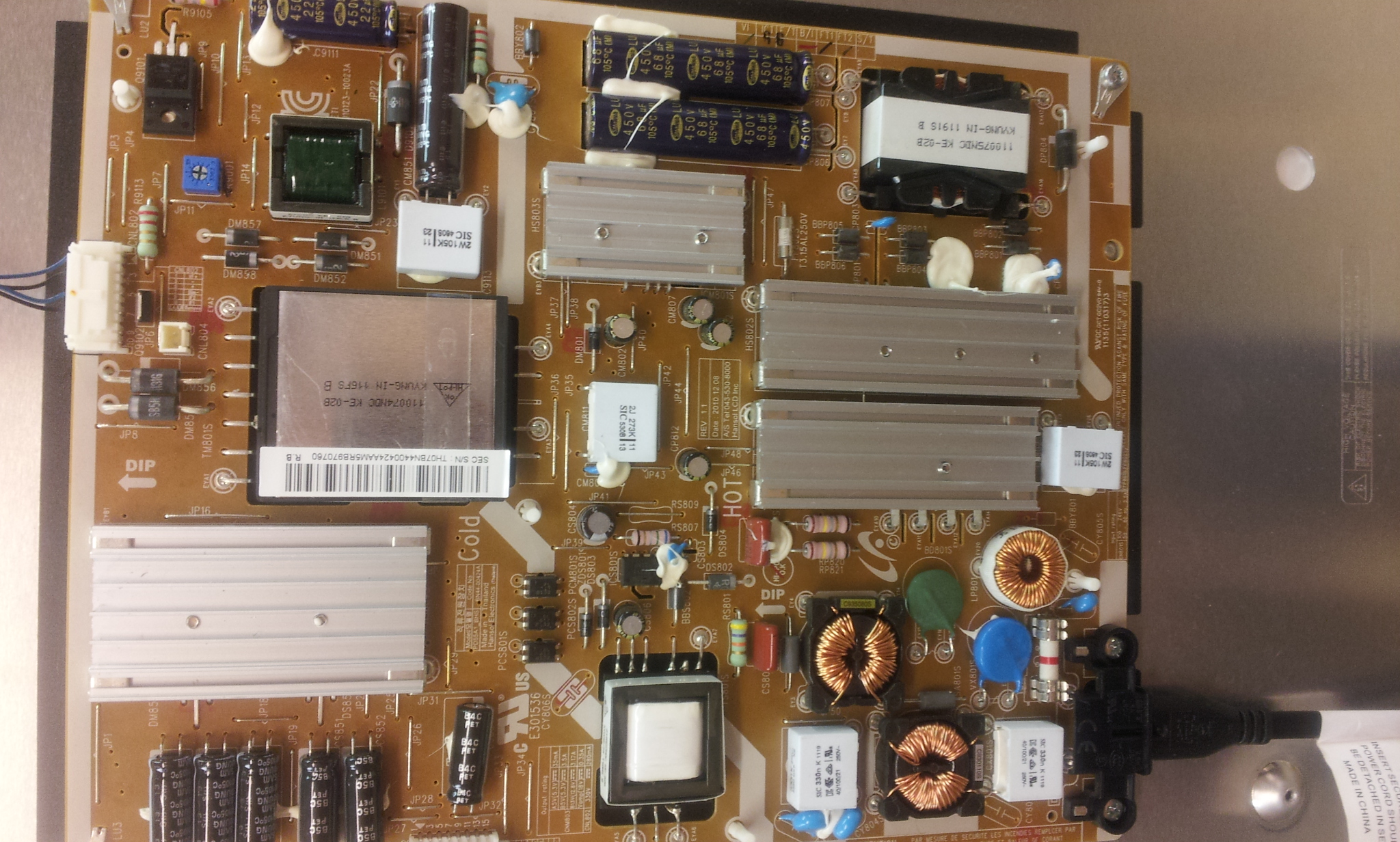

    This is the first really thin TV I have had the pleasure of working on. The Set will not turn on. Power Supply BN44-00424A has an A 5vdc on pin 14 was 5vdc. B 5vdc on pins 13 &15 would cycle on/off continously. If you remove the P.S. CNM803 connector from Main Board (BN94-05429D) the B portion of the 5vdc on pins13&14 cycle even faster.
    I can not find a downloadable Service Schematic
    I bought a New P.S. and it did the exact same thing as the original P.S. so I returned it to Encompass and a 15% restocking fee. Bummer. No one has a used board. Set has 3.3vdc on several pins that feeds the remote. There are no buttons on TV. Everything is done through the remote. Only thing I can figure it is the Main Board BN94-05429D.
    I tried jumping the A 5vdc to the P.S.-On on the P.S. and the B 5vdc still cycled on/off. Any Ideas? Suggestions? Schematics?

                Re: Samsung UN55D6003SFXZA
                The main board was likely the victim.

                  Lights should light if main disconnected from SMPS. If not, bad power board. I did it backwards and removed screen and tested all LED's good then replaced power. ooooof. lesson learned. Examined board from bottom ICM801s exploded.

                          Just force on the power supply and see if all voltage rails come alive. So what should you have done first place before ordering a new PSU is to check the 5V STBY voltage. If it is there and you can't turn on the TV, check the PSon pin. If there is nothing on that PSon pin while trying to turn on the TV, your main board is bad.
