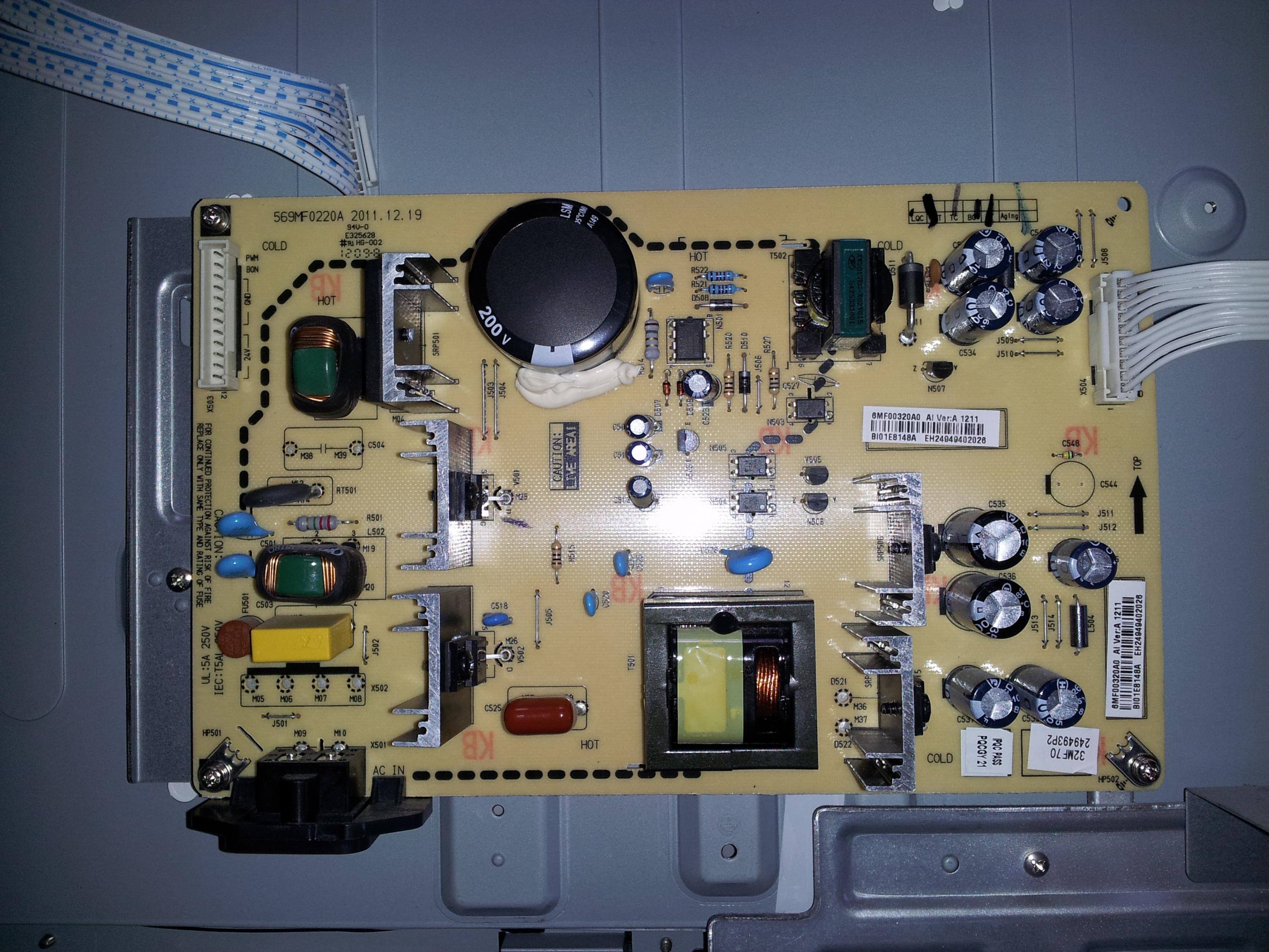

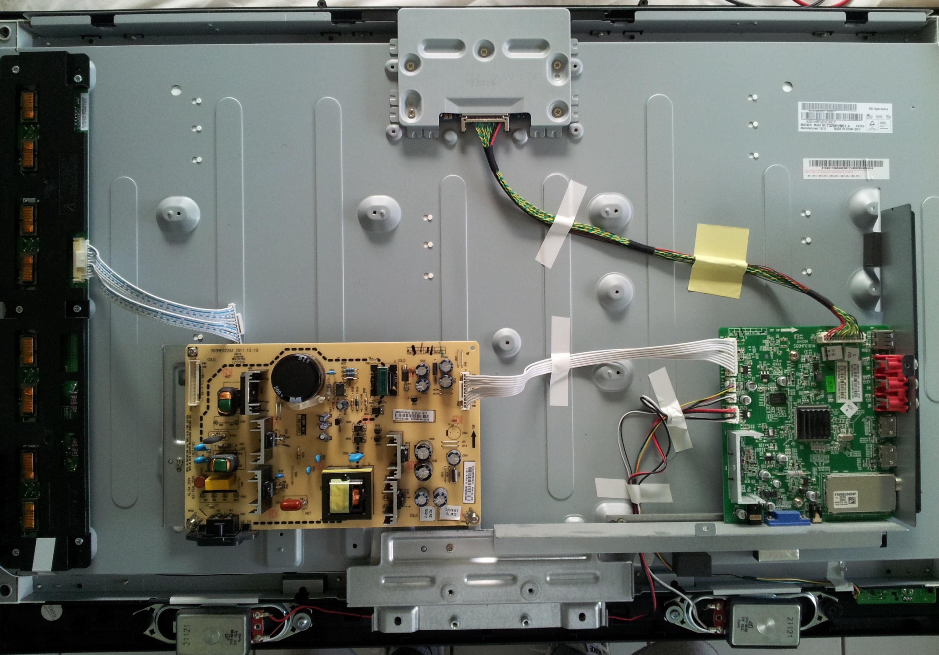

    Hello

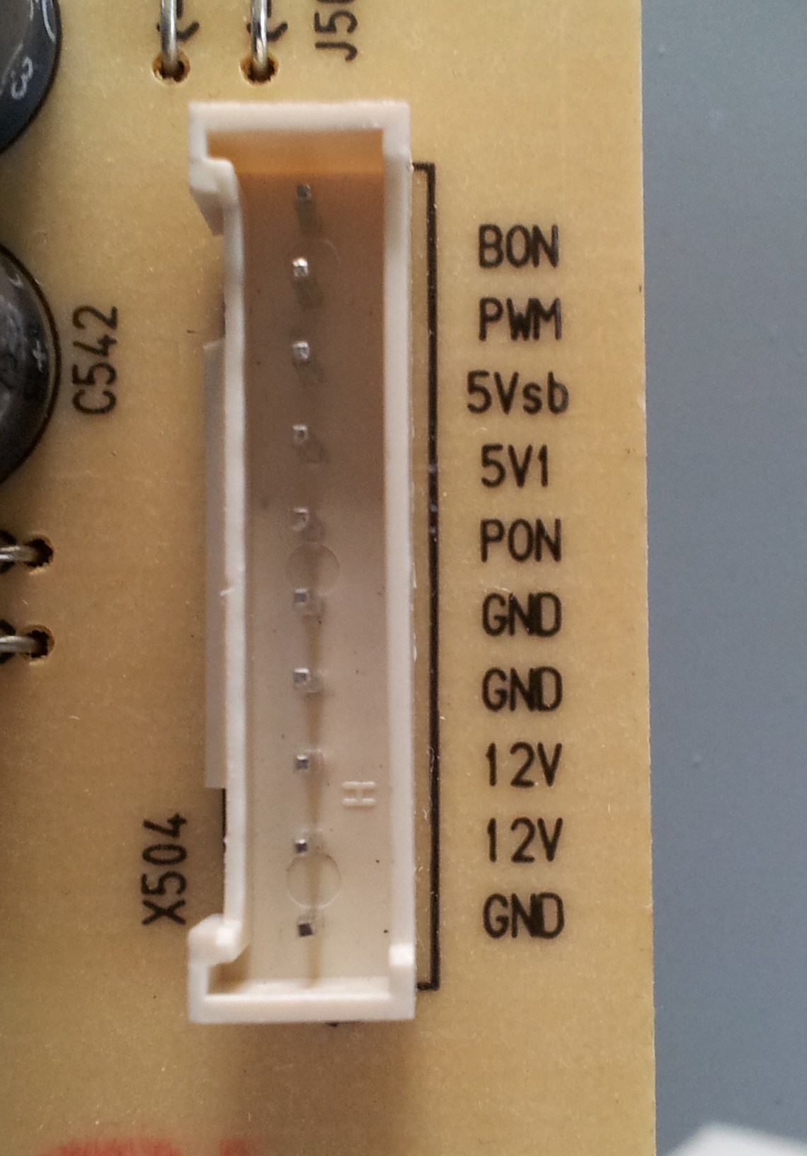

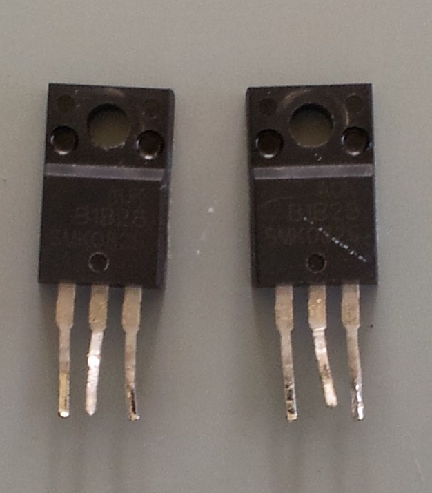

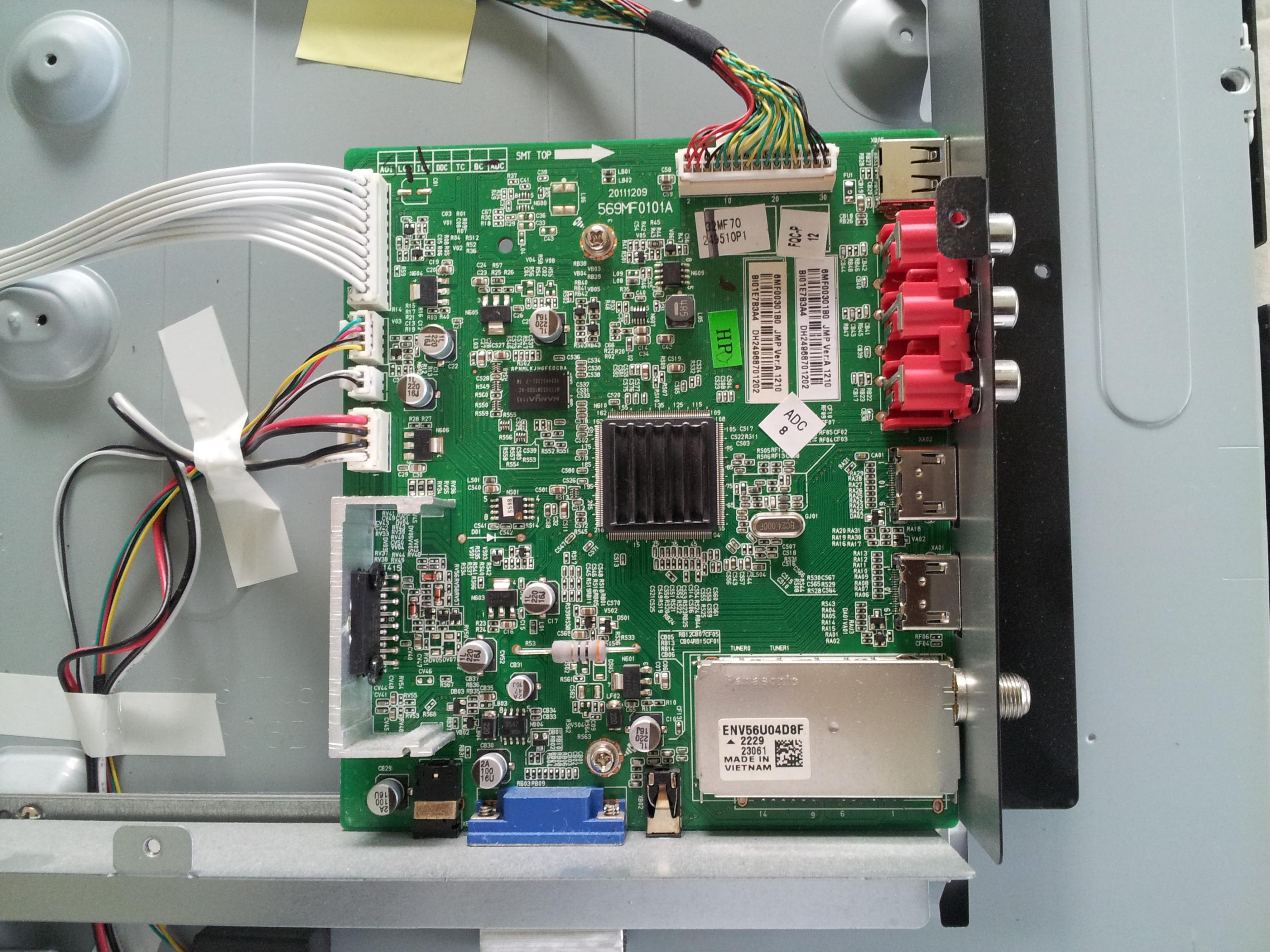

    I check the Power supply found two short MOSFET SMK0825 Replace them with FQPF9N25CYDTU I getting my 5Volts on pin 5Vsb and pin 5V1 reading 2.7volts. How can i startup the Power supply without the Main board because when i connect the main board standby voltage fluctuate between 1 - 2volt. No standby light.
    Please Help

    To test without main board you can run a 100 to 470 ohm resistor between PON and 5VSB.

      Re: Insignia NS-32L240A13 NO POWER
      Did that same results like when i connect the main board stand by voltage drops. What can be stoping the PS from turning on
        Any info diagram or schematic drawing for this Power supply 6MF00320A0
