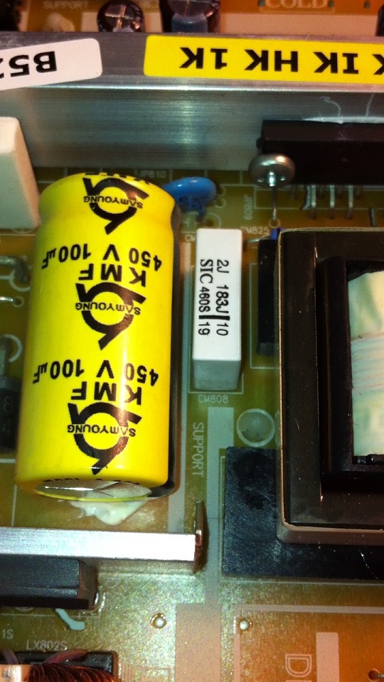

                  But I'm not able to find cap CM808 !!! do you have an idea where is it ?
                    Re: Problem with Samsung LN32C450E1D

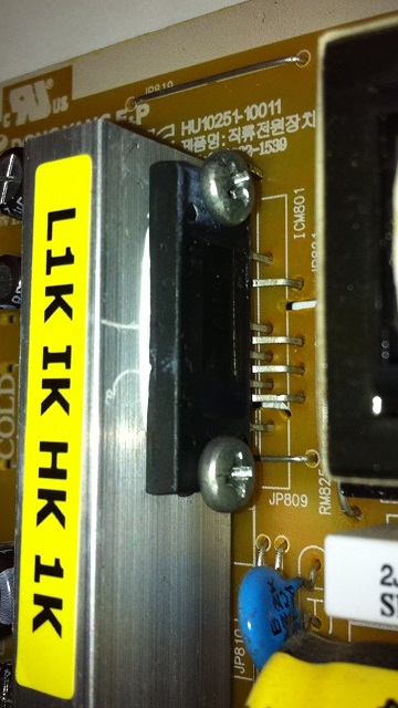

                    CM808 is the 630V, 18nF capacitor near transformer, it is not normal electrolytic can cap.

                      I found that capacitor, white one, under board I can read CM808. Well, seems to be ok, but I've nothing to measure a capacity.
                      which kind of measure must I do ?
                        If you don't have a meter to test it, the best thing you can do is just replace it.

                                Ok, thanks for your help. I've 3.80 rather 13V and 7.72 rather 24V...So I think your right about CM808 and ICM801. For main cap, Ive 390Vdc.

                                  It can be just that cap, 0.018uF 630V. Do you have any repair shop close by that more likely to have cap meter to check its capacitance?
