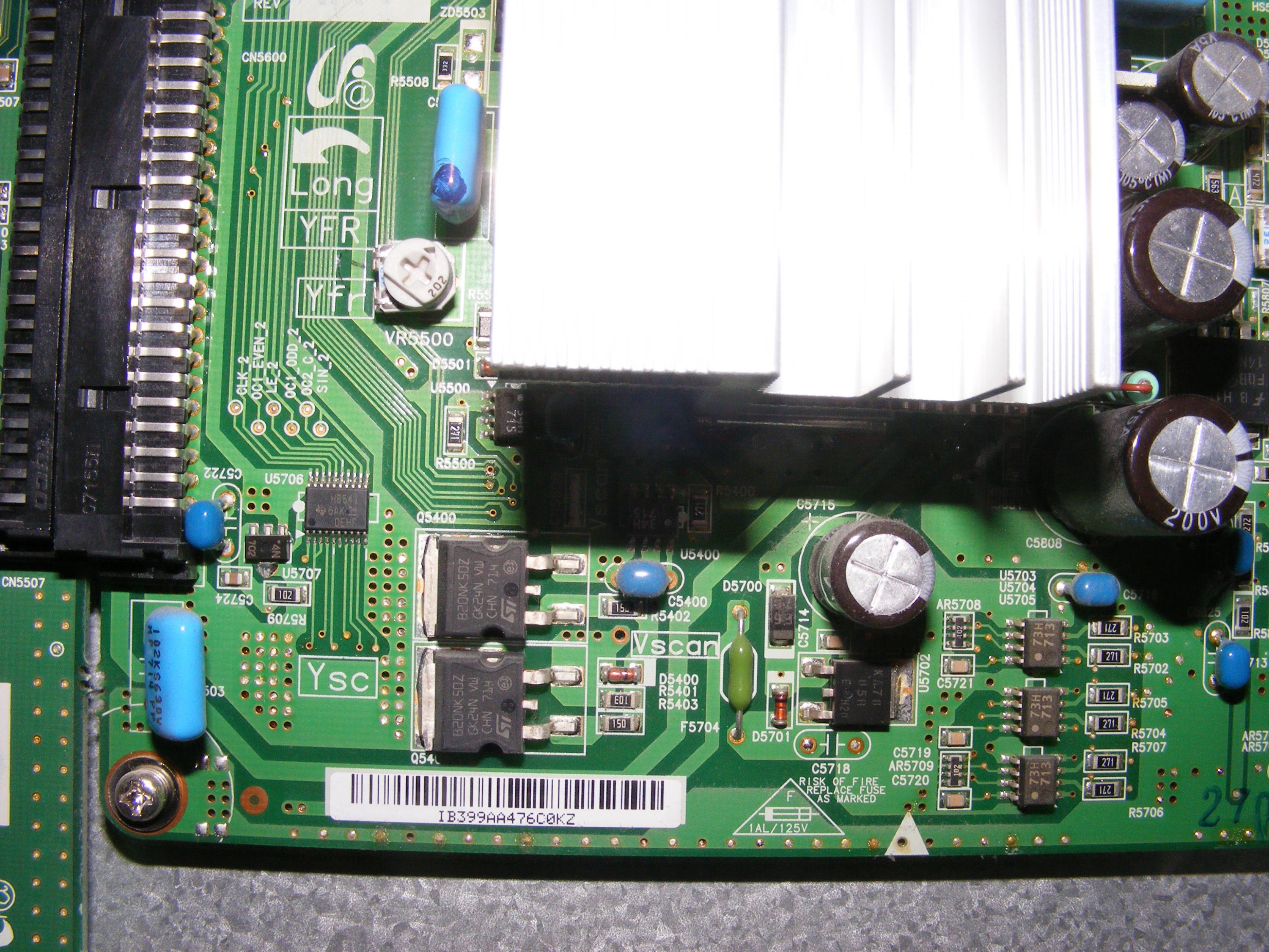

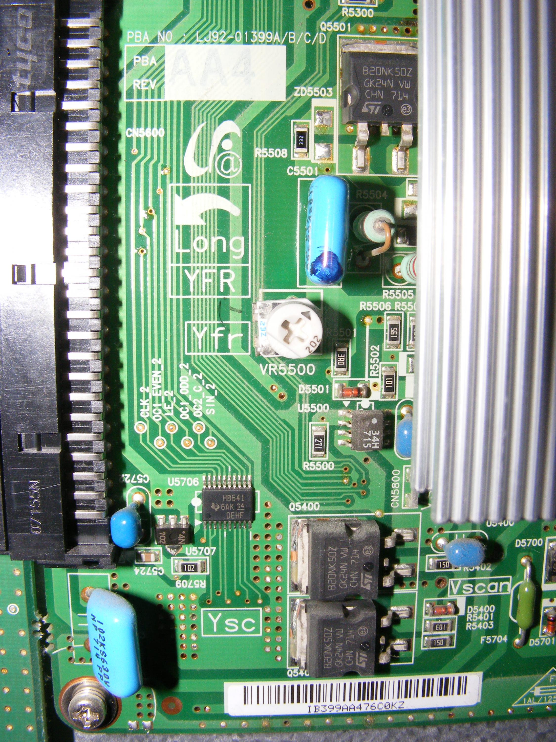

    Re: Philips 50PFP5532D - X-main issue??
    Can you post a clear shot of your Y-main, including around the Yfr (or Vfr, or Y-FR) adjustment point?
    • tn245
      • Oct 2013
      • 530
      Here you go..

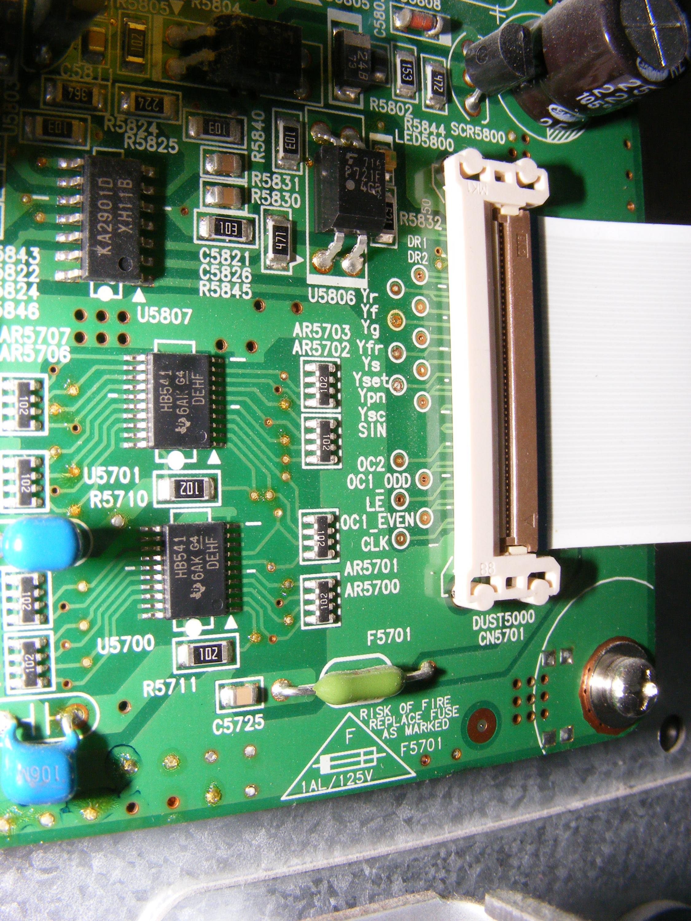

          I'm not seeing obvious points for Vset, where did you test it before? (Yset at 0.1V?)
          • tn245
            • Oct 2013
            • 530
            Here, over on the right by the connector to the control board.
              That's the enable signal (pulses on and off, very high, difficult to measure with meter), unfortunately not the Vset voltage. Did you try before to adjust the Y-RR and Y-FR controls to see if they have much effect on the picture?
              • tn245
                • Oct 2013
                • 530
                I don't have a Yrr control. I have Yfr, Vscan and Yset controls. Yfr and Vscan do affect the picture and I can reduce the sparklies, but there is still a lot of distortion in the picture - especially pixels either not filling in or not going out when they should. Yset does nothing at all.

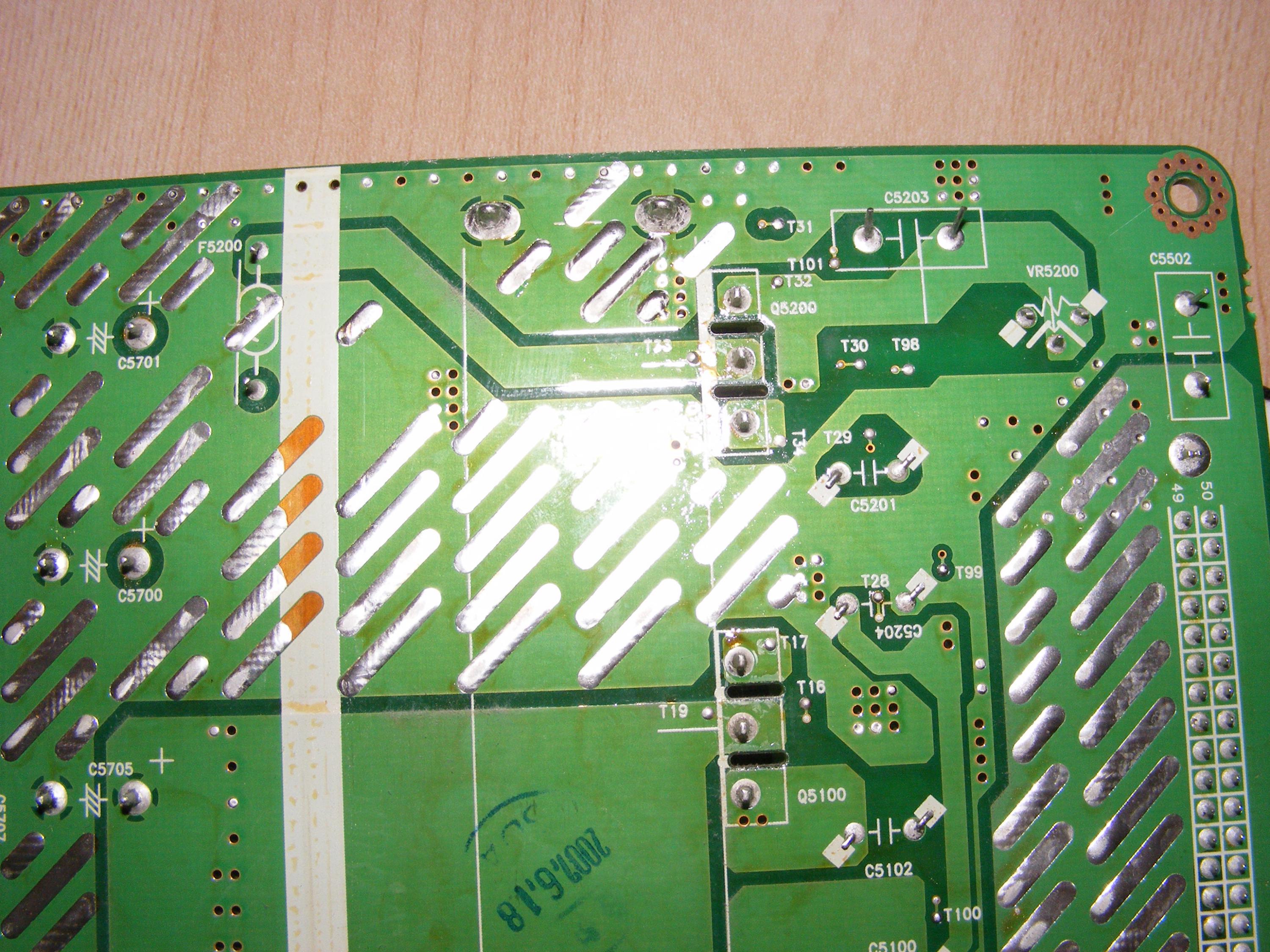

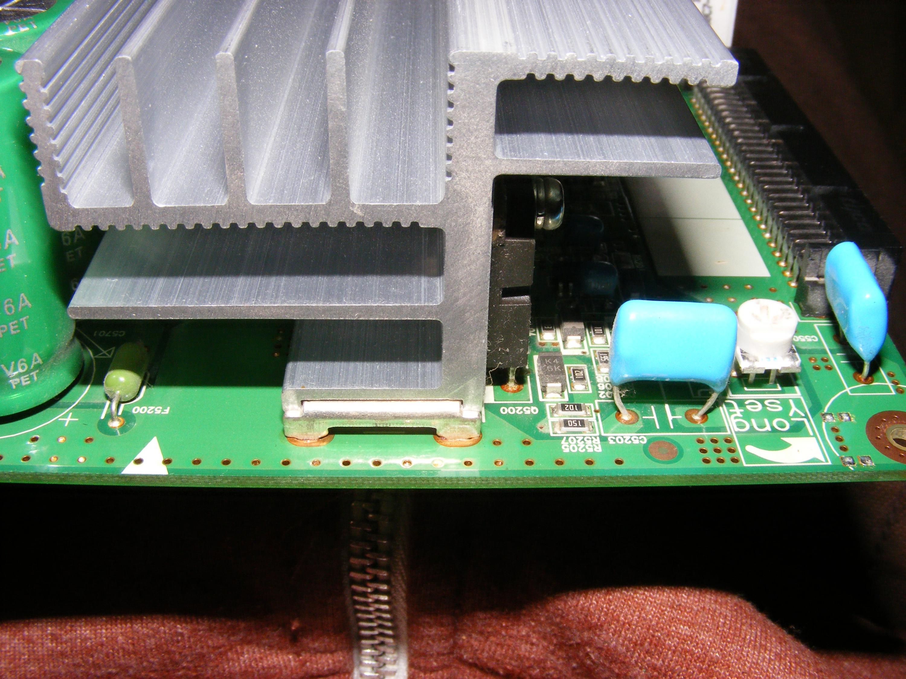

                    Thanks for the suggestion. I've taken out the Y-main. Haven't found any shorted FETs (tested in-circuit) but the fuse F5200 you can see in the attached is o/c. So something must be wrong up here.
                          The mosfet seems ok. No shorts and switching on fine. The only odd behaviour is it switches off very quickly even if gate is not discharged. But I compared it with another k2837 from another part of the board and same behaviour. I can't find any other shorted components in that part of the board.
                          Would I be crazy to try just replacing the blown fuse? Do these fuses ever just go for no reason like smd ones sometimes do?
                            #33
                            Fuses can sometimes blow without cause, but it's rare on a sustain board like this. You have little to lose from trying, though.

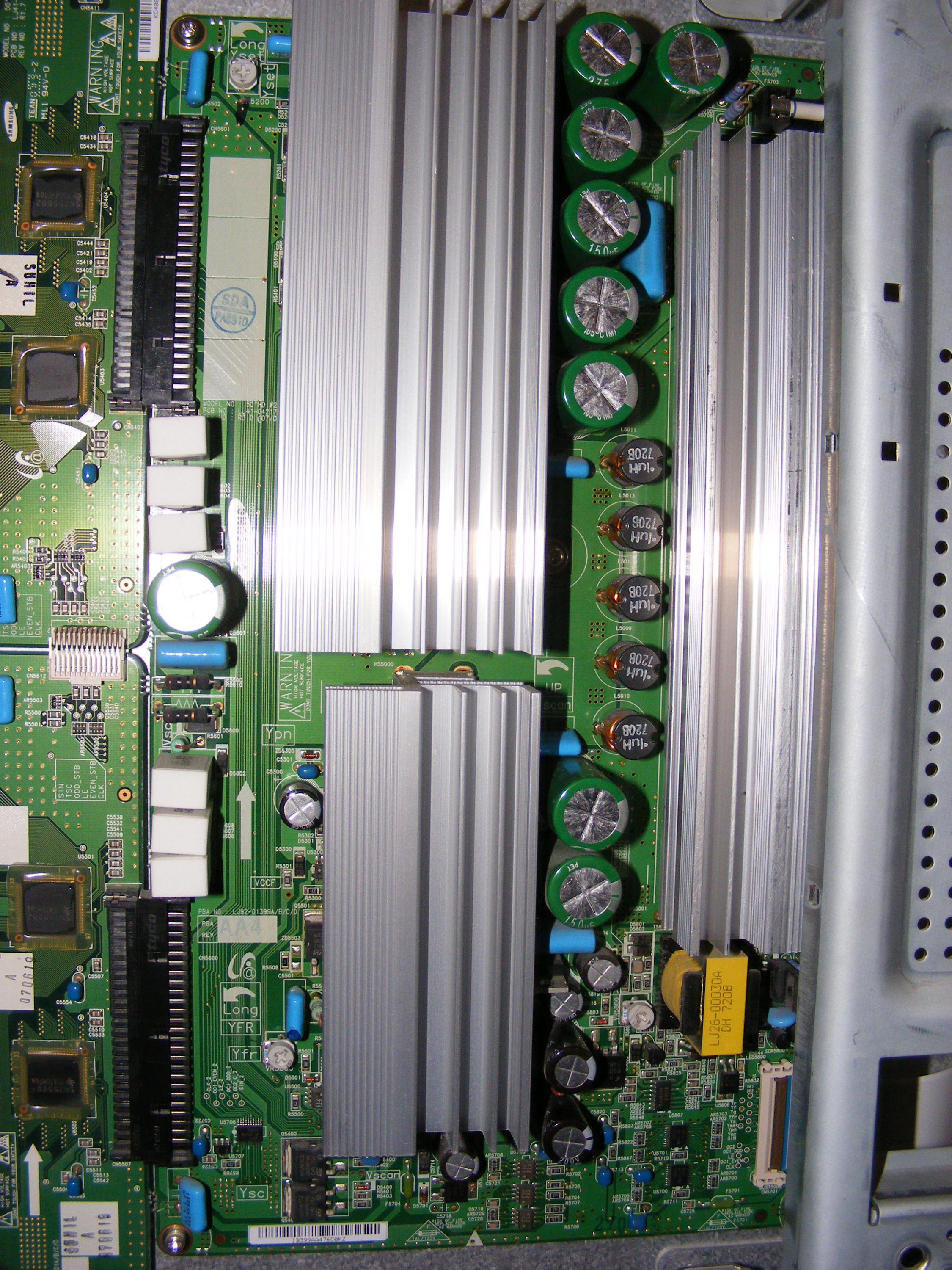

                                      #38
                                      Well, sadly I'm back to this TV with more questions.
                                      I've just finished putting heatsinks on the buffers. Also replaced the fuseholder with the proper littelfuse. However, when I put it all back together and power on I now suddenly get nothing. The same fuse is blowing, but rather than the messed up image I had before I've got a black screen. There's also a strange noise coming from the y-main - halfway between a buzz and a crackle, not loud.
                                      Tested voltages again. Va and Vs are ok. Ve at first goes to the proper 94V, but then within seconds of turning on jumps to 137V. It does this with y-main disconnected and not. Vscan also starts off at the proper high negative but then quickly drops.
                                      What have I done??
                                        #39
                                        Is it possible your heatsinks on your buffers are shorting something out?
                                        • tn245
                                          • Oct 2013
                                          • 530
                                          #40
                                          It's possible. I will investigate. Is that normal for Ve to go that high with y-main disconnected?
