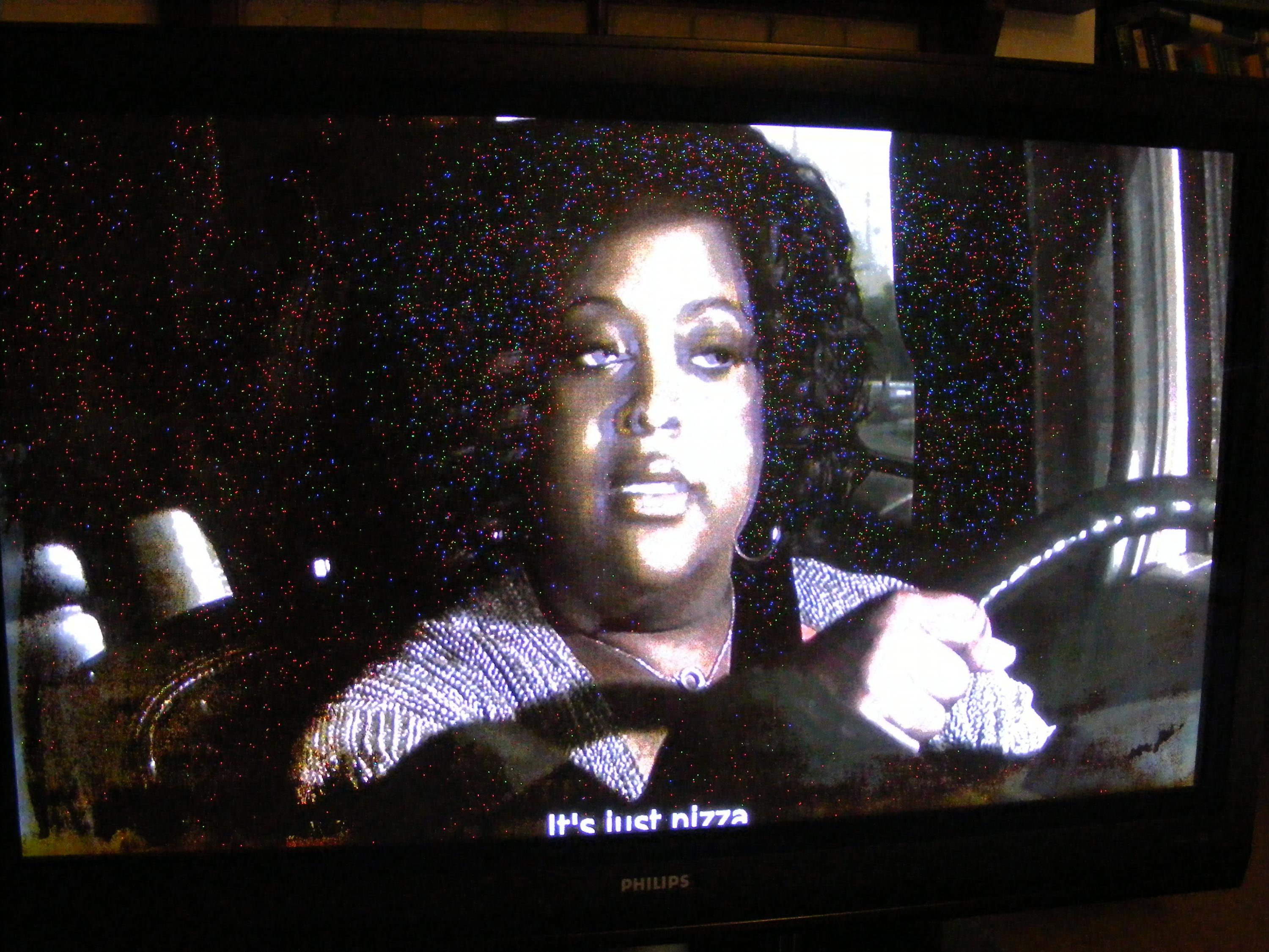

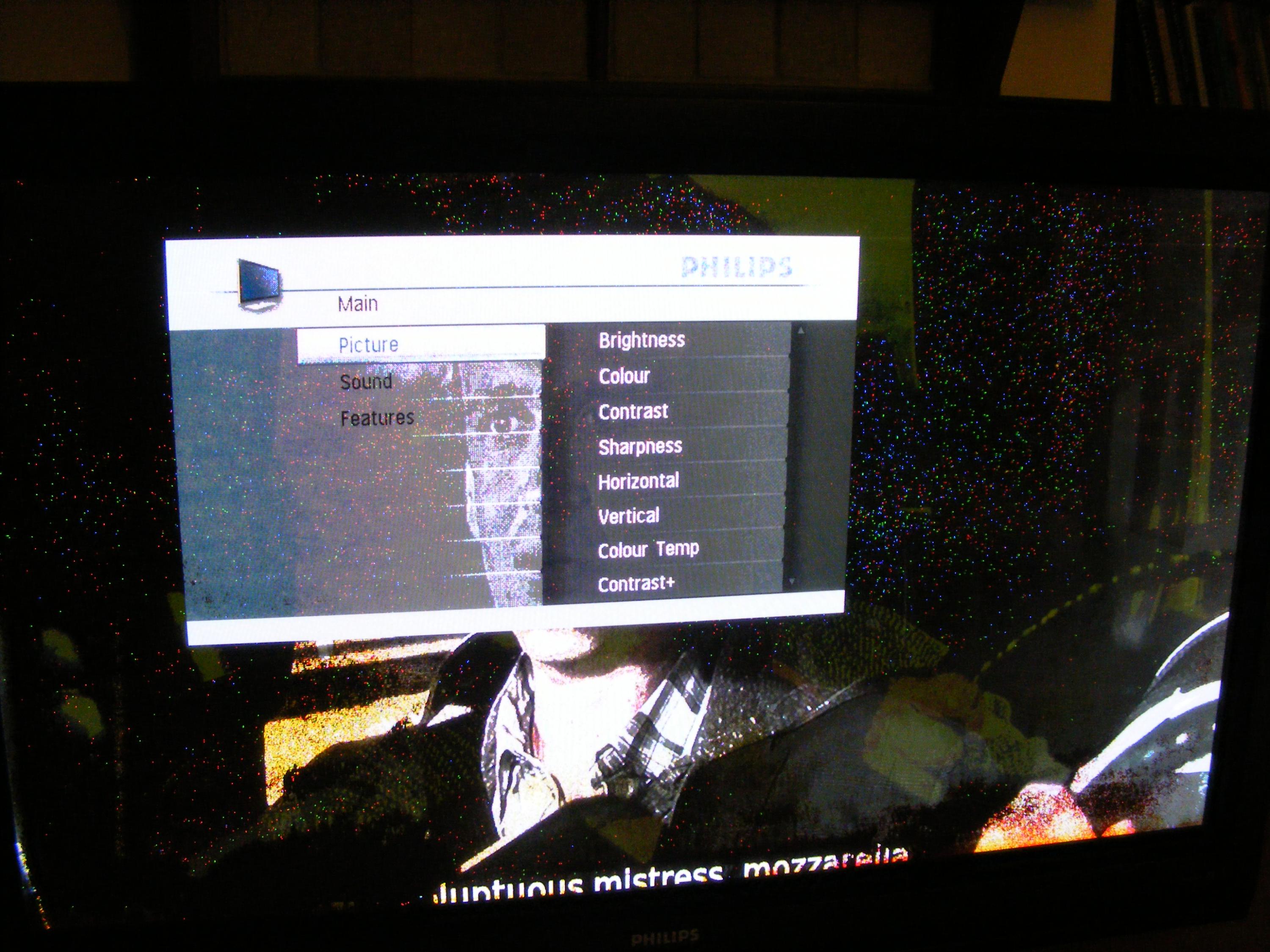

    Hi
    I'm working on a Philips 50PFP5532D with picture problems (see attached photos). Dim, washed out picture, lots of snow, some pixels slow to update and some image retention. From my reading of this forum I thought bad X-main. This uses mostly Samsung boards.
    Ordered and fitted a 'tested' replacement X-main and the problem remains exactly the same.
    All voltages are spot on. There's an LED on the control board flashing steadily (LED2002) - not sure if that means something.
    What do we reckon? Is the replacement X-main also faulty or maybe control board? How can I test?
    Thanks again!
    X-main: LJ41-04216A
    Control board: LJ41-04220a
    Re: Philips 50PFP5532D - X-main issue??
    I would say Y-main more than anything. Did problem get slowly worse or just suddenly happen?
