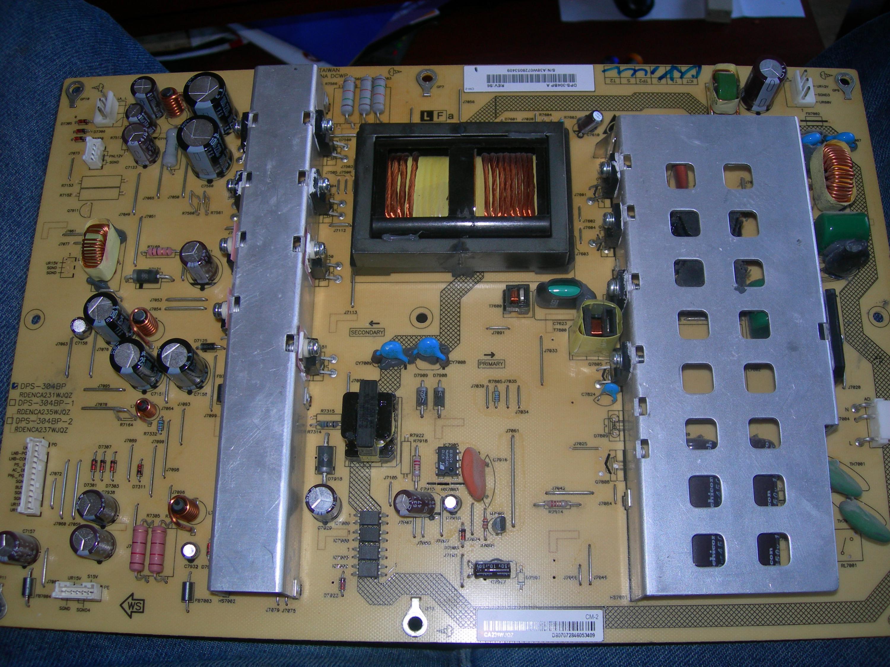

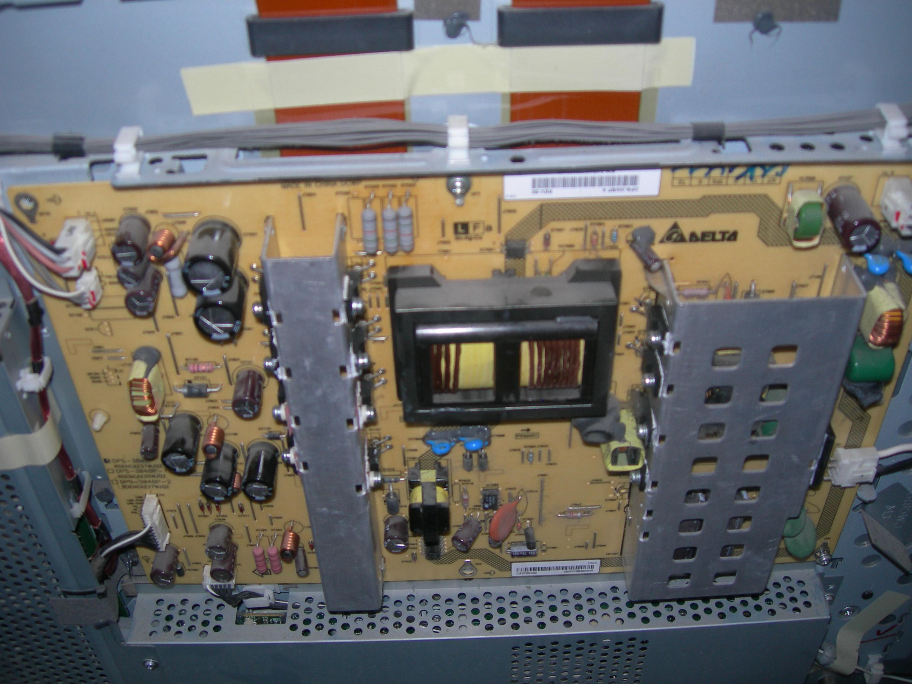

    Bingo. Tapped heatsink on power board (with screwdriver) and it shut off. Wait for it to come back, tapped it again, went off again. Found multiple cold joints. This looks like it might be an easy fix .

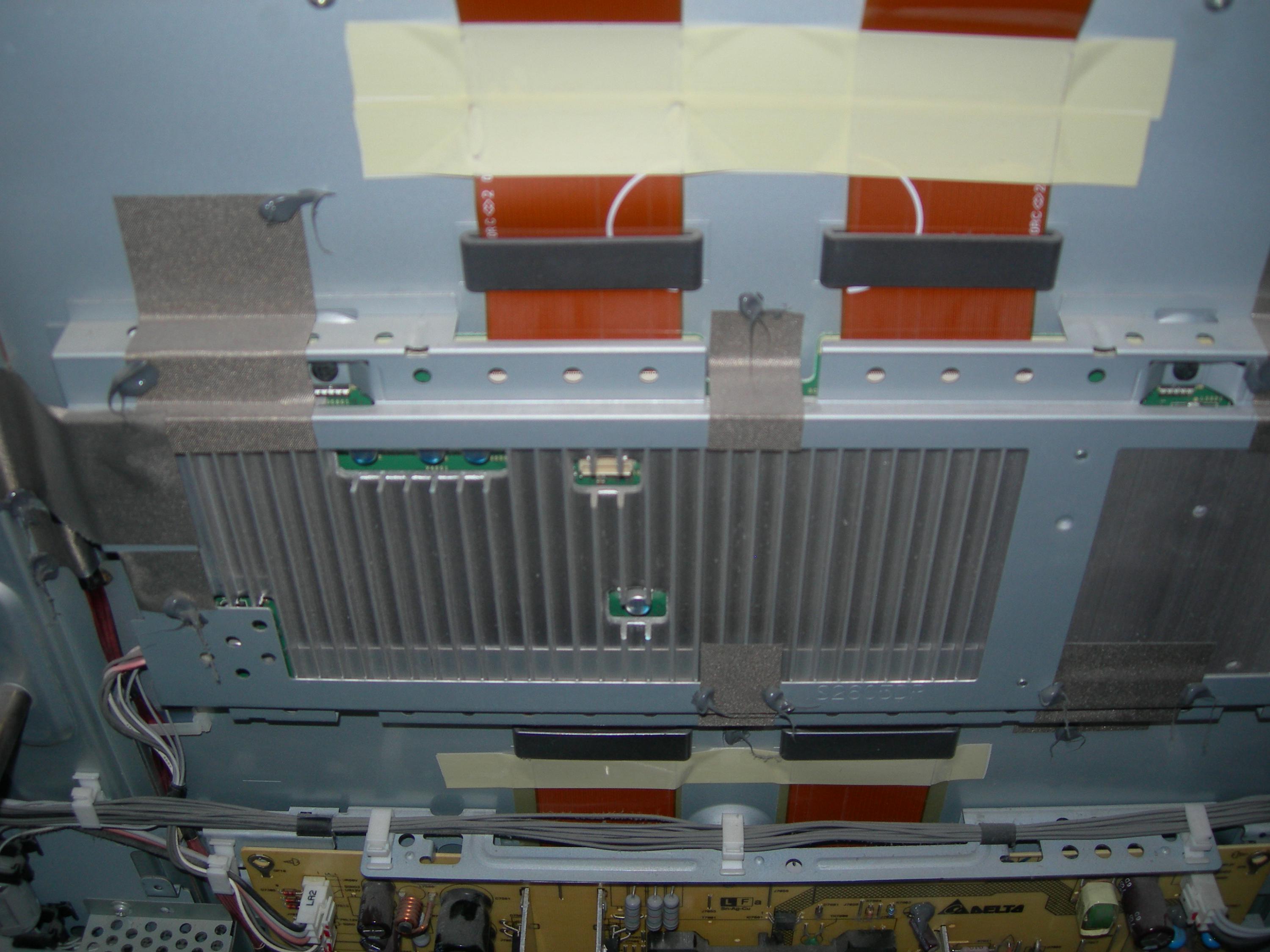

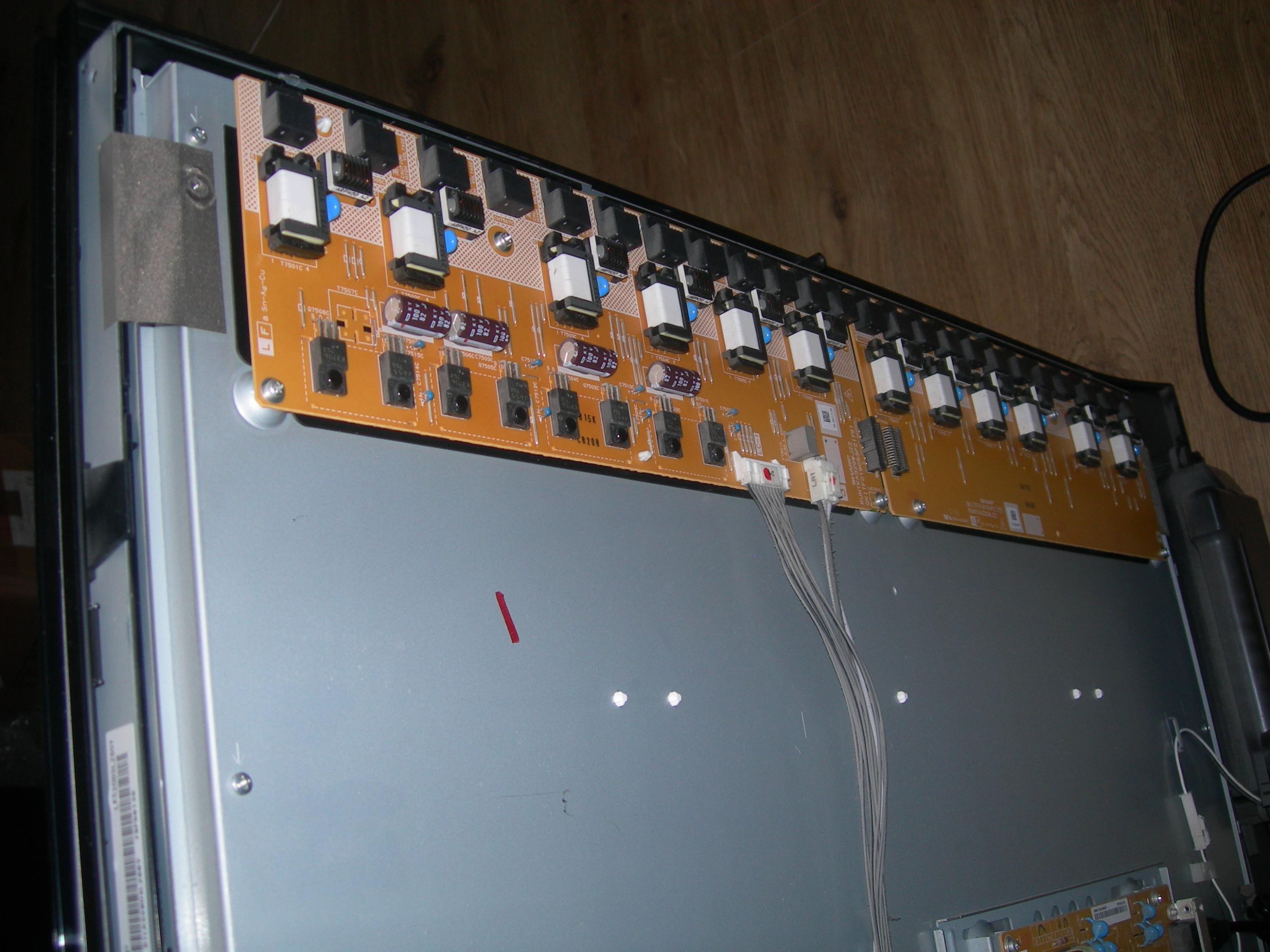

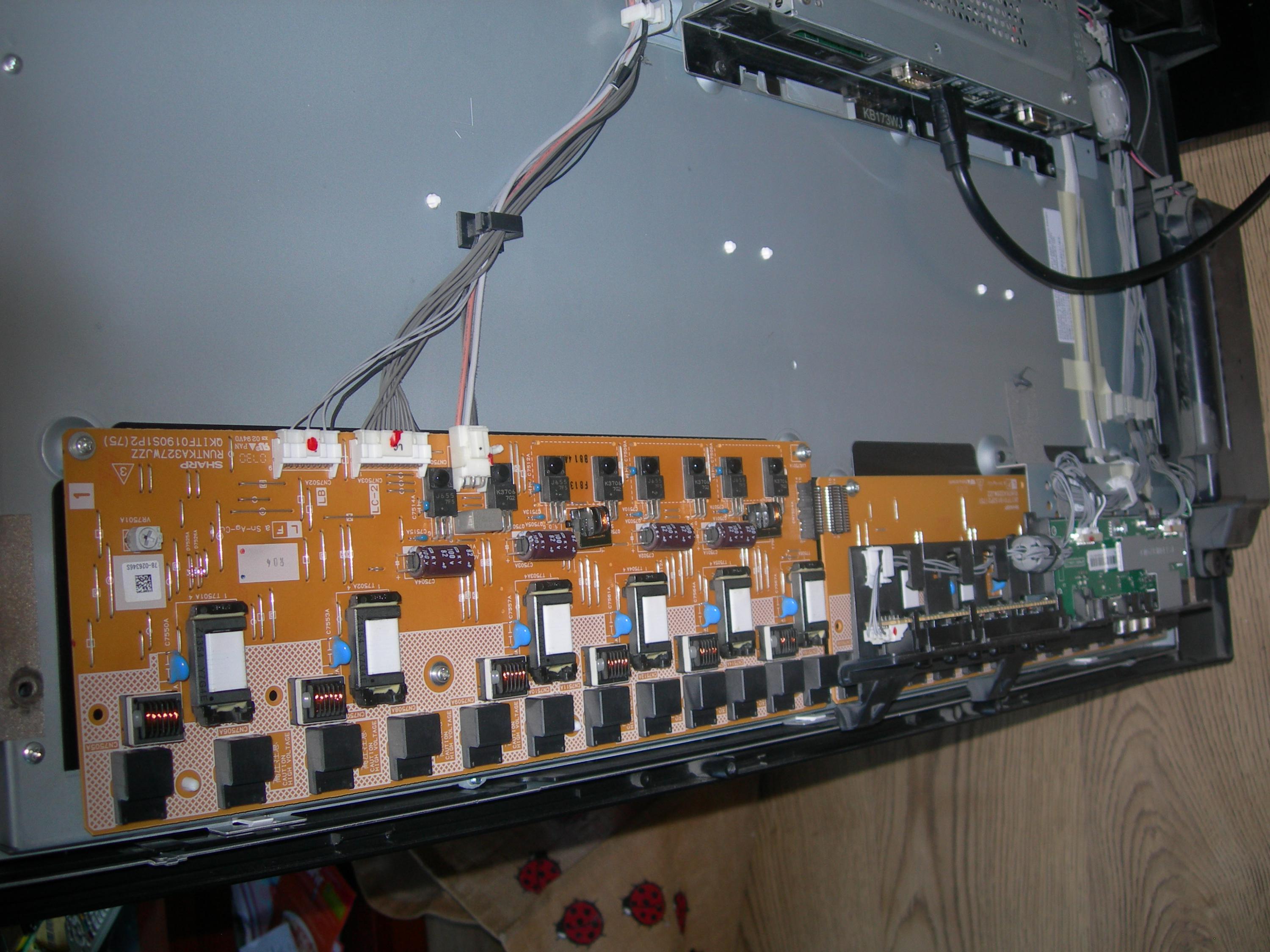

      As promised pictures.
      This is by far the largest LCD, in fact largest TV I have ever worked on. Previous LCD record was 42" and plasma at 46"... I need to get even more bigger ones!
      The solder joint fix appears to have held. I have to test this TV some more, but it looks like it is fixed.

            The fault with this set was with the only part not made by Sharp the power supply by DELTA (though they are still a very good manufacturer in my opinion.)
