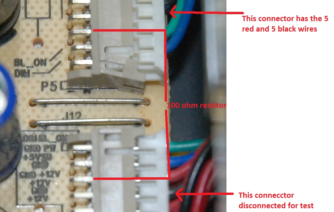

                    Re: RCA L42FHD37YX8 Will not power on
                    No blue LED is expected. Can you take a photo of what you did so I can make sure it is correct?
                    • Snype32
                      • Jun 2011
                      • 76
                      #30
                      here you go
                        #31
                        Sorry, a misunderstanding: the jumper should be on the same connector only. You can stick the resistor leads in the holes of the exposed connector (disconnected from the main board end.)

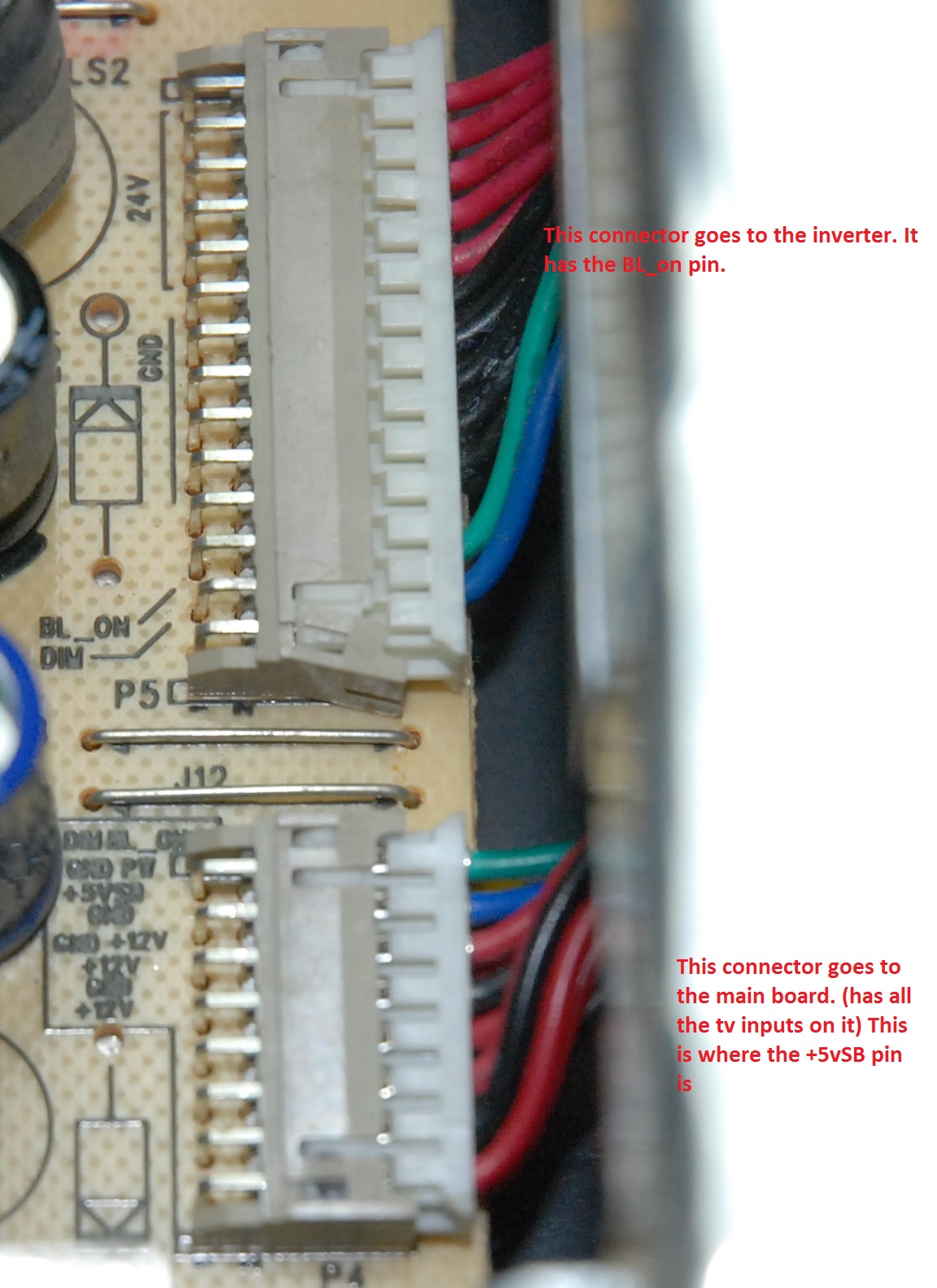

                          I still seem to be having some confusion... I attached a pic... the connector that has bl_on is different from the one that has the 5v. What am I missing?
                          Thanks!
                            #33
                            Huh, that's weird. The BL ON and DIM pins should feed through straight to the inverter connector. Can you use the continuity mode on your meter to tell which connects to where?
                              BL_ON and DIM go to the inverter. It also kinda looks like there is a BL_on in the cable going to the main board as well. the connector has two rows of pins, one above the other and the label says dim bl_on so I am wondering if dim is the top one and bl_on is the bottom. Tried the tests and still nothing.
                                #35
                                Oh I was getting confused by how there are like 12 labels and only 8 pins. That explains a lot! In cases like that, it's a matter of placing a piece of wire in the appropriate hole to get a good probing position or place for the resistor.
                                      So I found out that depending where I put the resistor, I can get 5v on either dim or BL_ON on the cable going to the inverter. However I no longer have the 24v on the 5 reds so there must be something else that turns that on. There was a pin labeled pw...would it need the 5 volts as well? Thanks for your patience in this.
                                        #39
                                        Yes, it would be PW likely, which gives you 12V and 24V, then BL ON which turns on the inverter. DIM controls brightness, can be left alone for now.
