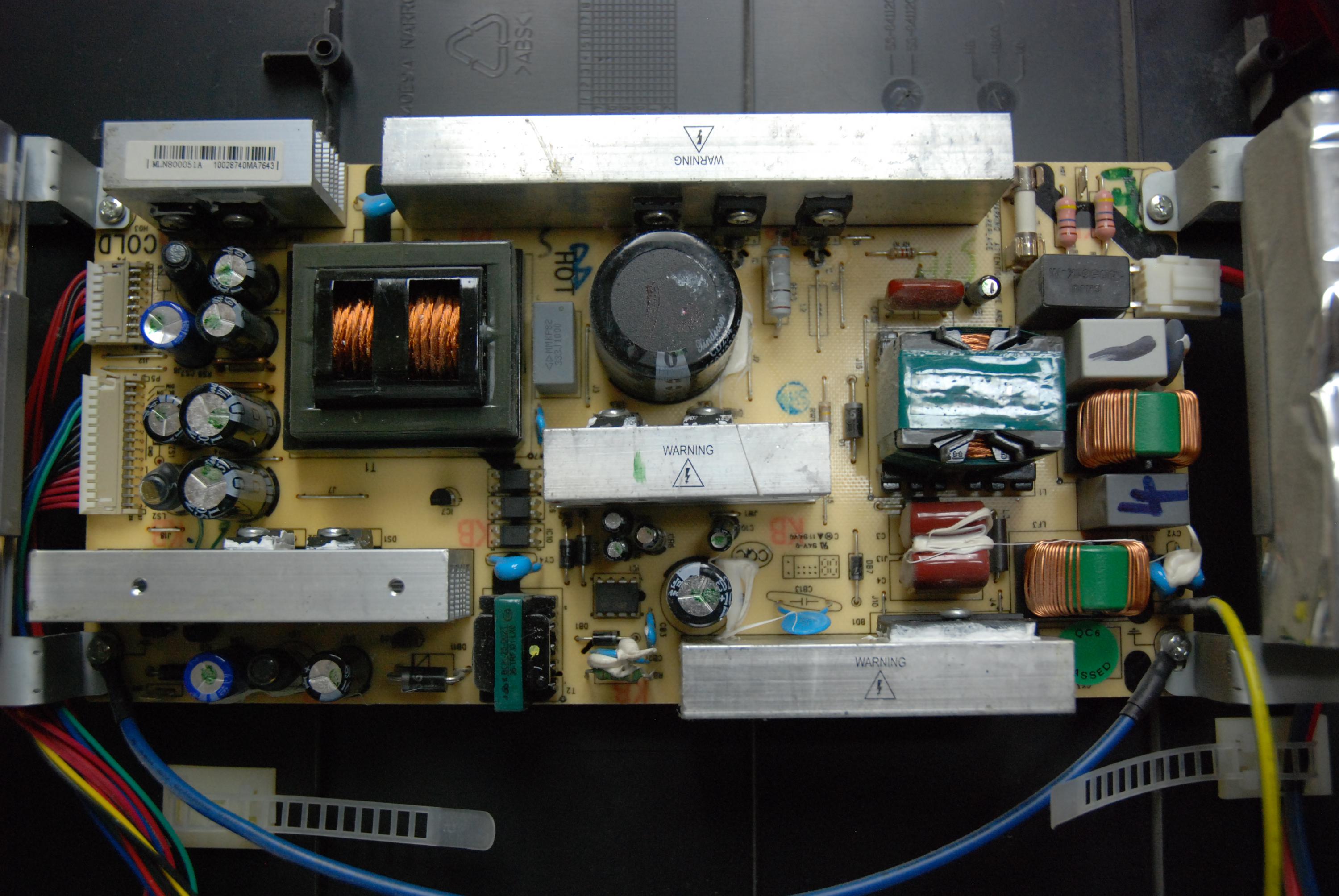

    I just found a RCA L42FHD37YX8 at our local dump. When it is plugged in, A blue LED comes on. Nothing happens when the power button is pressed. I opened up the back and looked at the power supply... All caps look good. Is there anything I can test for? Thanks!

    Can you get any pictures of the boards in the set?

      Sure...here you go. Thanks for the quick reply. These are the two main boards. To get pics of the inverter would require some more serious surgery. I did notice one cap has what looks like a bit of a dent...but I kinda doubt it's the cause of the problem.

        Re: RCA L42FHD37YX8 Will not power on
        So, I see some pin markings on the connectors going to the main board, can you list them?
            OK, check the voltage on the +5VSB.
            To do this: multimeter on DC volts scale (20V if manually ranging), black probe on metal chassis (e.g. back of LCD panel module, wall mount...), red probe pressed into pin in question.
            What do you read? Should be around 4.75V to 5.25V.

              Looks like I'm getting 0.
                      Ah sorry...just double checked...I was on the wrong pin... now getting 4.95 or so. Sorry for the confusion.
                        OK, next, check the PS_ON line both before pressing the power button and after. Check it also upon immediately inserting power cord.
                                What do you get on the +12V and +24V?
                                  I get 12v and 24v. There are no extra boards between the AC source and the main board.
                                    It looks like this might be an "always on" type power supply.
                                    What do you see on the DIM and BL_ON pins, which is the one with only +24V x 5 and GND x 5 on it?
                                    If the BL_ON is varying, the main board is stuck in a boot loop = replace main board (unless easy-to-find fix found.)
                                    But if it is steady, then it can only be an inverter fault, which seems more likely.
                                      I get 0 on those pins.
                                        Even while the backlight is flickering?
