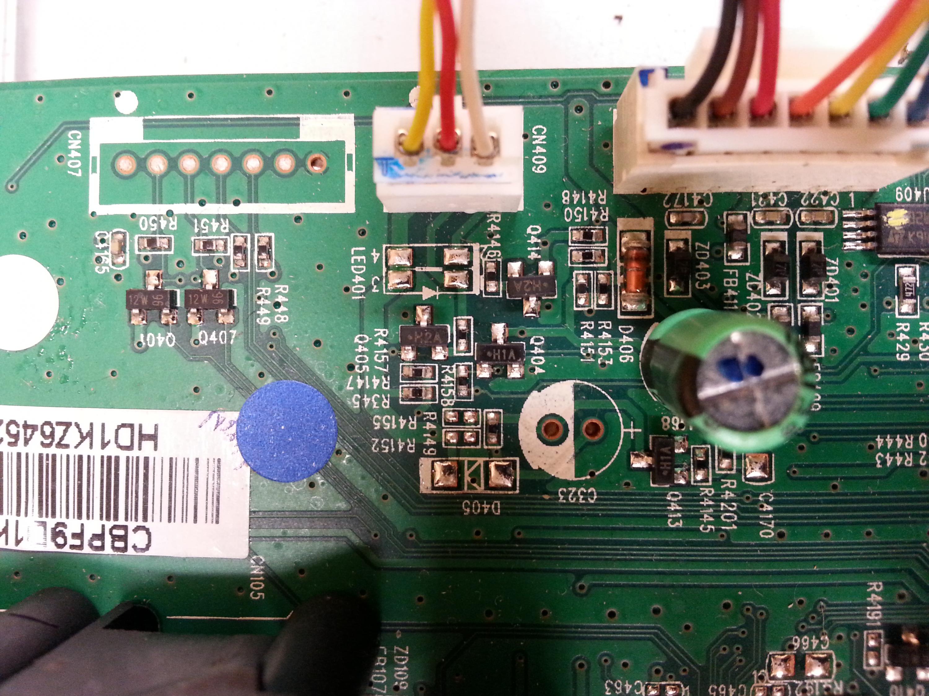

        I'll see if I can post some pics of the transistors I'm trying to check. They're surface mount, and teeny (for me, anyway). Not sure how they'll come out from my phone. I'm off in two hours, so it may have to wait until then.

          I guess, before diving too far into this, I should ask if you think it's even possible for me to test and/or replace the smaller components on this board. The specific ones in question are Q404, Q405, Q414, Q413, R4145, R4158, etc. I'm willing to try it, as the TV was free... But if it's going to be an exercise in futility, I may look for a replacement board if I can find one.

            The only markings I see on those specific transistors are H1A and H2A.

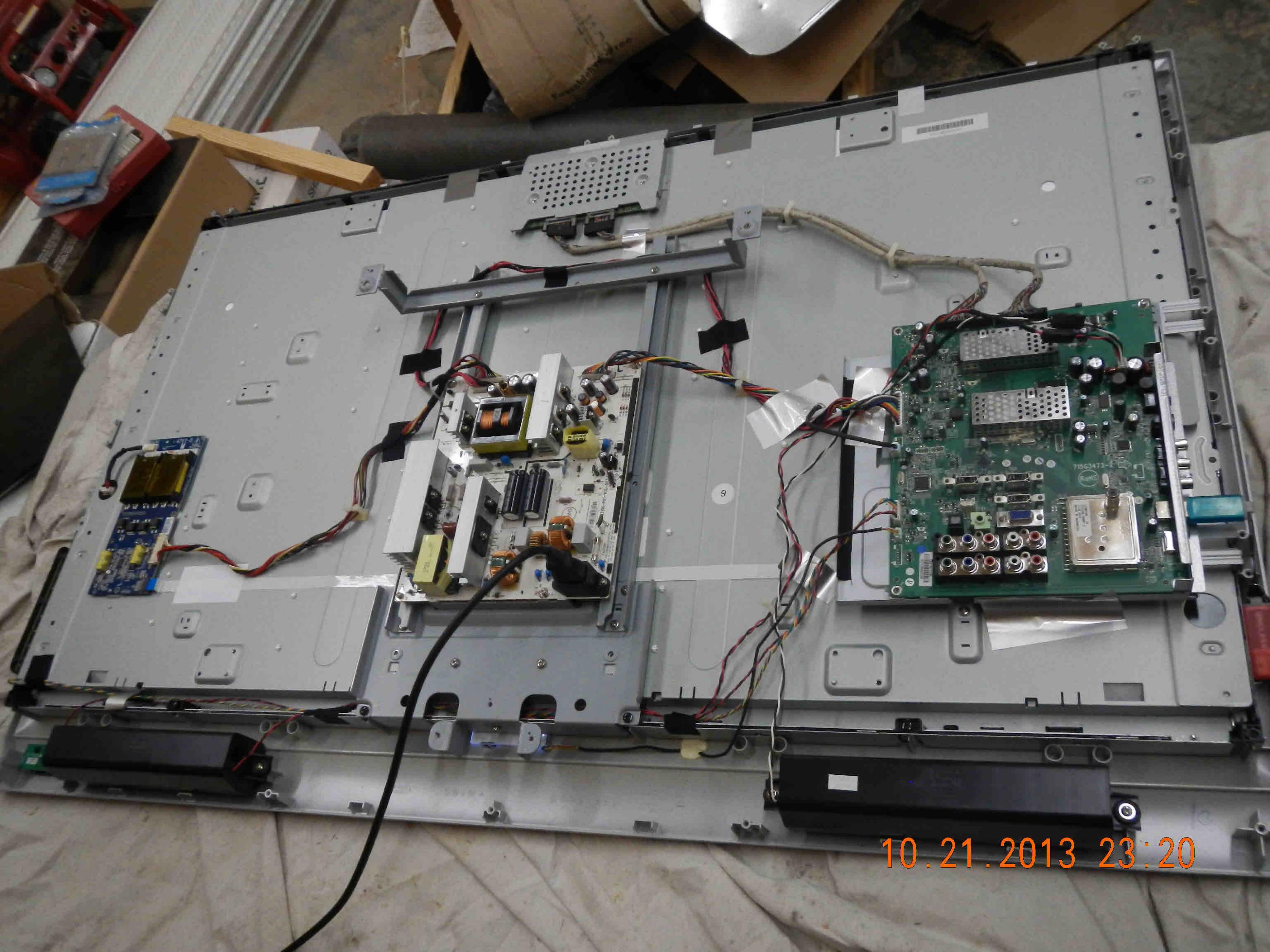

                    Okay, I've got a video of the TV starting up, working, great. The only thing that's strange with it WHEN IT WORKS is that the VISIO power indicator never turns amber. It's always dim white/gray when it's off, and when it turns on (every time, when it works or not), it just gets a little brighter, then dims down again where you can barely see it. When the set does NOT work, the power indicator does the same thing, the backlights come on for about five seconds, then go out for about three seconds, then come back on and stay that way indefinitely.

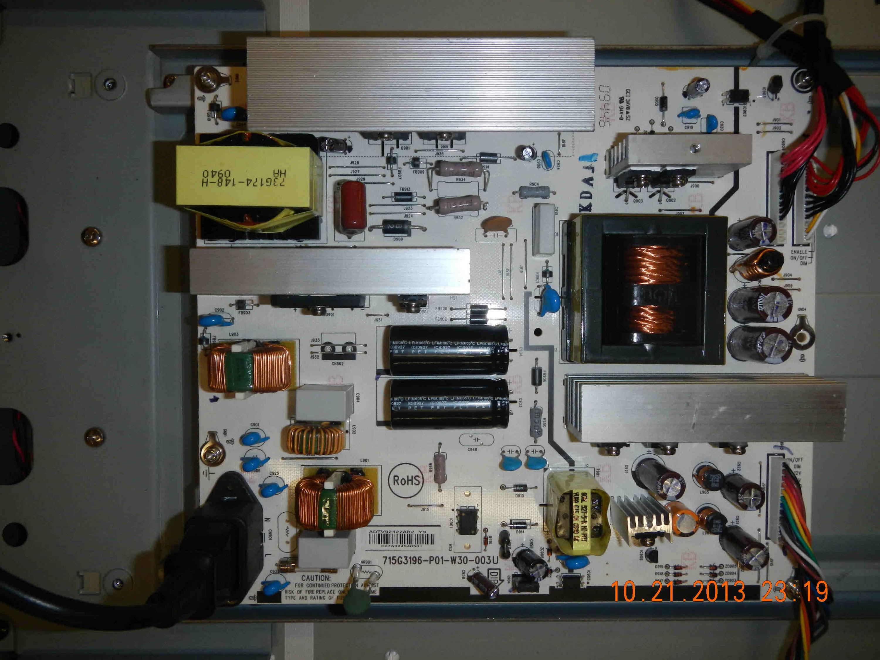

                    I checked the voltage at the large caps on the power supply, and each is 166V. I don't see any burn marks for puffed capacitors, and the voltages, from what I can tell (and that ain't much!) match the markings on the boards. Checking U701 and U702, I get 9.1V and 12.0V out, respectively... Those are just ones that I've checked from perusing this forum...

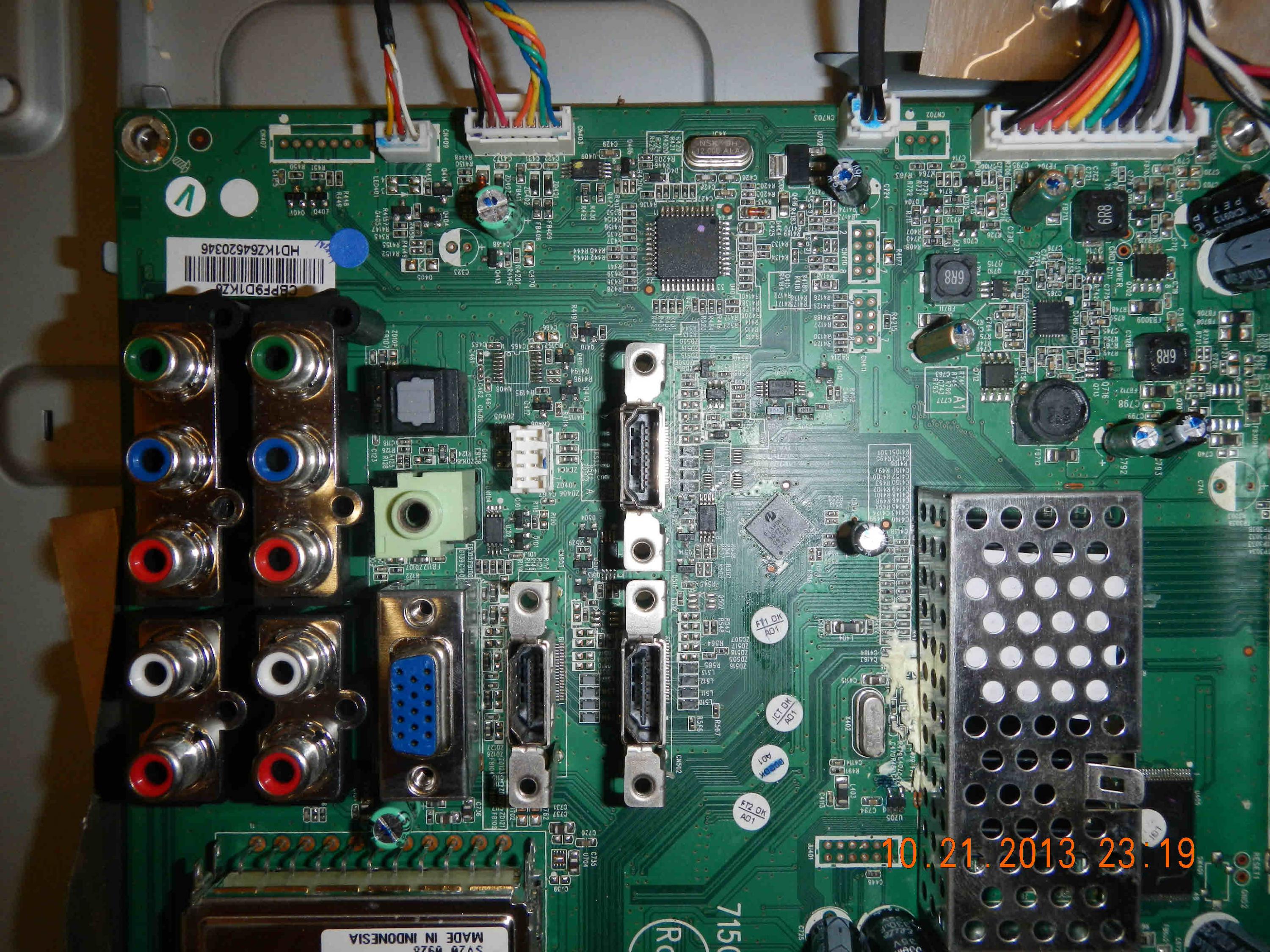

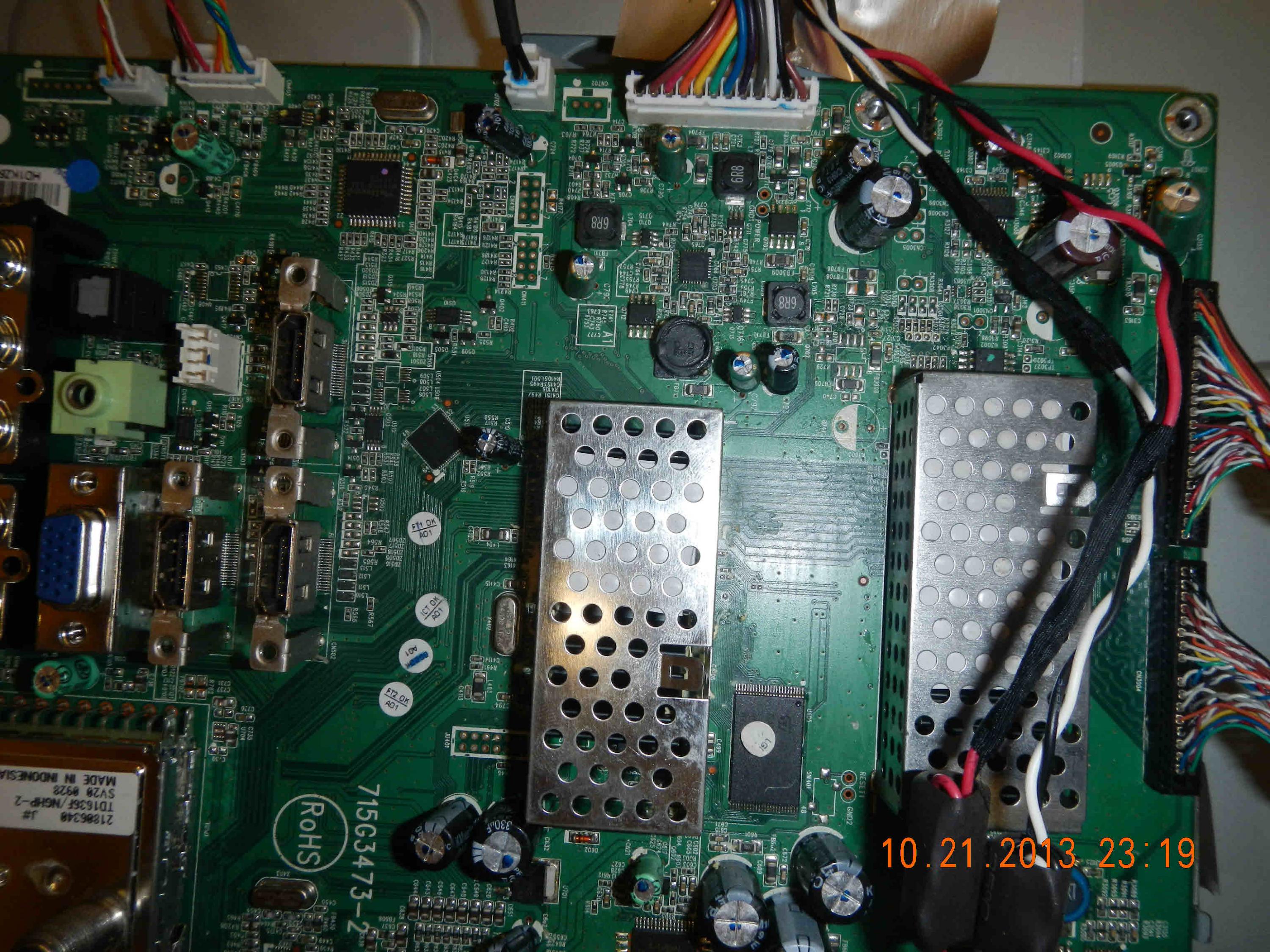

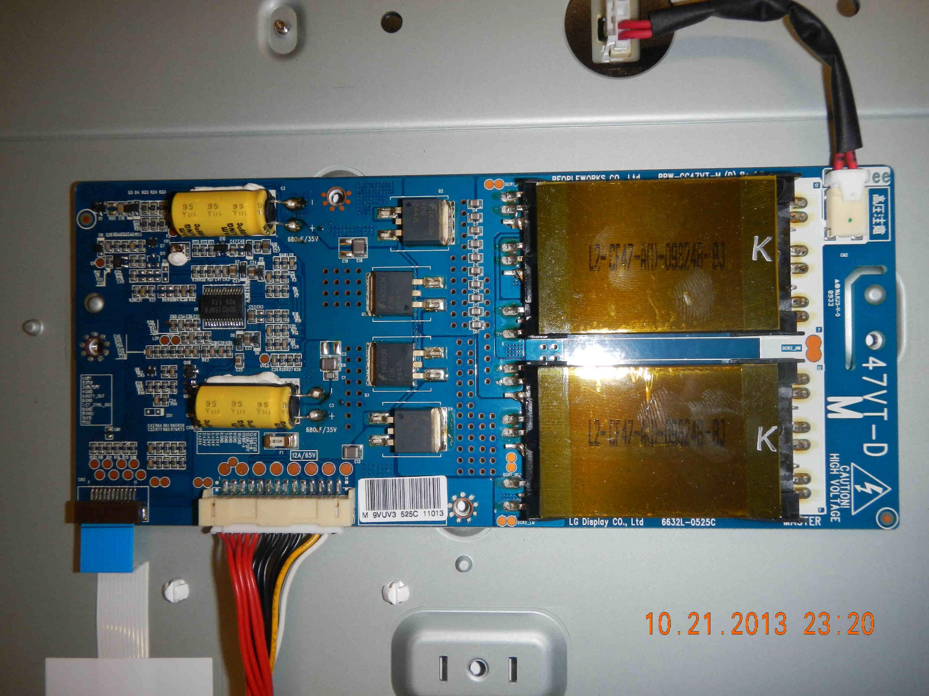

                      Okay, here are some pictures of the boards. Not sure how detailed you want or need... Bits are free (Got a 64GB card in the camera), so I can take as many as will help out.

                            That inverter board looks like either someone already did a repair on it (look around the legs of the caps and the inverters themselves) or that was a piss-poor job at the factory...

                              I repaired this set a while back. Keep in mind that there are actually two inverter boards for the panel. There should be another one that is under the metal plate where the main board is screwed on. There was a couple bad FETs on the inverter board which was the problem, but im not sure if it is similar to your problem.
                              There vizio logo doesnt actually change to amber for this particular set when this it is turned on. It'll just get a little brighter when on and dimmer when off, or vice versa (i forget which).
                              But you said when it doesn't work the backlights would go on but there is no picture. Then I would guess the Tcon board. (Bad panel is also possible since its intermittent)

                                i was thinking the same thing as tiezane that it looked like someone already tried to repair the inverter board. and i also agree with glitcher that it is probably the t-con board which is the cause but could also be the panel. the t-con board is at the top middle of the chassis still under that metal casing with the 2 connectors going to it in your last pic. i would suggest that you see if you have those 2 connectors properly connected and then turn the tv on and wiggle the connectors to see if it gets better or worse. or it could be the connector going to the panel from the t-con board that is rubbing on the panel i saw someone had a problem with that connector. i don't think you should focus on the brightness of the vizio light when it is on or in standby. thats just my opinion.
