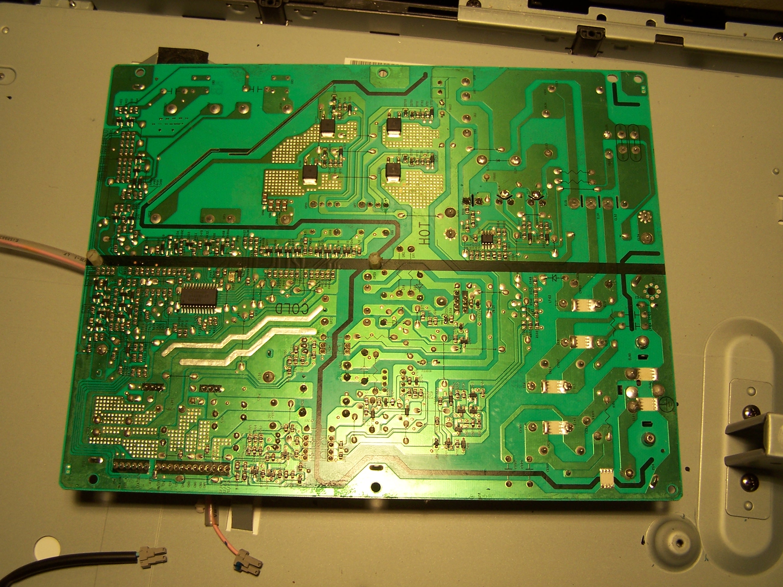

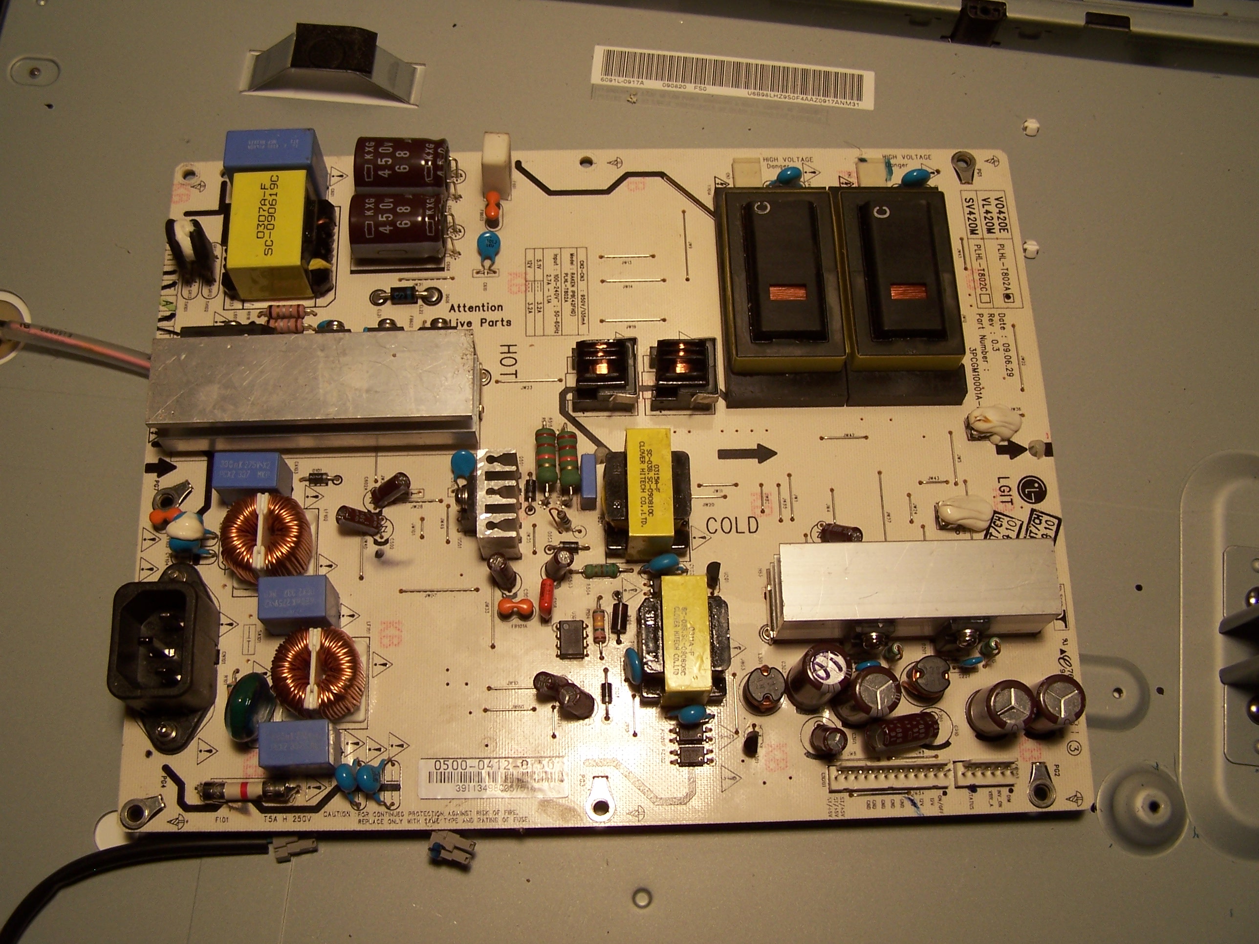

    I need help with a vizio v0420e power board # PLHL-T802A
    The main fuse was blown
    after the fuse was replaced I had a very bright light when using a 25 watt lamp in series with the ac input
    I replaced a shorted mos fet a K13a600 after which the lamp was no longer lit
    when powered up normally the main dc voltage was 186 VDC
    The stand by voltage was 1.2 volts should be 5vdc
    all other voltages were o
    I removed and tested all electrolytic caps ESR and value
    Tested all thru hole Fets
    Tested all diodes including the zener diodes
    Was unable to find any data on u501 part # DK19B I think that this a regulator
    The voltage across ZD105 an smd zener is .141mv in circuit and the correct value 16vdc when removed

    Any pictures of the power supply board? Check 5VSTBY without main board connected?

      The standby voltage is 1.2vdc with the main board disconnected
      I attempted to post pics but they were not included
