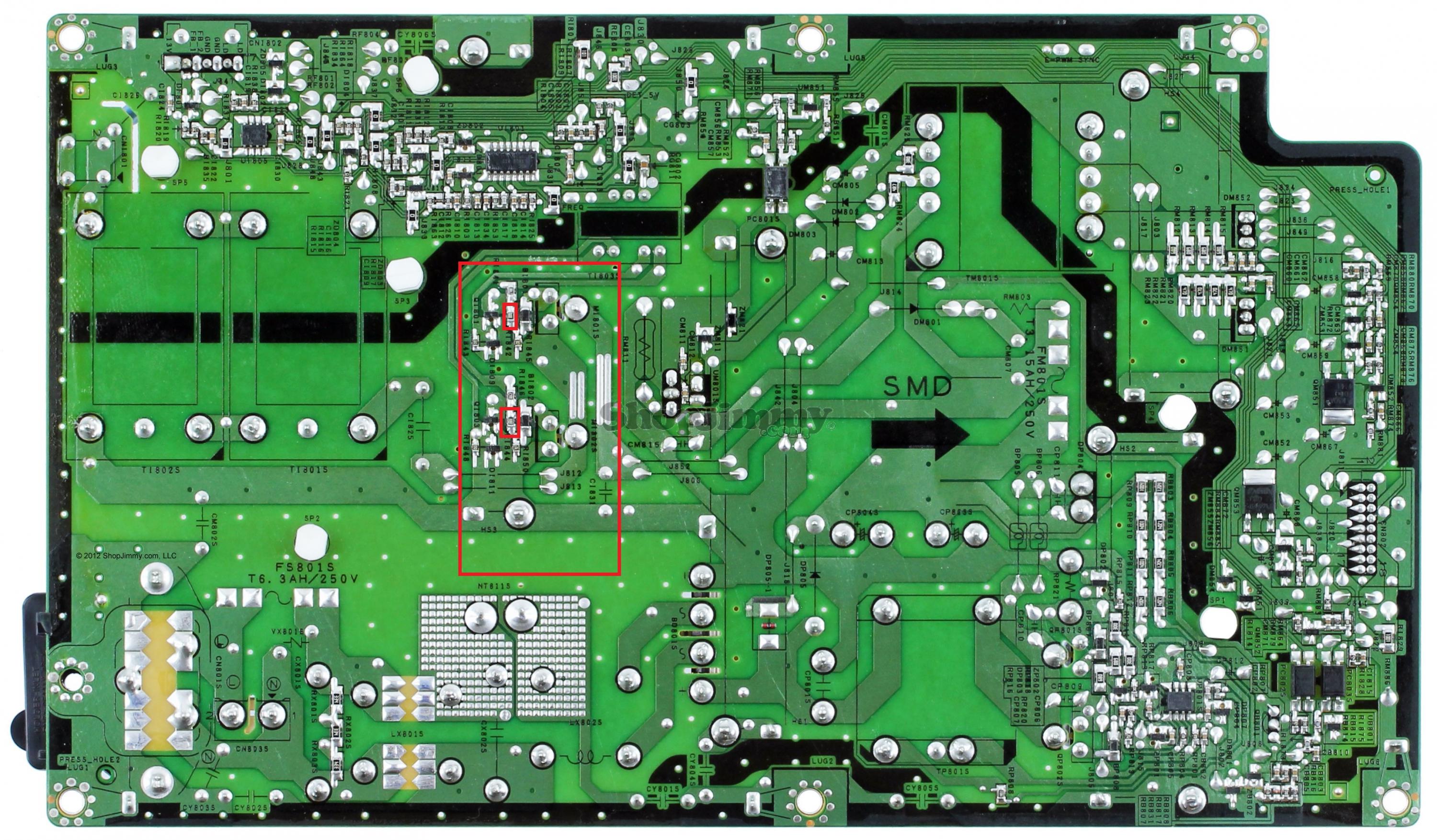

            Could be a power board problem. I'm chasing similar issue on a LA40C650. Totally dead, no standby. Found blown 3.15A fuse and 2 shorted Mosfets 12N50 which power the backlight cct.
            Kinda got it working but backlight was erratic and eventually it went bang again.
            The same FETs blews but also a lot of resistors and SMD transistors around these blew as well.
            Any chance you could check your board for me and see what version you have?
            I need to know the resistor values because mine are burnt.
            I have BN44-00340A, the B version is different in this cct so no good for a comparison

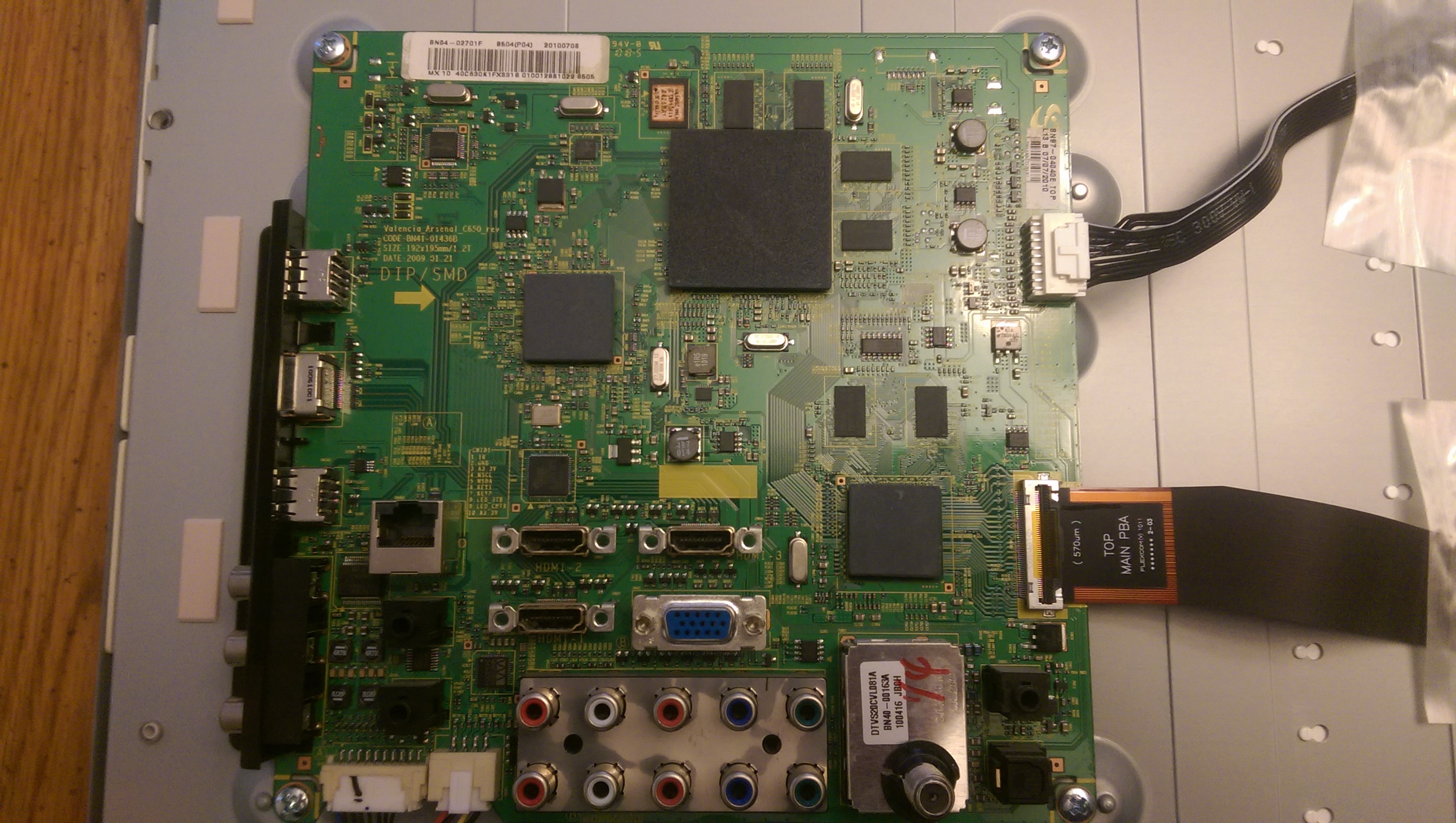

              Re: Samsung LN40C630 won't turn on
              This help?
                cheers but it's the power board in the middle, not the mainboard I need help with. But you'll need to check if you have BN44-00340A as the power board
                I've marked the part, on it will be some numbers, could be 3 or 4 digits. The one next to it is 2700, I can almost make it it starts with a 3? I just need the digits on the top.
                This is the section in mine that blew plus the 3.15A fuse on top
