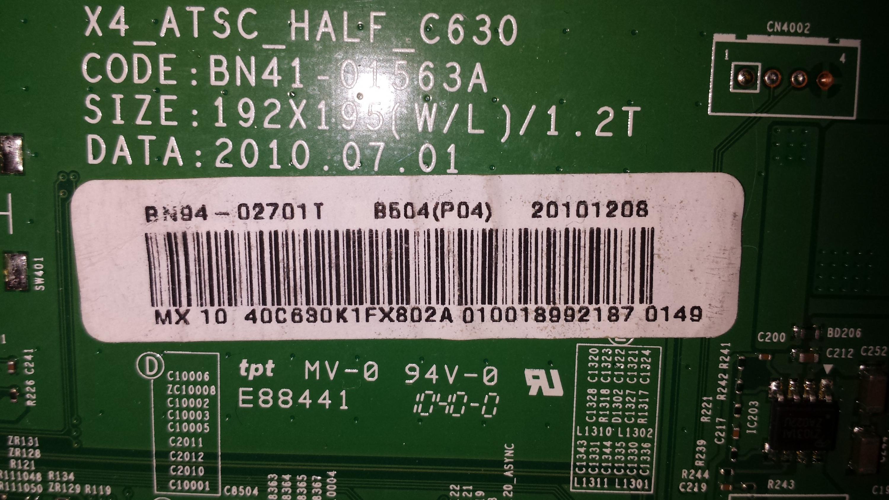

      Pictures of the board? Power supply board P/N BNXX-XXXXX?

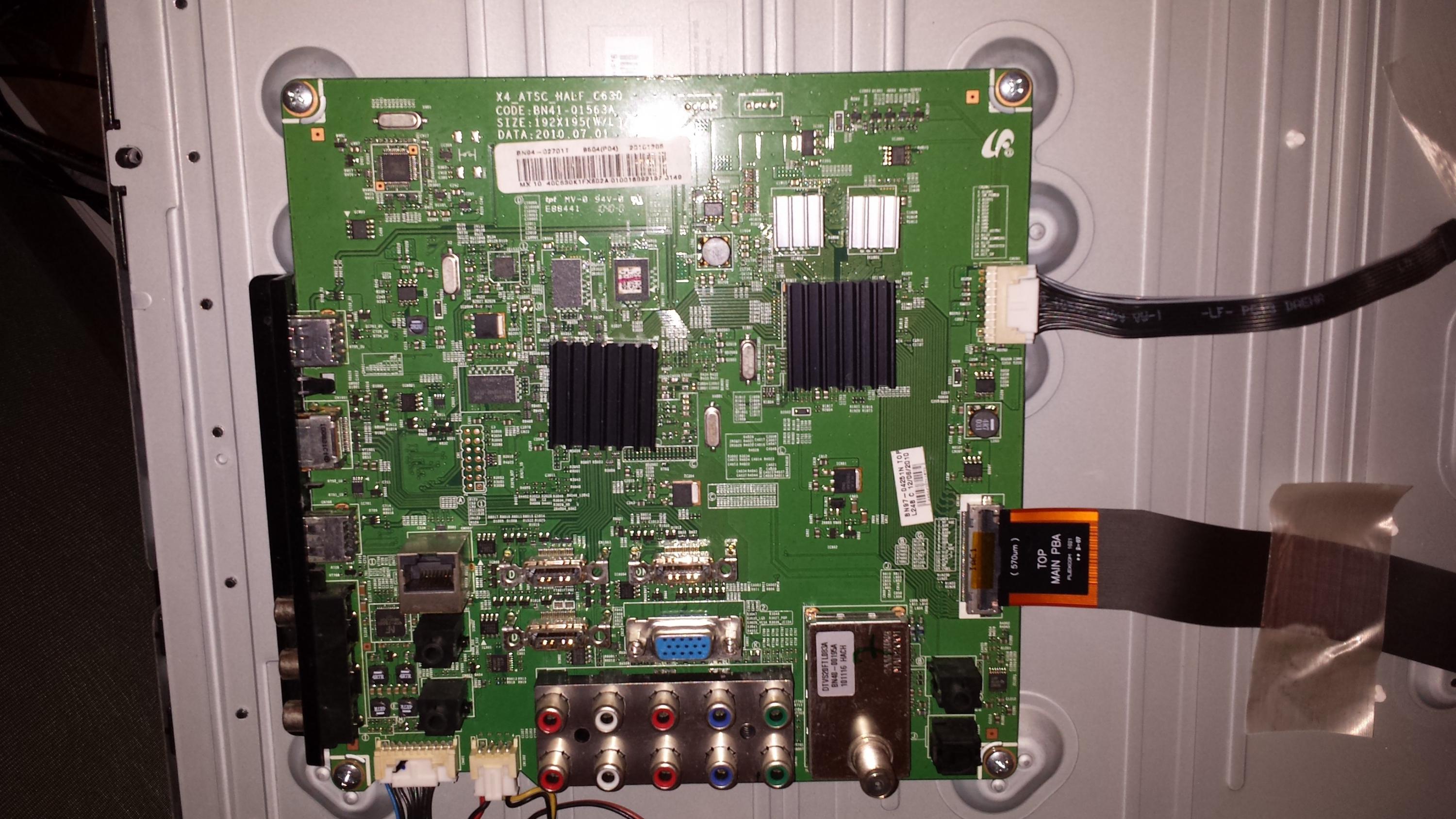

        Re: Samsung LN40C630 won't turn on

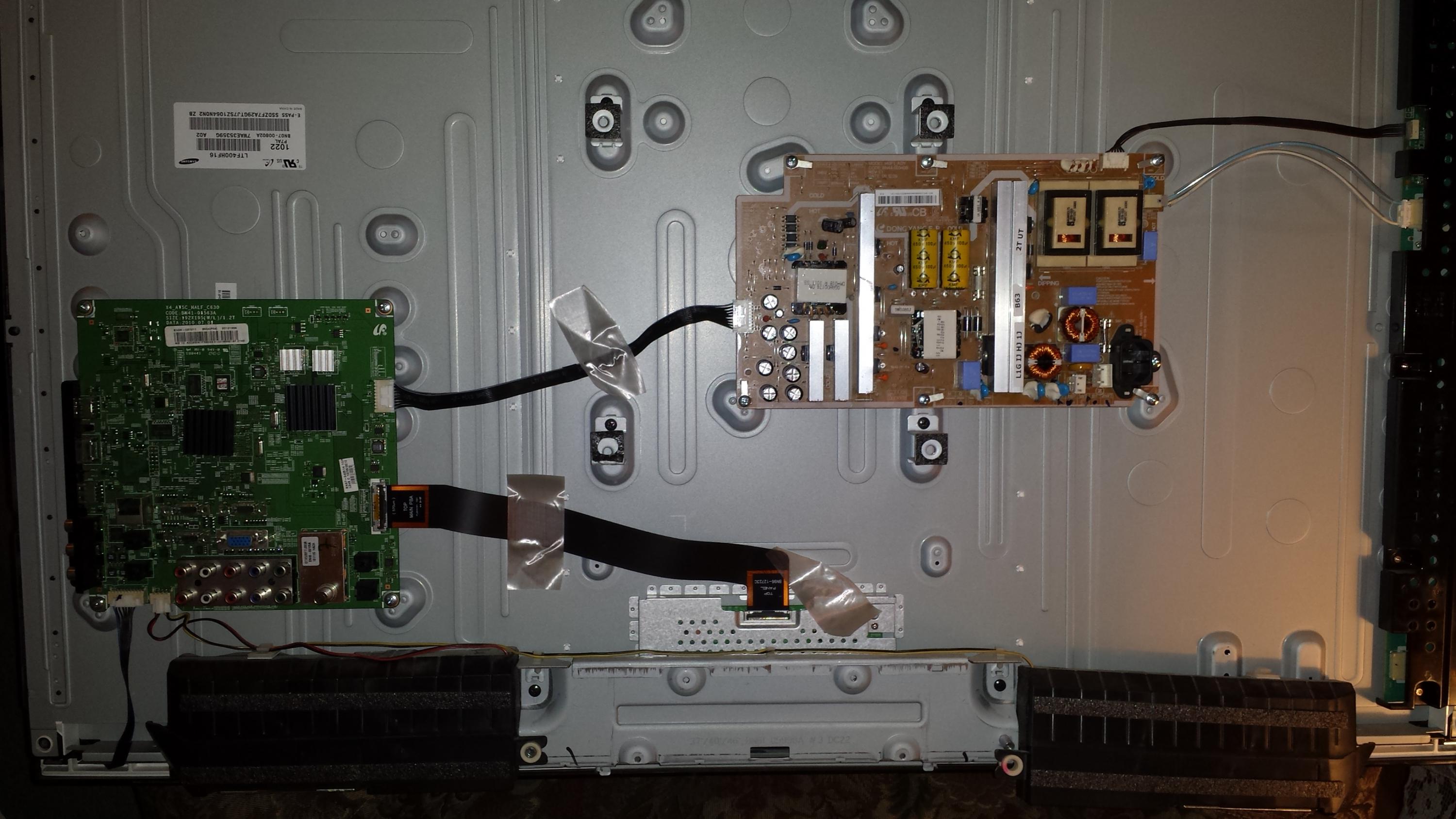

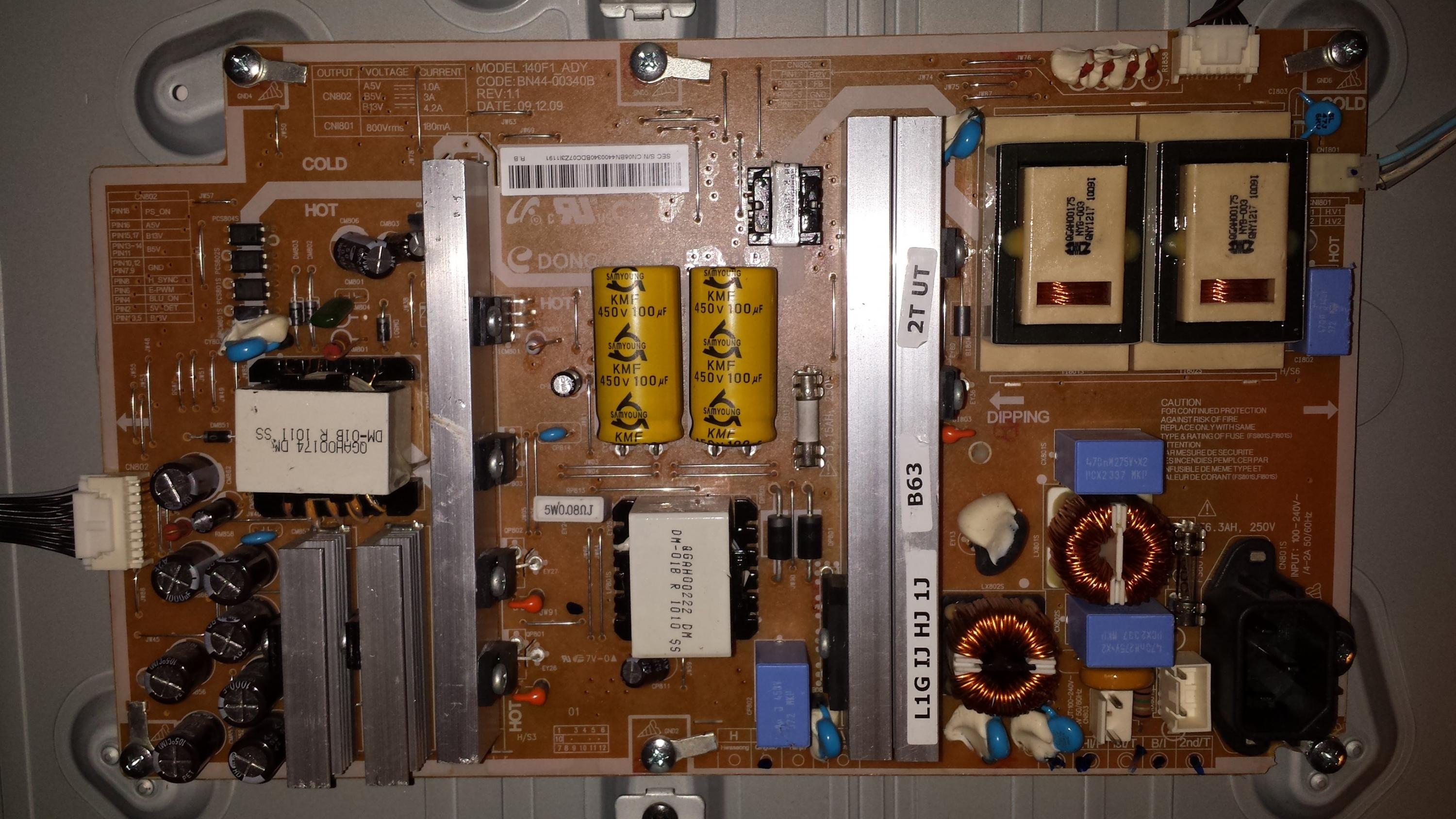

        Thank you for your replies. I looked at the screen with a flashlight, I couldn't see anything.
        Attached is some pictures as requested. There is a picture of the part number also.

          Schematic of power board
          Across two yellow 450V capacitors, check the voltage before & after power button pressed. Expect 160V~170V in standby, 380~400V run.

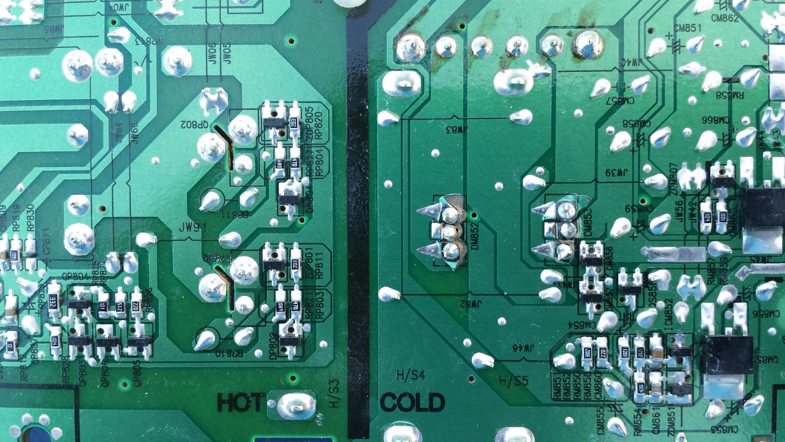

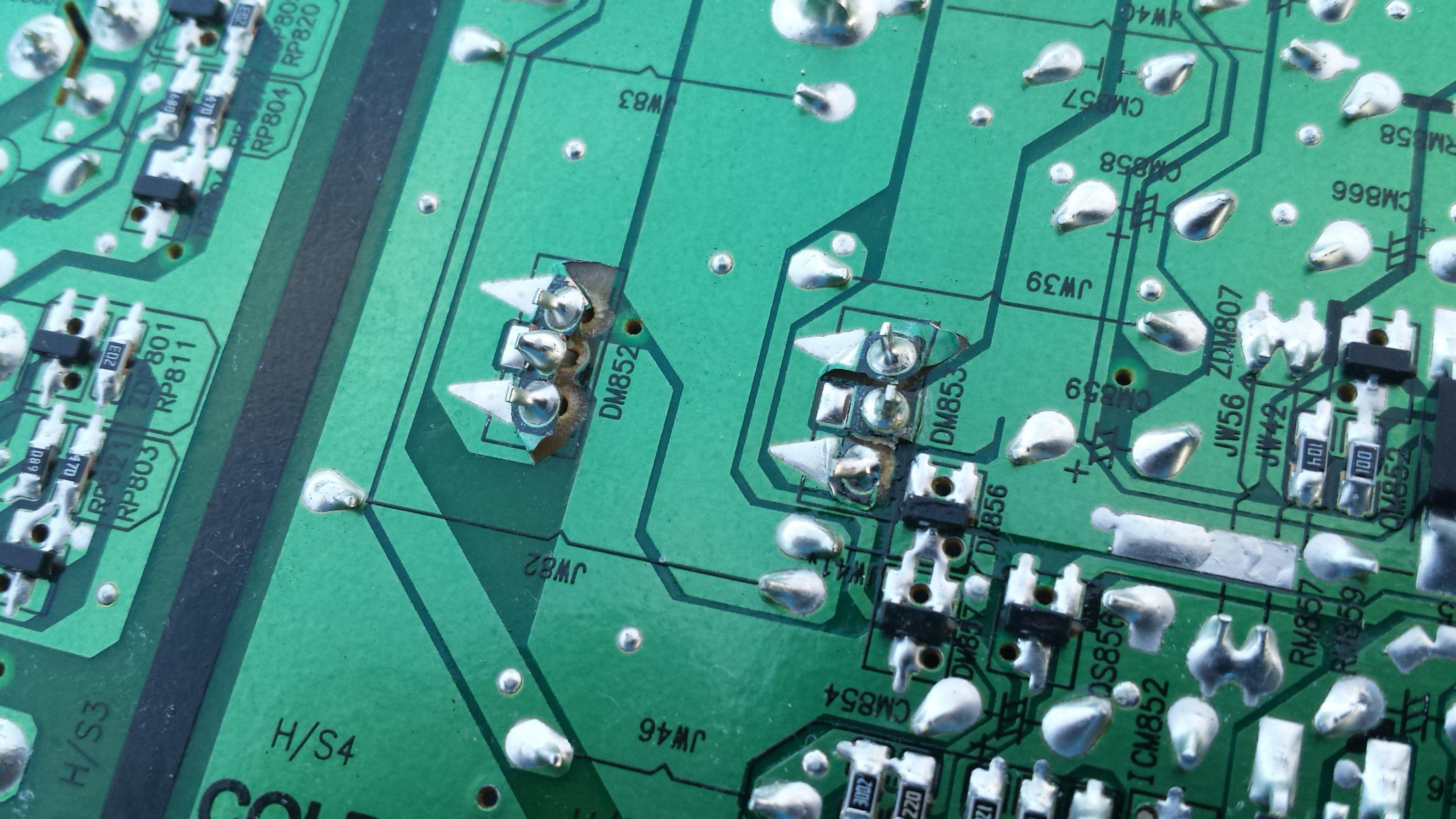

                                I removed the board to solder the leads on it and found out that both DM852 and DM853 were pushed through the board and the circuit board was broken around them. So I guess I'll be looking for another power supply.
                                  Not necessarily. Such damage is often repairable. If you show us a picture, we may be able to judge if that is the case.
                                  • gingerbreadman
                                    • Sep 2013
                                    • 36
                                    Okay, here is a couple pictures of the damage. Let me know if you need different pictures.
                                    Thank you for all your help so far. I appreciate it.

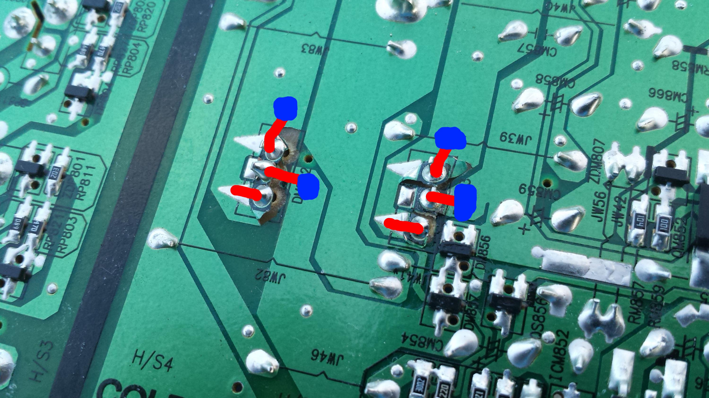

                                      Looks quite fixable.
                                      First of all identify why that occurred, the only reason it could have occurred is the heatsink was pushed down, but this is not normally possible due to solder tabs. Check they are all soldered in place and that none have slipped or broken.
                                      Then, solder wire links to the respective copper areas. To get a good place to solder you will need to remove the solder mask from the board. This is what gives the board its green colour. A small blade or flatheaded screwdriver works well. Just scrape lightly on the appropriate area and you will reveal the inner copper. Once you have a bit of copper exposed, solder as indicated in the diagram.
                                      Blue areas: expose the copper
                                      Red areas: solder a wire
                                      • gingerbreadman
                                        • Sep 2013
                                        • 36
                                        I soldered those wires on. The tv powered on and seems to work great! Thank you so much for your help Tom66!
