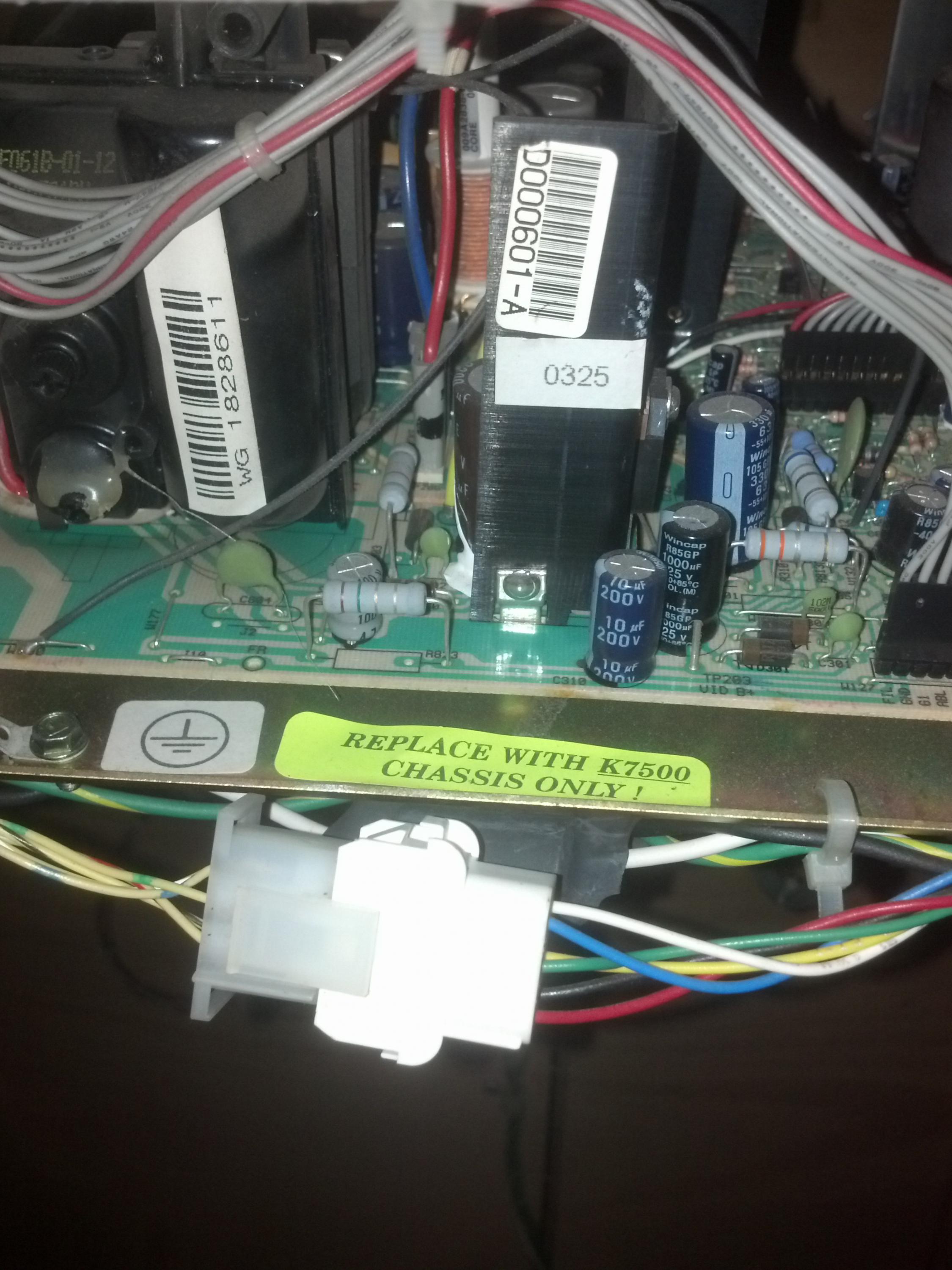

        If by crawl you mean not not staying in frame, no. The picture is steady except for the horizontal spikes. It is very evident when in the adjustment mode with the grid. Vertical lines to have small spikes intermittently. Horizontal lines seem steady. I'll post some pictures perhaps you can point out the cap you are referring to. Not familiar with terminology of b+. Thanks

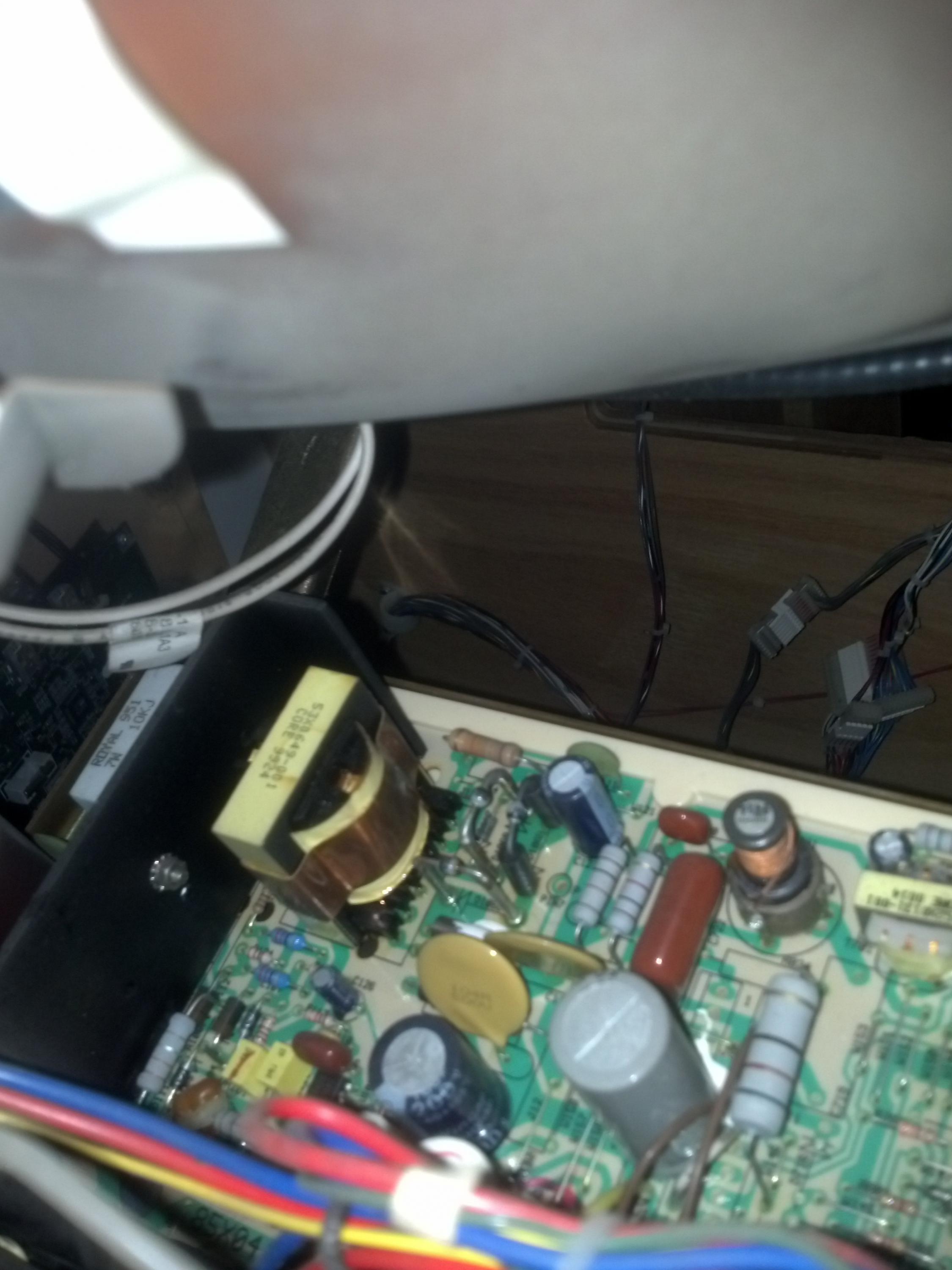

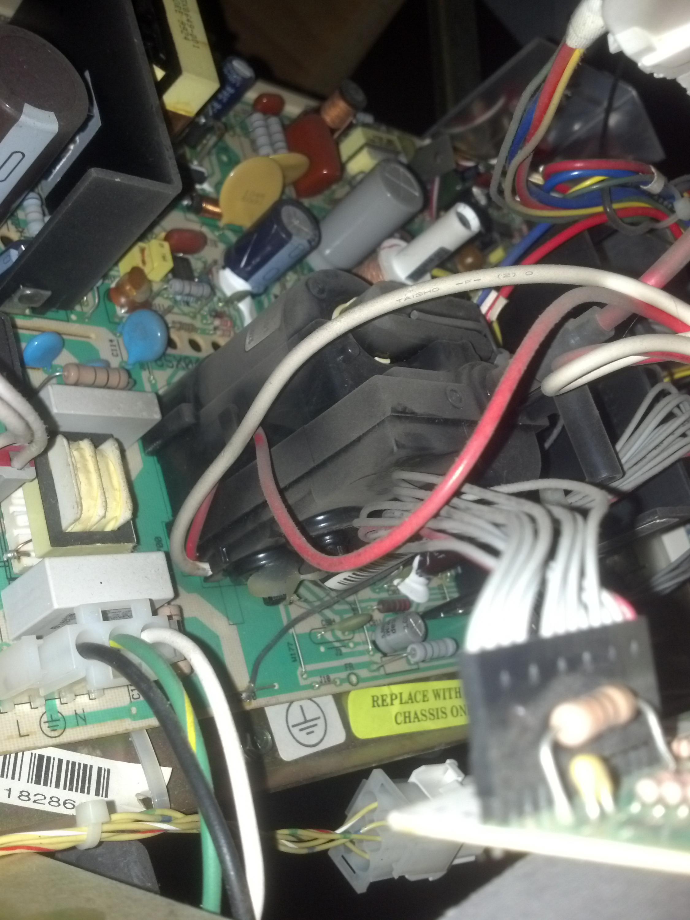

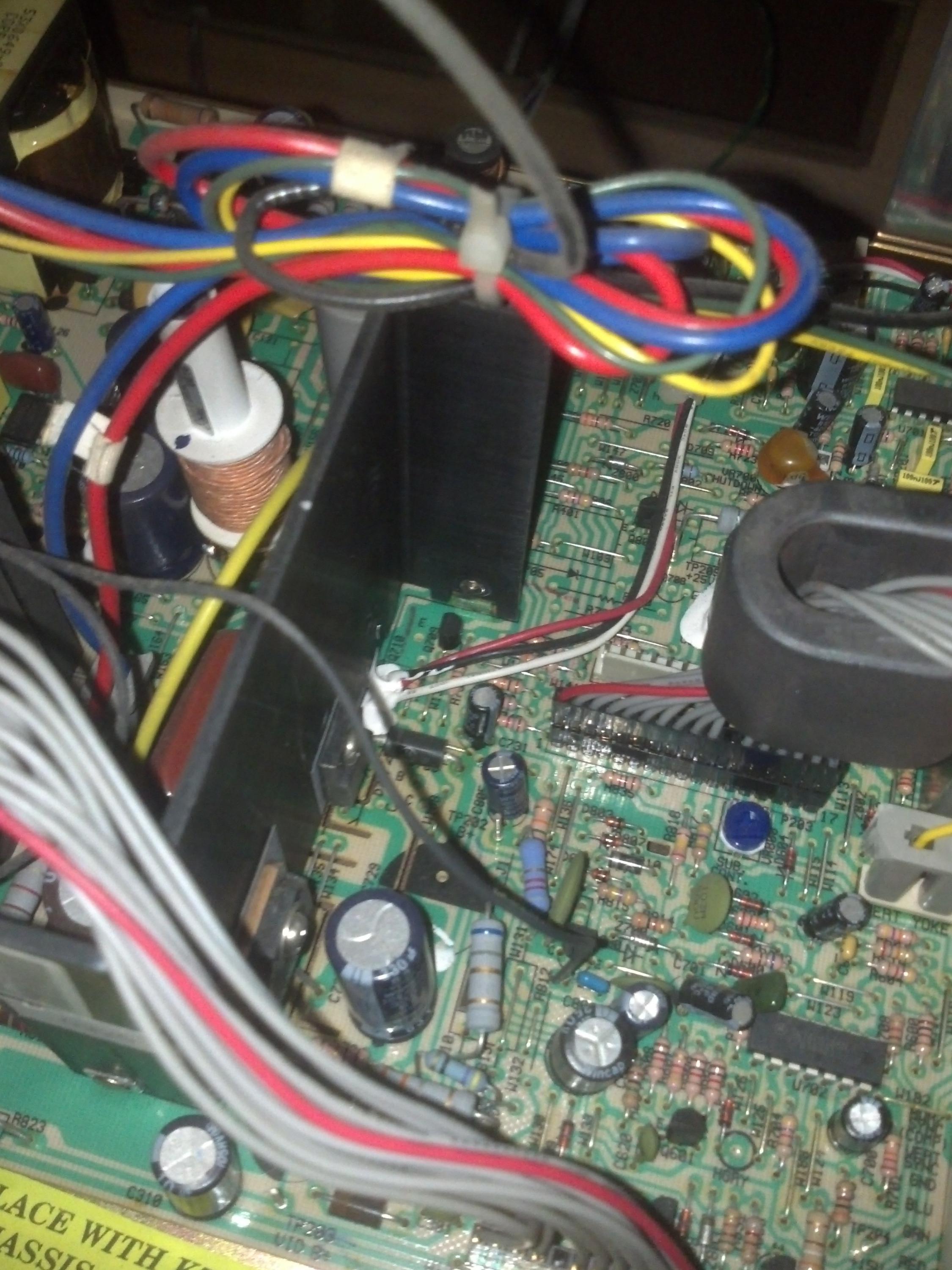

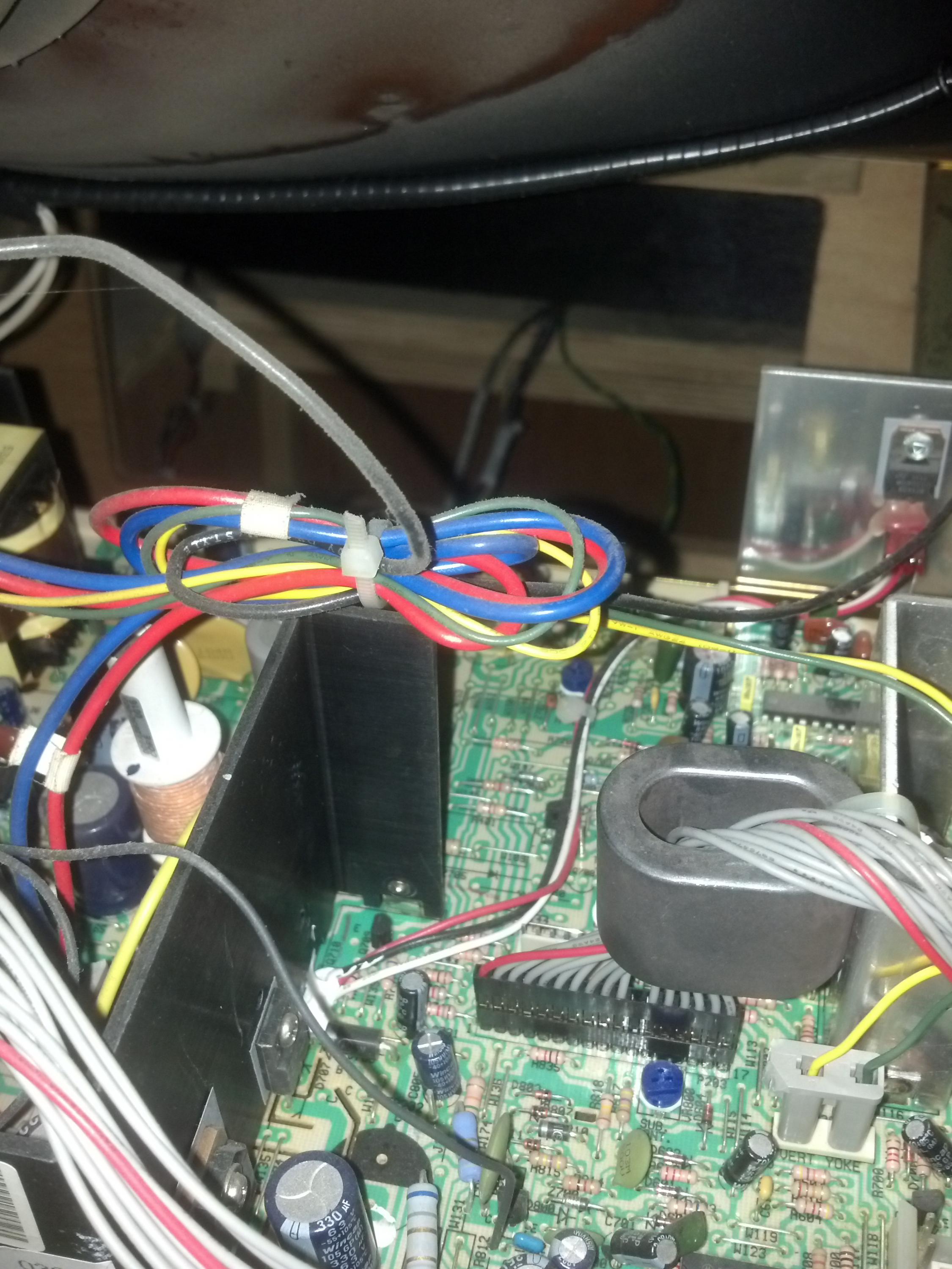

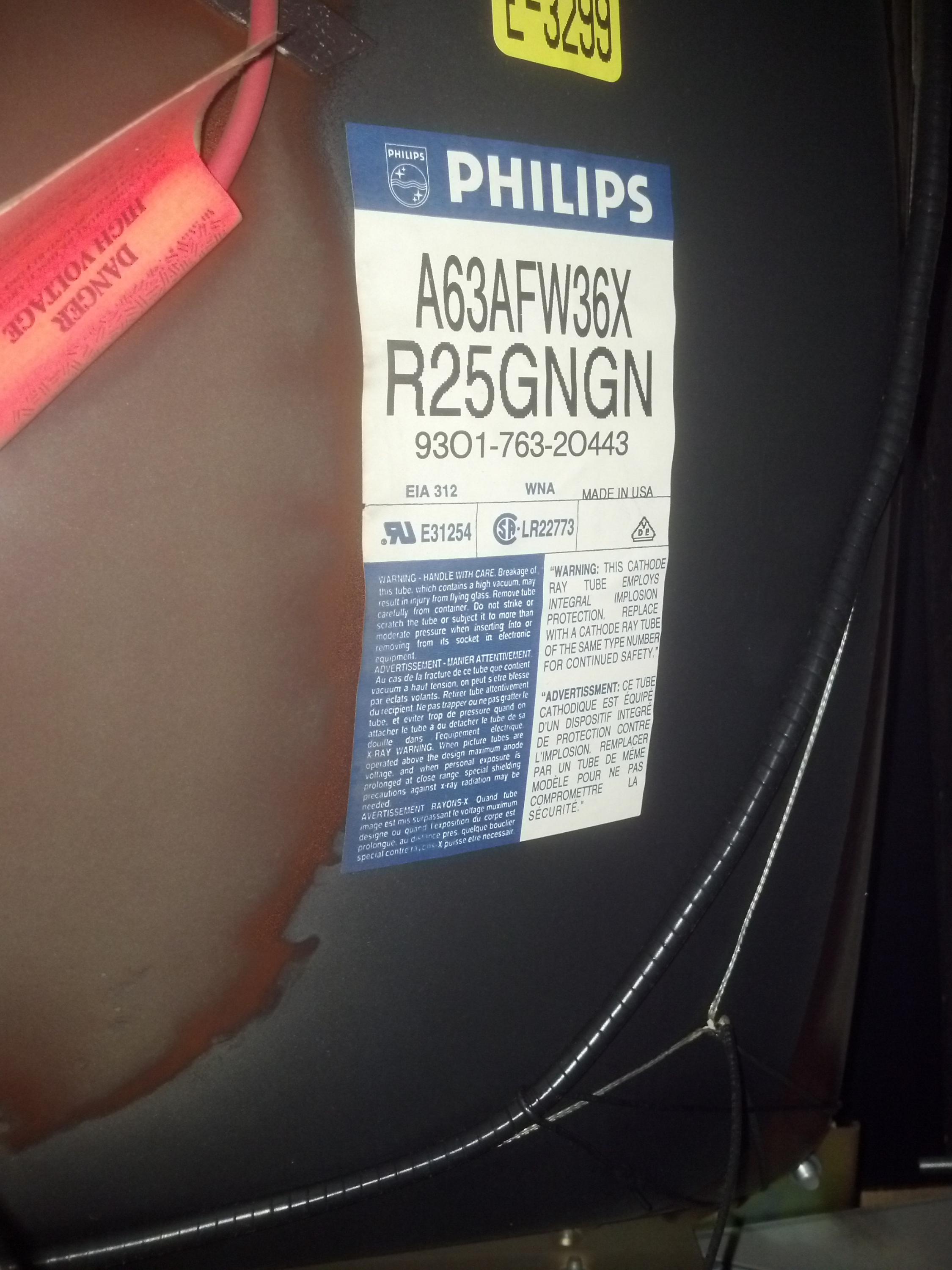

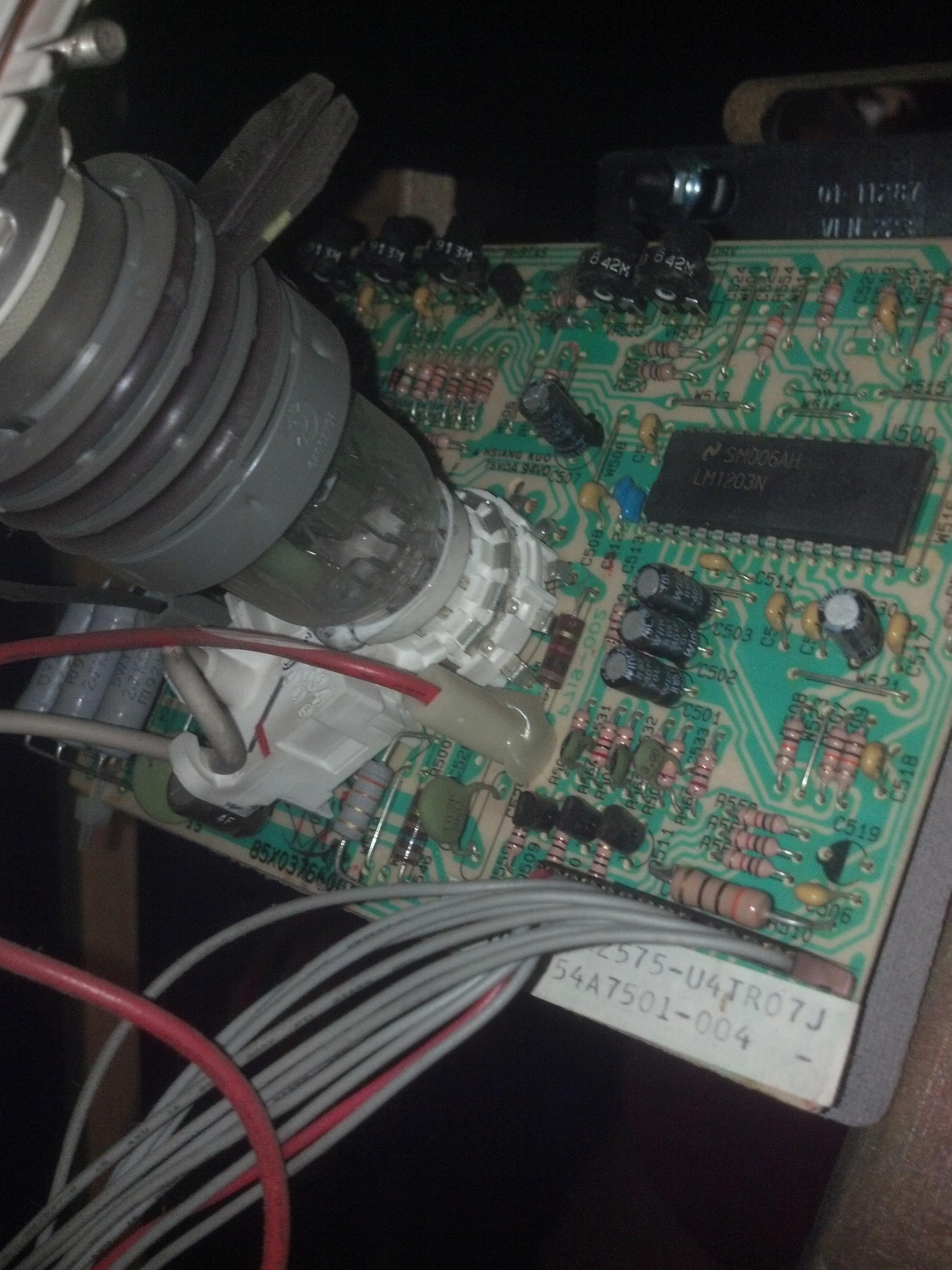

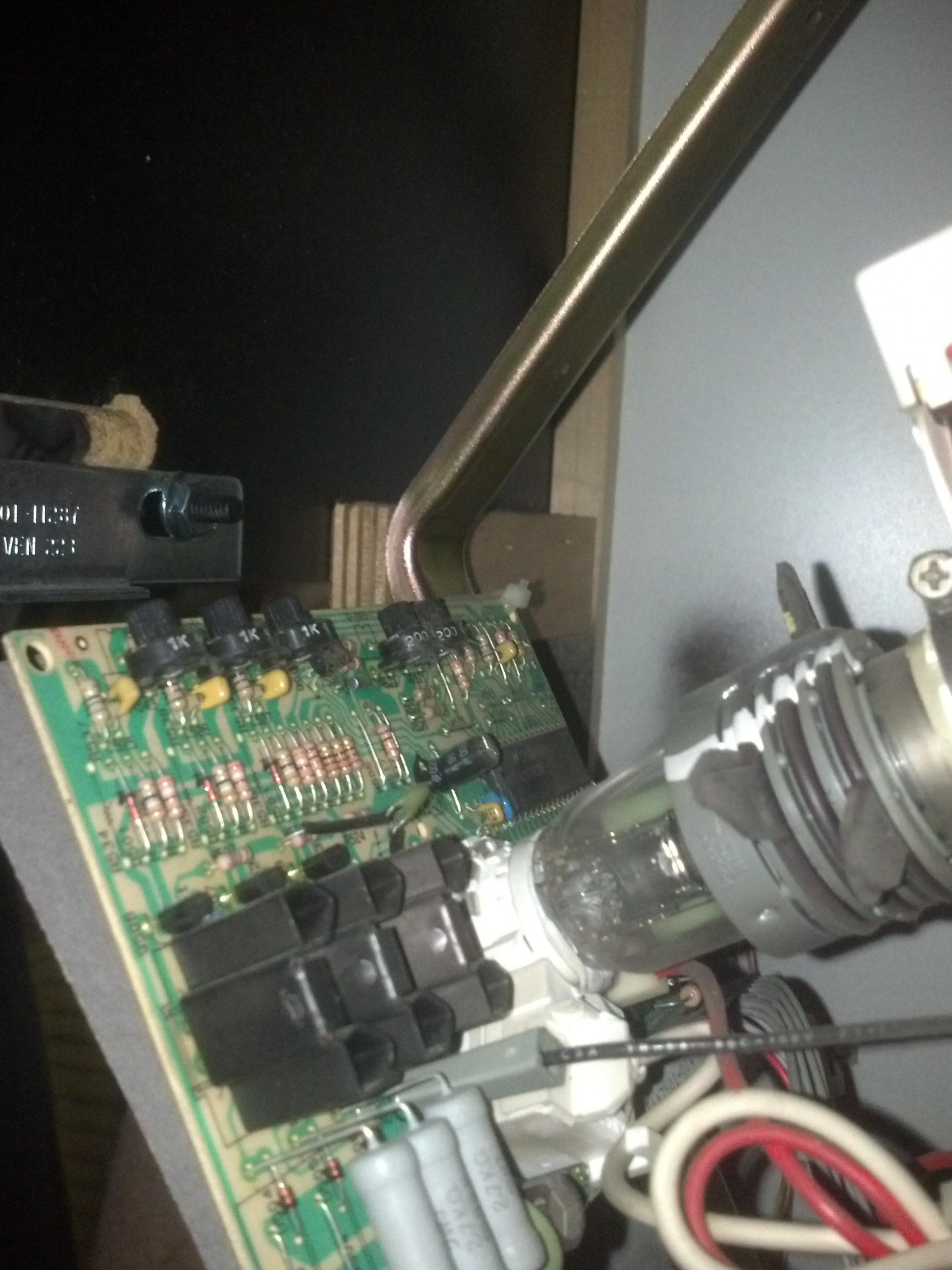

          Re: wells gardner k7500 chassis 25" philips CRT jumpy
          pictures of chassis and tube. Please help ID the B+ side main filter cap.
            Is the screen out of focus at all? B+ are boost capacitors that operate the high voltage aspect of the monitor. Post a pic.of the screen and tge test grid with the problem

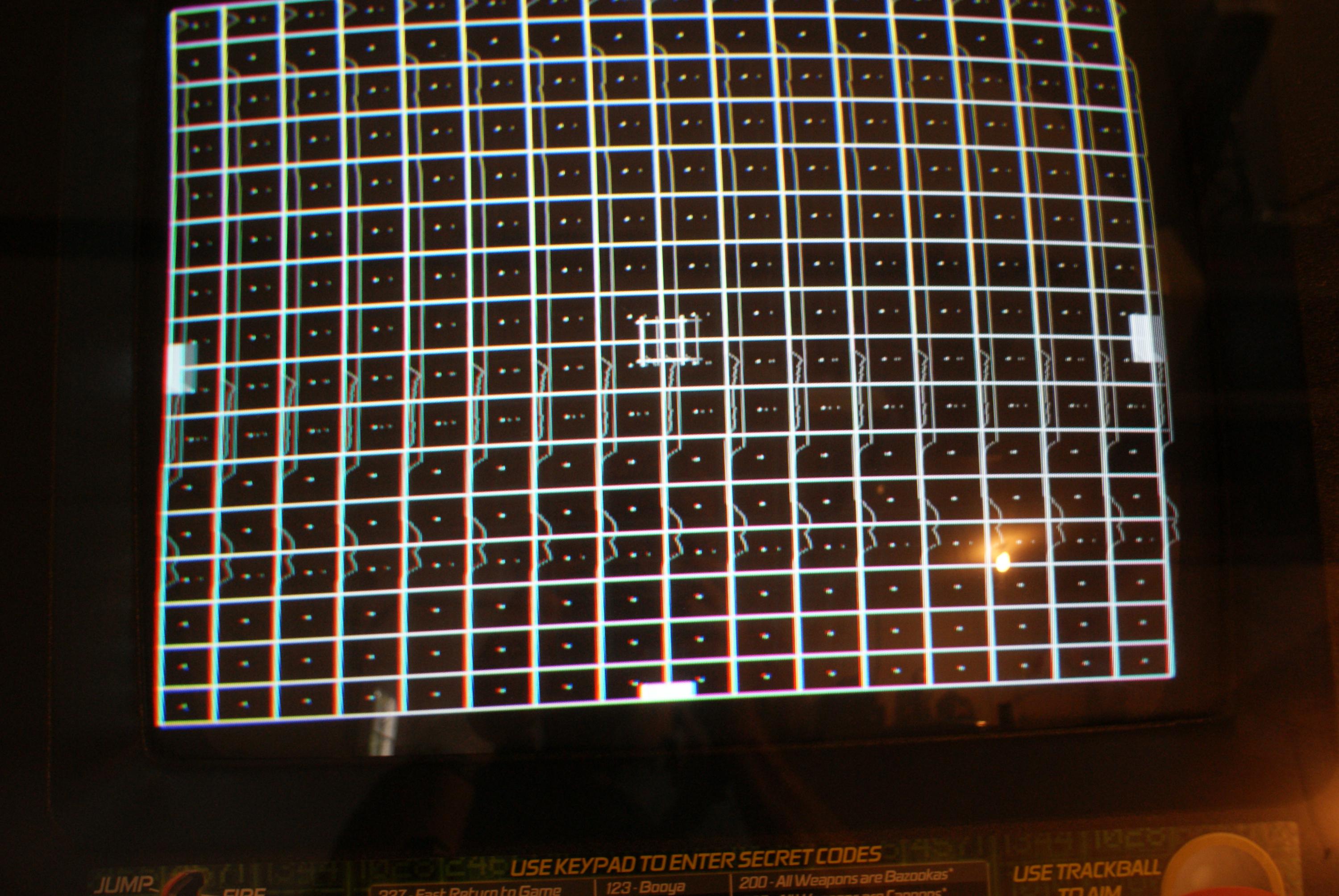

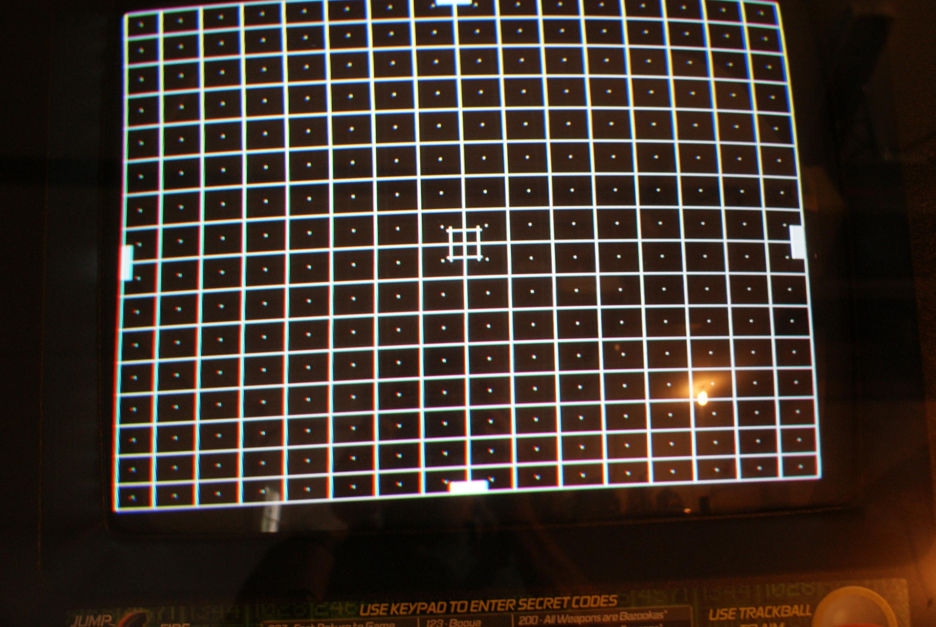

              Added pictures of the picture with adjustment grid. One good, one jumping.
                Thats not at all what I thought I t was doing. Check horizontal centering adj knob gor crap in it adjust it back and forth and see if the thing get s jumpier.
                  Finally had a chance to check it out. It does appear to reduce the jumpiness when I turn the adjustment all the way to the right and jet more jumpy when I turn all the way to left. I have two more of these games and I will try to switch the vontrol board to see if it improves. I think it just plugs in. If you have more suggestions mI would appreciate it. I'll let you know the results.
