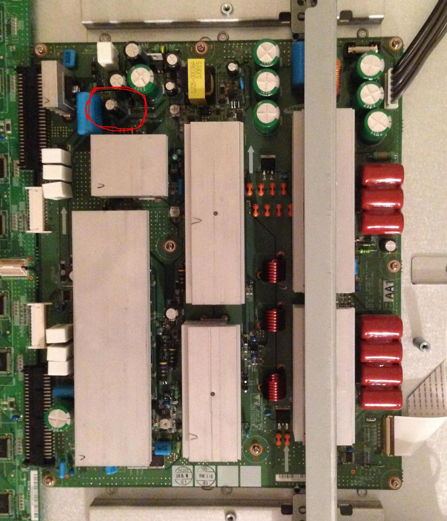

So a question, when I started this diagnosis I found the bad cap on the Y main board and replaced it.....I will admit I had no decent de-soldering tool at the time and kind of mangled one of the circuit board holes trying to clean out the solder.
When I plugged in my "repaired" Y main the power tried to come on briefly and then reverted to the clicking and no power I had been dealing with from the start.
I have since removed that poorly installed cap (seriously bad cold solder joint), and with proper de-soldering tool cleaned up the hole and replaced it again. Is it possible for that one bad cap (or my botched solder job and potentially damaged board) to take out the power supply?

Well, I think I may have damaged the Y Main board when replaced that bad cap....
Plugged everything in, crossed my fingers, turned on the TV....got the "chimes" screen sparkled briefly then came on with a clear picture....in the top half!!! The Bottom half of the screen is dark.
Now I know that could be the lower Y buffer....but this was not the symptom when the power board went out starting this adventure.
I have not disconnected any of the ribbons to the buffers, only R&R'd the Y Main, and those are hard connects to the upper and lower buffers.
The cap I replaced is circled in these pictures.
