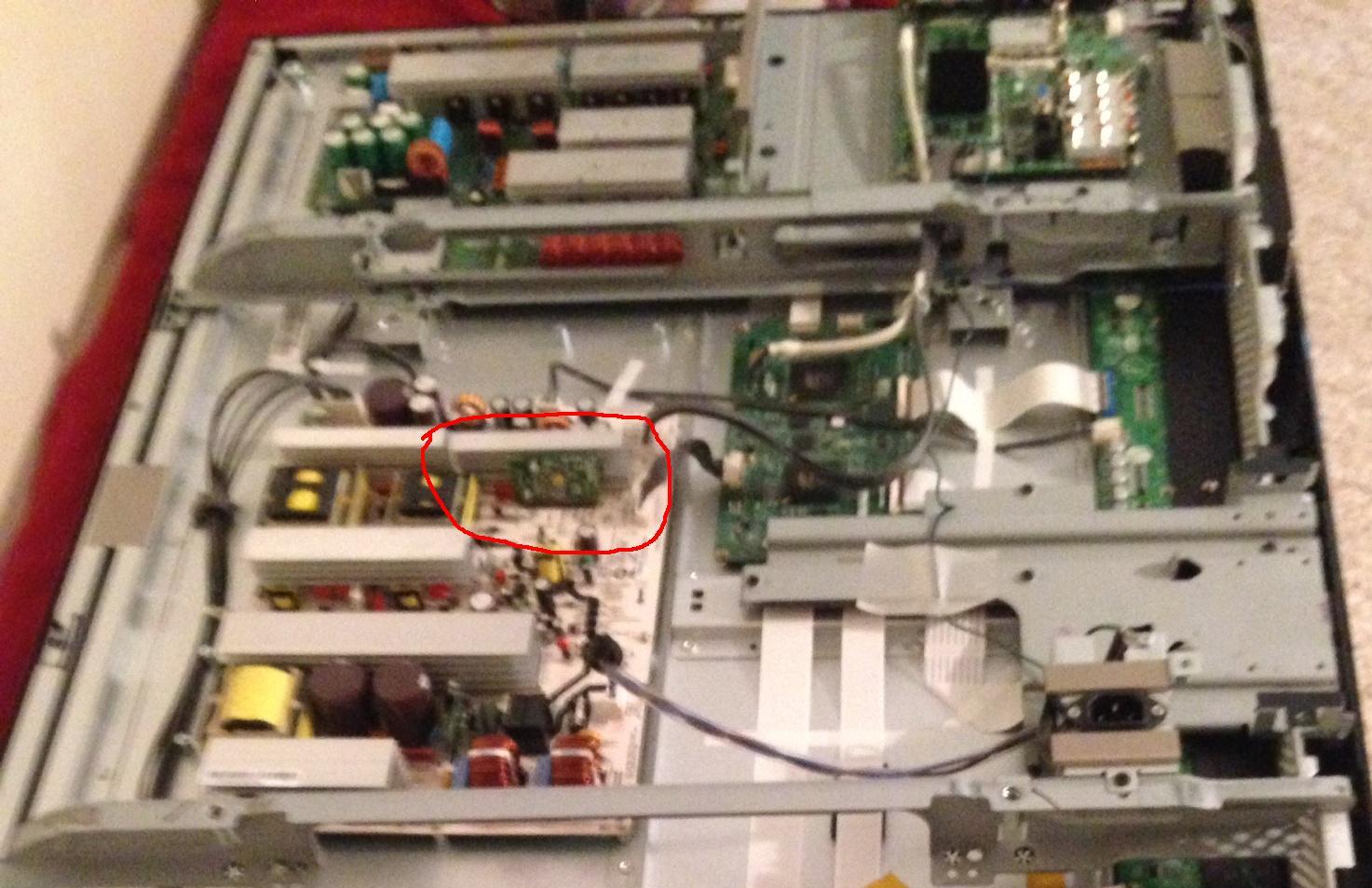

      Updated info.
      When relay is clicking the stand-by light is on, but goes off when relay stops and the LED on the power supply board starts blinking its continuous series of 7 blinks.
      With the Main Board unplugged the green LED is on steady. No stand-by light and TV will not turn on.
      The LED is on a small board mounted on the Power Supply board..see photo.

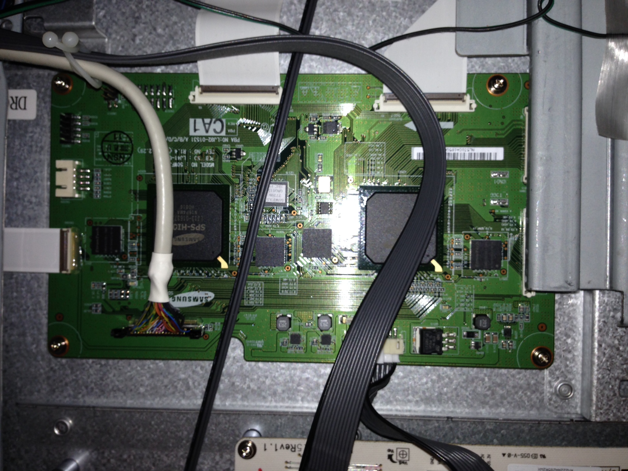

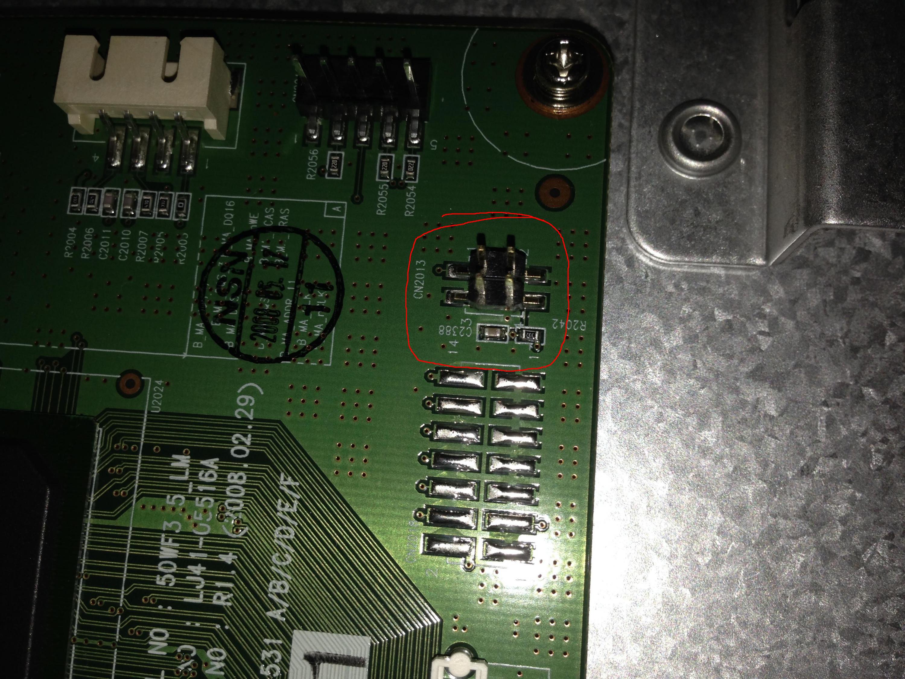

        I'm interested in the board to the right of the power board in that pic, the control/logic board. Does the light on it blink at all?
        • EsqzMe
          • Sep 2013
          • 56
          Re: Samsung PN50A550S1F does not turn on, relay clicks.
          No light there. I was just looking at it to see if I could find the 4 pin connector for test jumps....
            This board???
            Wonder what this thingy on the circuit board does??
              Yes.

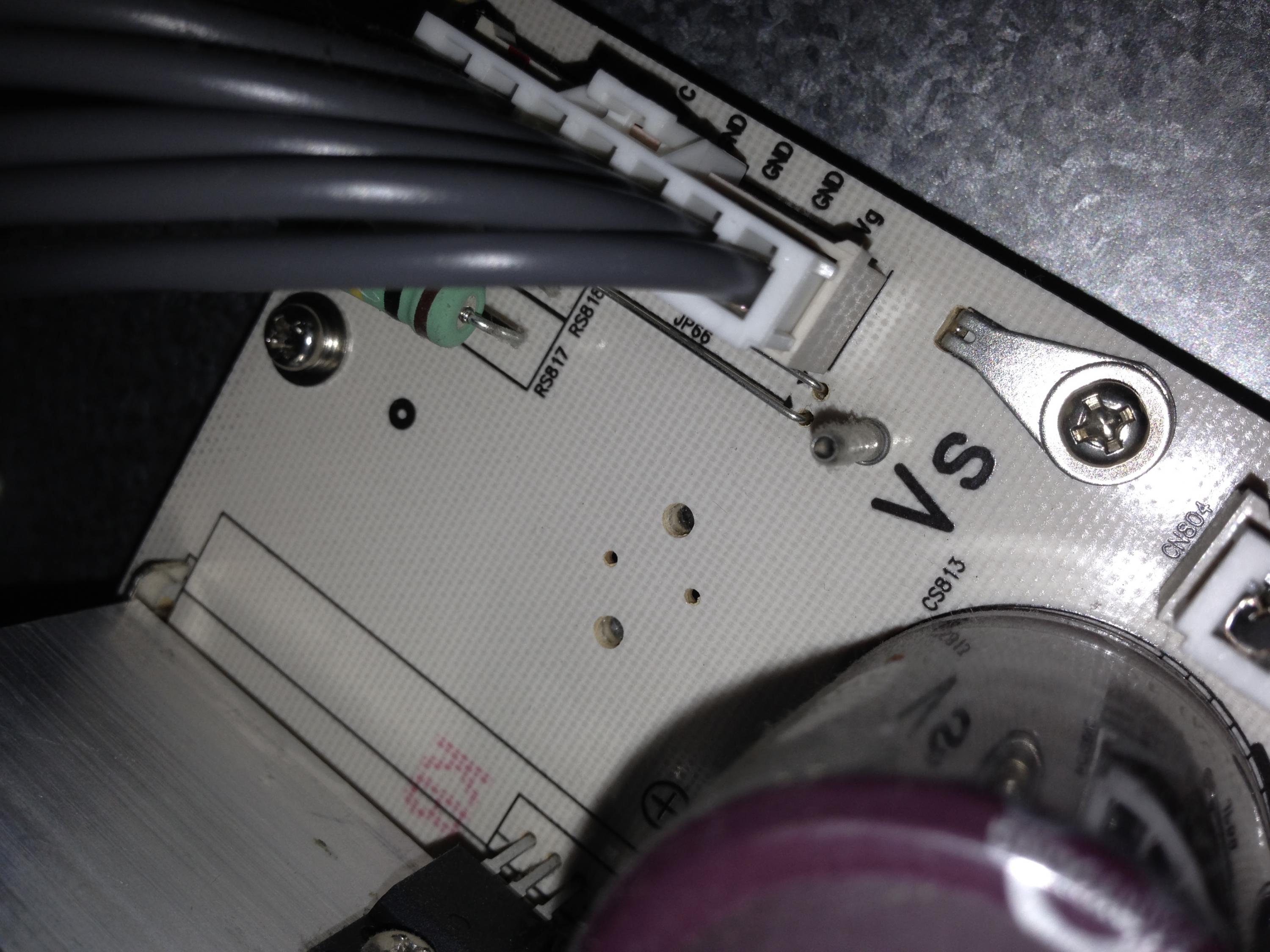

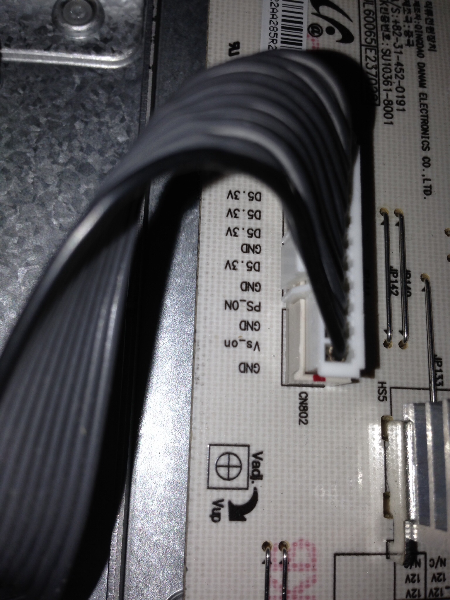

                          OK...I've got resistors, I've got jumpers, I've got a good meter, and I've located the #3~4 pins to jump....but:

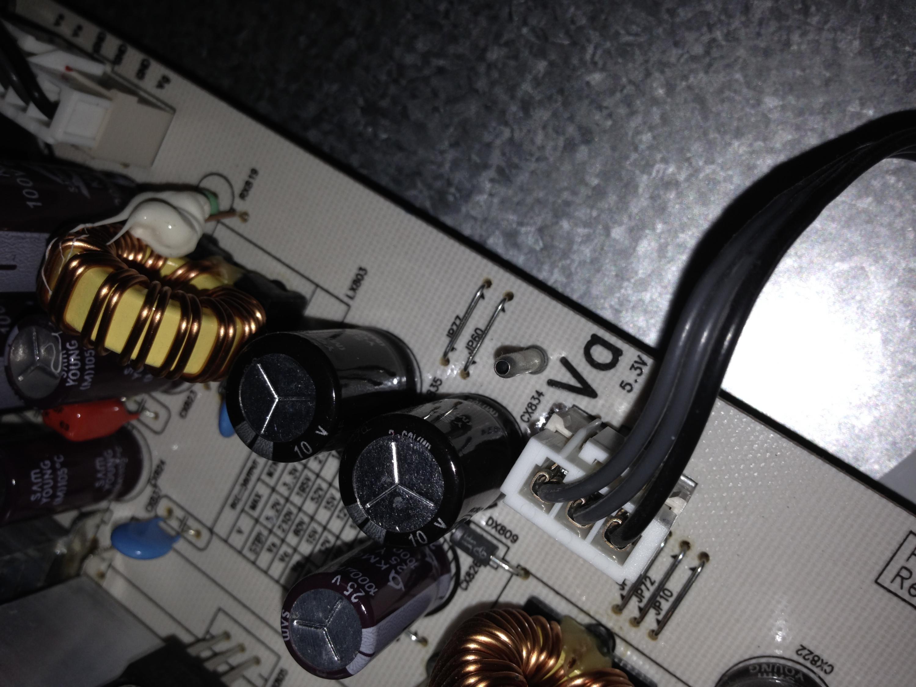

                          where is the VS-ON and PS-ON??? I find a test point labled VS and one labeled Va on the power supply, but no PS-ON or VS-ON...
                          I figure ground is a chassis screw, but where should I tap 5.3 v power supply?
                            VS-ON and PS-ON -should- be on the connector which hooks between them main and power board. It should have a little legend next to it.

                              I'll get my magnifying glass out and have another look...and the 5.3v supply?
                                Also on there though may be labelled 5.2 or 5.4V.

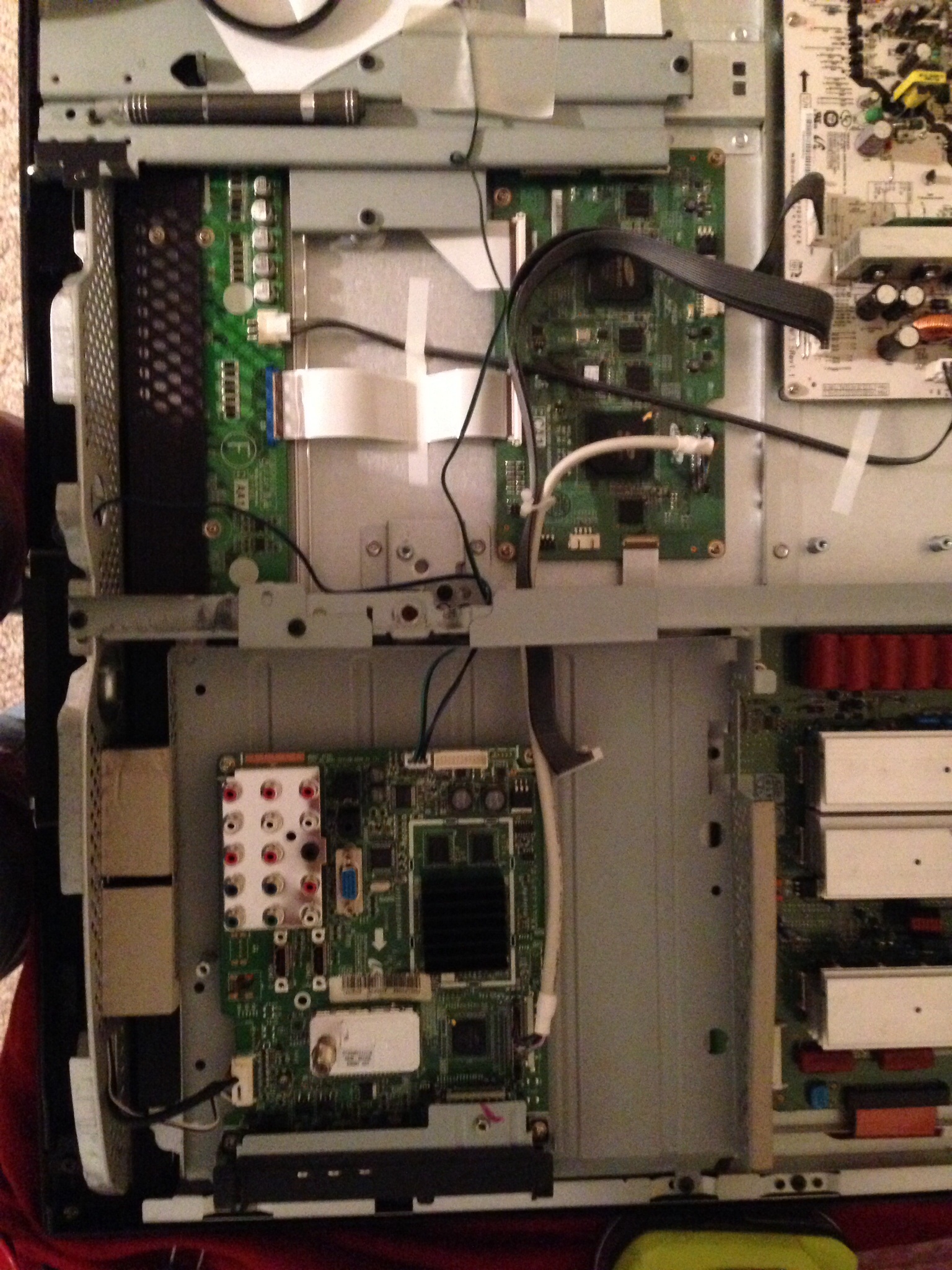

                                  OK. I found the connector and legend on the power supply board. But it doesn't go to what I thought was the "main" board, so a clarification is needed please.
                                  Here Is a pic of the 2 boards in question. The cable with the PS-ON etc goes to the board directly beneath the power supply.
                                  Guide me oh Sensei ...
                                  • EsqzMe
                                    • Sep 2013
                                    • 56

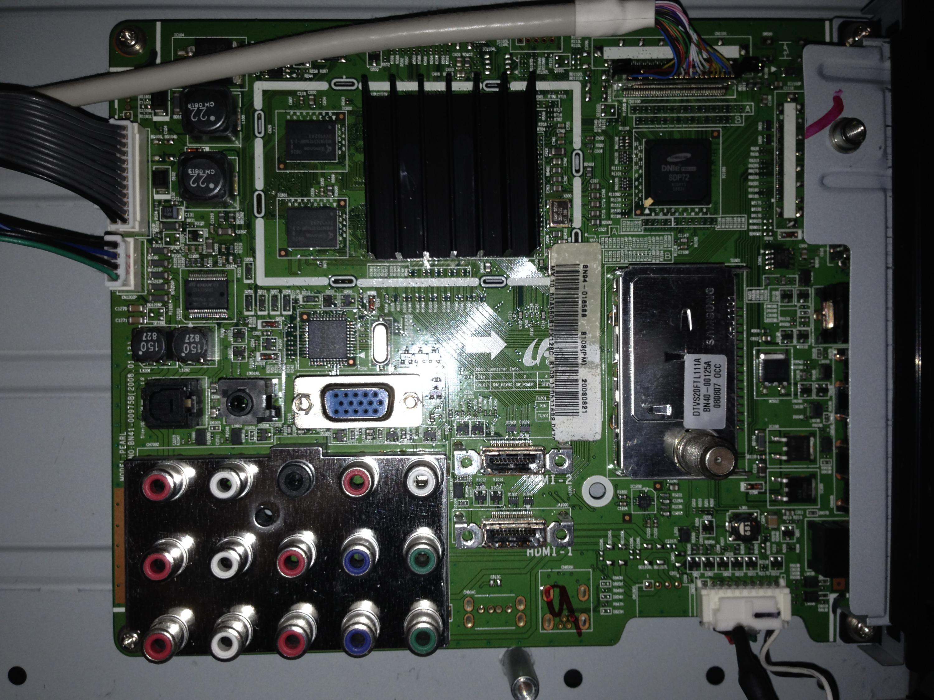

                                    My iPad only loads one pic at a time...very frustrating. Here are the 2 boards in question. Which is the main and what is the other called
                                      The main is the one with video inputs on it.
                                      The control/logic has the test pattern jumper on it.
