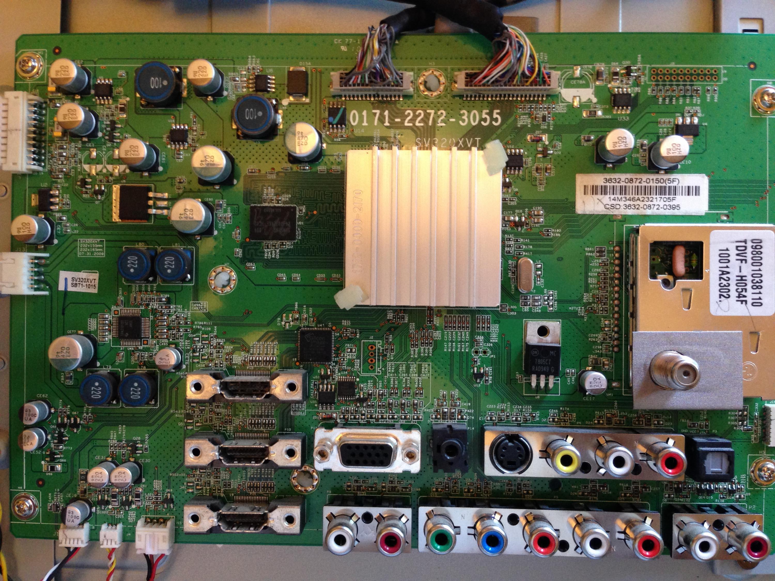

Vizio SV370XVT, no picture, will not turn off
  • jacksonjoe
    • Sep 2013
    • 3
    My Vizio SV370XVT will not turn off, has no picture or sound. The front logo remains lit white anytime the television is plugged in. There is no obvious visual damage of any capacitors. I have verified continuity of both fuses. There is voltage at both fuses; 5.16V on F1 and 11.92V on F2. My knowledge of regulators is limited to what I've learned on this board in the last couple of days, but they appear to be good. The voltages for the regulators are listed below. Any advice?
    U2
    L501
    G1117
    Pin1 2.082
    Pin2 3.322
    Pin3 5.14
    U4
    L501
    G1117
    Pin1 1.5mV
    Pin2 1.241
    Pin3 3.396
    U9
    L502
    G1084
    Pin1 0.557
    Pin2 1.81
    Pin3 3.405
    U8
    7805CT
    RAD949G
    Pin1 11.91
    Pin2 1.3mV
    Pin3 5.00
