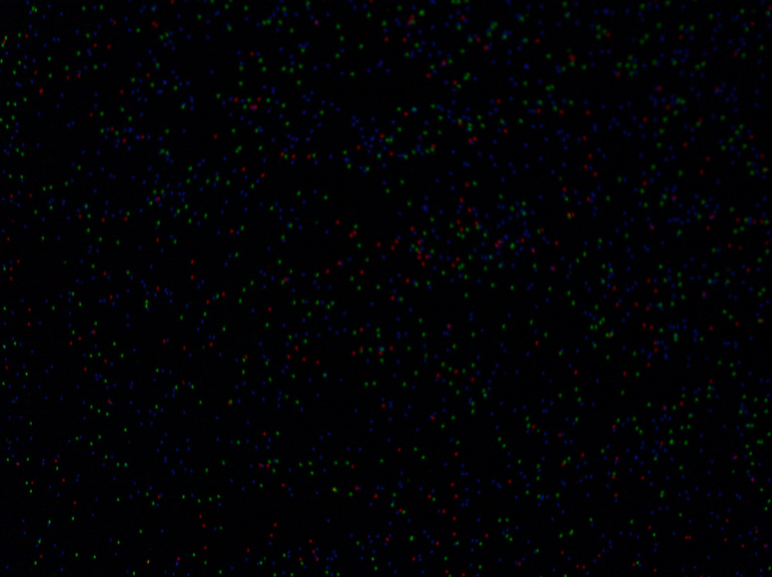

    My Hitachi P50S602 plasma powers on with that familiar white snow static then powers off after a few seconds and the power indicator blue light blinks five times & repeats. All the capacitors and resistors look fine. The fans also turn on and Vs & Va voltages are correct for the few seconds that it has power. When I unplug XSUS from the PSU, the tv does not power on at all and the blue light blinks 3 times. The only fuse I've found (on PSU) is good.

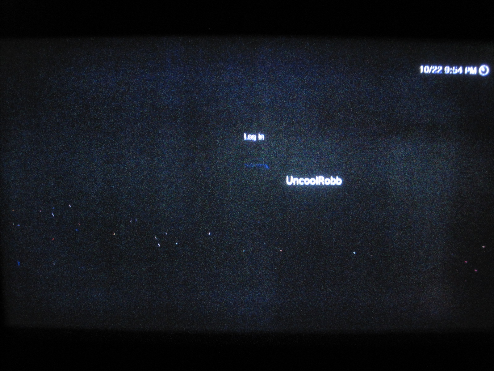

                Re: Hitachi P50S602 Powers On/Off Blue Light Blinks 5 Times
                Below is a picture of what the panel looks like for the three seconds before the TV shuts itself off.
                  Looks like PDP maldischarge could be Y-sus fault.

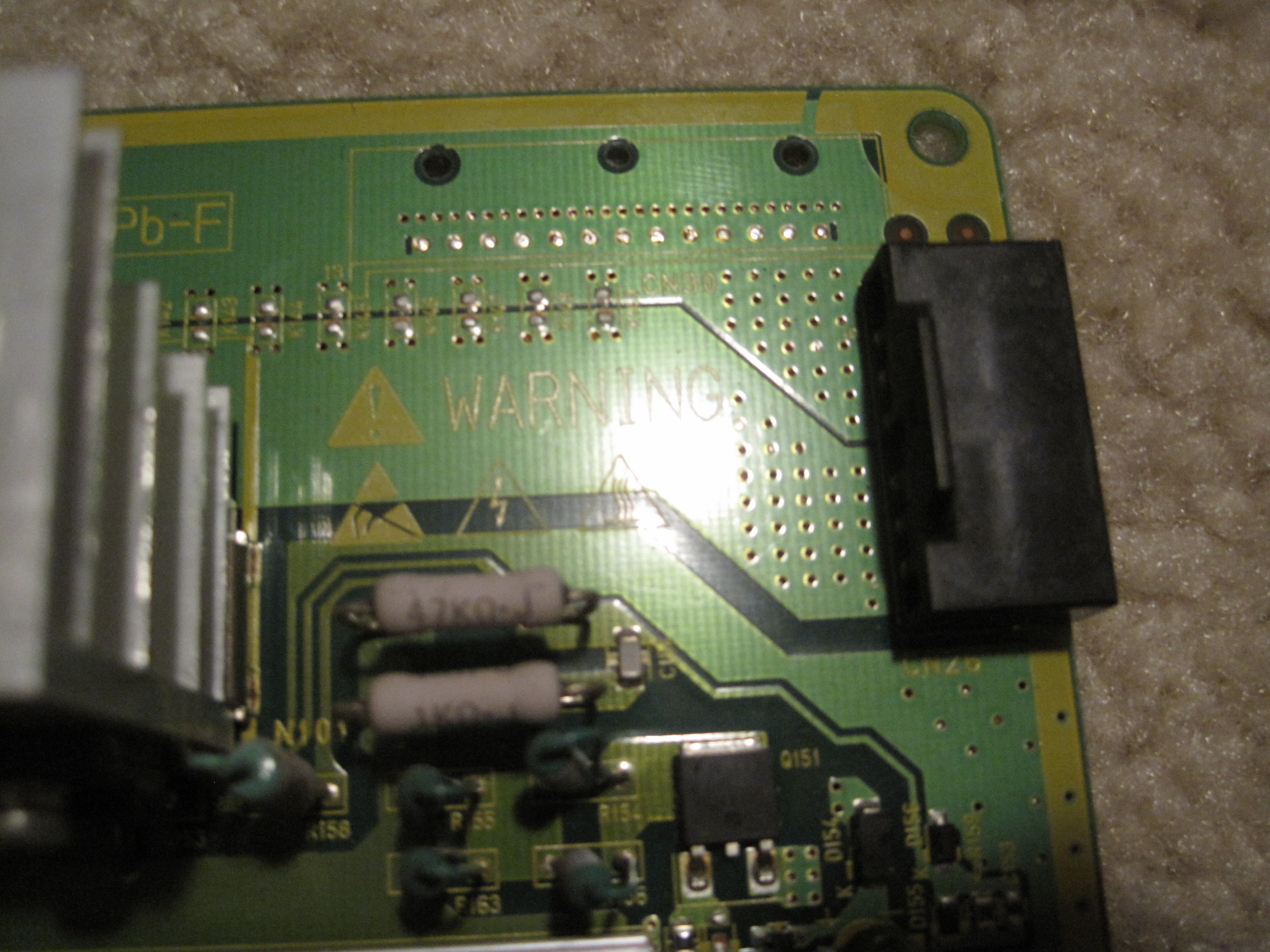

                    Hmm, according to the service manual (p. 27), the five blue led blinks indicates 1) ADM, ABUS 2) XSUS, Logic, PSU.
                    Unfortunately, I don't think this model &/or brand accommodates the remove the Y-sus and see if it powers on correctly method of diagnosis. If I disconnect the Y-sus power, the blue led blinks three times & the screen displays nothing & the fans don't spin for the usual three secs before it shuts down.
                    I guess I should start testing the components on the boards soon. Do you know what components usually go bad on Y-sus & X-sus boards?

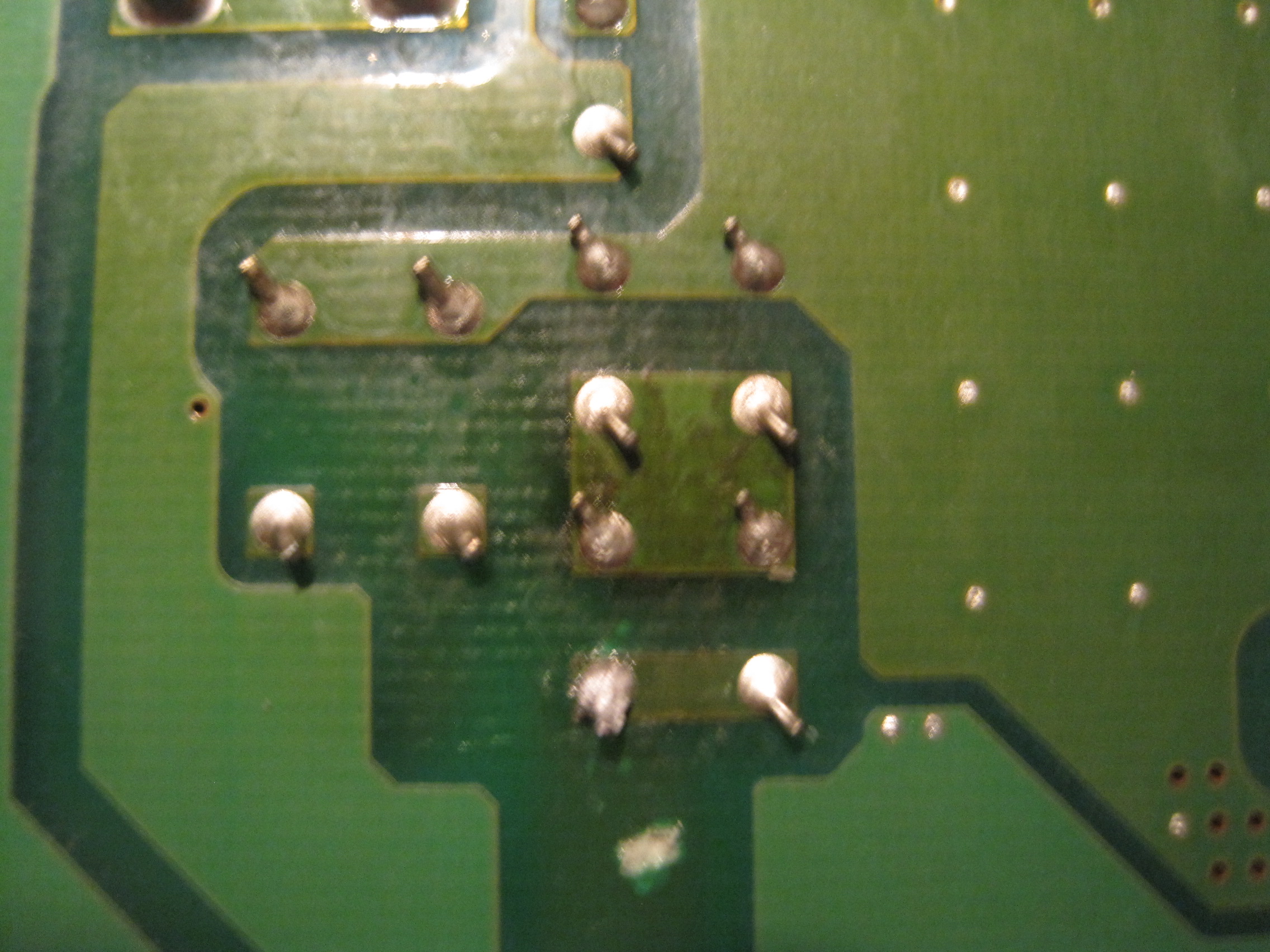

                    I'm not sure if this is important, but there is a burnt smell & slight discoloration on the underside of the X-sus around the R154, R155, R156 & R163 resistors (see pics), however, they all have the same ohm reading in circuit & one measured correctly out of circuit.

                                I know I'm grasping at straws but I found another anomaly. There are three HDMI ports and I plugged a playstation into all of them to see if anything would happen. Two ports did nothing new, just the usual power on with multcolored maldischarge. However, one port produced a partial image (see below). Could this mean there is an issue with the Main Board?
                                  It probably indicates the TV was originally set to that HDMI port and that bright image information can be displayed. I would be thinking more Y-SUS than X-SUS in this case but I'm not certain.
