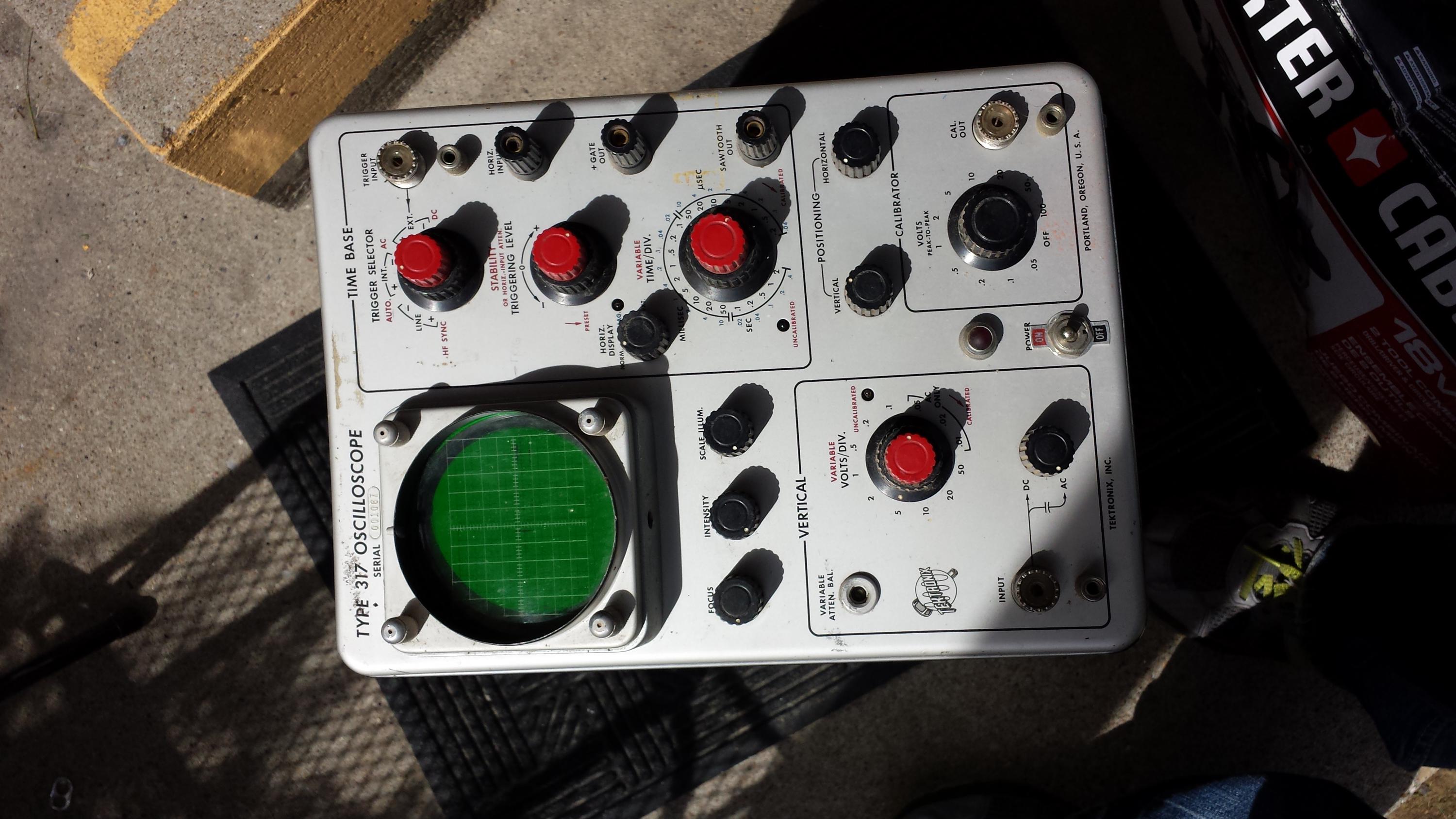

        I got a response to a craigslist post asking for an oscilloscope for sale and someone's got a Type 317 Oscilloscope. Anyone have any idea if this would work to test plasma TV boards? It sure looks cool but I think it's only a 10mhz scope.
          Re: Hitachi P50S602 Powers On/Off Blue Light Blinks 5 Times
          Not really worth it for any more than $15. Would be difficult to get the probes for it due to non BNC connectors, etc.

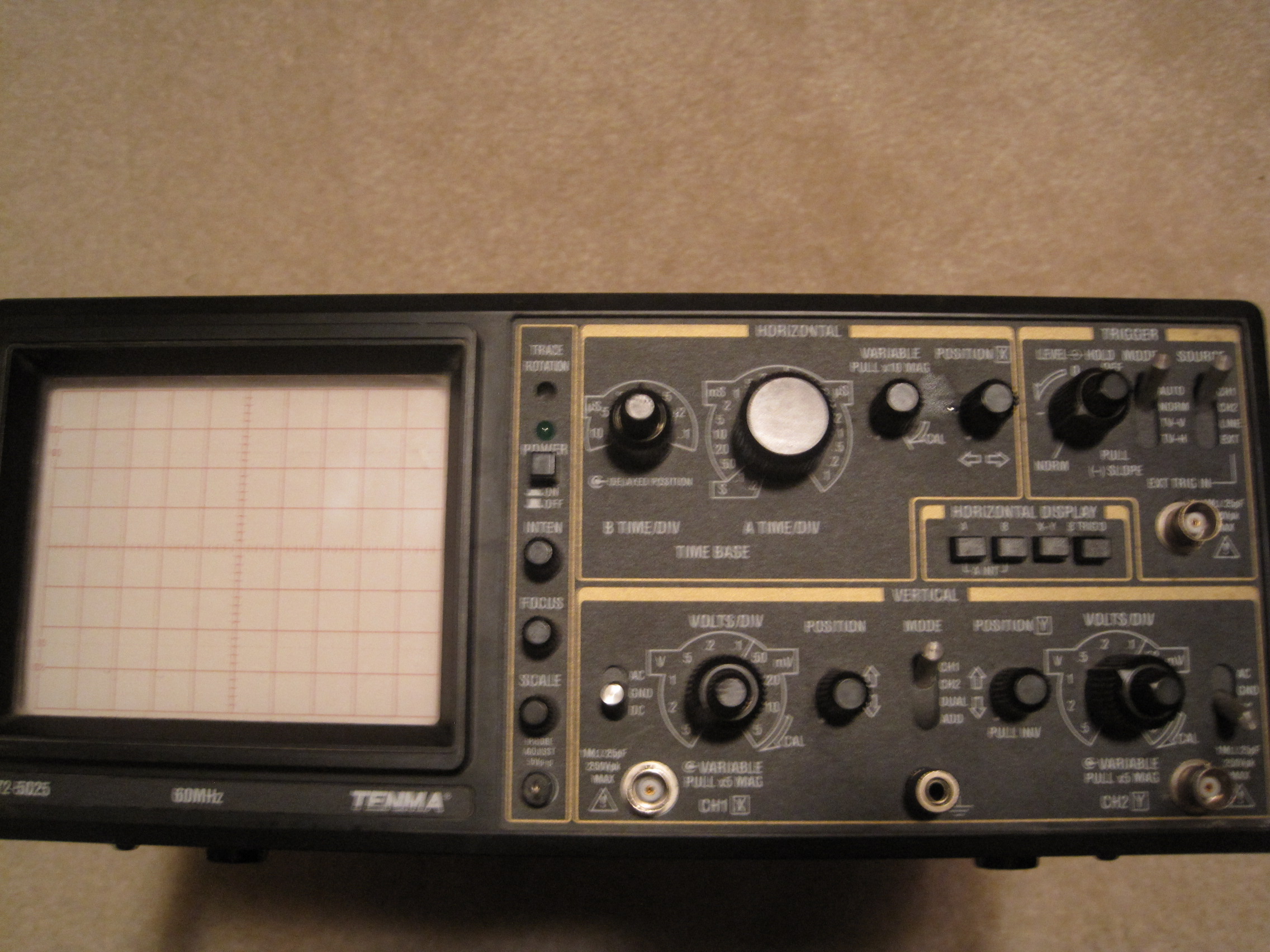

              60MHz is fine. Dual channel? Tenma is just a rebadge, but most rebadge scopes are fine.
              When you buy a scope, bring a probe with you or ask to borrow one. Hook the probe off the CAL TEST point and you should get a good clear square wave when on about 1ms/div, 500mV/div, DC coupling, norm trigger.
              Line and TV triggers are extremely useful for plasmas, so if this scope has them, then even better.

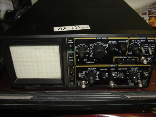

                According to the photo below it looks like there are Auto, Norm and 2 TV Mode Triggers and Ch1, Ch2, Line and some other Source Triggers. I just hope the guy answers my email.
                  Looks decent, as long as it works, will be good for you.

                    Thank you, tom66, for motivating me into getting an Oscilloscope. I contacted the guy with the scope. He wants $40 and I'm going to get it tomorrow, hopefully. Is there anything I should brush up on in the meantime, i.e. video tutorials, "How to test components with an oscilloscope" tutorial, etc.? I've found some but thought others might know better ones.
                      #30
                      Before you get it, ask to borrow a probe and hook it to the CAL output to test it (you should see a square wave), if the guy is worth his salt he can show you how to test it.

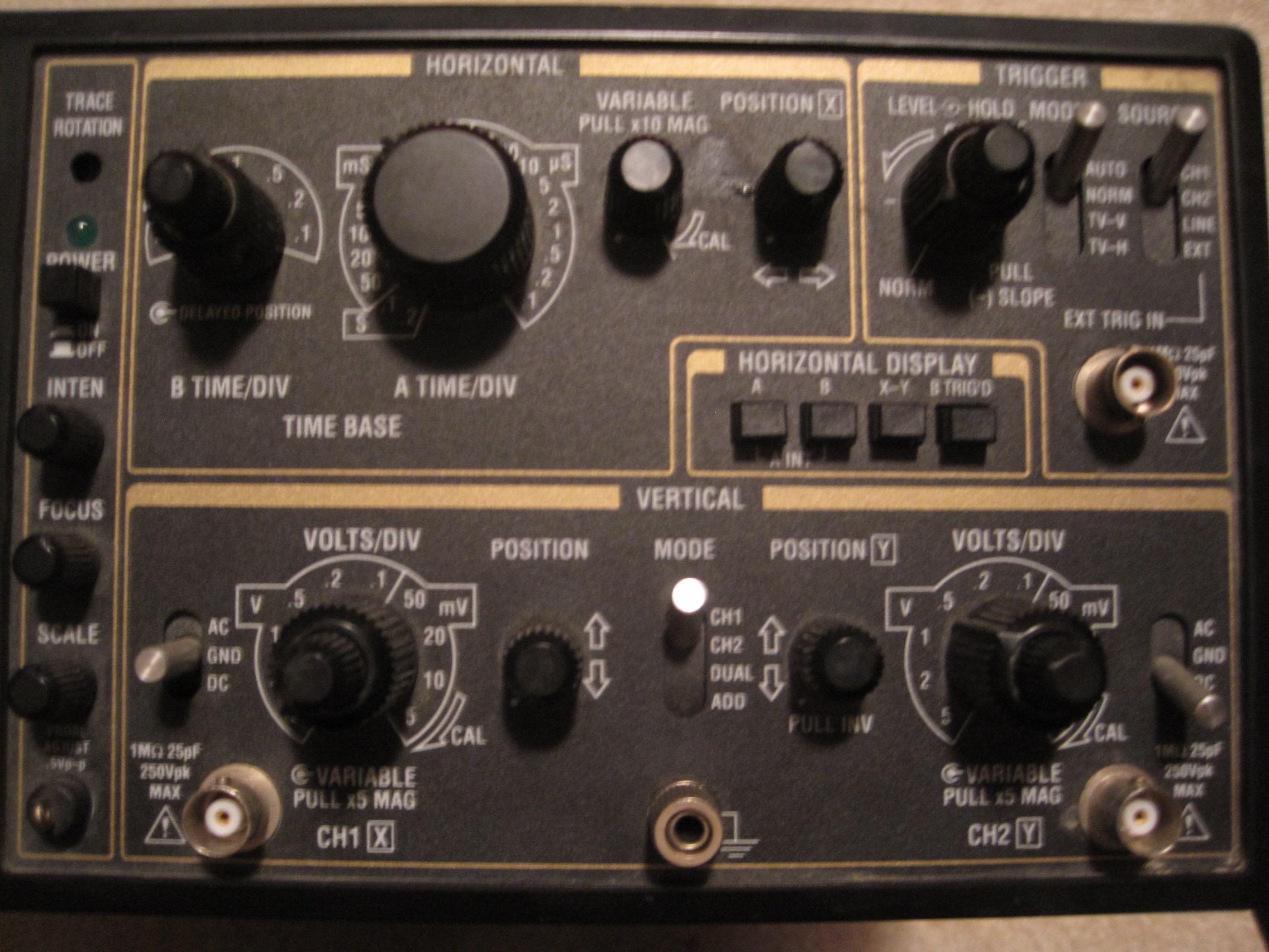

                                Got the oscilloscope. The guy didn't know anything about it and I couldn't find the Cal output. We played around with the dials while the probe was in Ch1 and were able to alter the signal on the monitor but that's it. I couldn't get a square wave and I'm only guessing that a square wave is a right angle.
                                I'm a little scared but it IS Halloween. I bought the scope anyway and I'm hoping it works. I haven't been able to find a service manual for it. I'm going to do some more research into how to use it.

                                  Your CAL output is the PROBE ADJUST point.

                                    OK. I had to play around a bit but I got a square wave |_| after touching the probe to the ADJ point
