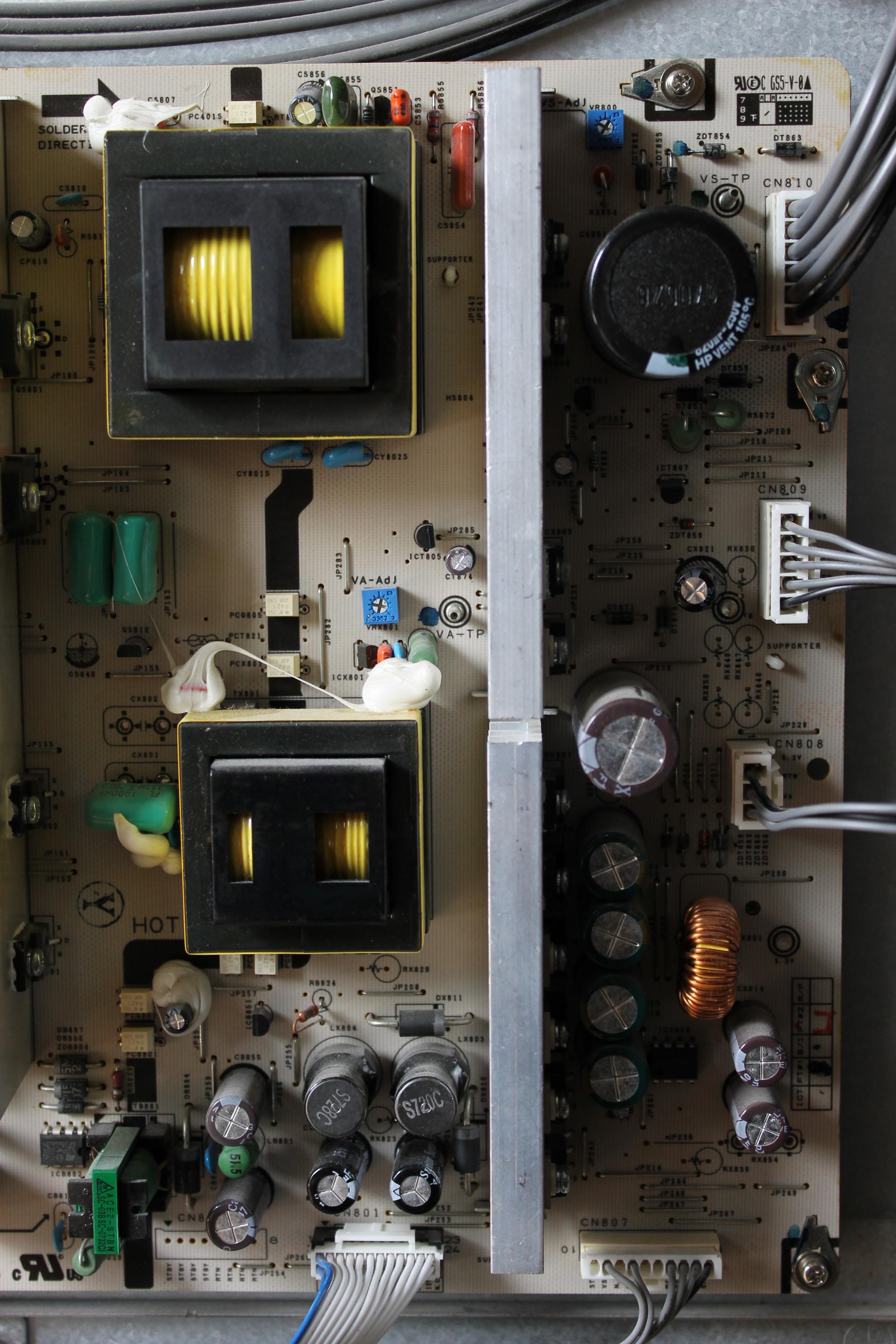

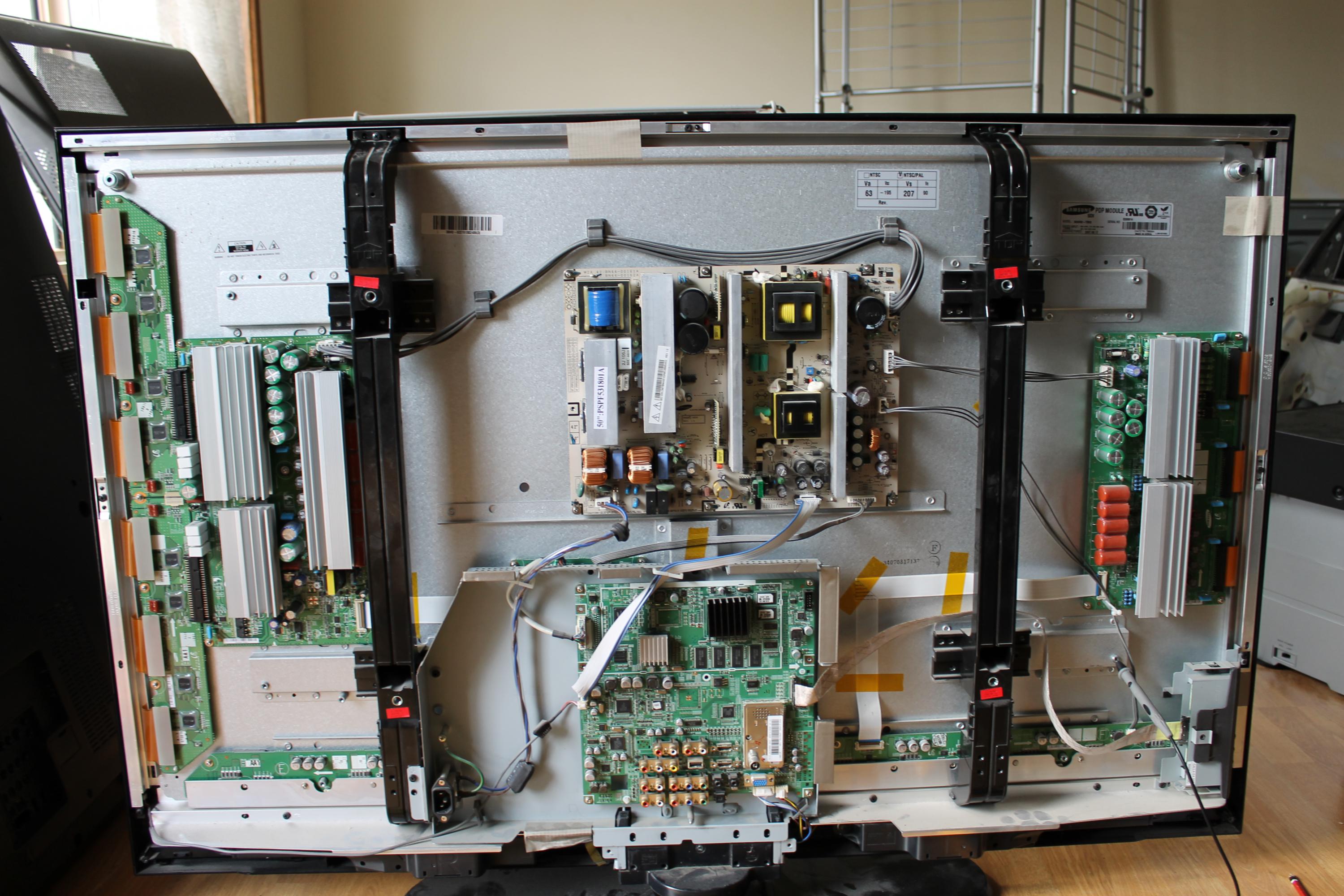

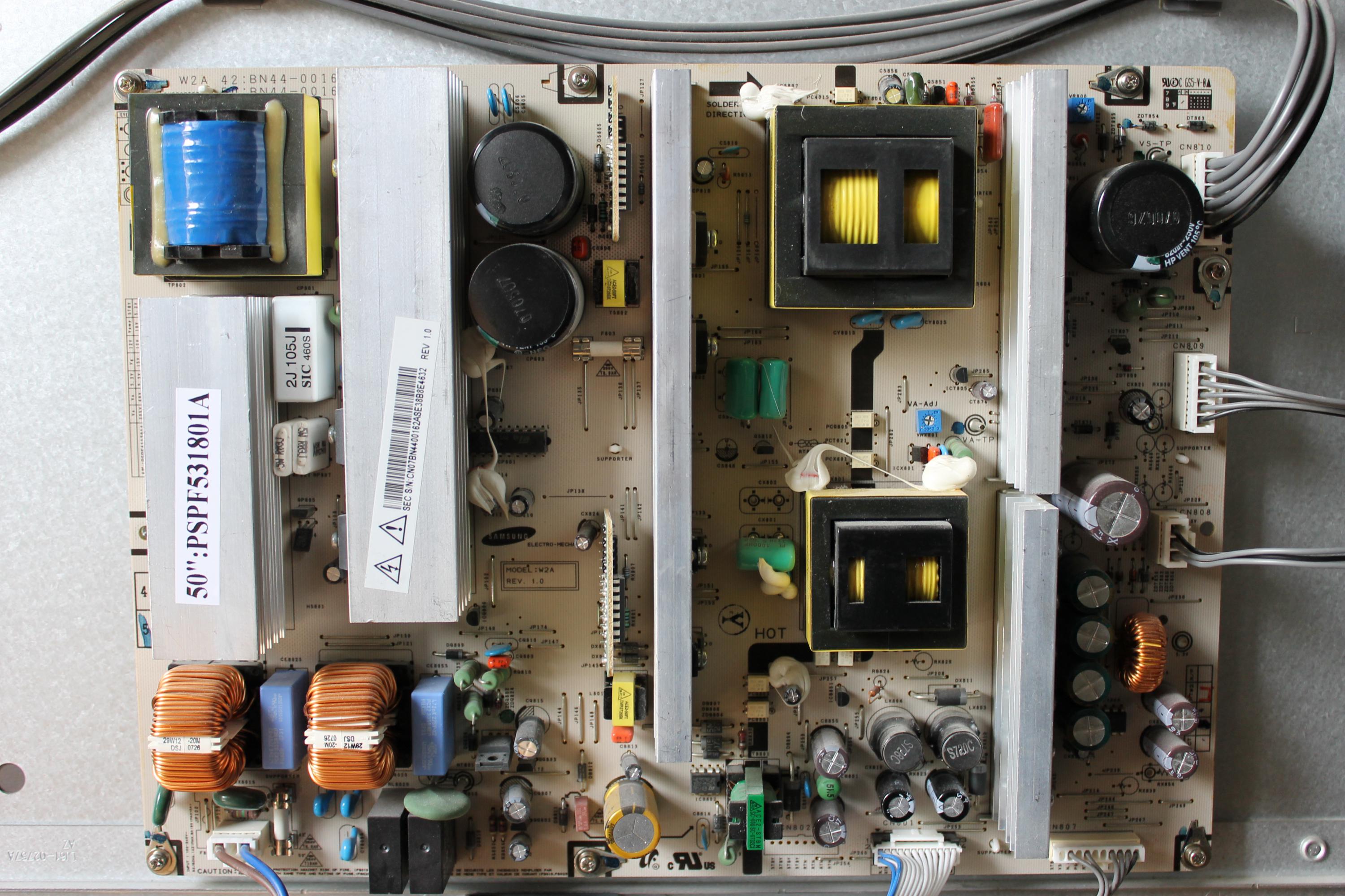

main voltages
sticker/have
va 63 62.7
vs 207 205.6
vsc -195 unsure of test point
ve 90 14.97
no screen glow at all

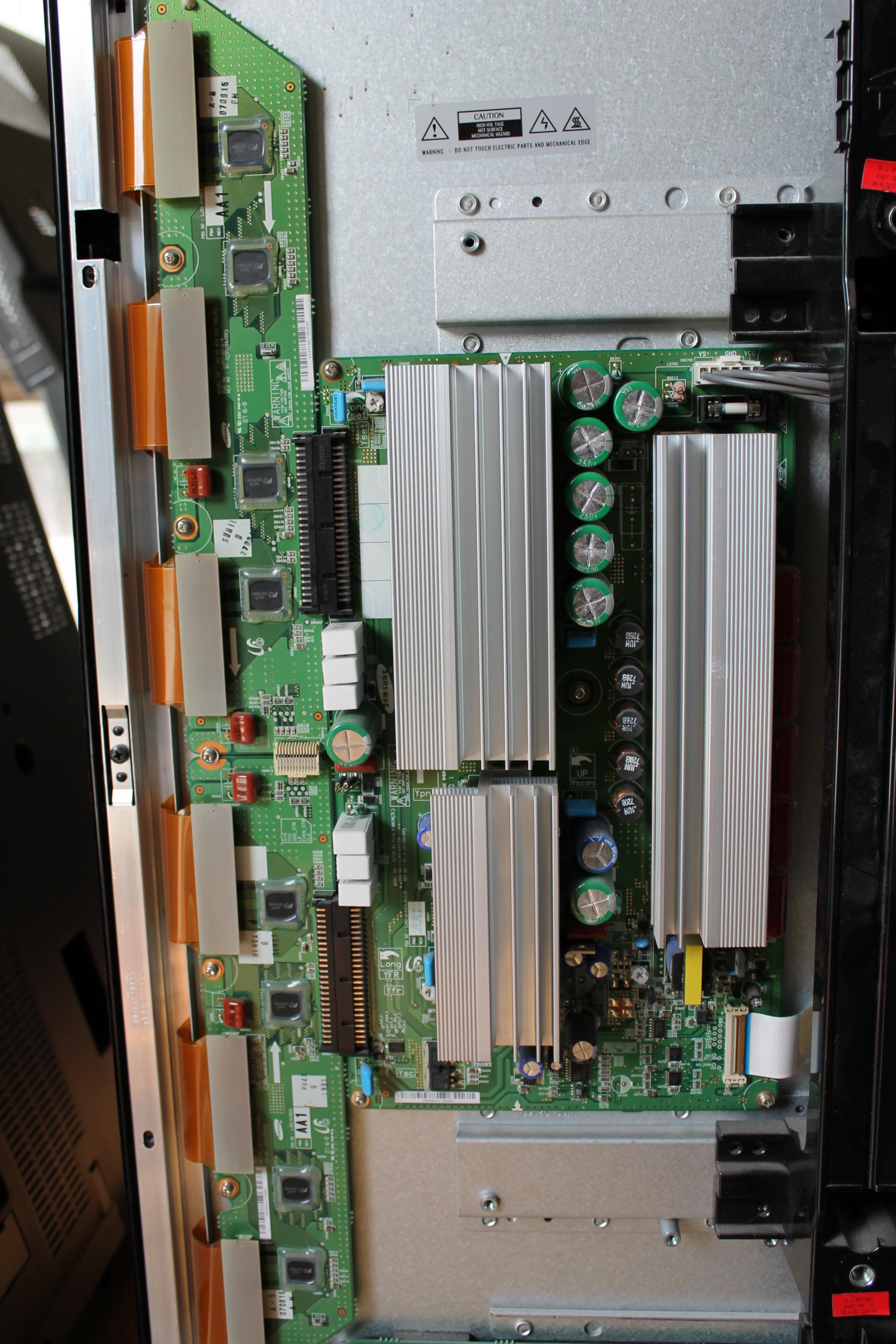

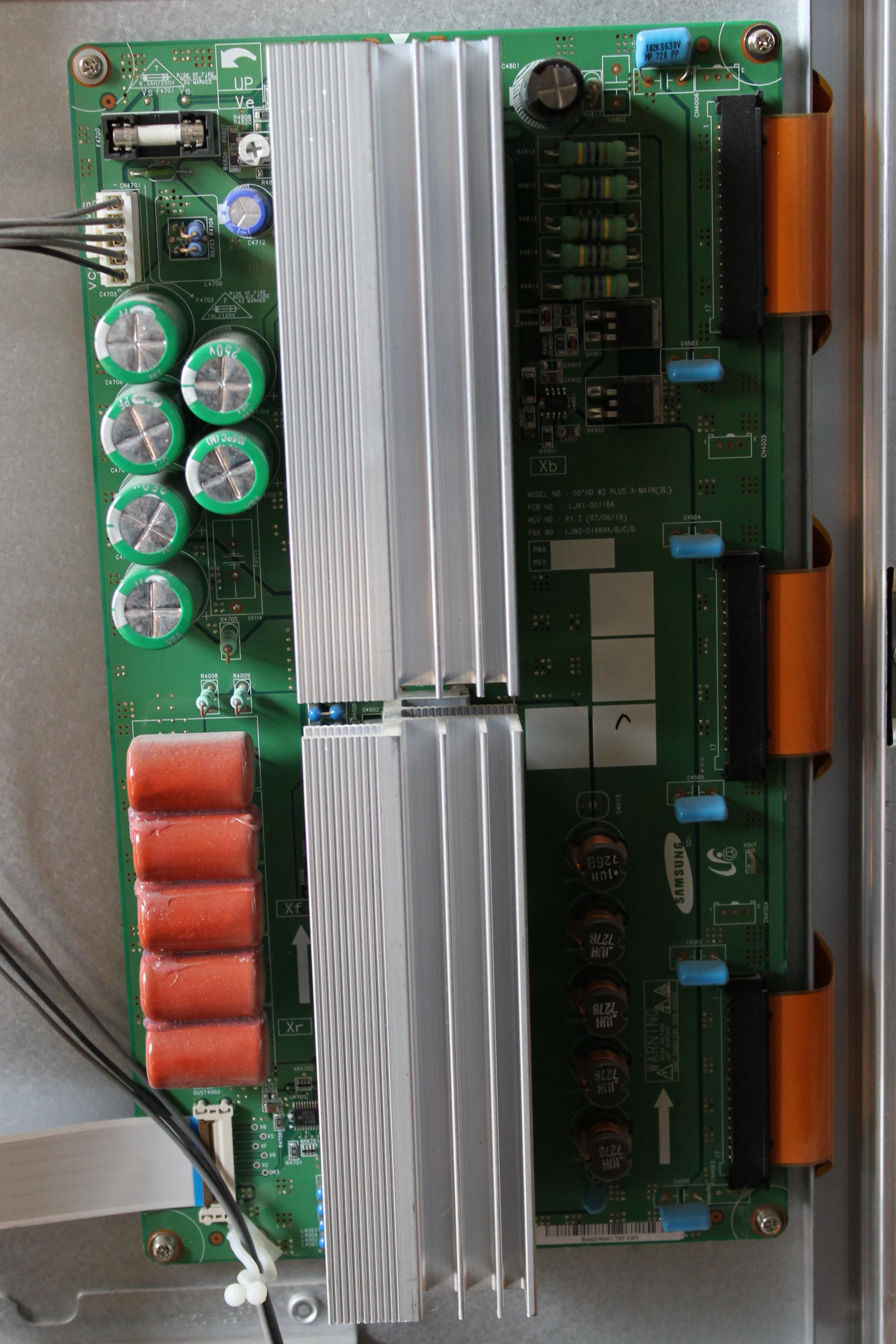

disconnected x main and no change to ve
disconnected y main and no change to ve
