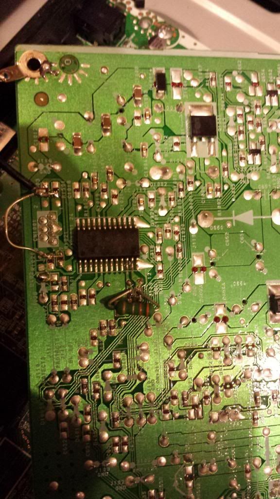

    Would bl_sw and bl_adj be the equivalent?

      Considering this hai 7209pc stellar reputation for failure is there a way to inject the voltages directly to the led strip and bypassing the constant current circuit? How about pin shorting on the ic? I have a feeling something is wrong with the ic

              Trying to get thus tv figured out still. I have consistent 45vdc going to the led strip center pin. The four outer pins are used for current sensing?

                well since this tv is so cheaply made and personally I really don't care I went a head and started doing some hack job mods. I took the current balancing pins which is essentially ground for the LED's and disconnected from the circuit and grounded them to the chassis. The LED still power up but I still have flickering. So now I'm trying to find a good 45 volt source of the power supply to apply the positive for the LED's direct anyone have any ideas?

                  and my hack job appeared to work! Full brightness beautiful picture anyone wants to know how it was done I took a .33ohm resistor and put it across two pins. 10 and 11 off the hai 7209pc ic disabling the current sensing on the ic. Also removed a smd capacitor and resistor from the circuit but its not nessecary.
                  Heres the pic
                  http://i845.photobucket.com/albums/a...psb8978d1d.jpg

                    Better pic

                      Is it normal for the led strip ti get nice and toasty under full illuminaton?
