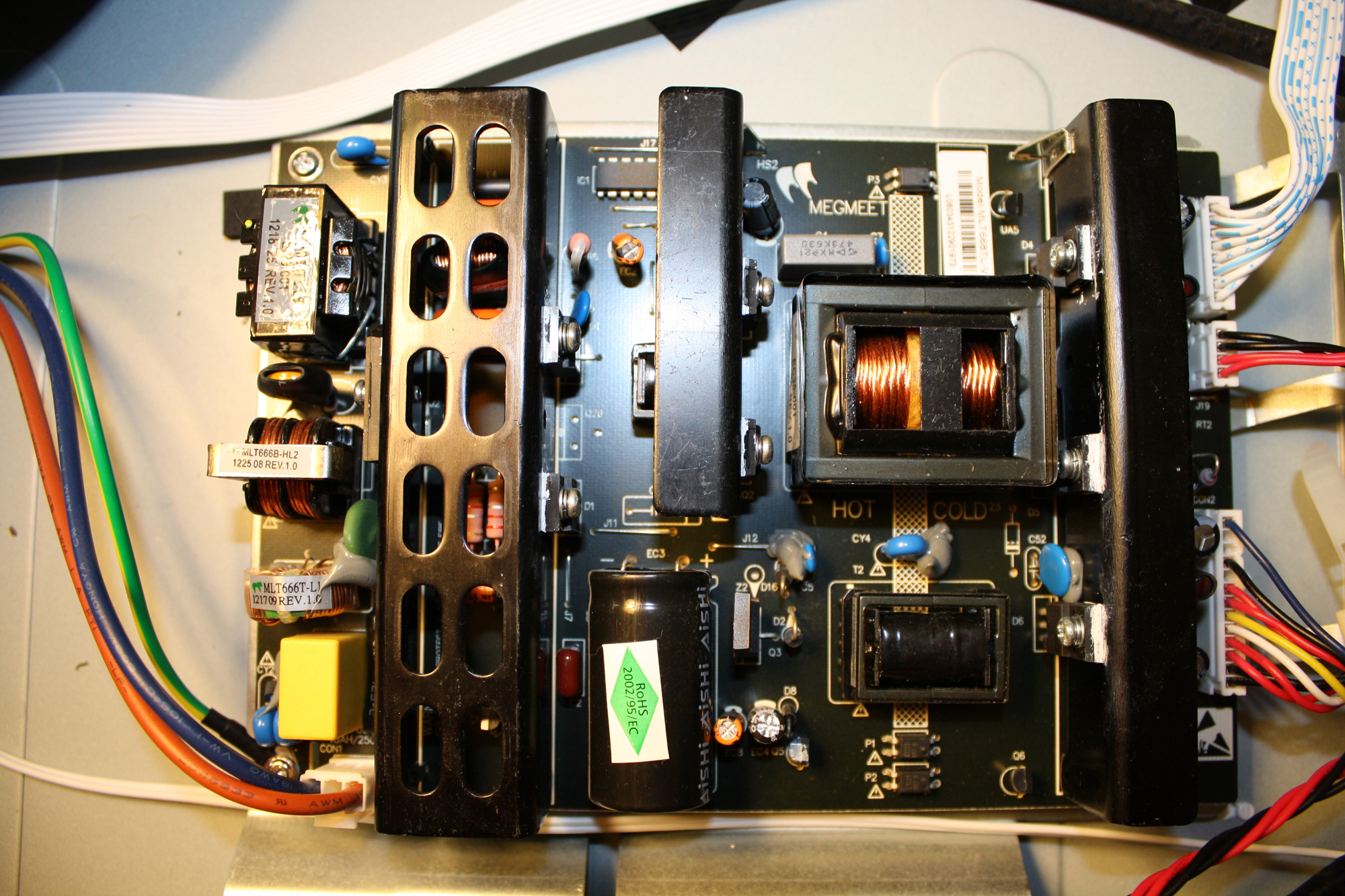

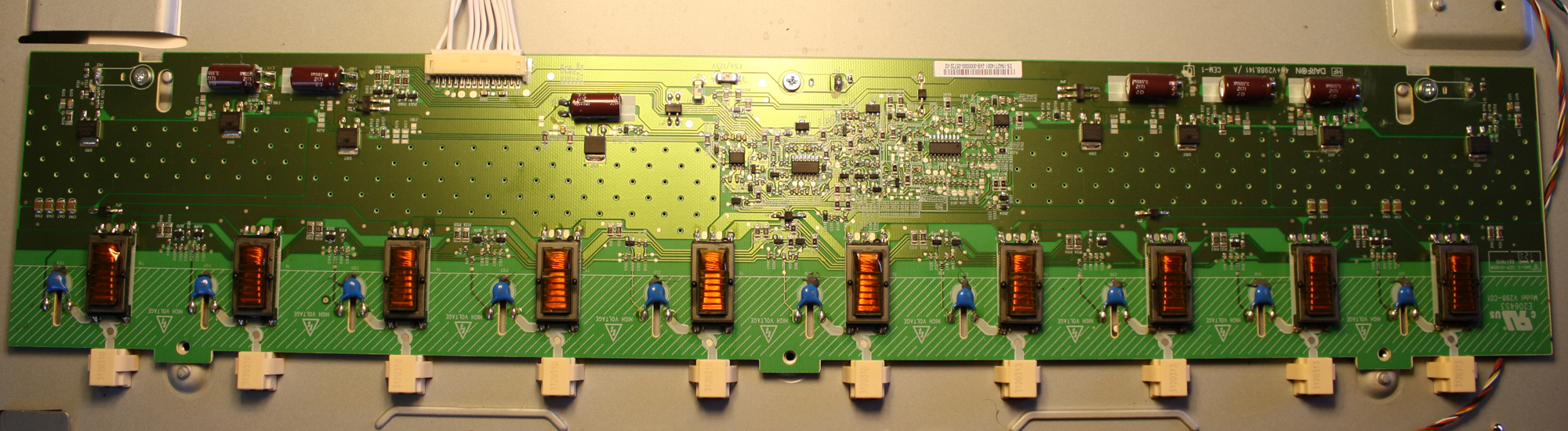

            Checked all the caps on the power supply, and inverter board. (Except the surface mounts).
            Loving the ESR70 by the way.
            I have 5v and 12v and 24v on the power supply.
            I have 3.3 1.2 1.8 5.1 on the main board. Regulators appear to be ok.

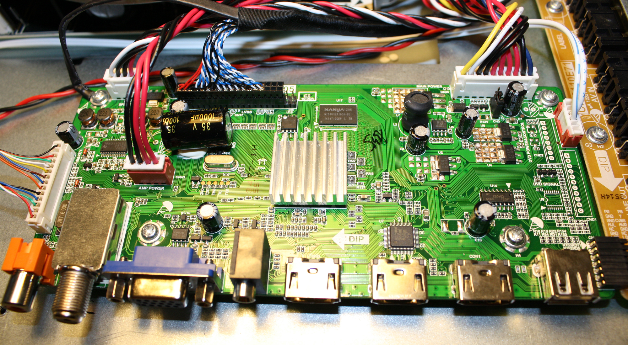

            Shouldn't the main board be supplying the turn on voltage for the inverter?
            Can someone explain how this works?
            I'm wondering if I just got a bad main board.
            Can anyone recommend what to look at next?

                There is BL_ON (backlights on) or sometime called INV_ON to turn on the backlights, it comes from the main board. You should look at the inverter board pin out. Post good clear pictures if the inverter board and the area around the connector. Main board also sends out Dimming control signal for backlights dimming. Both of these signals are routed through the power supply board (this is done on most TV).

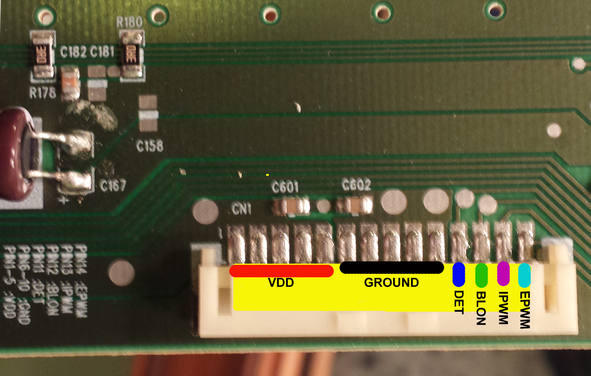

                  Heres a pic of the Inverter connection.
                  I am not sure what DET IPWM and EPWM are. I assume BLON is Back Light on.

                    Re: SCEPTRE x425bv-fhd NO video Powers Up
                    So when the TV is powered up, the BL_ON should be around 2~5vdc range for the ON signal.
                      Yes, 2.1 is what I get when I did get it to come up.
                      BLON is 2.1 when running.
                      EPWM is 5.1 when running.
                      In the current state:
                      BLON is 5.1
                      EPWN is 0.0

                        I might also add that the only connections other than the 24 v and ground are the BLON and EPWM.
                        Both these connections run to the main board.
                        If I unplug the connector on the main board I get backlights, but nothing else.
                          EPWN (External Pulse Width Modulation) is 0.0 that is not right, this is the Pulse-width-modulation dimming backlights brightness control, it is an AC signal around 200Hz with variable pulse width. What you can do is to disconnect this wire and see if the backlights will stay on.
                            Nope, Disconnected pin 14. No backlights. If I also disconnect pin 12, I get backlights.
                              That works in reverse then for the BL_ON, normally HI = on, LO = Off. But the bottom line is that if you do get the light source to stay on then you should see the pictures on the screen OK, no? Right now it points to bad main board.

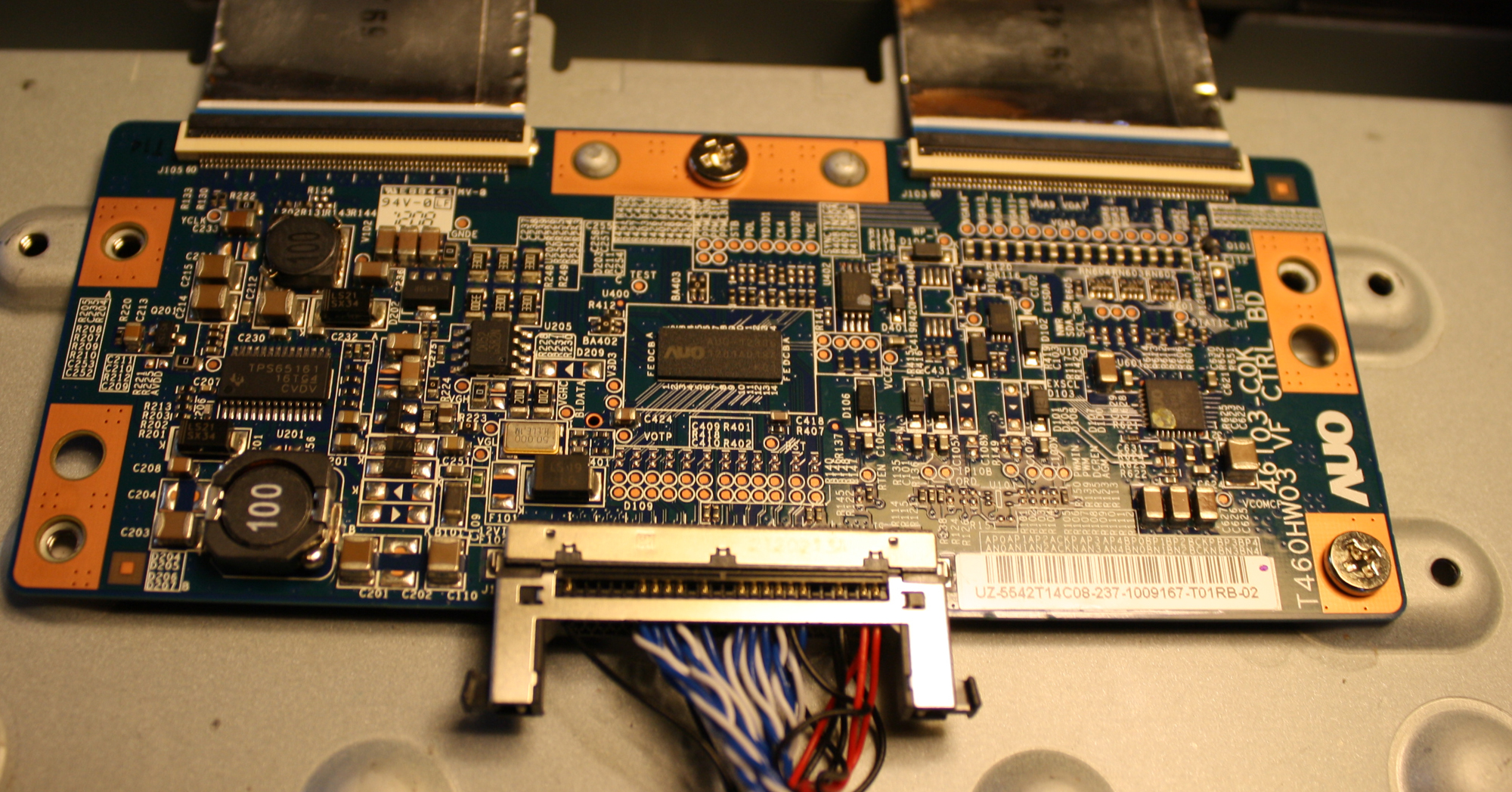

                                I do not have any power going to the tcon at all, the backlights don't come up, however all the voltages on the power supply are correct.
                                However, once in a great while, it will start up and I get video on the screen and power on the tcon board and everything works correctly, I can press the power button, and the tv will power off, but it only lasts a couple of minutes, then it goes back to what I have now.

                                  Ok, Thats what I thought on the main board. I have already replaced the main board, but I could have got a bad one I suppose.

                                        Just for a test, unplug the T-Con board and power the set on. Will it power off with the button then? I had a Sceptre X460BV with similar symptoms that turned out to have a faulty T-con board.
