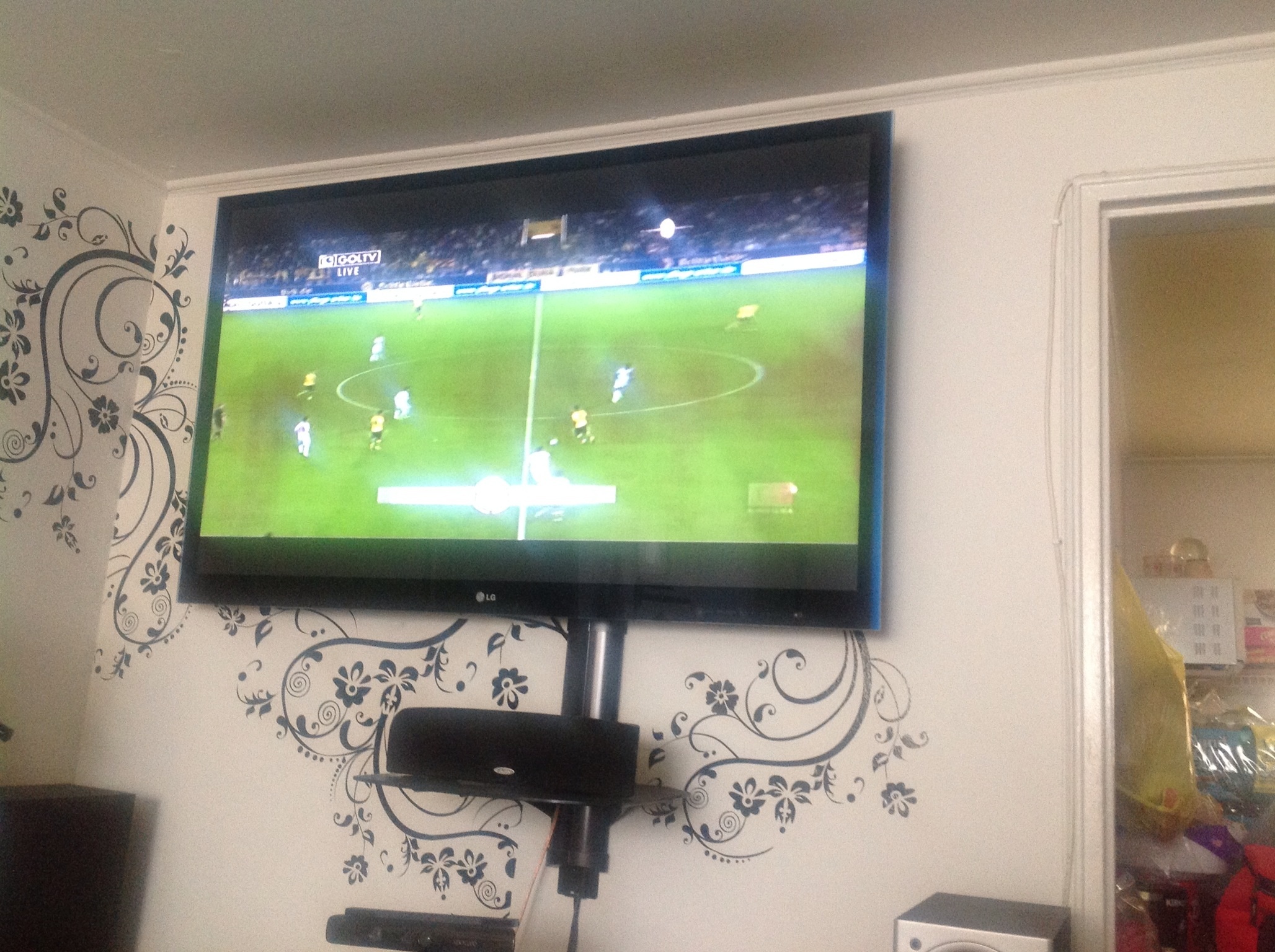

    Hello, I bought this TV in november of 2011. Few days ago I noticed a strange flickering burn in on the screen . I have one example in pictures and other in video. Please if anyone can help me with this issue. This is the link for the video
    http://m.youtube.com/watch?feature=c...e_gdata_player
    Thanks in advance

    Re: LG 60pz750. After year and a half strange burn in flickering
    My first suspicion would be the backlight. However the pattern is kinda weird for that.
    Getting the back off the TV and posting a good picture of the circuit boards might tell us more.
      This is a plasma - no back light. It could be a bad Y-Sustain, control board, or main board. You'll have to open it up to accurately diagnose the issue.
      LG Plasma Mal-Discharge Correction Service
        To me, it looks like the Vs or Ve voltages are low causing insufficient gas discharge.
          Another thing is that when I turn on the tv the image is fine but after few minutes it begins to do that weird thing. When i get the time ill put it down, that is a heavy beast
            When you do, take the cover off and give us some clear pictures to work with.

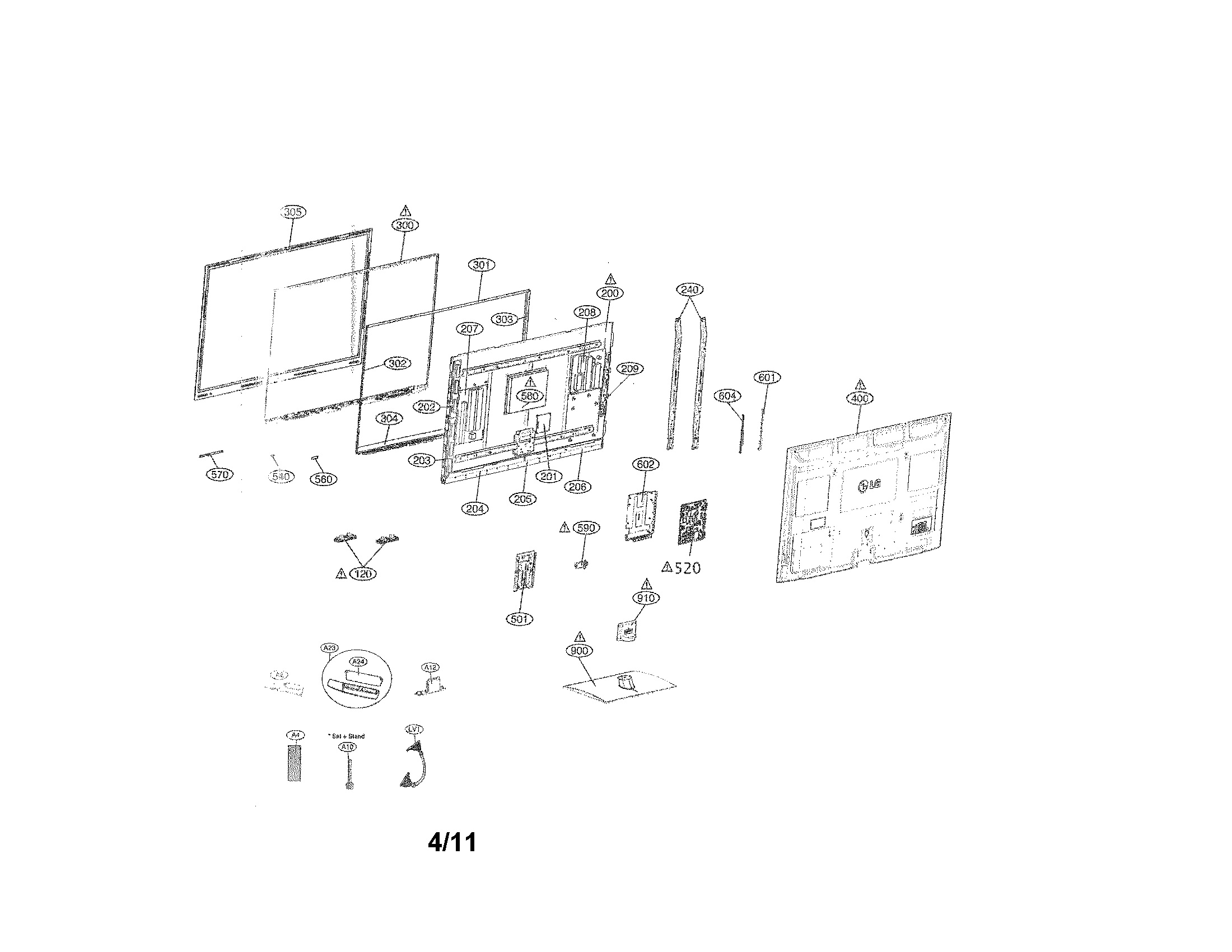

              Hello everyone, thanks for your replies. Before i opened the TV i tried with LG's costumer service and luckily they gave me and extended warranty . This is the tv diagram.
              First they replaced part 201 and the screen was the same, then they replaced part 207 and the tv got a little better and when they replaced part 208 the tv when back to its beautiful screen. Can someone explain me which components are they please?
              201 PART NUMBER: EBR67818201
              207 PART NUMBER: EBR71516301
              208 PART NUMBER: EBR67820001
              Thanks again for replying
                201: Control PCB
                207: Y-sus PCB
                208: Z-sus PCB
                So it looks like it was low Ve, as Z-sus on these generates Ve (LG call it Vzb/Vzbias.)

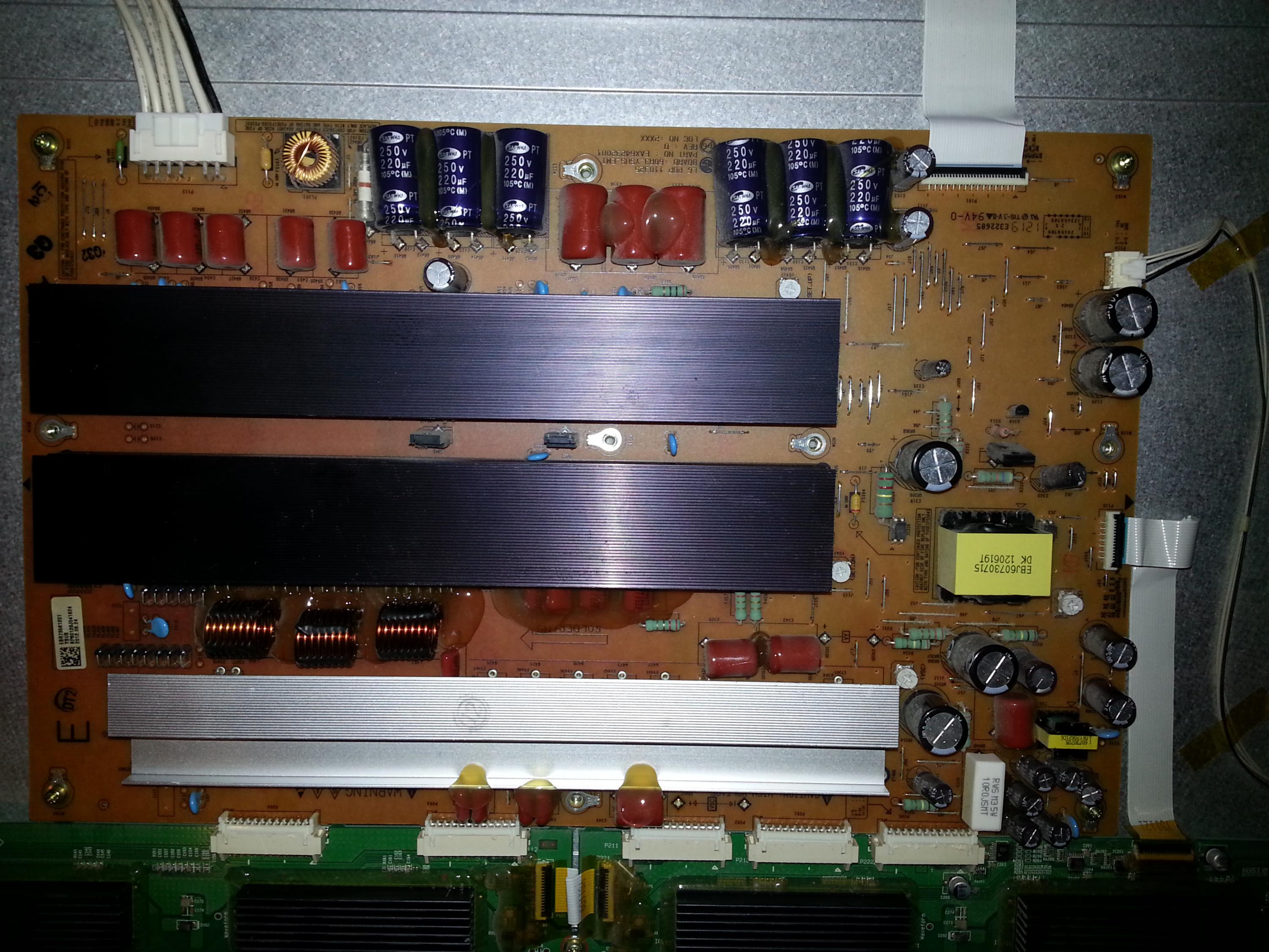

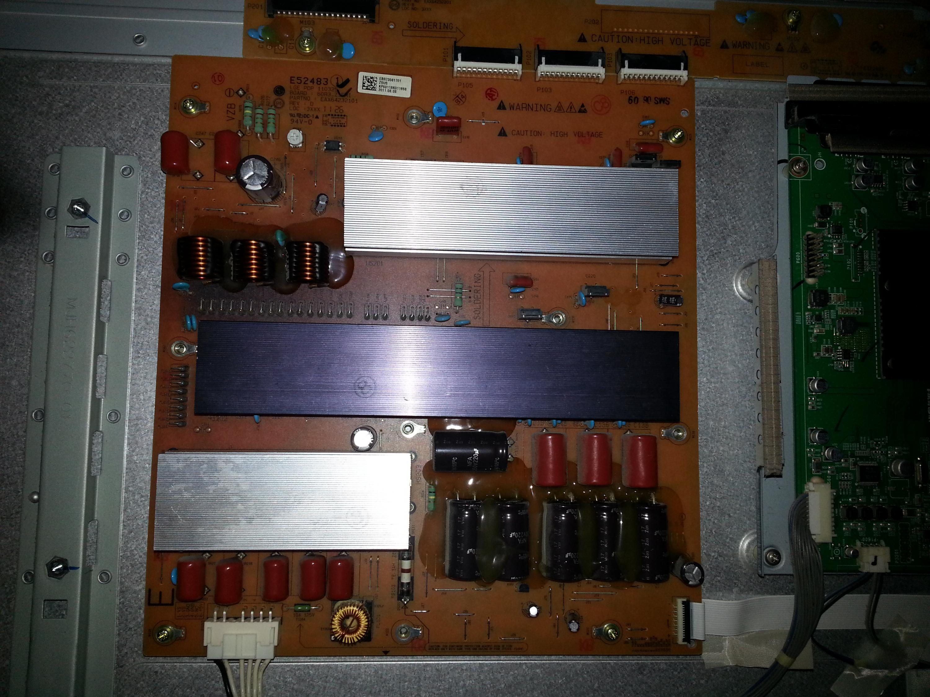

                                      Posting pictures of the back of your tv showing the boards with clear pictures may help you more with fixing your problem
                                      • ElctroNYC
                                        • Sep 2013
                                        • 20
                                        • Usa
                                        These are the pictures
                                        The first one is the 201 PART NUMBER: EBR67818201 and the second one is
                                        208 PART NUMBER: EBR67820001 . I think.
