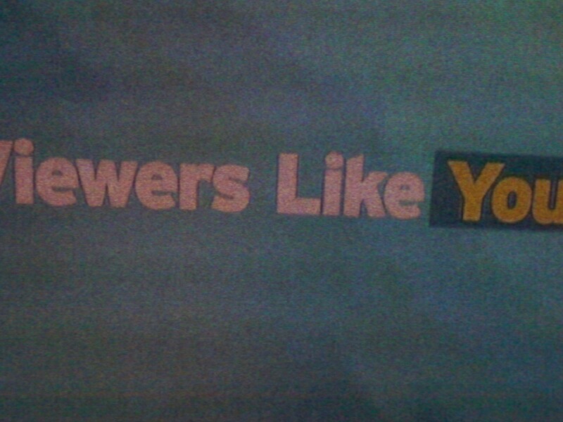

    plasma tv picture dull every thing else seems ok no lines
    light in rear marked error is on not blinking there is a blinking led
    1001 on logic board most people have error code 12 so i cant
    find something lick mine 2006 a found in trash tv hope to save it..

          replaced the xmain with a used one. pic not any better
          pic dull not bright looks like maybe not all pix are lit small white dots?
            Re: sanyo dp42746
            Can you provide a picture of the fault?

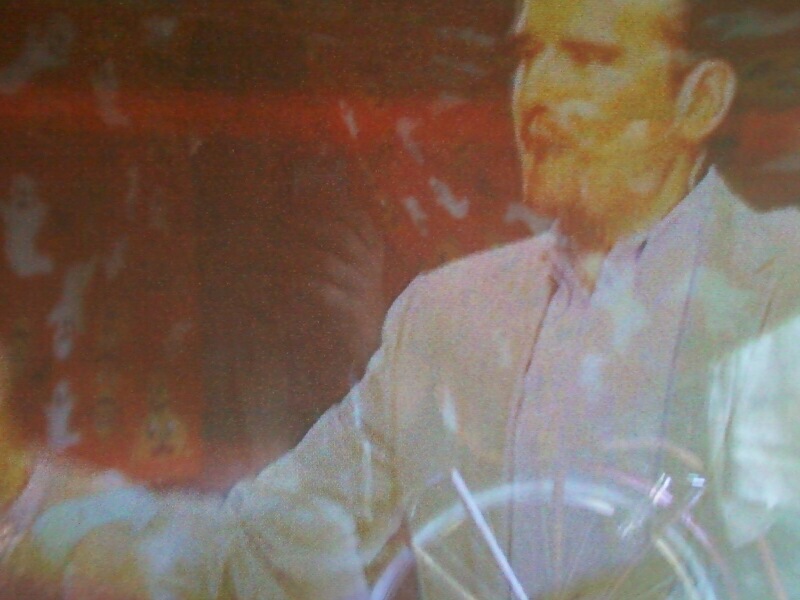

                Re: sanyo dp42746
                here is a better photo in the dark
                  Re: sanyo dp42746
                  See if adjusting the Yrr and Yfr controls on the Y-main helps, and check the Vs, Va, Vsc and Ve voltages are at or near the specification (within 2 volts.)

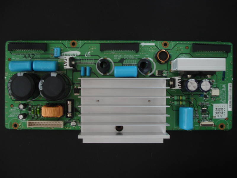

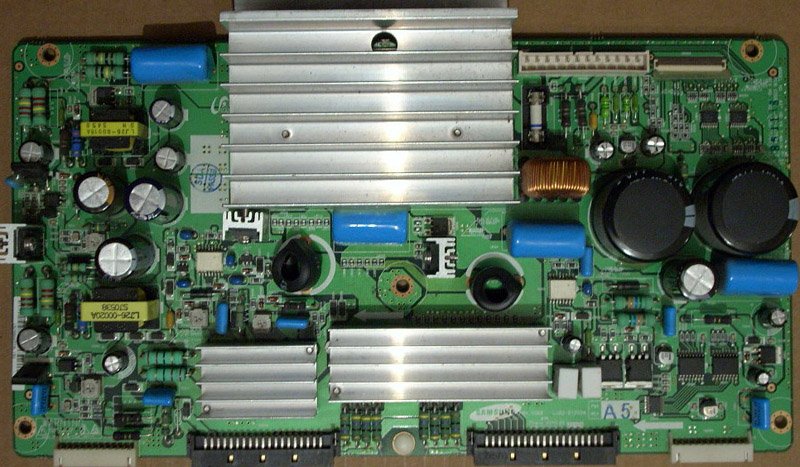

                      Re: sanyo dp42746
                      Can you provide a picture of your X- and Y-main boards?

                        Re: sanyo dp42746
                        here they are..

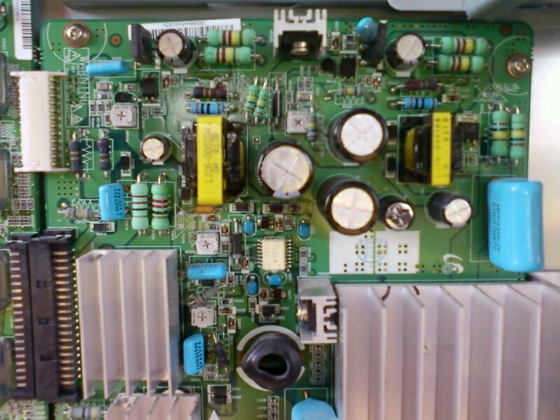

                          Re: sanyo dp42746
                          Any chance of a higher resolution picture, so I can see the text more clearly around the adjustment pots? Or just break the board into quarters and take individual shots.

                            Re: sanyo dp42746
                            there in the shape of letter Y bottom vr5001 vr5002 right vr5003 left vr5004

                              Re: sanyo dp42746
                              i cant get much better pic ive.changed some of the vr settings
                              and have much britter pic big improvement..
