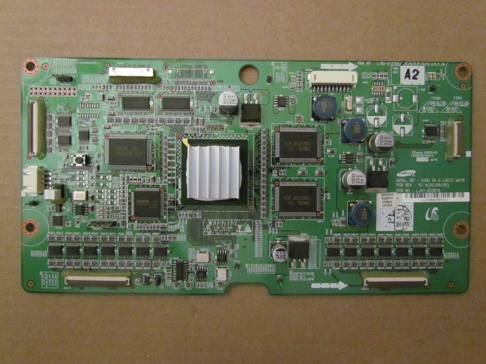

    im trying to also do a factory reset its on the remote to make the pic std instead
    of zoom which it is on. can these dip or jumpers help on logic bd..

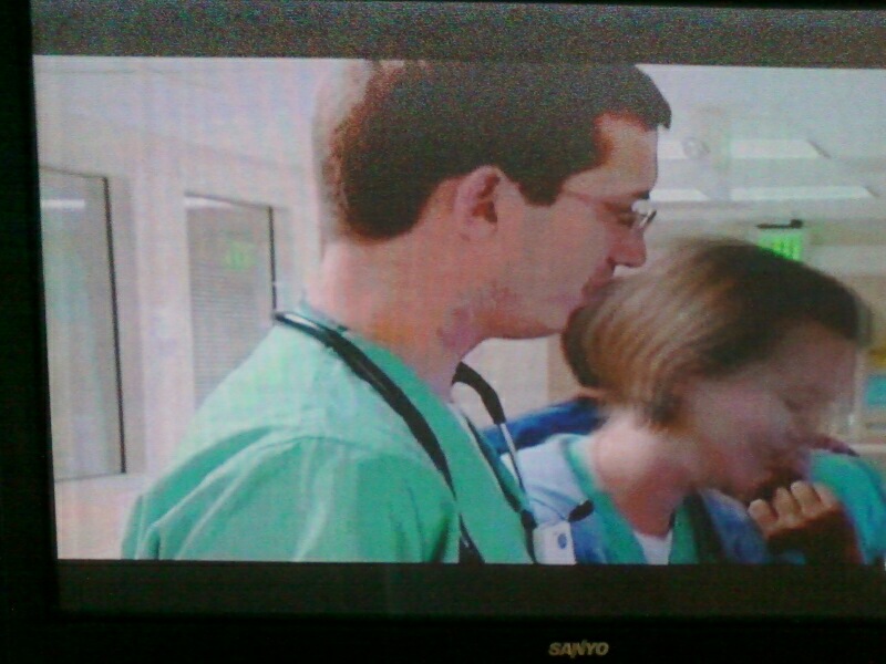

          Re: sanyo dp42746

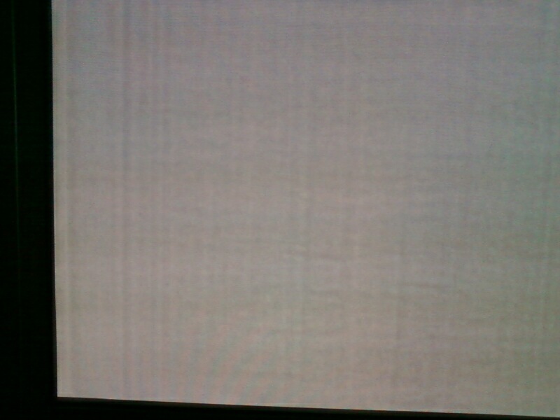

          i replaced x-main with a used one there was little change until
          i checked and corrected the voltage adj. this is current photo
          white screen 1 and 2 showes top black bar dim

            Re: sanyo dp42746
            i put the old one back in and no difference .. checked all conn.

              Re: sanyo dp42746
              still no luck try adjusting y board pots and recheck voltages one increases

                  Re: sanyo dp42746
                  still have shadows on some channels
