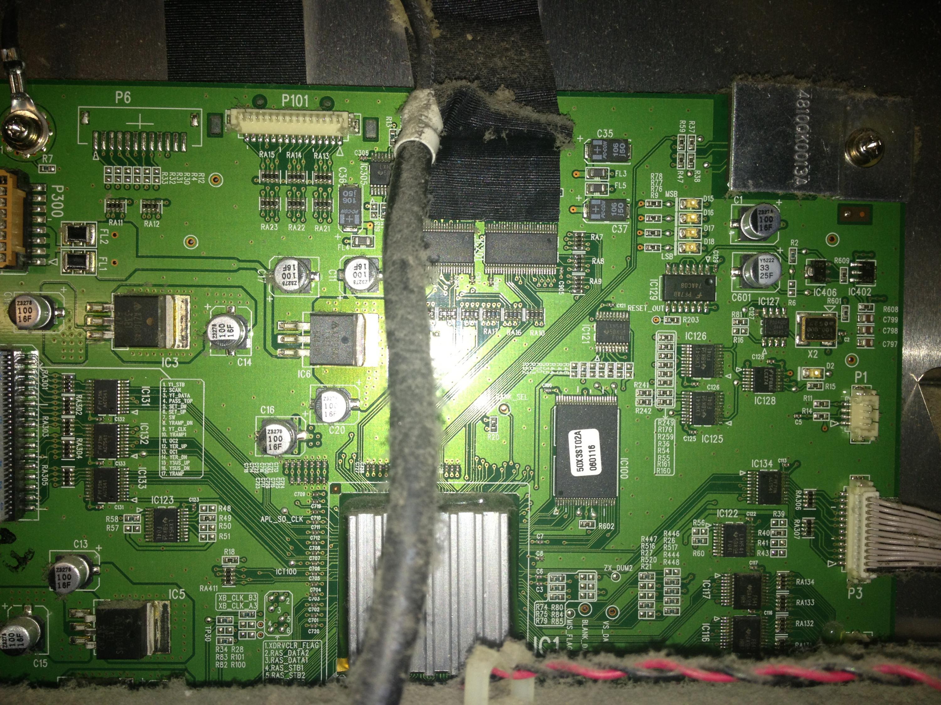

    took a quick video of symptoms... http://youtu.be/CwHbEXCOhFE
    D15 comes on
    D17 comes on
    D1 Comes on then shorts out and relay turns off
    Main board light stays on.
    I tried a few things from this forum...
    https://www.badcaps.net/forum/showthread.php?t=25596

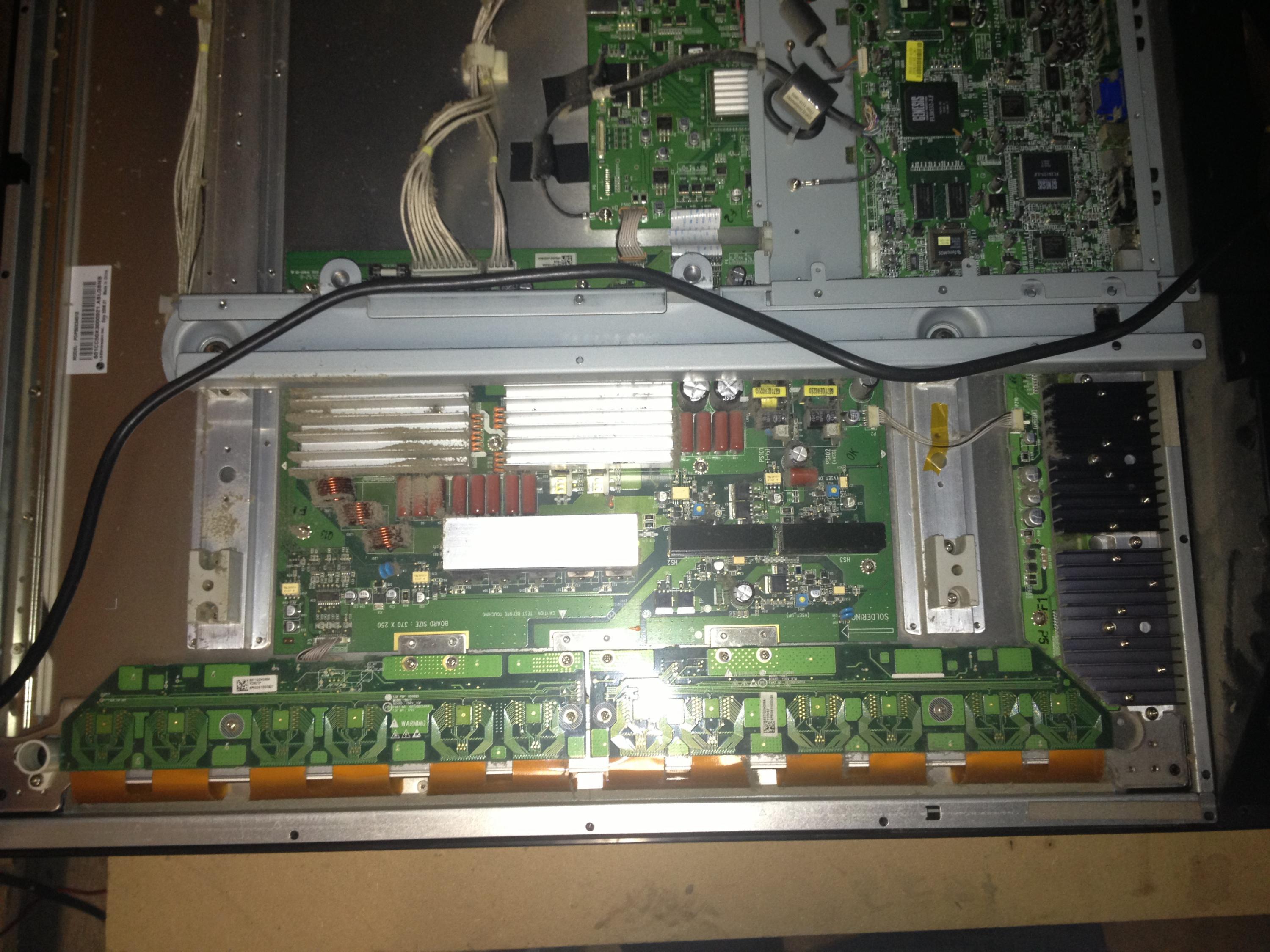

    no fuses were blown when I started.. now on Y-sus board fuse keeps blowing fuses... help?

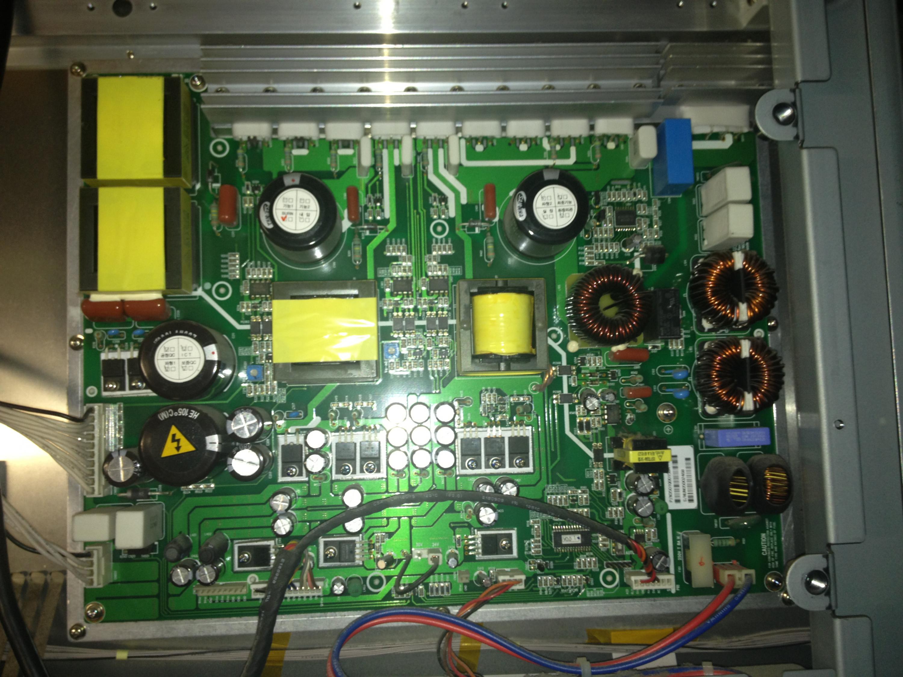

    it sounds like a short near the top left PSU near transformers... Thanks Guys...

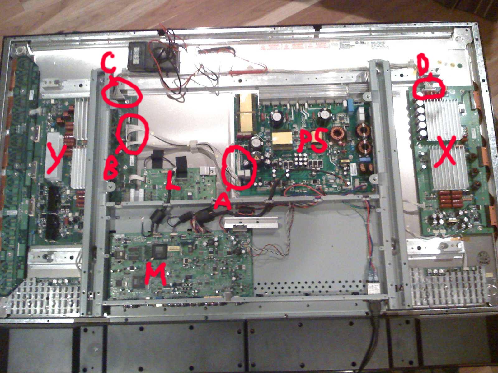

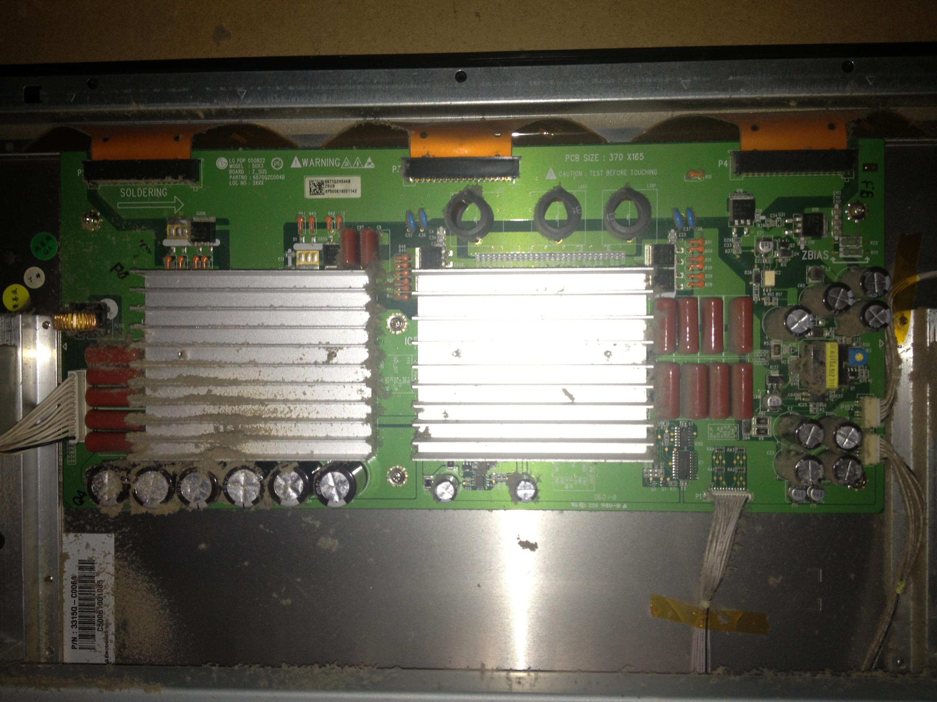

    also saw a puff of smoke come from Z-sus board when i unplugged Z-sus board... and turned it on... am i wrong but how does power get to Z-sus board? isn't it from Y-sus board?

      Pretty sure the Z is powered from the Y. Y is on the left, Z is on the right.
        Re: Blowing Fuses on this...
        X-sus = Z-sus. Same function different name. Please clarify.
          it is Z-sus sorry going from pic i found on my travels
          this is what i am looking at... not my pic but same setup
          Puff came from right Z-sus board near bottom
          PS= Power Supply
          Y = Y-sus
          X = Z-sus
          M= Main
          L= Logic
          A, B, C, D = connectors

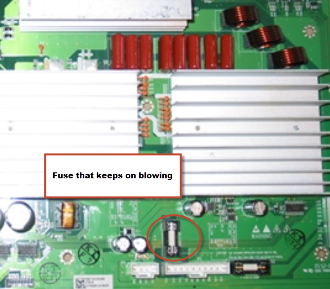

              How do I check if Power board is culprit? how do i trace it down? cause if it is blowing fuses on Y-sus doesn't that mean it is putting out to much from Power board?
              Fuse that keeps blowing in attached picture

                I am borrowing my brothers Fluke 123/3 portable scope... what should i look for?
