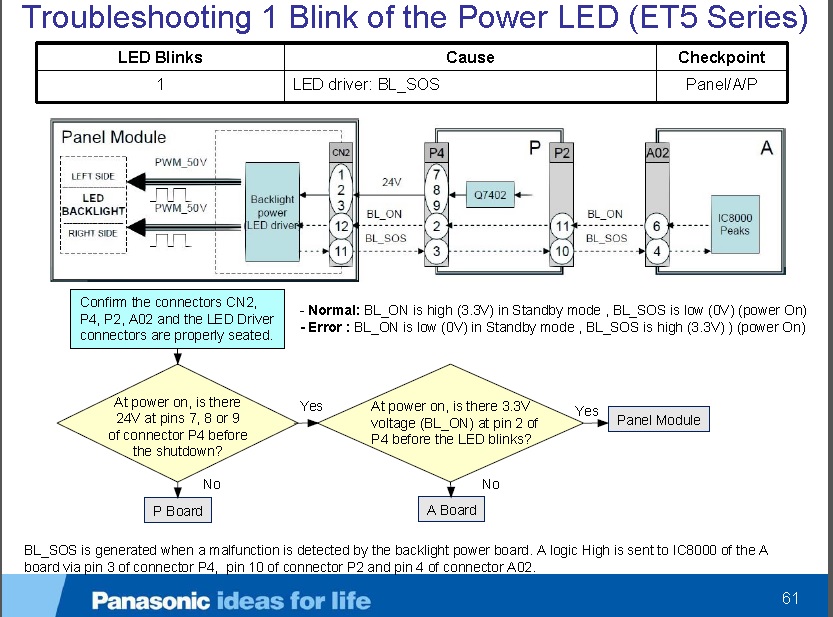

    I push the power button and the power led turns a solid red as if its trying to turn on the just starts flashing red infinity with a one blink code with a few seconds pause in between and just keeps doing the same thing over and over. Any Ideas? what does a one blink code mean on this model anyone know?

    Still need help on this one. Anyone know what I can check? the service manual says the one blink is the panel inverter. I replaced the LED driver board which i'm assuming is the inverter and its doing the same thing.

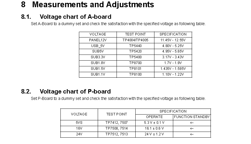

            It's Sergio2013 here, I just changed my username because this one is easier for me to remember. Anyways I'm stuck with this TV. I do have the service manual. I measured the voltage on the power supply at power up I'm supposed to have 24 Volts and I'm getting 0.034 volts only so thought it was the power supply I just got power supply put it in and same problem. I have also changed the LED driver board with same problem. What can this be?

                The power board has no legend. I'm not getting the 24 volts at power on as the service manual says I should be getting, but I am getting the 3.3 volts on BL-On.

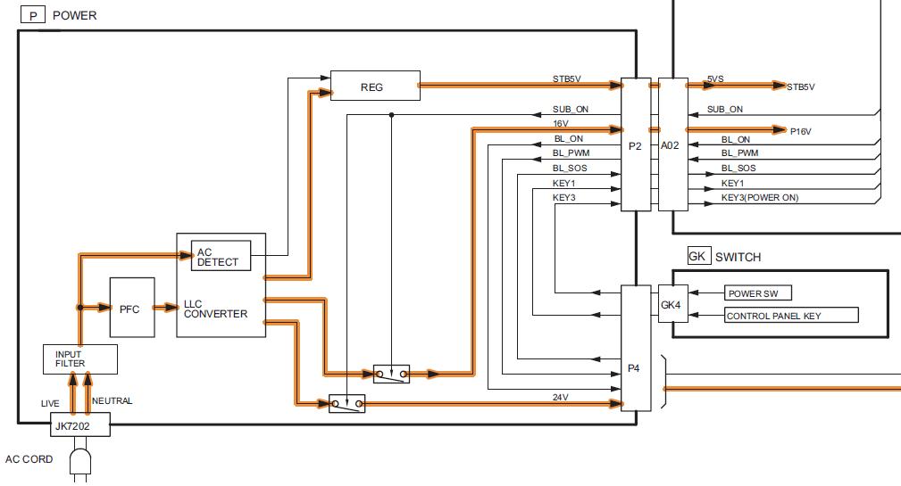

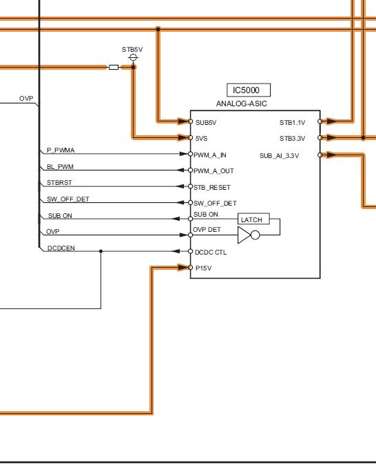

                      24V will only come on when Q7402 turns on, due to negative Vgs. This will only occur when Q7401 pulls its gate low, which will occur if SUB-ON goes high. If SUB-ON does not go high it's the A board.

                          He may mean 9.2. Detailed Block Diagram (1/2)
                          connector P2, pin 7 on P-board from A02 , pin 13 A-board generated from IC5000 A-board

                              Do you have the service manual? Go to section 9.2 and on that first page it hasPSU connector P2, A board connector A02 labelled sub-on. On the next page that traces back to IC5000 on the A-board.
                              I think that was what Tom meant by sub-on. You asked which sub-on and then said there are lots of subs along with the sub voltages list but Tom is talking about the sub-on command from the A-board.
                              "24V will only come on when Q7402 turns on, due to negative Vgs. This will only occur when Q7401 pulls its gate low, which will occur if SUB-ON goes high. If SUB-ON does not go high it's the A board"

                                I do have the service manual and I go to that section and it shows the main board not the PSU. I measured what I think was right, but not sure if I did it correctly
                                connector P2, pin 7 on P-board from A02 the voltage is 2.475
                                pin 13 A-board generated from IC5000 A-board the voltage is 0.192, but sometimes goes higher to like 0.800 and sometimes goes lower to 0.080.
                                What do you all gather from these measurments?
                                Pin 13 was measured on the P board on the A02 connector. Did I do it right?
                                I must have lots of learning to do because I don't understand how to read those pictures at all. Very confusing. I just need to know what pin numbers to put the probe on and on which connector and on which board and I can do it.
                                Can the Sub-on voltage be tested on the P board on connector P2? if so what would the pin number be?

                                  I'm looking at TC-L47E5X service manual, I see A,P,K boards.
                                  Now I'm confused, pin 7 P2 on the PSU is connected to connector A02 pin 13, should give you the exact result.

                                    I think you have the proper manual its the tcl47e5. Maybe you understood me wrong. All the measurements I did was on the P board on the P2 connector. I measured pin 7 and pin 13 on the P board, never measured any pins on the A board.
                                      Re: Panasonic TC-L47E5 LED TV blinking red power light PLEASE HELP
                                      Ok , pin 7 on the P2 is correct, pin 13 on that connector is not relevant and I don't know what it all means just wanted to guide you to the sub-on. I have to go, son just blew his lid and put his foot through the wall.
