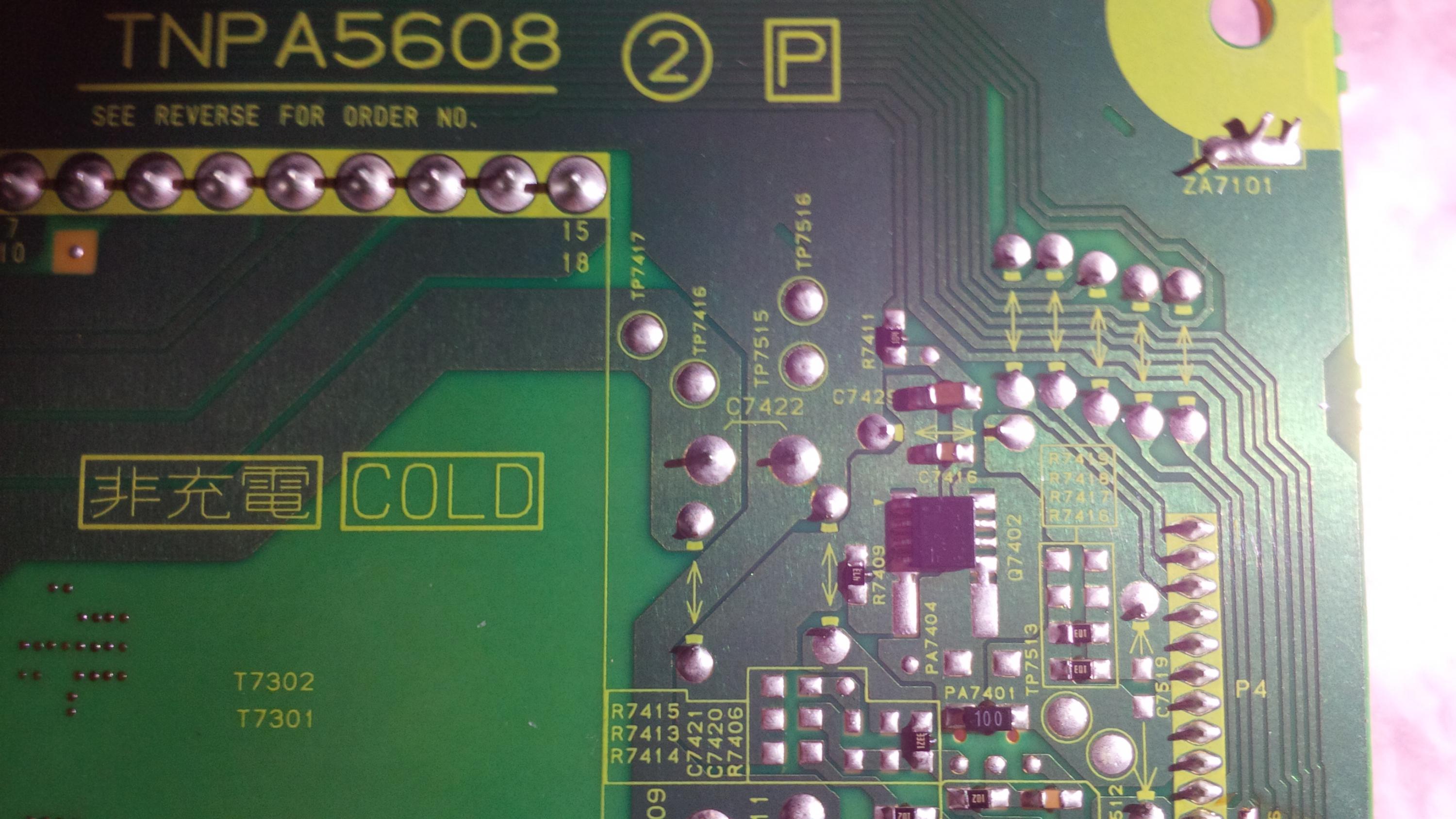

                    Ok ill get a picture for you in a few min. Don't know if this is related, but the ps has a silver like box that makes a click sound as the voltages drop. its a very low volume sound. Also don't know if this set has relays that click when you turn it on. because I don't get any relay clicks at all.

                      Here is a picture of the area.

                        OK pin 1 of Q7402 is marked with a yellow triangle.
                        Pins are then counted counterclockwise as so:
                        1 ... 8
                        2 ... 7
                        3 ... 6
                        4 ... 5
                        Test resistance (2000 ohm range) from 1 to 4 and from 5 to 4. I'm expecting to see infinite (your meter reading should not change, except perhaps very briefly.)
                        Then check what appears to be fuse PA7401. It should appear shorted (<3 ohms) on the same range.

                          The fuse tests -2.800 and just keeps dropping. I have my meter on auto range. On the Q7402 how do I test that do I use both leads on my meter? if so where does the negative go and where does the positive go?

                            Never mind I think I figured it out all the tests of the q7402 were infinity they didn't change they were all 0.2 ohms except for pin 4 which was 45.5 ohms but always stayed there and didn't move.

                                Please check resistance between these two combinations 1-4, and 4-5. No more for now please.

                                  I get 0.3 ohms. and if I put it on the continuity function it beeps. I hope im doing this right cause im not to sure.

                                    I'm confused about the numbering of the pins
                                    I know pin 1 has the triangle, then not sure if pin 2 is below it or to the right of it

                                      My diagram is accurate for the orientation shown
                                      >1 ... 8
                                      <2 ... 7
                                      <3 ... 6
                                      <4 ... 5

                                        Ok but when you say test pins 1-4 do you mean one probe on pin one and the other on pin 4?

                                          I mean one probe on 1 and one probe on 4.
                                          If you get continuity between 1 and 4, the MOSFET Q7402 is failed.
