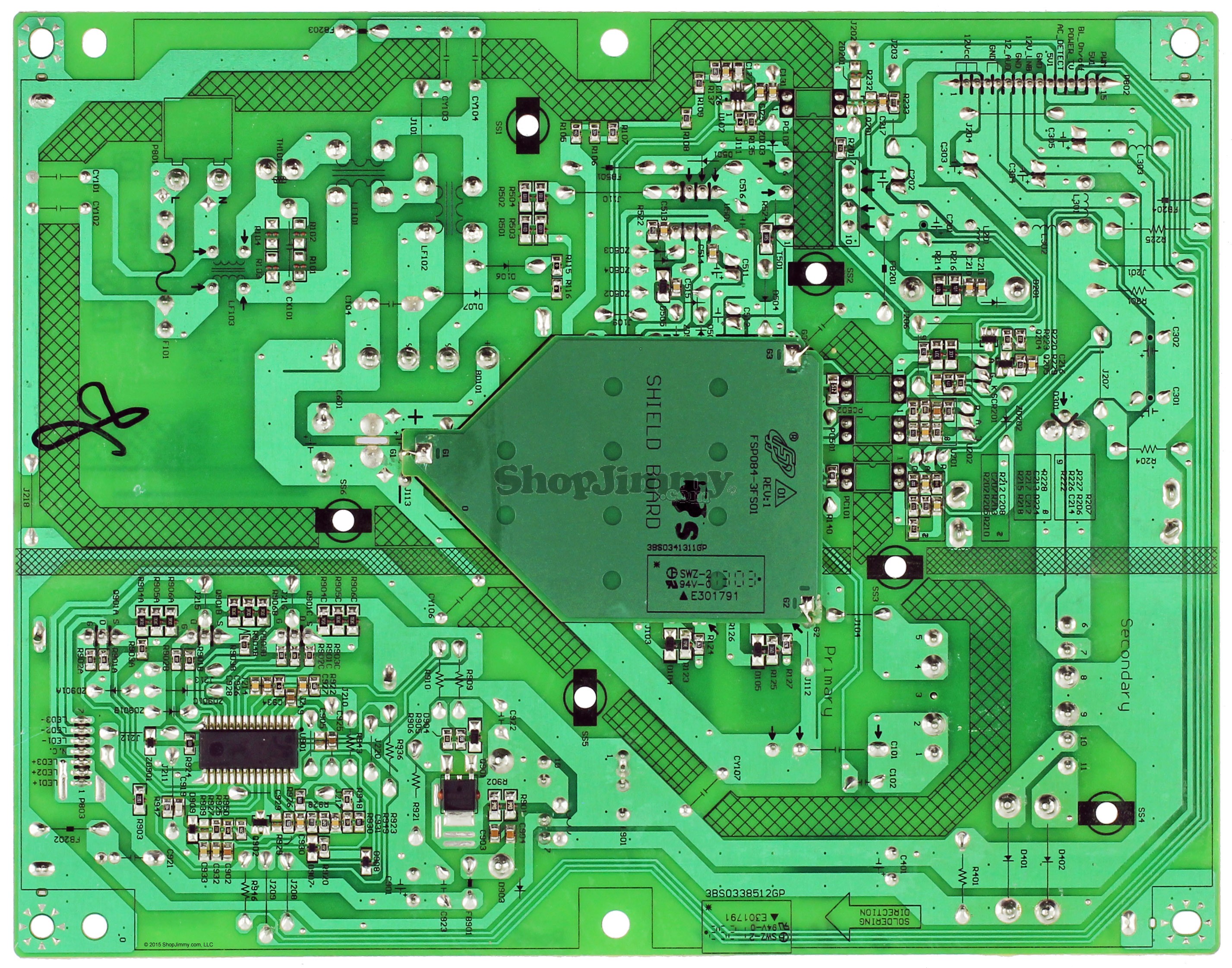

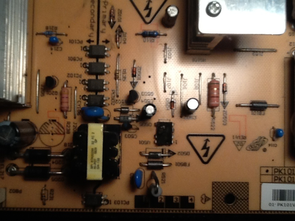

    A power surge took out a few components on the power supplies primary. Part U501 is a pmic but it is completely blown and I can't read its part #. I've tried searching for a schematic but there are none available. If someone could identify the part that would be extremely helpful. The power supplies model# is Pk101v0830i. Thanks in advance for any help you guys provide.
    Re: Need help identifying component U501 on the power supply of a toshiba 40rv525u
    To me, it looks like a Power Integrations TNYxxx chip -- the hard part is determining the "xxx" part. Any clue of those last digits?

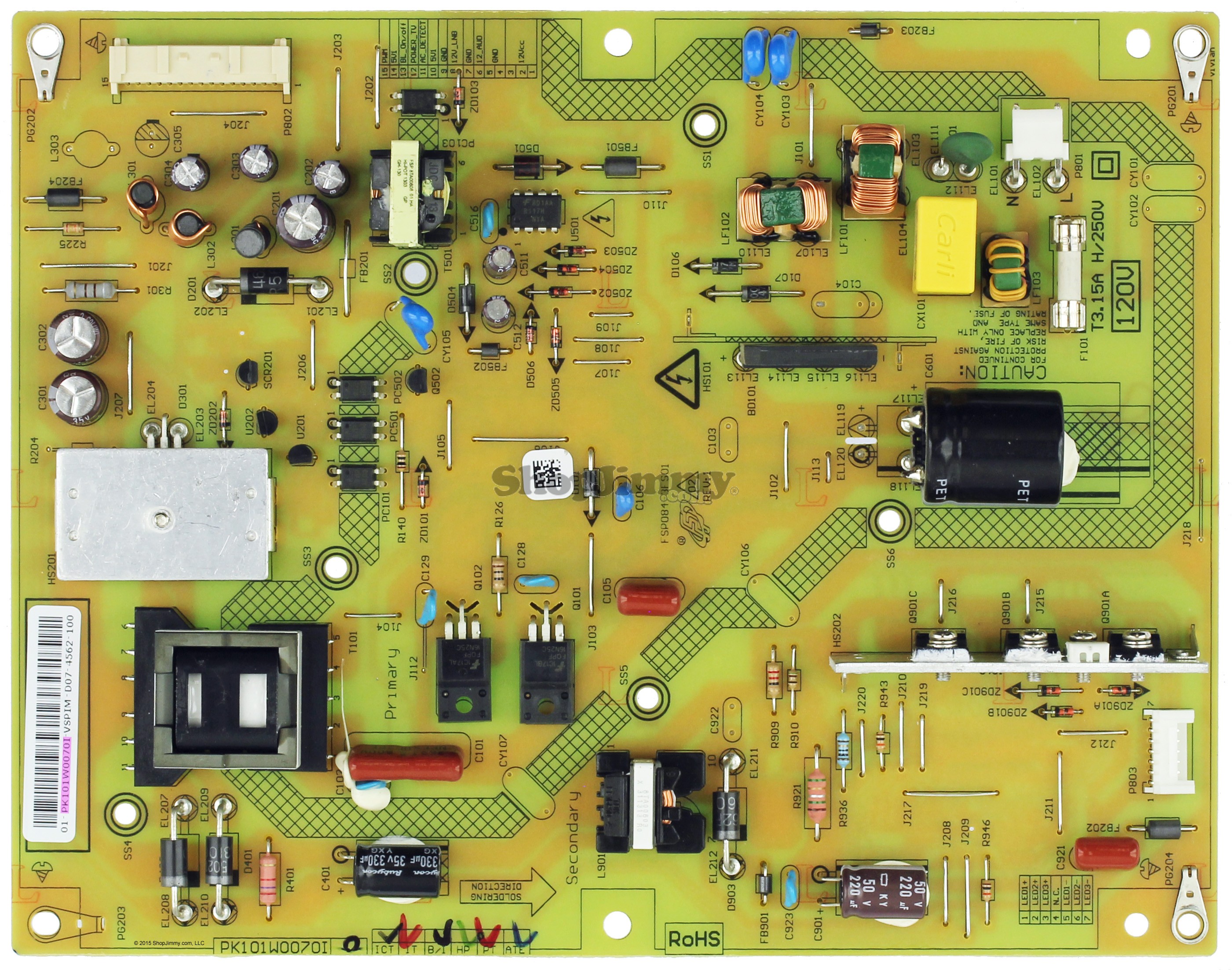

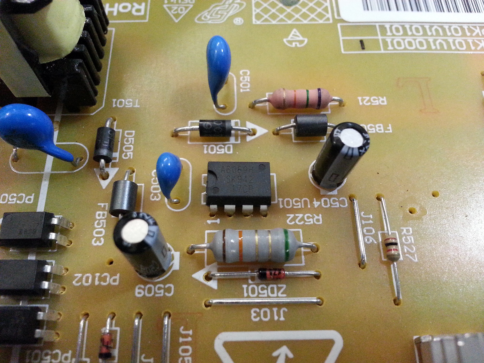

      On a similar Toshiba TV's board the U501 has these markings:
      A6069H
      SK942
      17CP
      It's a seven pin IC.
      Board number is: PK101V1000I/FSP245-4F03
      http://www.digikey.com/product-detai...69H-ND/3661844
        That checks out this one is a seven pin as well. Thanks
          U501 is part # STR-A6251M

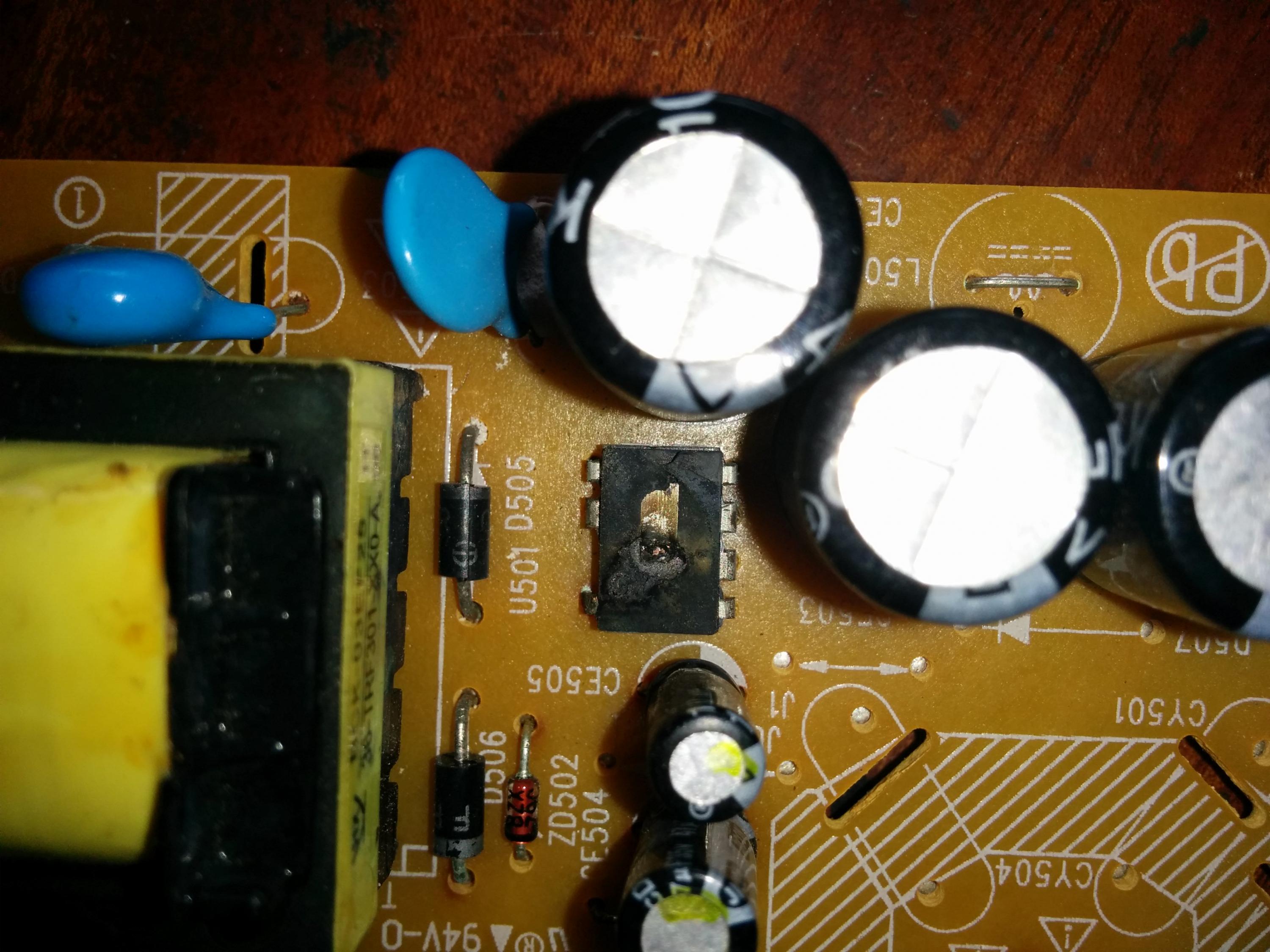

              I am Stuck with same issue but my toshiba pSU board # PK101W0070I
              IC mentioned U501 has 8 legs NOT 7 Legs
              it blown top part ..i can't read the number ..
              can someone please help me to find the number
              its 8 legs..
              this

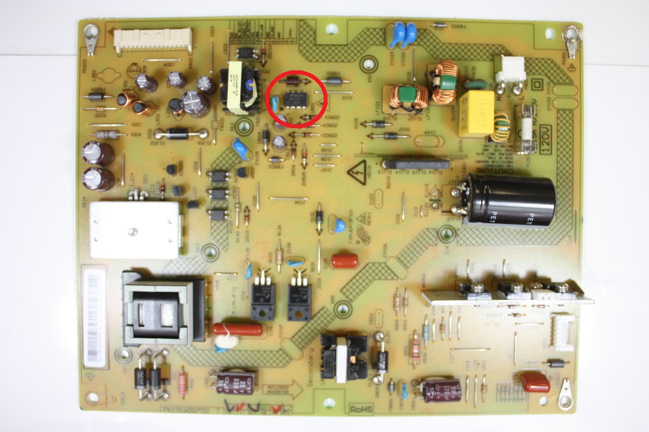

                  apologize for not picture in previous post...
                  here is picture
                  part mention in RED circle..
                  help appreciated ..thanks in advance..
                  this
                    If its the part circled in red there are numbers on it try using a good magnifying glass.

                      hello sir,
                      thanks , this is just similar board i tried to use to mention rigt location ..
                      the board which has damage IC is blown from top so i can't read at all.
                      i tried magnifying glass only last 2-3 digit i can read that's all ...
                      its 8 LEG IC ..and same board as shown in image..
                        OK, after hours of manipulating the picture of U501 using shojimmy photo and searching the FAIRCHILD website.
                        U501 is made by FAIRCHILD P/N FSB117HNY used in your board version.
                        The connections of the IC pins on the board seems to match the app notes.

                          Thank you so much BUDM ,
                          much much appriciated , before i post here since 2 days i am trying to fliping lot of website and pictures..but none of has any clear picture neither i am photoshop expert to modify the picture to clear view of number.
                          your effort much much appriciated not just to find the number but also cross verification to make sure that that's the right one.

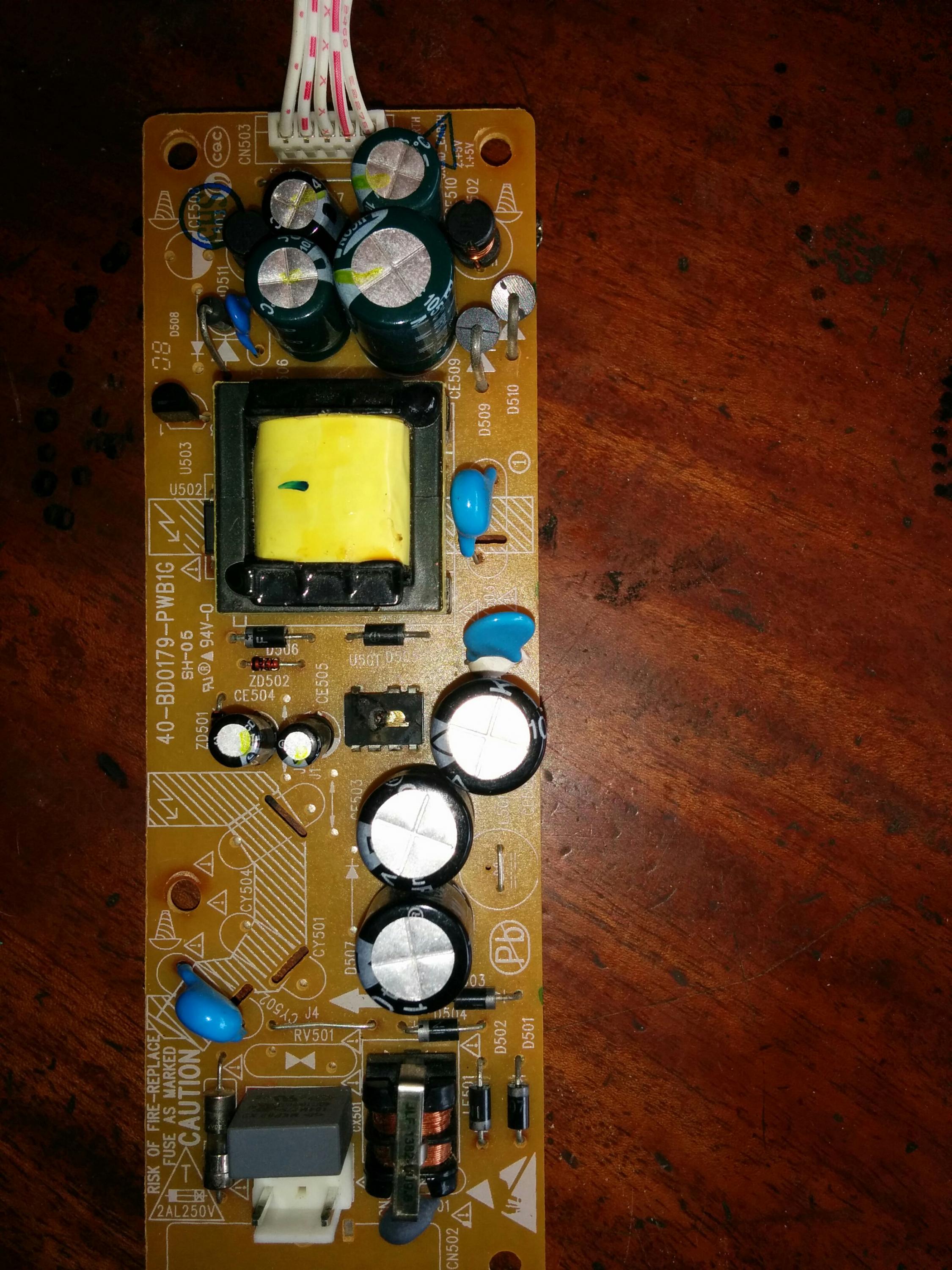

                            my Toshiba bdx 1200 blue ray player PSU board is burn it's code u501 can you help me to identify the component
