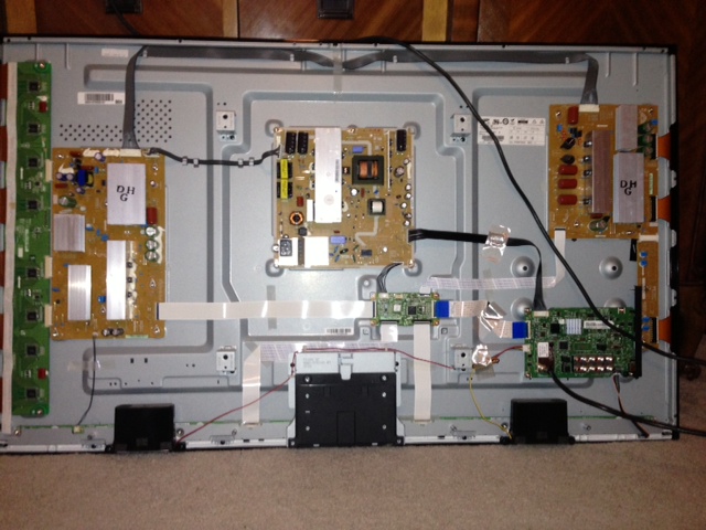

    20 month old plasma with no picture. I've read several posts on here and learned a good deal so far, but need help with the next step.
    I took the back off, but don't see any swollen or leaking caps. I measured VS and VA, and initially get VS=~205 and VA=~50 before both gradually decrease, maybe 10 volts per second.
    I replaced the Y-Main board with ebay find, but same status. I unplugged every board leading to the power supply except main board and input board, since they appear to be required for power supply operation. VS and VA still fall the same way.
    I guess I'm ready to buy a Power Supply, but wanted to check before I shotgunned again.
    Picture attached. Y-Main is on the left side of your picture. Power Supply in the middle.

    Have you done this test yet?

      No, I haven't. What are the expected results of this test?

        A series of test patterns show on the plasma panel.

          Re: Samsung PN51D430A3DXZA Sound but no picture
          and if it produces these test patterns, does that indicate I need a controller board?
            It indicates a bad main board. The main board is the one with HDMI etc on it. Not the board you do the jumper on.
                  shorting pins 3 & 4 fails. No test pattern, no changes whatsoever.
                  Another possible tip. When I plug it in, I get one click followed by a "bizzip" sound, possibly from the power supply area. I can't quite pinpoint the location.
                  Thanks in advance for your help.
                    Does the "bizzip" persist, or is it brief?
                      sound is very brief.
                        That's probably OK then.
                        Look at the LED indicator on the control board. Does it light up? If so, does it light up for 5 seconds then pause for 2, or does it flash about once a second?
                            5 seconds on, 2 seconds off.
                              OK, this indicates an X-main or Y-main fault. 5-2 blink error. I'd suggest you replace both boards as they are currently reasonably cheap.
                                Cool. Progress. I just replaced the Y-main. Do you recommend another Y-main at the same time as the X-main? Or can I likely just buy an X-main?
                                  I always advise both Y-main and X-main to be replaced at the same time on these models.
                                    Parts ordered. I'll report back. Thanks for the help.
