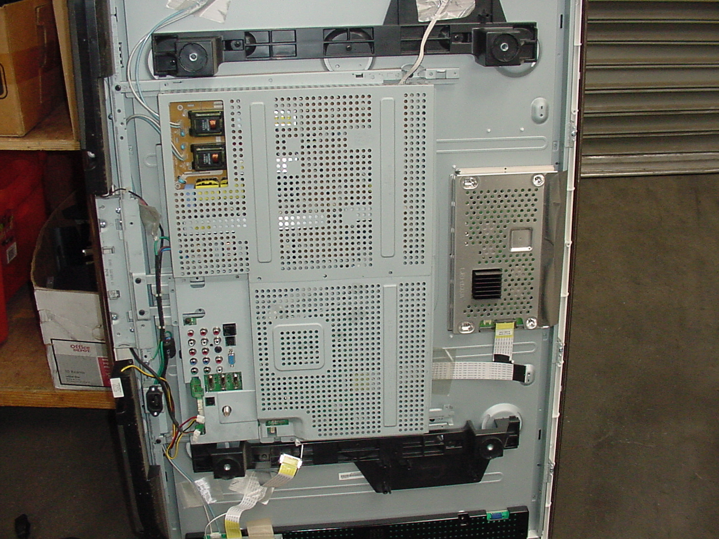

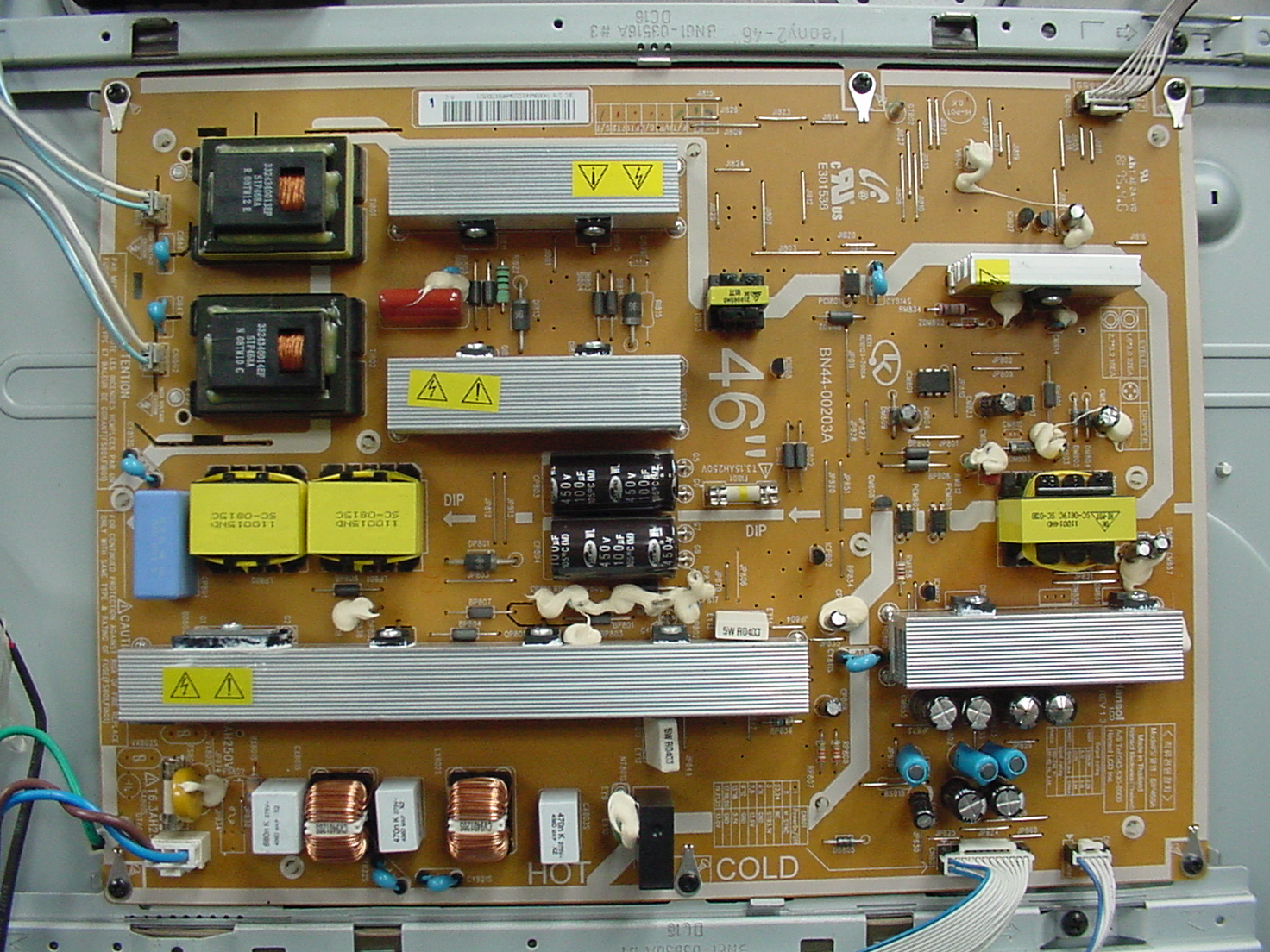

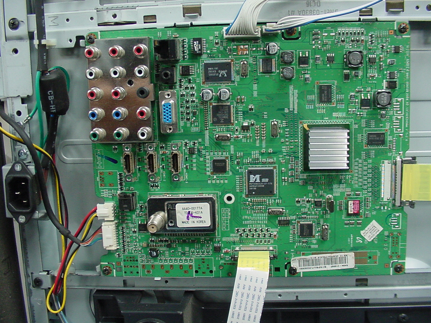

    This 2008 Samsung 46" came in yesterday. Bad caps, of course.
    More pictures here:
    http://s807.photobucket.com/user/bud...?sort=3&page=1
    So far no tab bond problem showing up yet either.

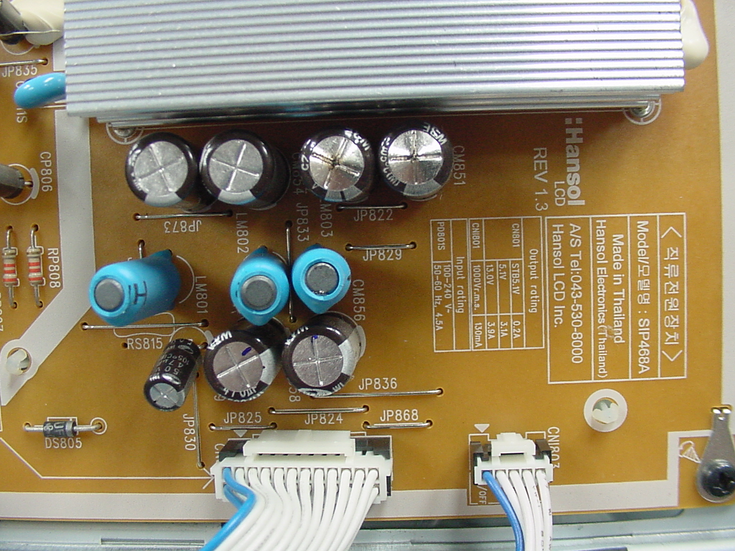

    Nice. I've had the LE40A656 with bad caps, and I stuck it in the front room at parents house... still going fine, no tab bond issue either.
    Did you replace all the caps? I did all on mine with Panasonic FR and FC.
      Re: Samsung LN46A650A1F easy fix

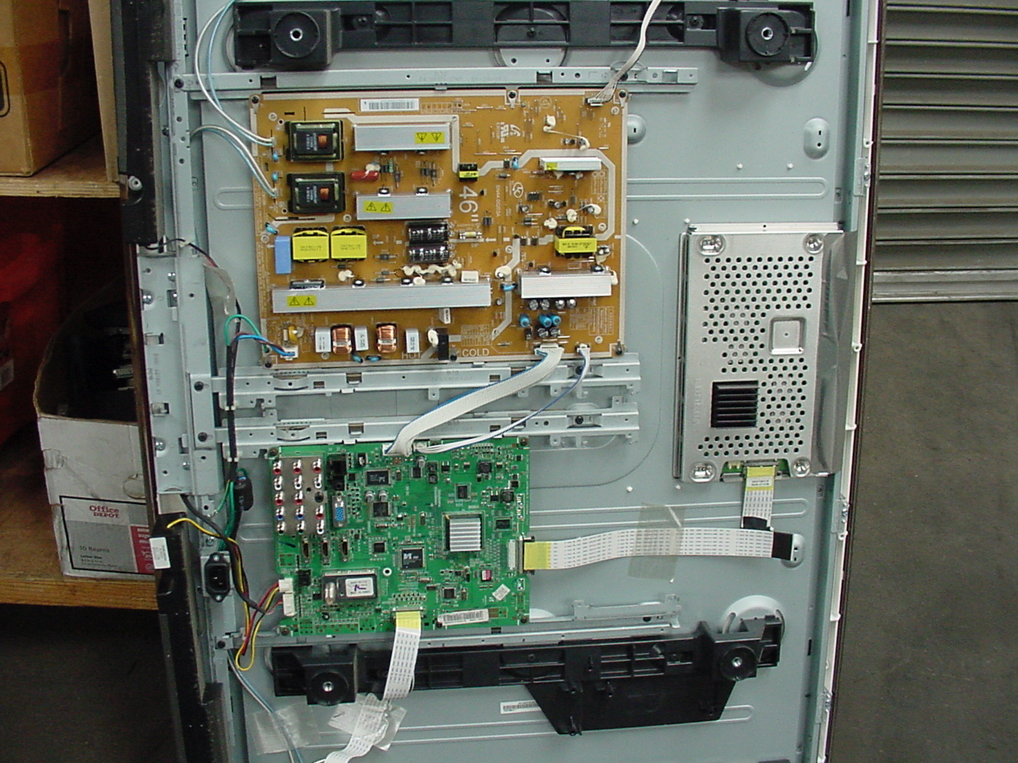

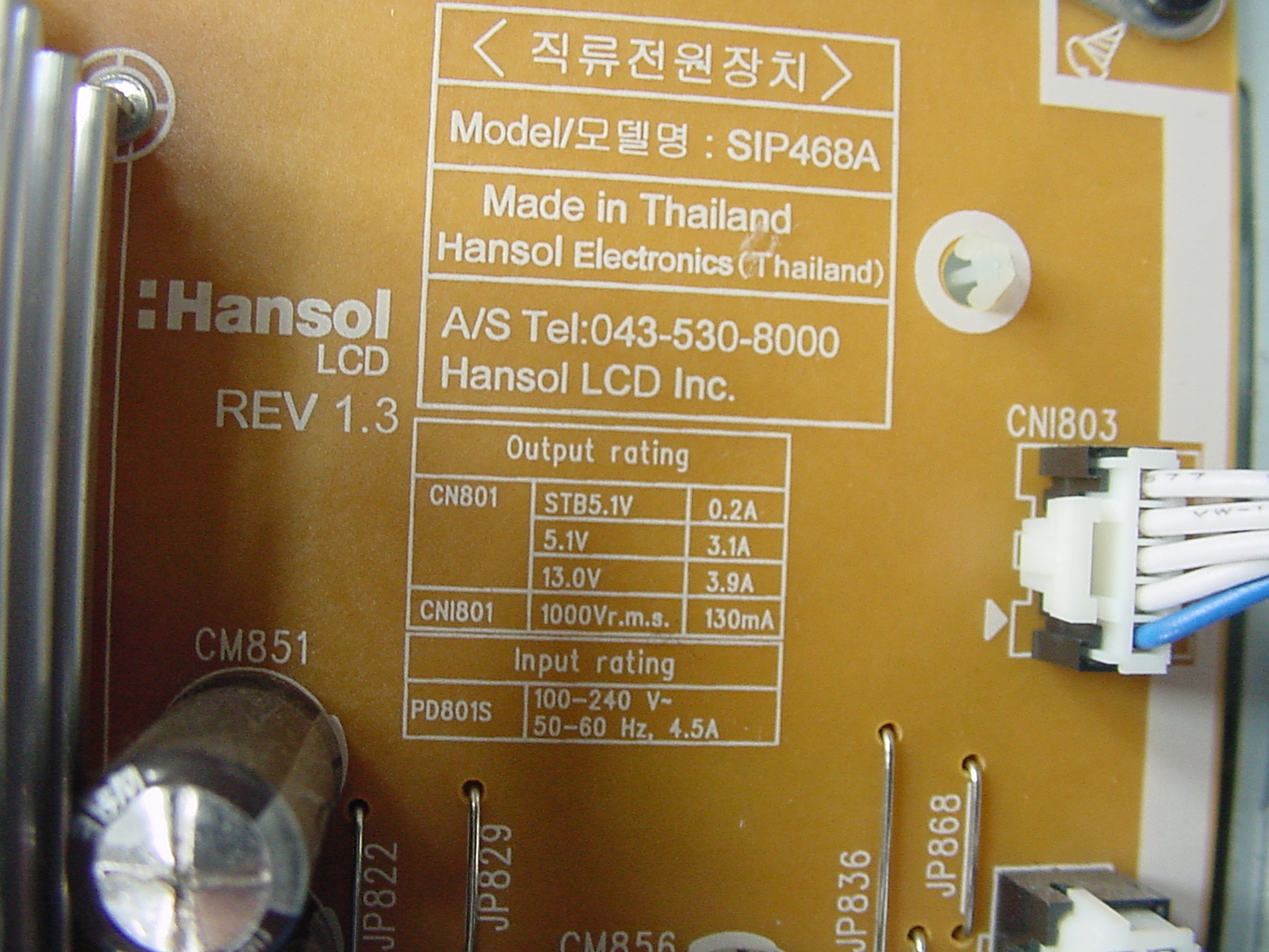

      Yes, I replaced the 2 bad one first to see if I can get the backlights to come on first to make sure it does not have cracked screen, I replace the set of caps after the verification.

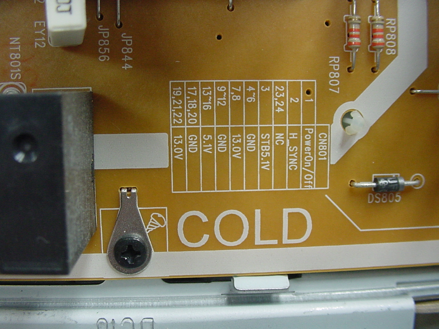

        I'd imagine you could still pull the power board cable to do the backlight check, even if caps are bad? After all inverter is primary side. Not sure how dependent it is on the power supply working OK, or if this model supports that test.
          That is what I did first but that did not work, It is the bad caps in the power supply (stby ps) is not supplying the pull up voltage to turn the PS_ON and the BL_ON signal, after new caps installed the backlights come out with the cable disconnected between the power supply and the main board.
          When I first turn on the TV before repairing, it was going on and off with Samsung chime, stuck in that mode.

            Or maybe inverter control circuit runs off 13V rail. Not sure if it is separate rail or shared.

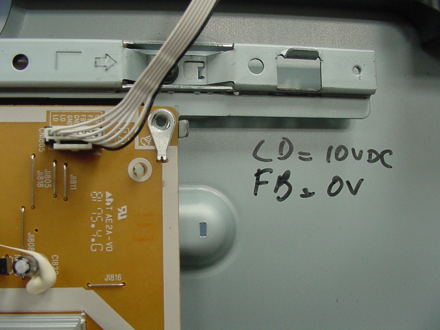

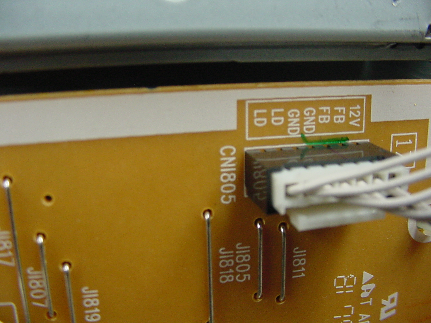

                    Look at the FB and LD signal.
                    LD = 10~12V
                    FB = 0 V
