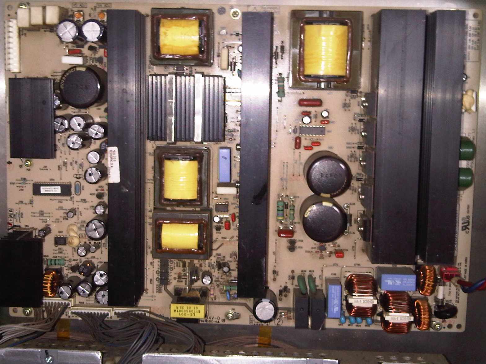

    The Problem am having is the tv when the power button is press the front led goes from red, green then back red. It startups ones then shutsdown. The voltages i read on P800 Connector
    Press Power Stutsdown
    P800 PINS
    4.83v 1. AC-D 4.85V
    4.53V 2. RL-ON 0V
    5.03 3. STANDBY 5.04V
    3.6V 5. VS-ON 0V
    4.66V 6. 5V-D 0V
    5.02V 7. M5V-ON 0V
    5.03V 8. STANDBY 5.05V
    3.32V 10. NC 3.34V
    5.98V 11. 6V 0V
    4.53V 13. 3.3V 0V
    The Connector P802/P803 Voltages startup then stutsdown.
    But i'll disconnect y-sus cables from PS the voltages Vs-230v then drop fast and stay at 4v, Va-66v then drop fast to 0v but the 5v-4.98 and stays there.
    Next I disconnected P800 from the main Board jump 470 resistors from standby to rl-on and m5-on PS voltages reading 6v-6v, 12v-12v, 19v-19v, 3.3v-0v, Vs-0v,Va-0v and 5v-5v
    Disconnected P804 & P805 voltages reading 6v-6v, 12v-10v, 19v-17v, 3.3v-0v, Vs-0v,Va-0v and 5v-5v
    jump 470 resistors from standby to rl-on, m5-on and vs-on PS shutsdowns
    Feel the problem is in the Vs &Va Section of PS But Any direction to solve this problem welcome

    Re: Lg 50pc3d blinks once click shutsdown
    Pics
    Please Help
      Are your fuses good on the sustains?
        All fuses are good
          It does seem like you have a PSU issue. I found a few repair kits that might offer some clues of things to check:
            So just replace the Power supply, But i really want fix it doe
              You could try replacing the PSU, do more testing to try to fix this one, or see if there's a reputable repair service. The one thing that would make me do more checking in general is that the VS and VA voltages do come up to spec at some point.
                Vs goes up to 230v is that normal or is that what causing the Power supply to shutdown
                  230V is much too high. 185V to 190V is typical for these supplies. Check your multimeter's battery is good. Also, check Va does not exceed 65V.
                    Vs reading 230v-259v and Va 66v-79v then Power Supply shutsdown, Any diagram for the Power Supply
                      Ugh, sorry, I'm working on about 4 hours sleep. Thanks for catching that, Tom.
                          If Va is 79V, I would be seriously worried about the plasma panel itself surviving such extreme overvoltage. Check your multimeter battery.
