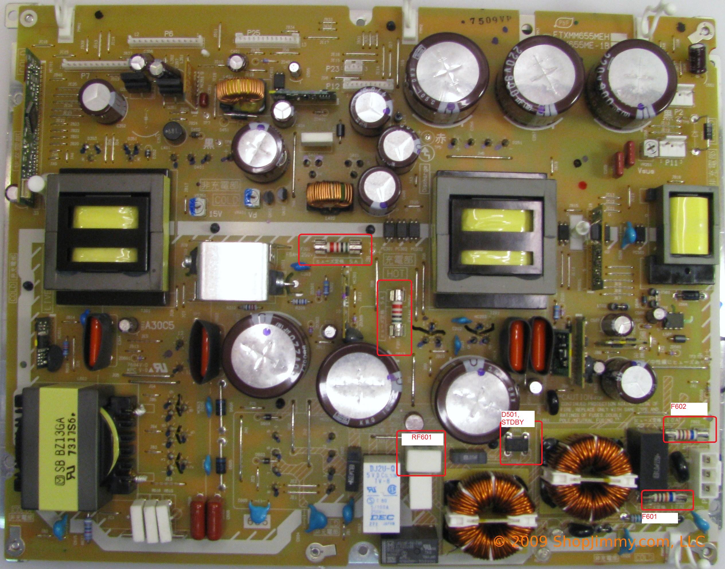

        Have a pana th50PX77u thats completely dead (apply power - no clicks or lights) - PSU etxmm655meh. does anyone have any diagnostic or repair tips for this PSU ?? I've seen a blog that says replace MC201, MC301 and maybe IC tea1610. Thanks
          Re: Pana plasma TH-50PX75U shutdown 10 blinks
          Are fuses OK on your board? You should really start a new thread.

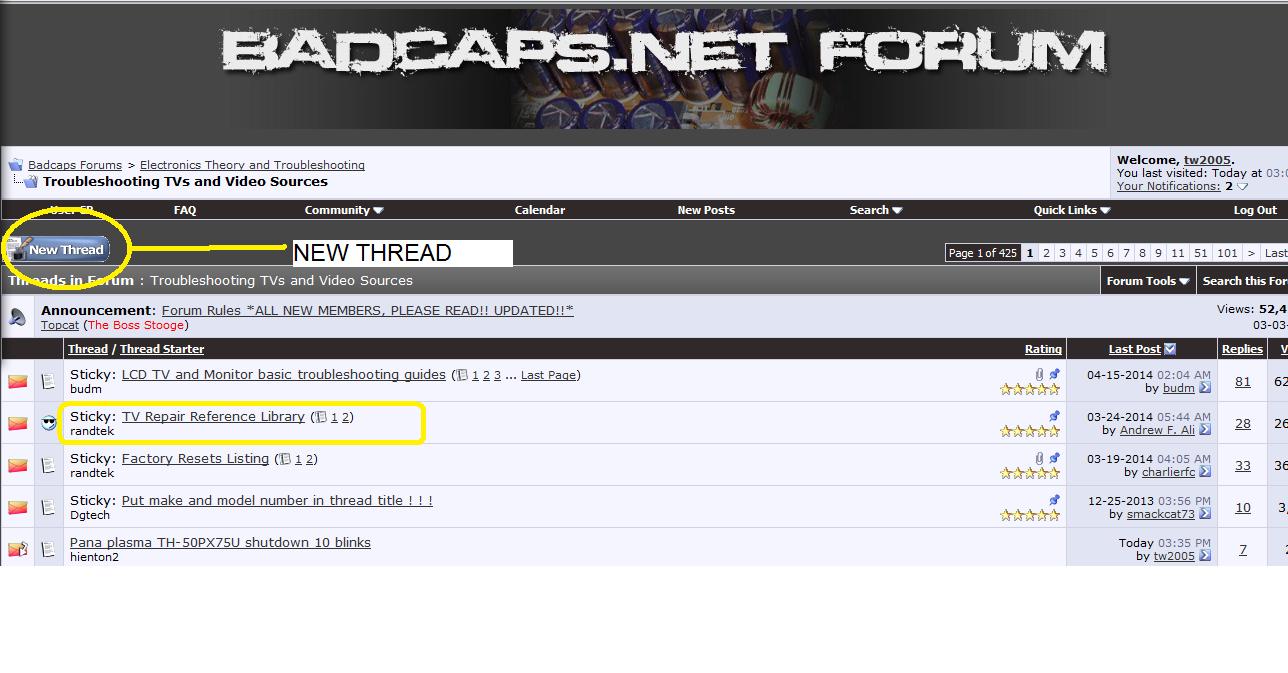

              tried to start new thread - HOW ????
              no 5V at pin 5 of connector A7 when the
              TV is plugged into the AC line
              TV unplugged - 1 ohm continuity between pins 8 and 10 of connector P12 of the P board
              assuming the PSU is bad. looking for diagnostics on PSU - or what to look for ?

                probably is a PSU issue.
                Unplug the TV.
                Disconnect connector A7.
                Does the TV turn on by itself
                when it is plugged into the AC
                line with no picture and lit
                LEDs on SS & SC
                boards?
                If not then PSU.
                You have no STDBY 5v so I'd start with the fuses F601,602,501, thermal fuse RF601.
                manual and troubleshooting guide should be in Tom's reference library in the sticky.

                you should be able to start a new post from the front page.
