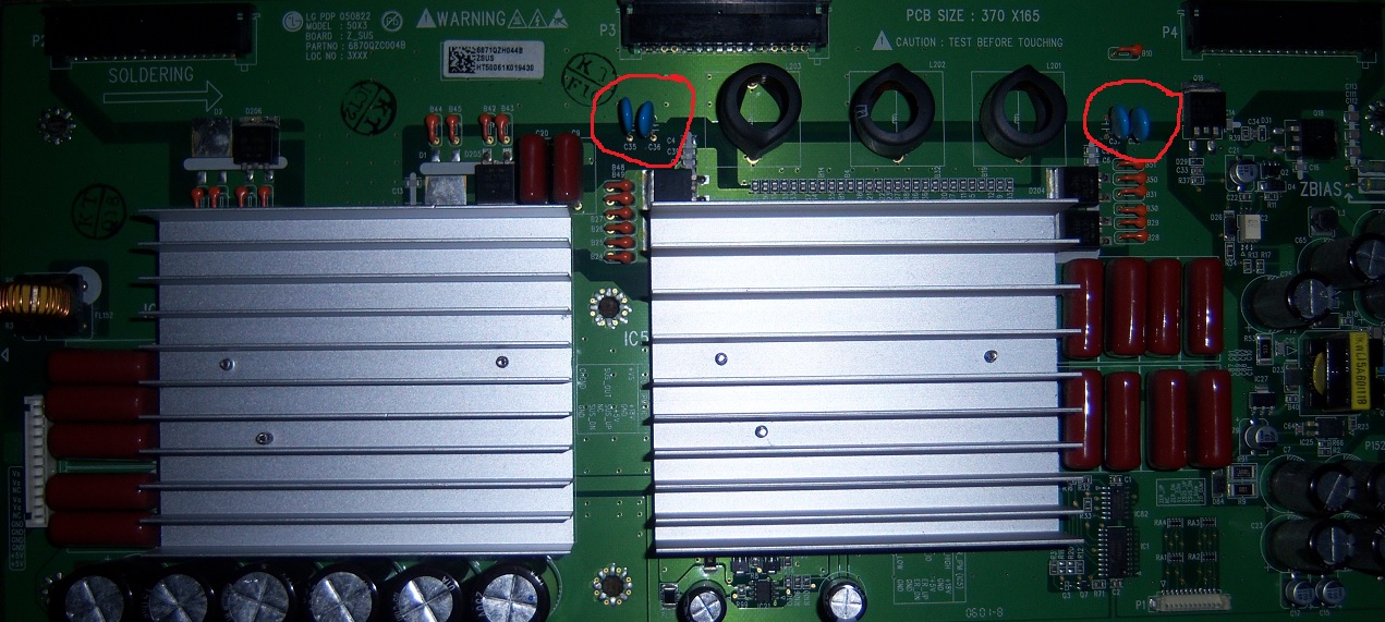

        Re: LG 50PC1DR doesn't power up. Just clicks.
        Thanks Tom. When you say 68n capacitor, were you referring to the ones I've circled in this picture on the Z SUS board?
        I've pulled and inspected all of the boards in the TV except the logic board and everything, at least visually, looks flawless. Of course it can't be something simple
          It's on the power supply, a blue box approx 1cmx2cm marked PILKOR 68n I believe, may be different.
