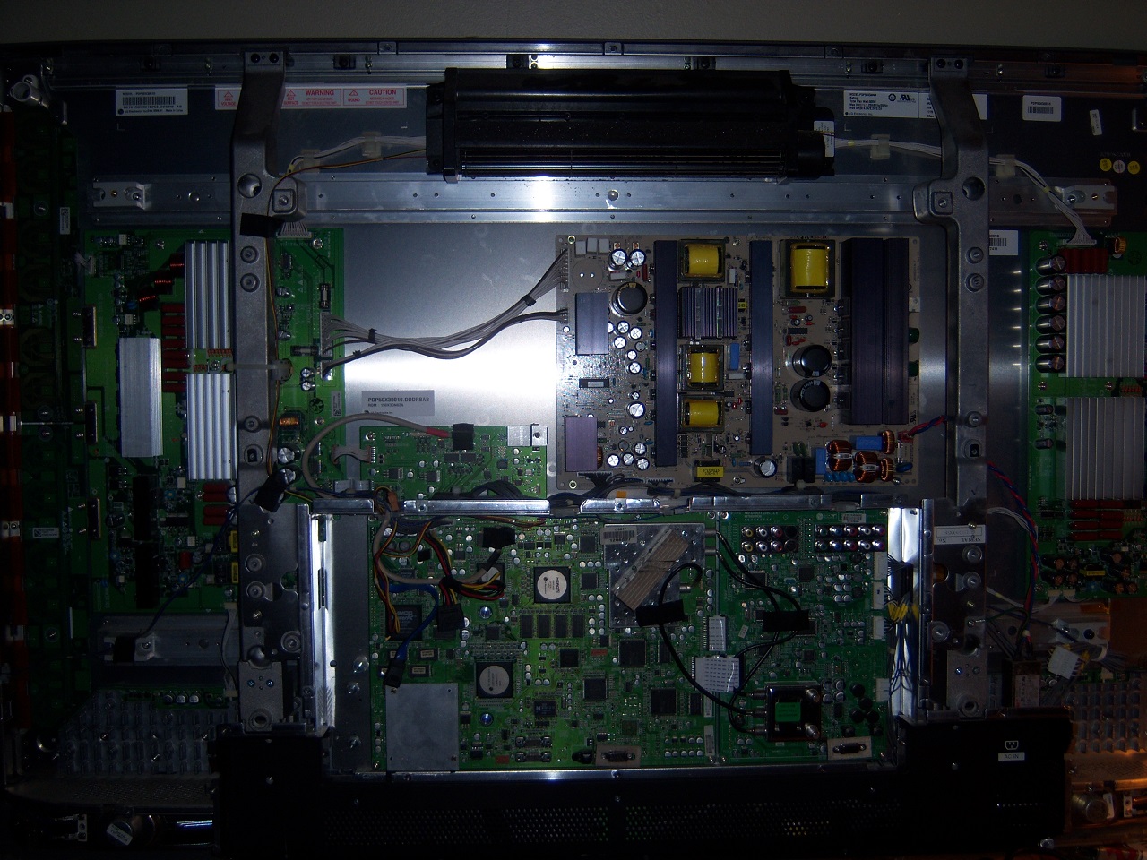

    Hey everyone, I've got an LG 50PC1DR that my neighbor gave to me for fixing his lawn mower. He got it from his old boss, so I have no history on the TV.
    Upon plugging it in, I hear the PSU click, red light on the front of the TV goes green, then another PSU click, then light goes back to standby red. (few LED's on the other boards turn on during this process, then turn back off). Pressing the power button simply does this again. Zero activity on the display, doesn't attempt to light up or anything.
    I've removed and inspected the PSU board (and other boards in the TV without removing them yet) very carefully and have found no signs of bulging caps, no leakage, nothing burned or charred. The PSU just clicks, then clicks again a few seconds later and it does not cycle on its own. Only when I push the power button, click, ... click.
    Unplugging the Y or Z SUS boards does nothing, same clicks, no changes.
    I do have a digital multimeter, but I'm not sure where to place my ground when testing voltages. Any help is greatly appreciated. Thanks!

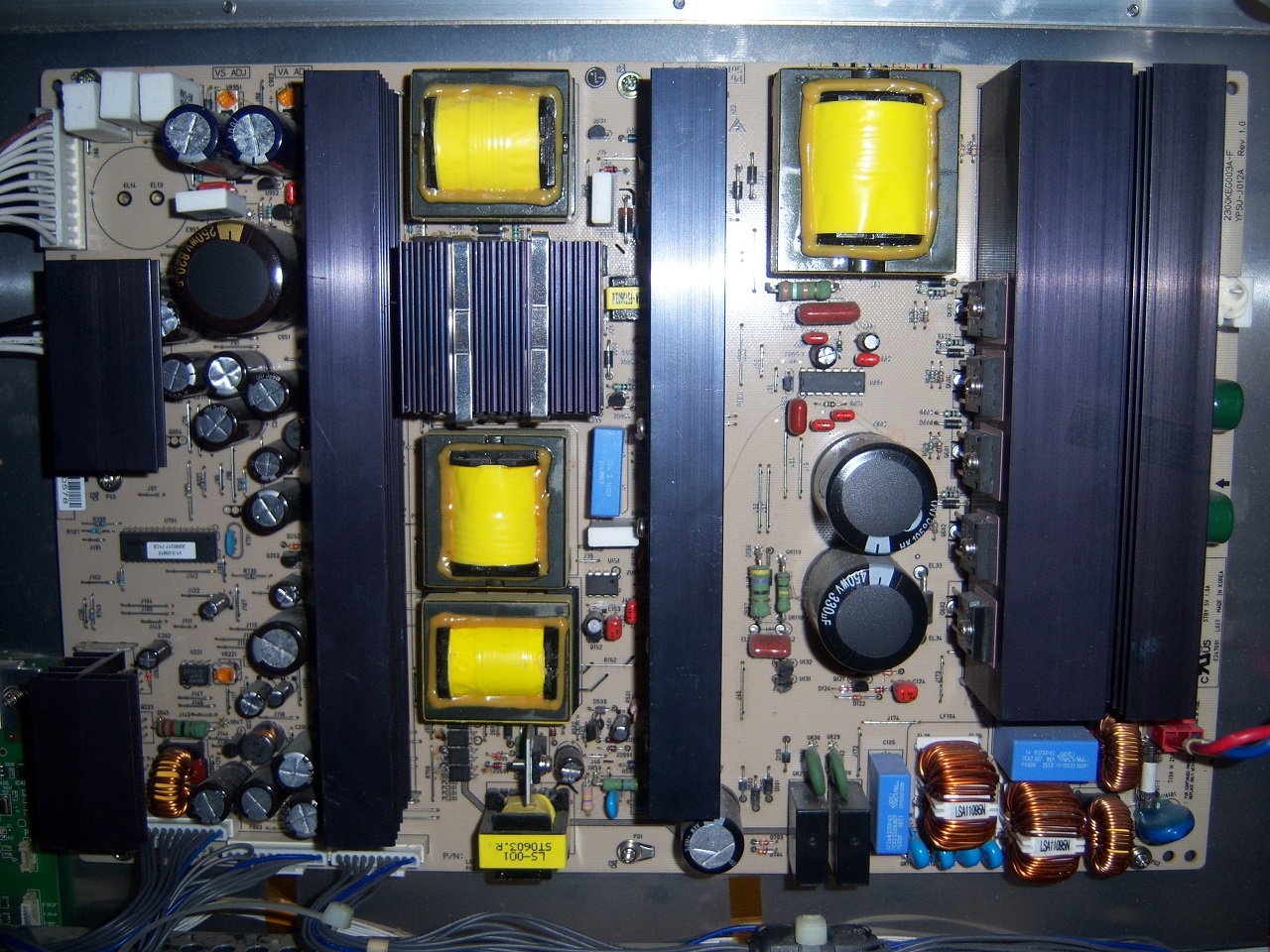

    Can you post some pictures of inside the set?

      You'll notice a sloppy solder job on the optocouplers, I bought a new iron and I'm undoing that as we speak. Not sure if I attempted the bridge correctly anyways.

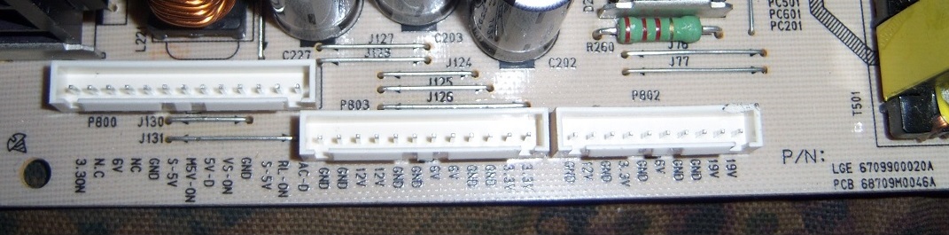

        OK, along the power connectors going to the main board, you'll see labels marked 19V... 5V... RL_ON... etc. Can we get a picture of these labels?

          Re: LG 50PC1DR doesn't power up. Just clicks.
          Sorry about the delay, my digital camera couldn't have picked a worse time to start acting up.
            OK, please measure the following pins while the set clicks on and off. Hold the measurement while it clicks, to see if the reading changes:
            S-5V
            RL-ON
            AC-DET
            6V
            3.3ON
            3.3V
            To measure: all connectors installed. Multimeter black probe on chassis. Red probe to touch metal sheath around each pin visible on each connector.

                        OK, near the top left of the power board, there is a connector going to the Y-sus.
                        On it there should be some pins marked Vs, Va, 5V, etc. Please make measurements there.

                              I believe the Z SUS wiring harness goes through the Y SUS? See the first photo I've posted above, the wires run above the PSU and behind the squirrel cage fan, to the Z board.
                                It sounds like you have a bad Vs and short on Va.
                                Let's try to rule out bad plasma panel short (which would terminate the repair, due to it being uneconomical to repair.)
                                Unplug the highlighted cables. Measure Va and Vs. Note: Under NO circumstances reconnect these cables with the TV power on or within 5 minutes of turning the TV off or else you will kill the plasma panel.
