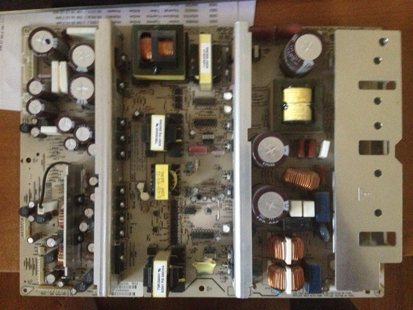

                    Odin,Super late but here are pics from my PSU board....
                    Also send ya a inbox....

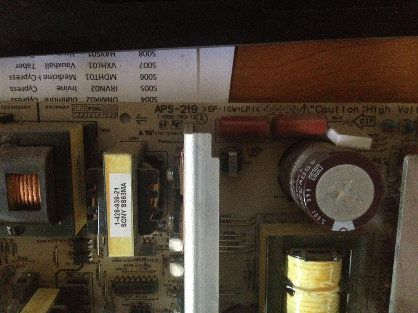

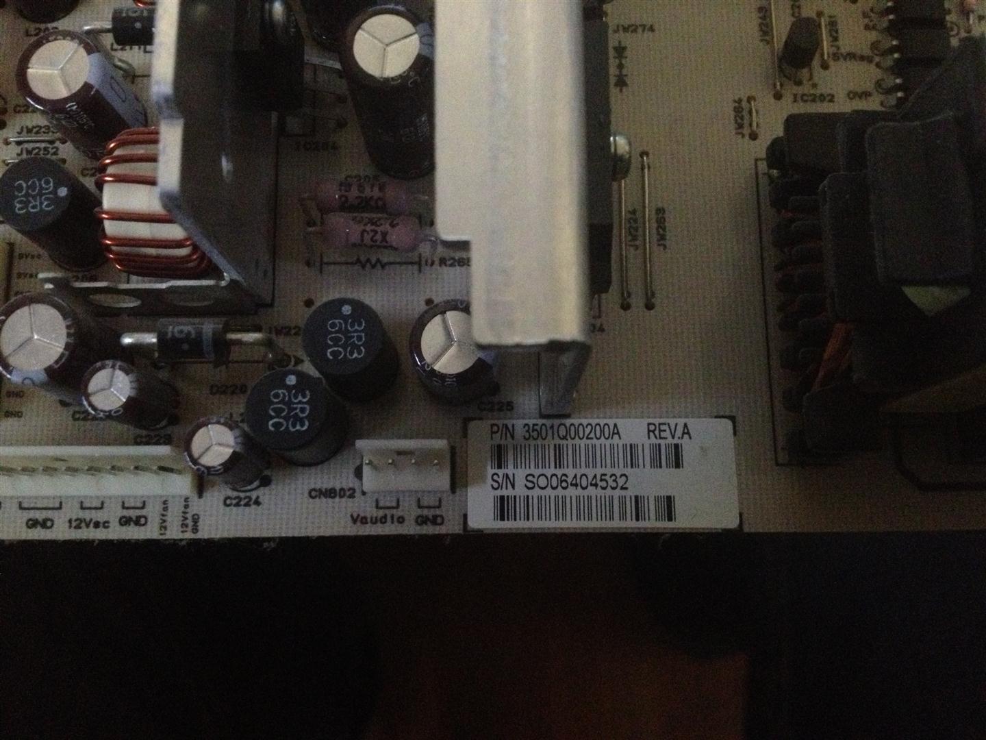

                          Originally posted by Odin8989
                          We got this TV for free and it was working fine for the most part up until about a month ago. I haven't really had time to do anything about it til recently. Before it stopped working completely it would turn on and off until it warmed up, we'd speed this up by using a hair drying and point it towards the capacitors.
                          Well long story short, it finally went off one day while my wife was watching it, and it....never turned back on! :O
                          Since then I've taken the back off of it and played with the voltage nobs (to no avail sadly) on it, and checked out all the capacitors on it. None of them are bulged or burnt looking. Anyone have any ideas about what it could be? I'm not afraid to solder or take anything apart on it, I've done soldering before and it's not that bad. If it's gonna cost me like $1000 I'll just put it to the curb.
                          I've uploaded a couple of photos for you guys to help, let me know if you need anything else. The first one is of what the TV looks like if it manages to stay on long enough to get a picture. It doesn't say "please wait thank you for your patience" anymore before it turns on. The second one is the Power Supply Board. The third is the lights that turn on in the back before it turns off. The one off by itself near the bottom flickers the whole time it's on.
