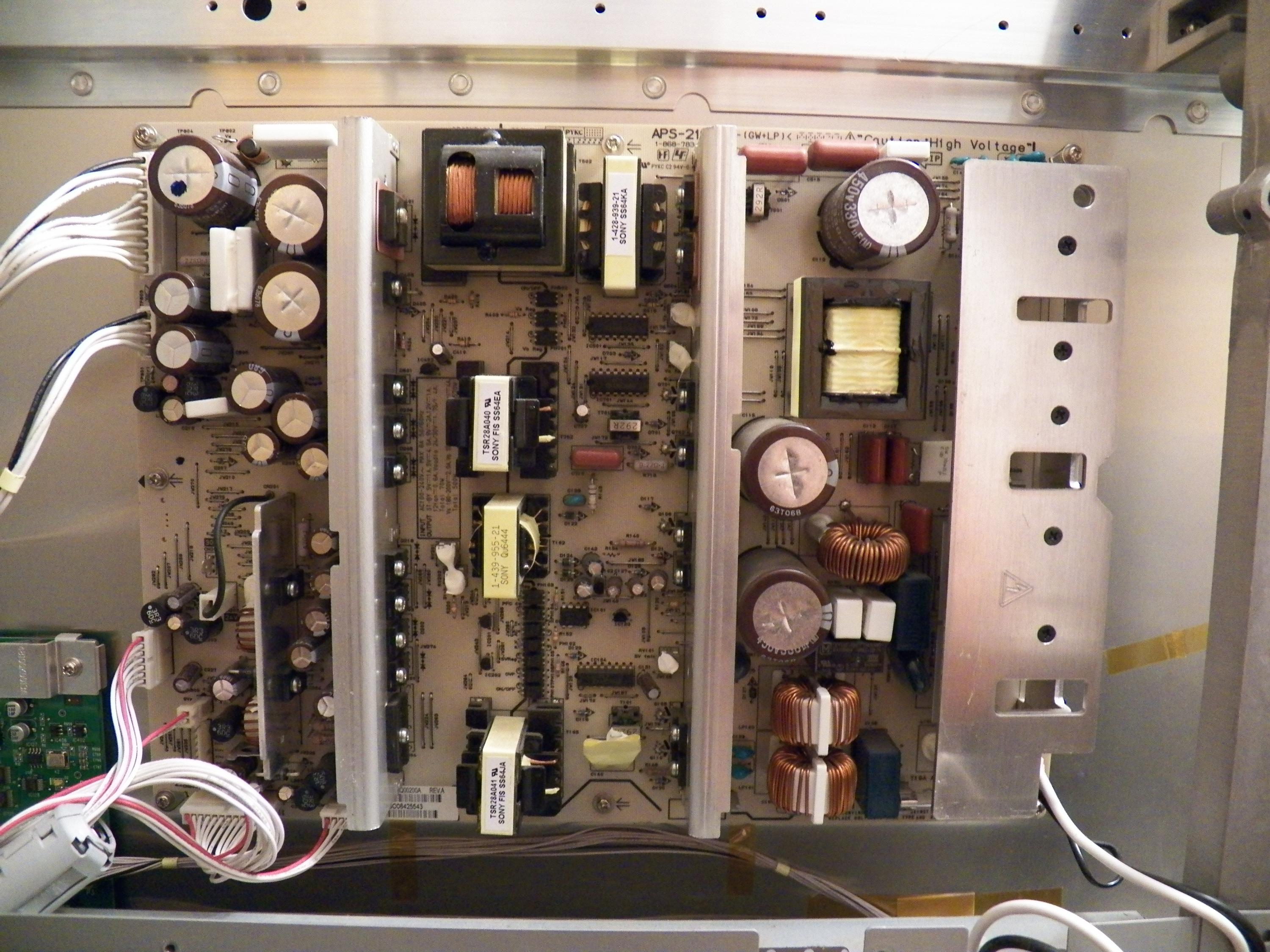

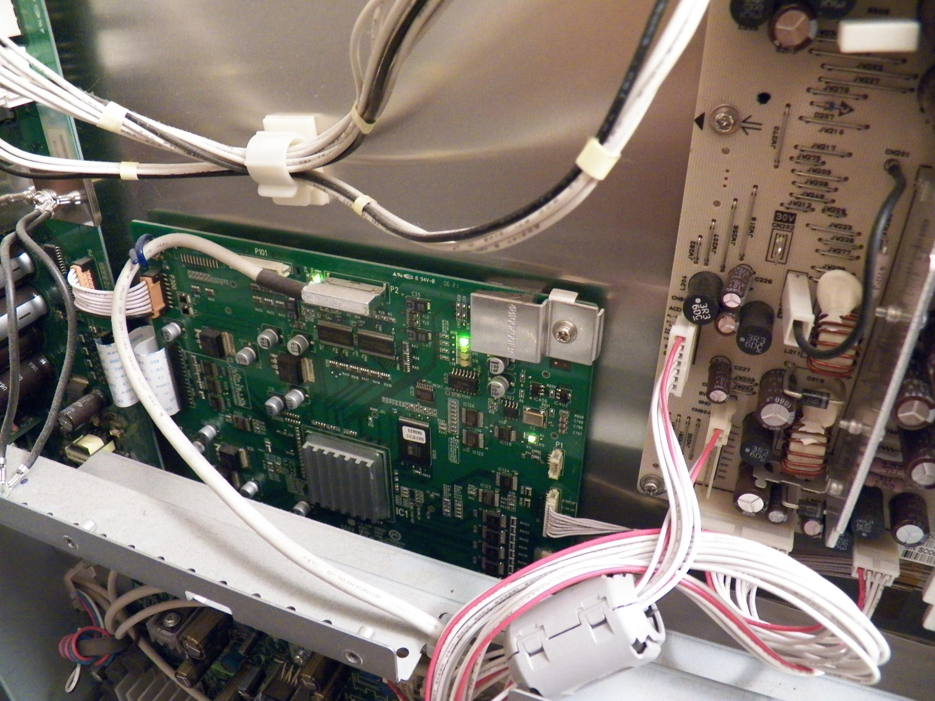

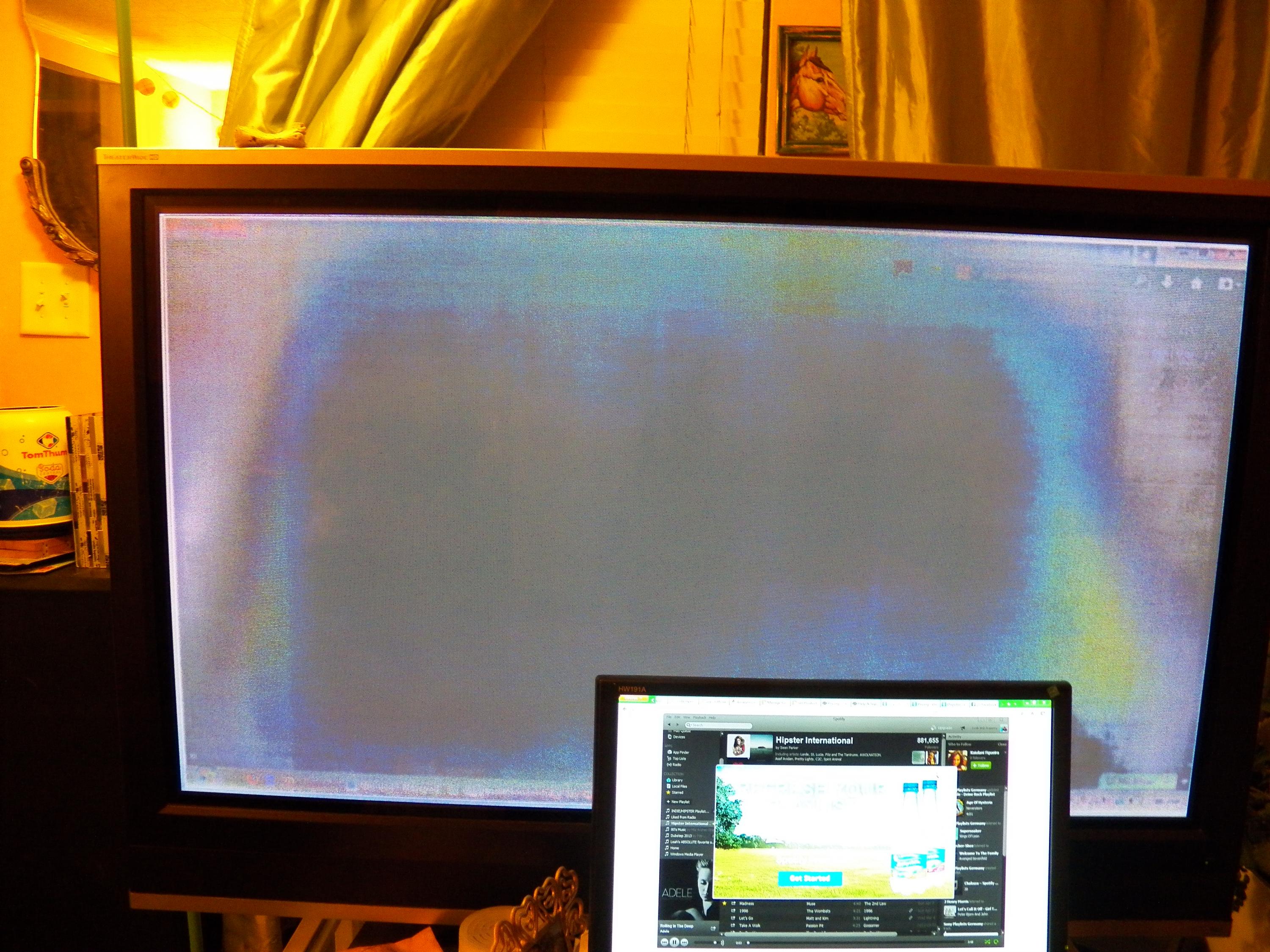

    We got this TV for free and it was working fine for the most part up until about a month ago. I haven't really had time to do anything about it til recently. Before it stopped working completely it would turn on and off until it warmed up, we'd speed this up by using a hair drying and point it towards the capacitors.
    Well long story short, it finally went off one day while my wife was watching it, and it....never turned back on! :O
    Since then I've taken the back off of it and played with the voltage nobs (to no avail sadly) on it, and checked out all the capacitors on it. None of them are bulged or burnt looking. Anyone have any ideas about what it could be? I'm not afraid to solder or take anything apart on it, I've done soldering before and it's not that bad. If it's gonna cost me like $1000 I'll just put it to the curb.
    I've uploaded a couple of photos for you guys to help, let me know if you need anything else. The first one is of what the TV looks like if it manages to stay on long enough to get a picture. It doesn't say "please wait thank you for your patience" anymore before it turns on. The second one is the Power Supply Board. The third is the lights that turn on in the back before it turns off. The one off by itself near the bottom flickers the whole time it's on.

    Are any LEDs lit on the front of the TV when it's plugged in? Also, with the TV unplugged, check the white ceramic fuses for continuity on the Y-Sustain and Z-Sustain boards with a multimeter. If you're unsure, the Y-Sus is the big board with large heat sinks to the left of the power supply, and the Z-Sus is the board with large heat sinks to the right of the power supply.
    Edit: Be careful adjusting the voltage knobs. Those voltages have to be fine-tuned to the panel specifications, and incorrectly adjusting them could cause problems.

                  Yeah the LED on the front of the TV turns on, when it turns on it's green, and when it turns off it's Red. I forgot to mention that I did in fact check all the fuses, they are good. The person who we got this from had messed with the voltage nobs on it, so I figured I couldn't hurt it anymore by doing the same. lol Is there some place that I can find the correct position for all of them?

                        Unfortunately, the positioning is based on measurements with a multimeter. With the TV unplugged, what I would do is adjust each of the knobs to their midway points for now.
                        To start diagnosing, I would probably disconnect the Y-Sus and Z-Sus from the power supply to see if your power supply (PSU) outputs correct and steady voltages. VS and VA are the important panel output voltages to check on the PSU. Obviously, if your PSU stays on with Y-Sus and Z-Sus disconnected, you'll have to adjust the VS and VA knobs to match the voltages on the label at the top of the panel. Judging by your first picture, you may have some sort of issue related to the panel (not necessarily the panel itself), or you may have a combination of panel and PSU issues.

                              I unplugged both the Y & Z boards and you can still hear the power supply clicking on....off....on....off. So what should I try next?

                                Ok, so it sounds like your PSU has a fault. I just remembered that one of the Toshibas I worked also had a bad PSU; I'm used to these mainly having sustain issues. Tracking down the issue may not be easy on this PSU. So, you can try to fix it on your own, or you can use a repair service like Coppell offers (very reputable company): http://www.ebay.com/itm/APS-219-E135...-/110654425901
                                Edit: This price is $10 cheaper - they may not have updated their pricing: http://www.coppelltvrepair.com/p/324...repair-service.
                                Used boards are a little as $35 on eBay. This one is close by in Georgia: http://www.ebay.com/itm/TOSHIBA-50HP...item1c355ee5c5
                                Edit 2: Sorry. You can try scanning the board with a flashlight to see if you can locate a burned component. Personally, I would just buy a used board if this reveals nothing.

                                      Like I mentioned previously, you probably have a couple issues. I'd try a cheap PSU replacement in an attempt to stabilize your PSU voltages, then I'd tackle any residual issues.
                                      Edit: I don't have a lot of experience doing standalone voltage tests on the PSU, but you may be able to disconnect all the boards at the PSU and force the power supply on using a resistor from ground on the PSU to a pin on the PSU. I believe it's the RL_ON pin on the CN801 connector. Someone else may have a better idea of how to do that. My thinking here is to eliminate the logic board or main board as potential causes of the clicking issue.
                                      Edit 2: Here's a video by norcal715: http://www.youtube.com/watch?v=dVaC2KVVLvs. If I remember correctly, RL_ON is the equiv. of PS_ON in LG TVs.
