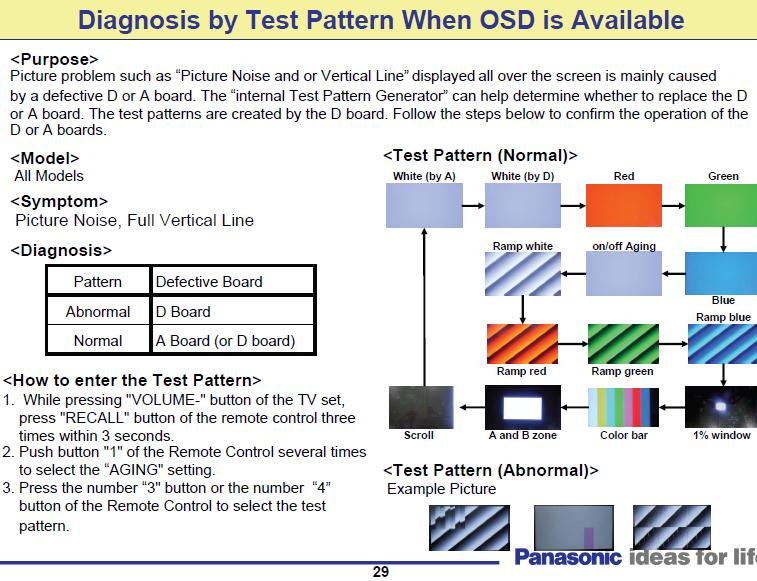

    SU board or A board.
    To rule in/out A board:
    Power the TV on.
    On the TV, hold the VOL- button.
    Press the RECALL button three times on the remote in quick succession.
    Wait approximately 10 seconds. Screen may flicker.
    Press the "2" button on the remote control twice.
    A pattern should appear. Press "2" again to cycle through each.
    Do the patterns cover the whole screen, or just the bottom?

        No, release it after pressing the third RECALL. Sorry for not mentioning that.
        Correction to above: "2" should be pressed each time to cycle not RED.

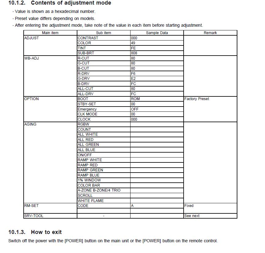

              Re: Panasonic th-50px77u
              I'll see if tw2005 turns up he may have a better idea about test pattern mode on these.
              • tw2005
                • Oct 2011
                • 6458
                serv menu , then select aging, then cycle through each pattern with the remote I believe.
                I expect bad SU would give half screen, but no harm in running the test though.

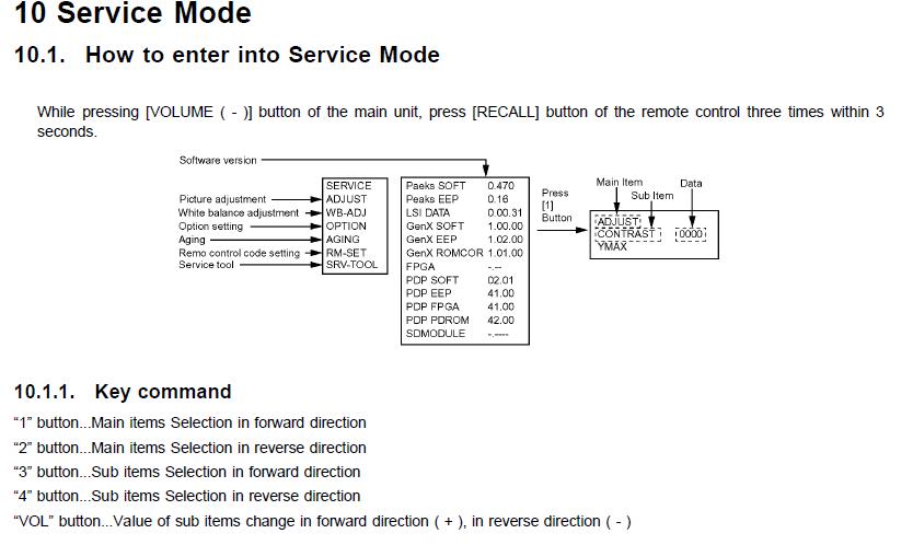

                  Just realised, with no top half he'll have no visibility of the serv menu. quick flick through the training, could also be D board and maybe SC.
                  Guide I have is called
                  panasonic_th-42-50px75u_th-42-40px77u_ch_gph10du_troubleshooting
                  I'm on mobile broadband, trying to save my limit otherwise i'd upload it.
                  I think you have that in your stockpile Tom.

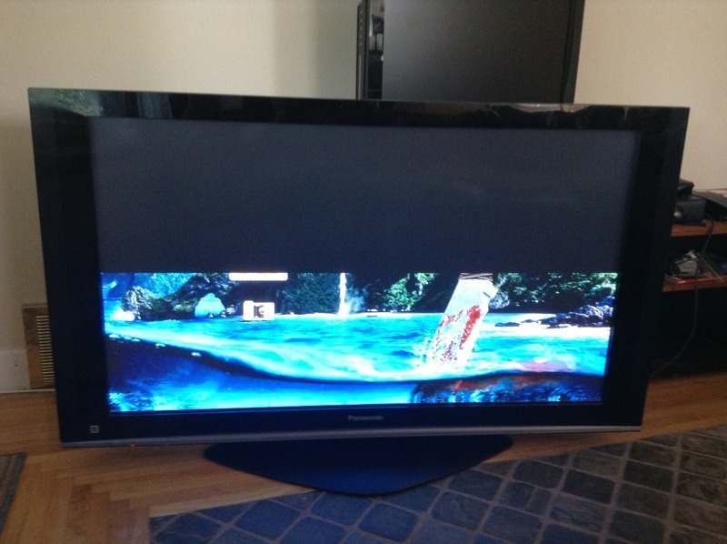

                    So,I became the proud owner of this tv.......
                    As per suggestion of Tom66 I ran the test screens....and it only shows up on the bottom halve of the screen,top halve stays dead...
                    So,does that rule "in" or rule "out the A board? Any suggestions on further testing?
                    I apologize for non existing pics of the boards,as I just brought it home and didn't pry it open yet
                    Proud owner of dozens of broken TV's and many,many,many boards.
                    Our website and passion:http://hollenhundshepherds.com/
                      It rules out the A board; the fault is on SU or D, most likely SU.

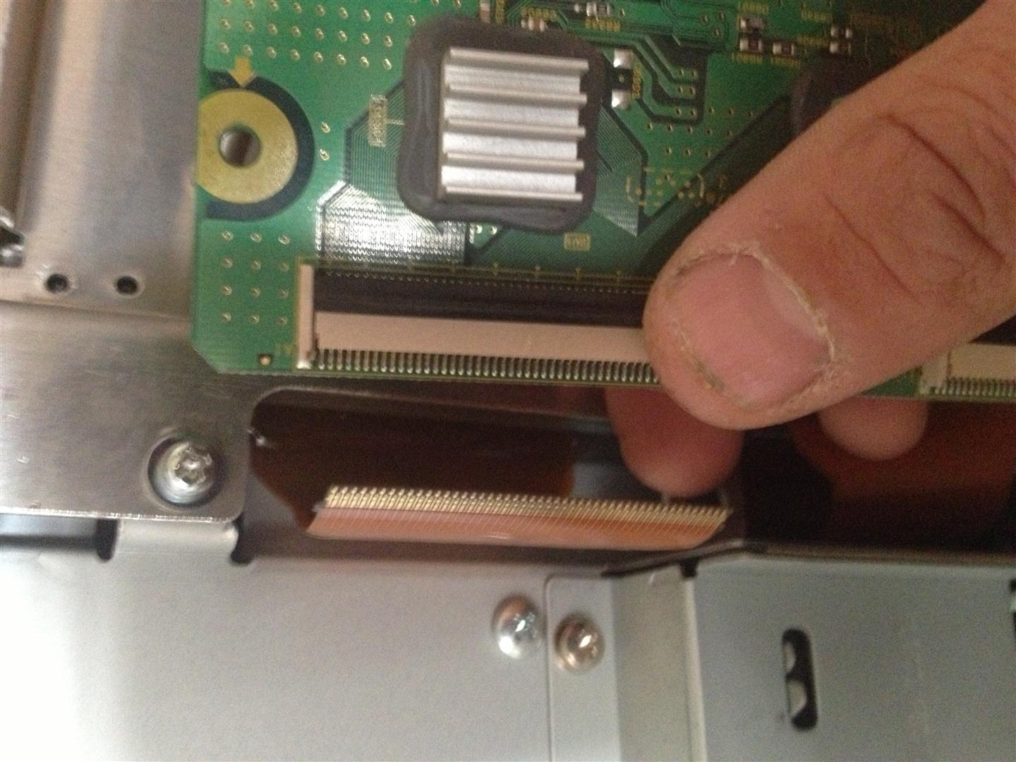

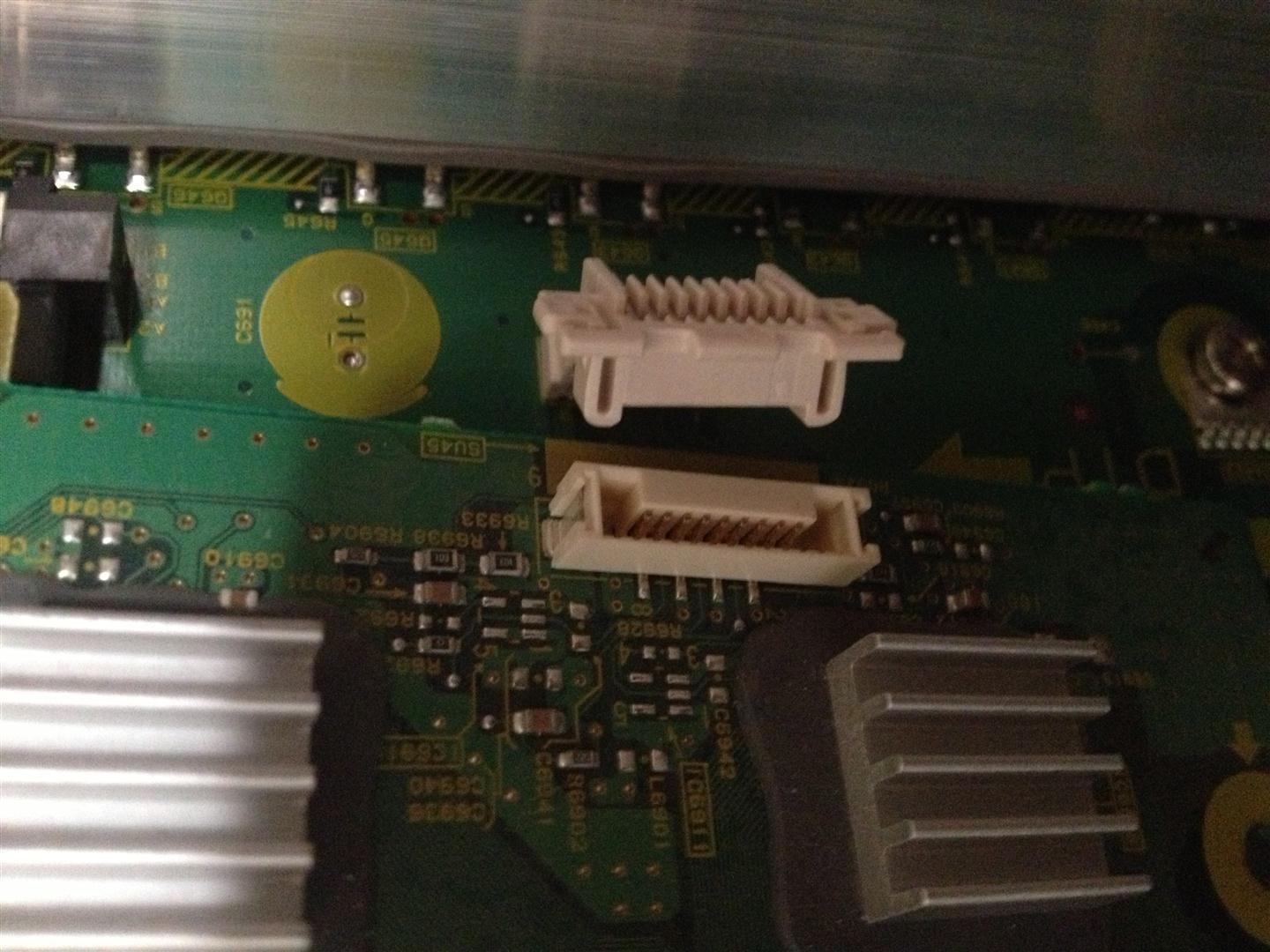

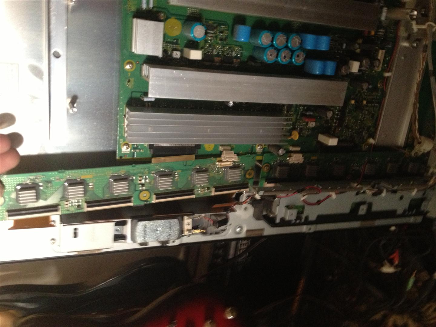

                                As promised some pic's from the buffer boards...
                                Replacing is easy,make sure TV is unplugged etc,pretty high voltage around the area you're working..
                                To avoid static discharge from you to a component,always touch a metal part in the TV before touching a board...
                                Just look at the pics to locate the boards,they are on the left side facing the gut side of the TV.
                                It's a few screws,some ribbon cables and plug,took pics of them..
                                Be careful with the ribbon cables are they are a bit fragile...To unplug them flip up the black clip on the connector(see pic) and carefully wiggle the ribbon out..
                                When seating the ribbon into new board,make sure it inserts fully and straight without using too much force...
                                Board numbers are: TNPA4188 and TNPA4189.
                                They can be bought as a pair for around $30 to $40 bucks....
                                BUT make sure you do the test pattern as described by TOM66 in post#2 in this thread to make sure it's indeed the buffer boards...
                                Hope this helps
                                **not sure why pic's uploaded side way's,sorry**
