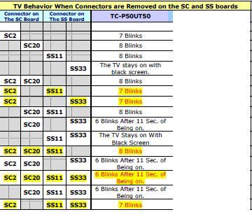

              post 1, Initially 8 blinks, ss disconnected, no blinks Chart says, SS11 SS33 disconnect, The TV Stays on With Black Screen suggests no blinks
              post 20, SC20 disconnected, 8 blinks charts says , SC20 disconnected, 8 Blinks
              post 28 SU/SD tested normal as per manual What did you do here, mearurement results?
              post 43 SU/SD isolation,SC50 test, OK (no blinks??) normal start, no picture,no blinks?

                        Similar problem here. It's a Costco model TC-50PU54. Instant shutdown; 8 blinks.
                        If you disconnect the A33 ribbon to the SS panel, TV comes on. Stays on, and there is sound, no video (except a flash of the "HDMI1" panel in the upper left corner.
                        If you reconnect that A33 ribbon, you get the quick shut down and 8 blinks.
                        Put an ohm meter to the TP101 spot on the C1 panel and checked ohms to chassis. It reads almost none, so it's close to a short.

                          You may have a shorted ic on the panel. One only other way to verify is pull the ribbons and visually blown

                                  I have the same problem with my Panasonic tc-p50u50 plasma. I unplugged the ss33 cable and it stayed on, but no picture. What now?

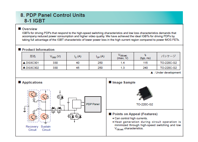

                                    I have TC-P50UT50 since Aug-2012 and all of a sudden yesterday TV went bad with 8 Blink behavior. I've extended warranty so trying to go through that first.
                                    But after searching through different Panasonic service manual, it seems like issue is with specific Transistor on SS Board. Most likely Q16051 which is most commonly used IGBT in Panasonic Plasma. Attached is the Panasonic Technical Bulletin and the exact part u can order.

                                      I just repaired a TC-P50UT50 for 8 blinks, it was the shorted transistor, diode and open resistor as in the panasonic bulletin above, worked great after repair. Also I would check the grounds (board to panel) on the sc board, they were'nt the best either, clean with a bit of sand paper.
