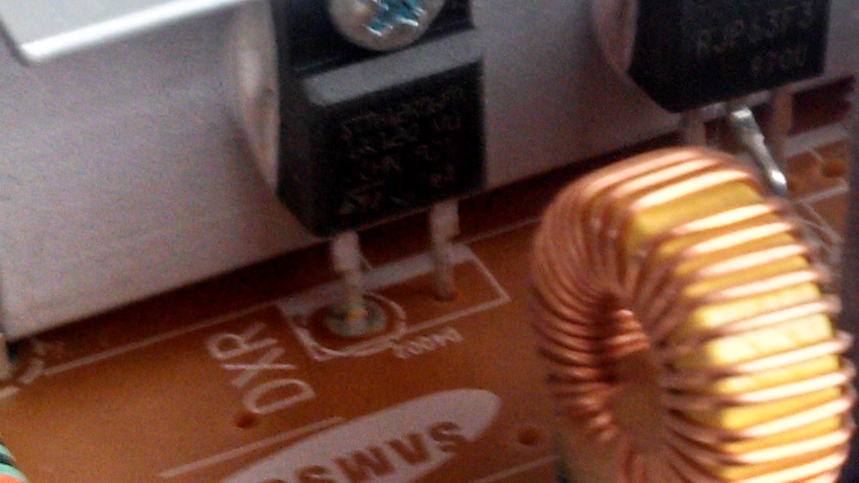

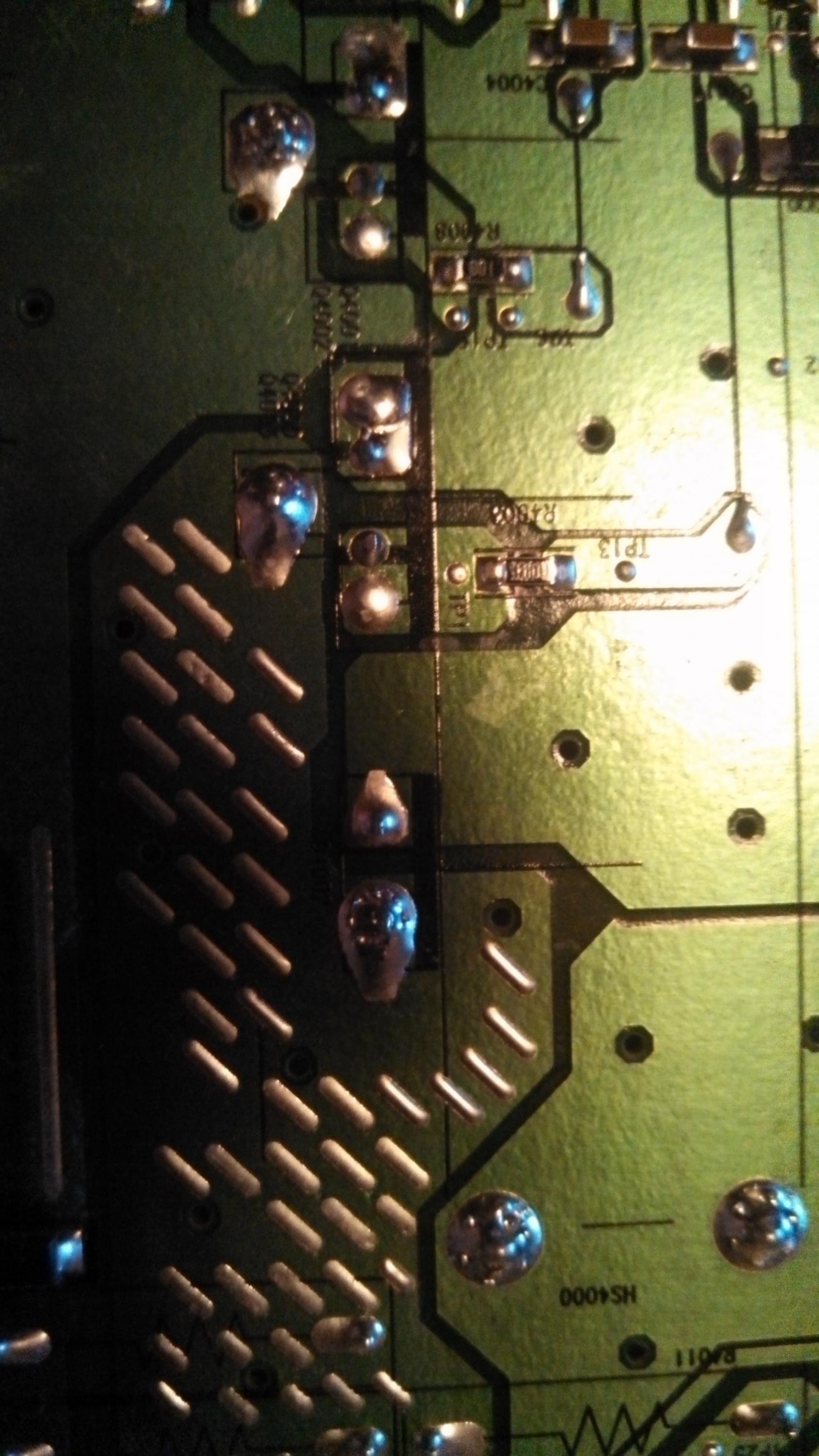

    I picked this tv up for free trying to fix it when I plug it in I get two red blinks by the power button, and the green led in the back blinks like it is trying to start up over and over. I have narrowed it down to the xmain I have a couple solder jounts that look iffy. I am thinking it is not shorted because the Y main is ok.I will get som picture on here to. any help would be great.

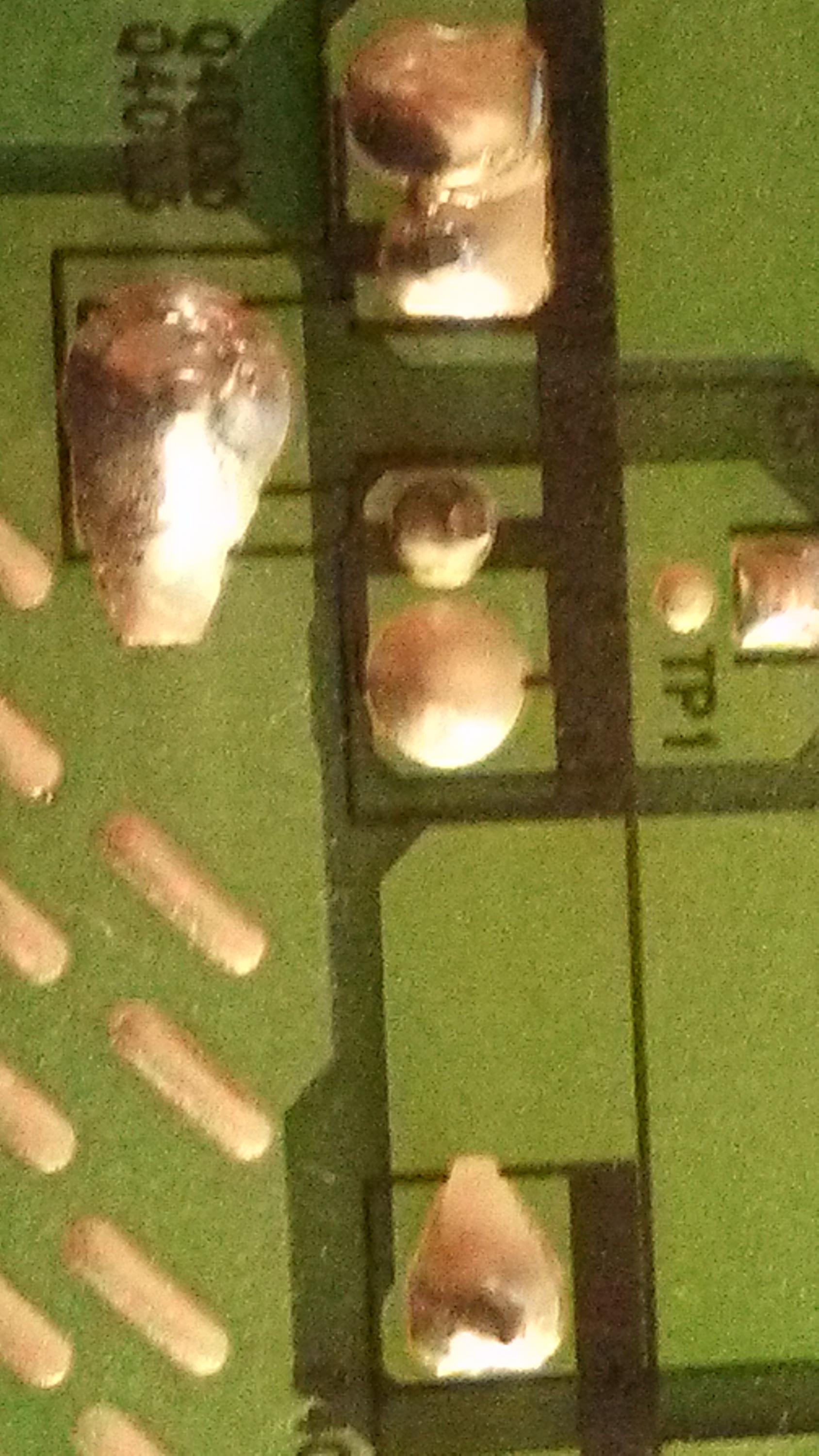

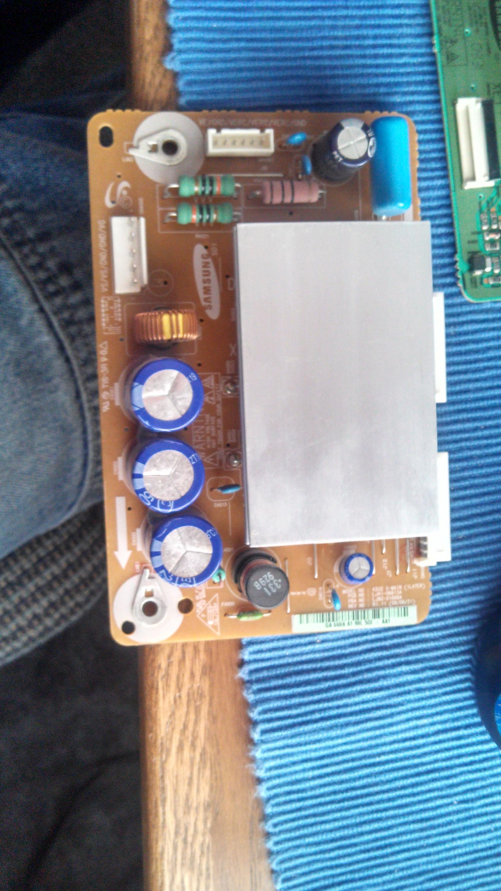

      It does and I have the x main out now. here are the pictures of it. The third picture is the one with bad solder joint I think, should there be continuity between the two post's? There is none on those two.

        Re: 42"Samsung Plasma problems.
        It's hard to tell from the pic. I'd just go ahead and re-solder it and anything else that looks questionable.

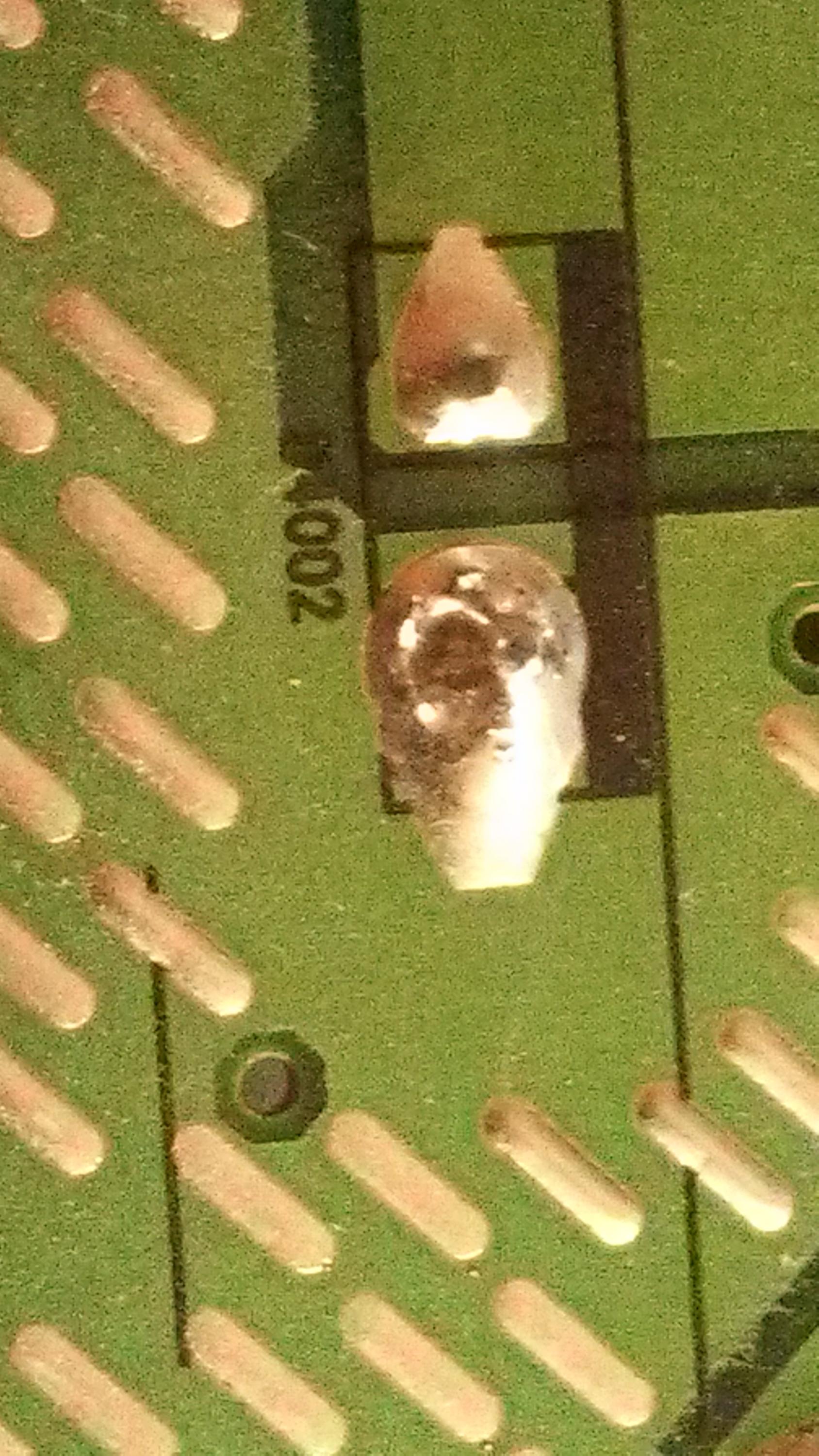

          This one might be more clear.
            Yeah I am going to try it the one post has a hole in the solder. I have high hopes that's what it is .
              I can't see anything wrong in that pic, either. Once you fix up your joints, I'd move on to testing the heat sink components. You may have to de-solder them individually if your readings aren't definitive.
