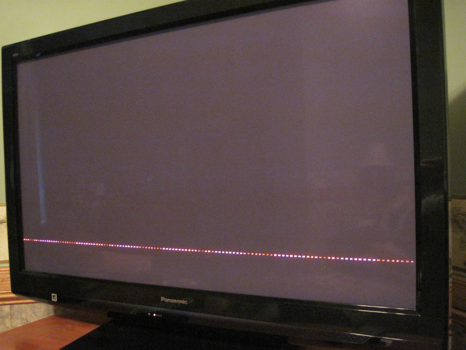

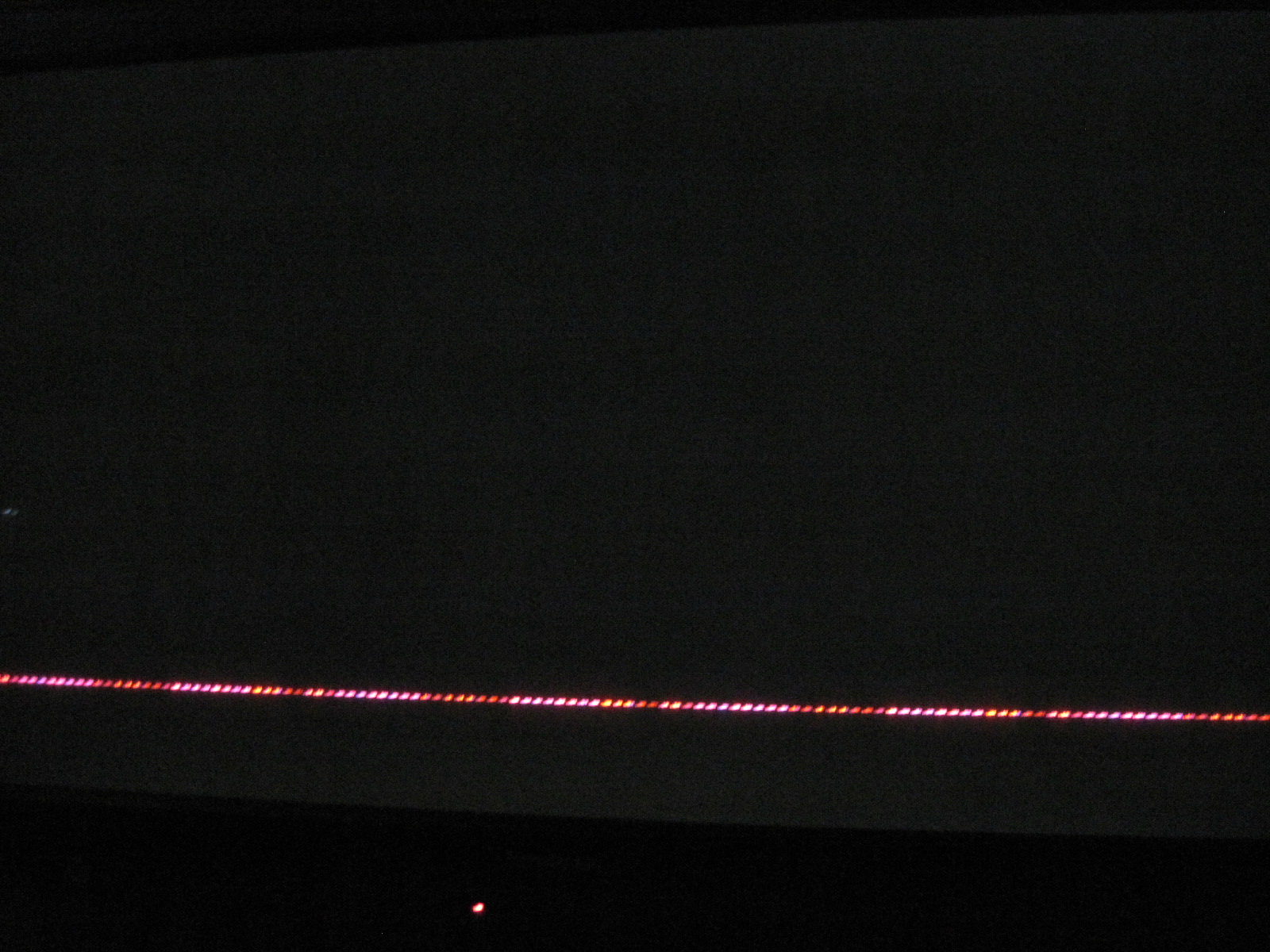

    Panasonic TCP42S2 horizontal line

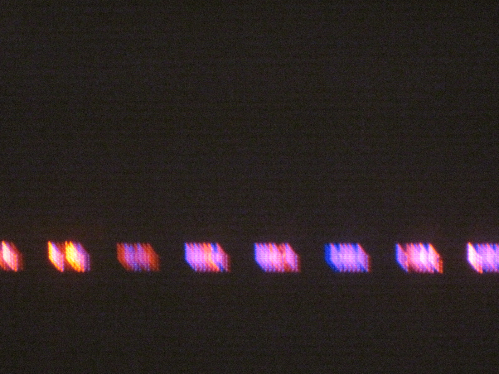

    Last week a thin red horizontal line appeared on the lower part of the screen. Its there even with no input devices on. The set is 2 1/2 years old.
    Any ideas?
    Thanks!!

      Re: Panasonic TCP42S2 horizontal line
      That's very digital and in blocks in appearance.

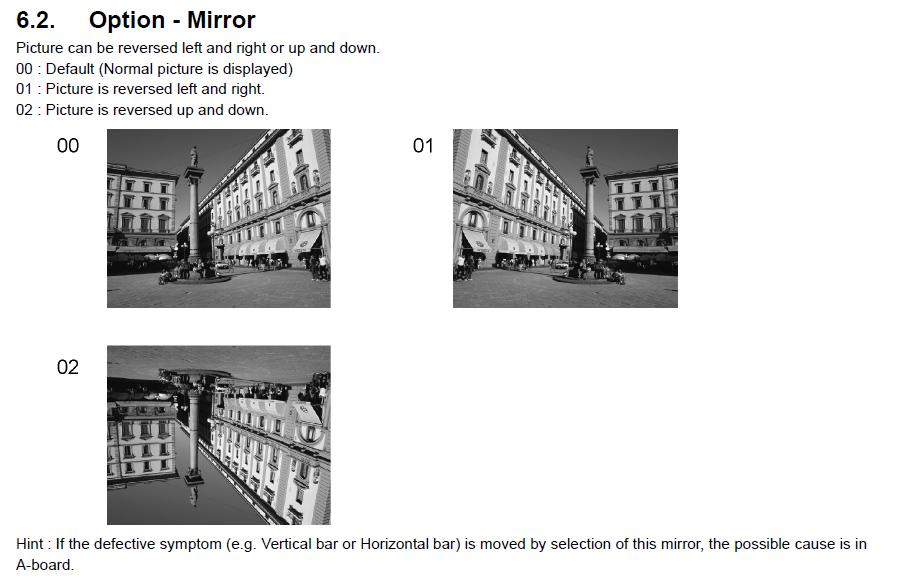

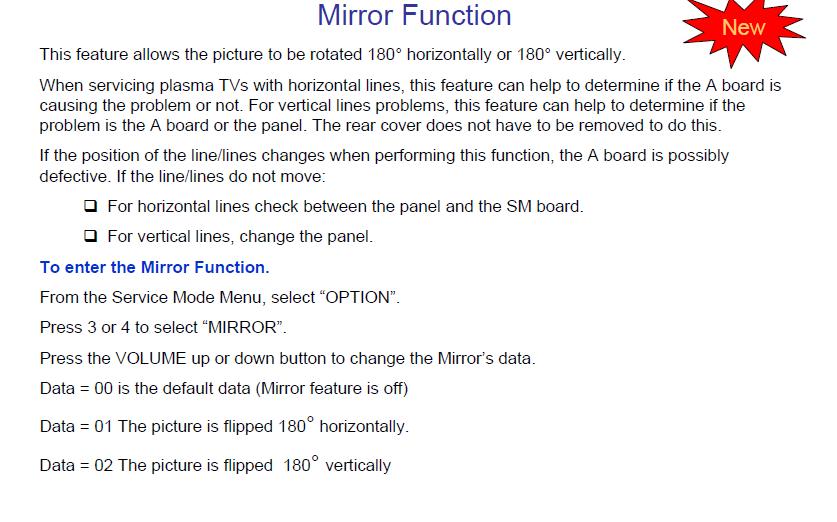

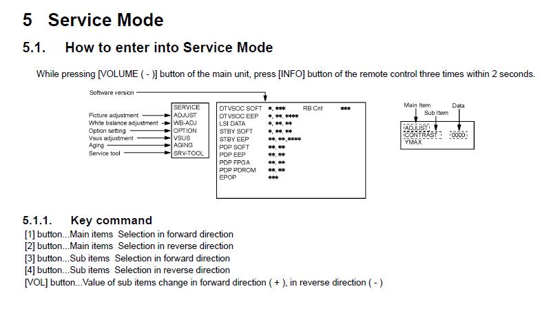

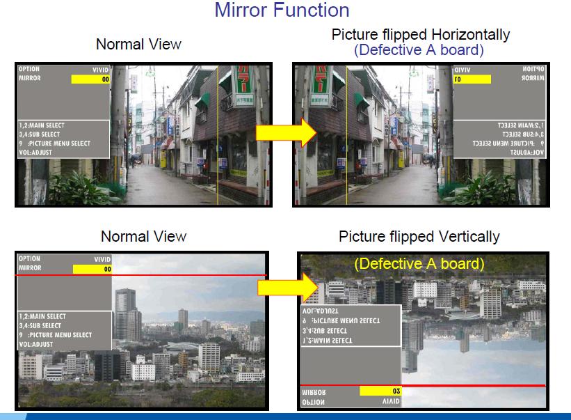

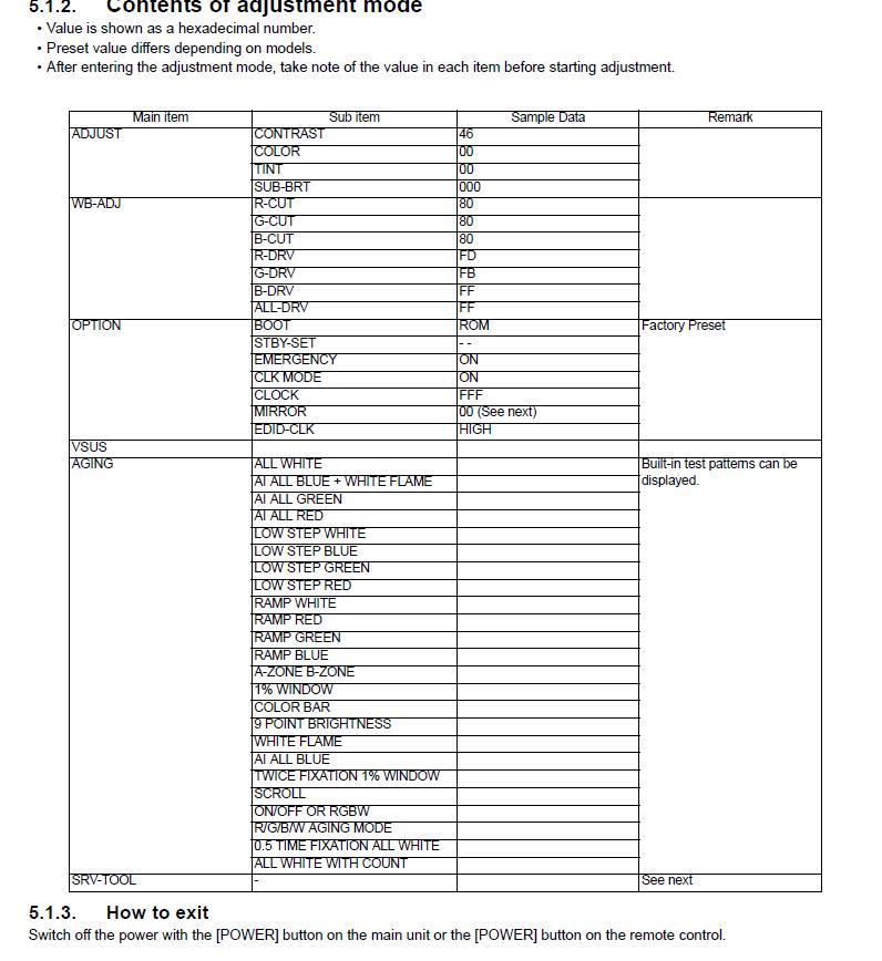

      If me, first thing I'd try if you have a copy of the service manual is the vertical flip in the service menu and see if those coloured blocks go to the top of the screen.

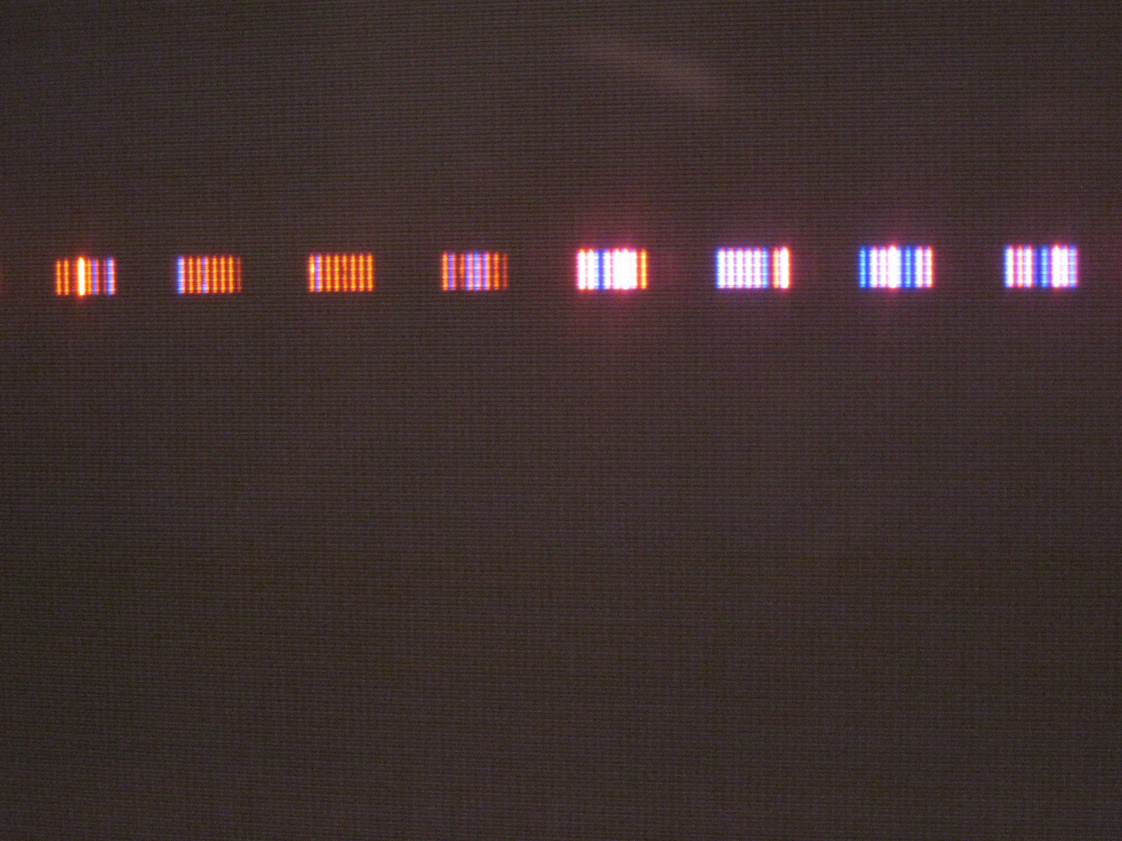

        Thanks Tom and tw2005. I tried a new buffer which didn't help. The line moved with the picture in the mirror test so it looks like I need an A-board. I'll start looking.
          Yeah for me it was a symmetrical pattern as opposed to a continous line. If your into experimenting I wonder if it's being generated or possibly a faulty A board buffer ICs ?
          TNPH0831 (version, no suffix) , TXN/A1LHUUS if SJ is correct. P42S2
          IC9400,9401,9402 (underside) . TC74VHCT541AF (Texas Inst equivalent SN74AHCT541NSR) should only be about $1 ea,
          Maybe you have some scrap boards with the same part fitted, they're not too hard to work with size wise.
