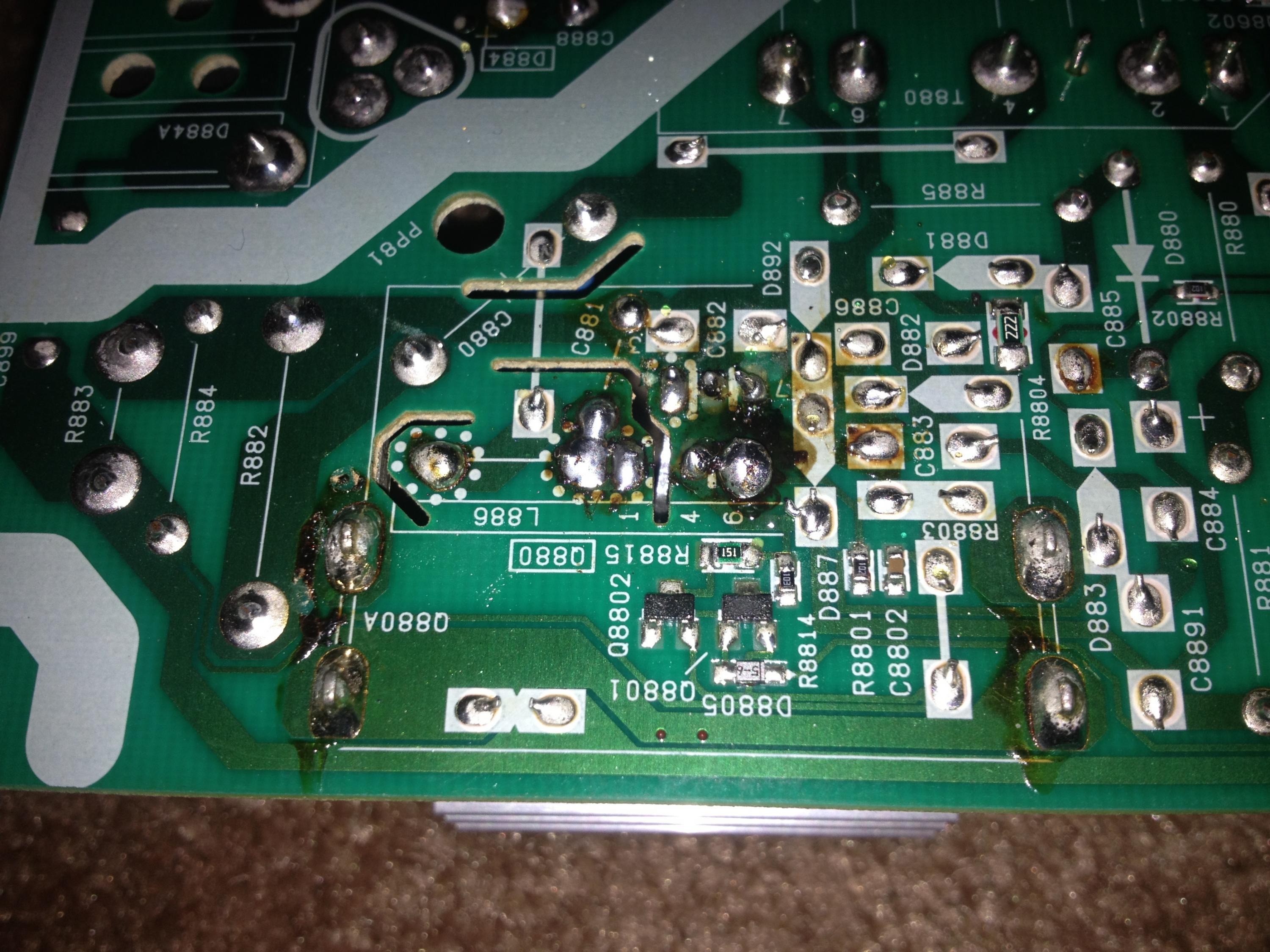

So I got one of the it's I replaced to stop getting hot by putting more heat sink paste on it. I didn't put much on before. But ic q880 is still getting hot. There is a diode next to it but I think it's fine but I'm not sure how to test it. Also there are two rectifier diodes on the opposite side of the board next to q820 that both have burn marks on the solder joints K. I don't know if this would mess the other ic up or not.Comment
Re: Toshiba 42hl196 no power no led flash

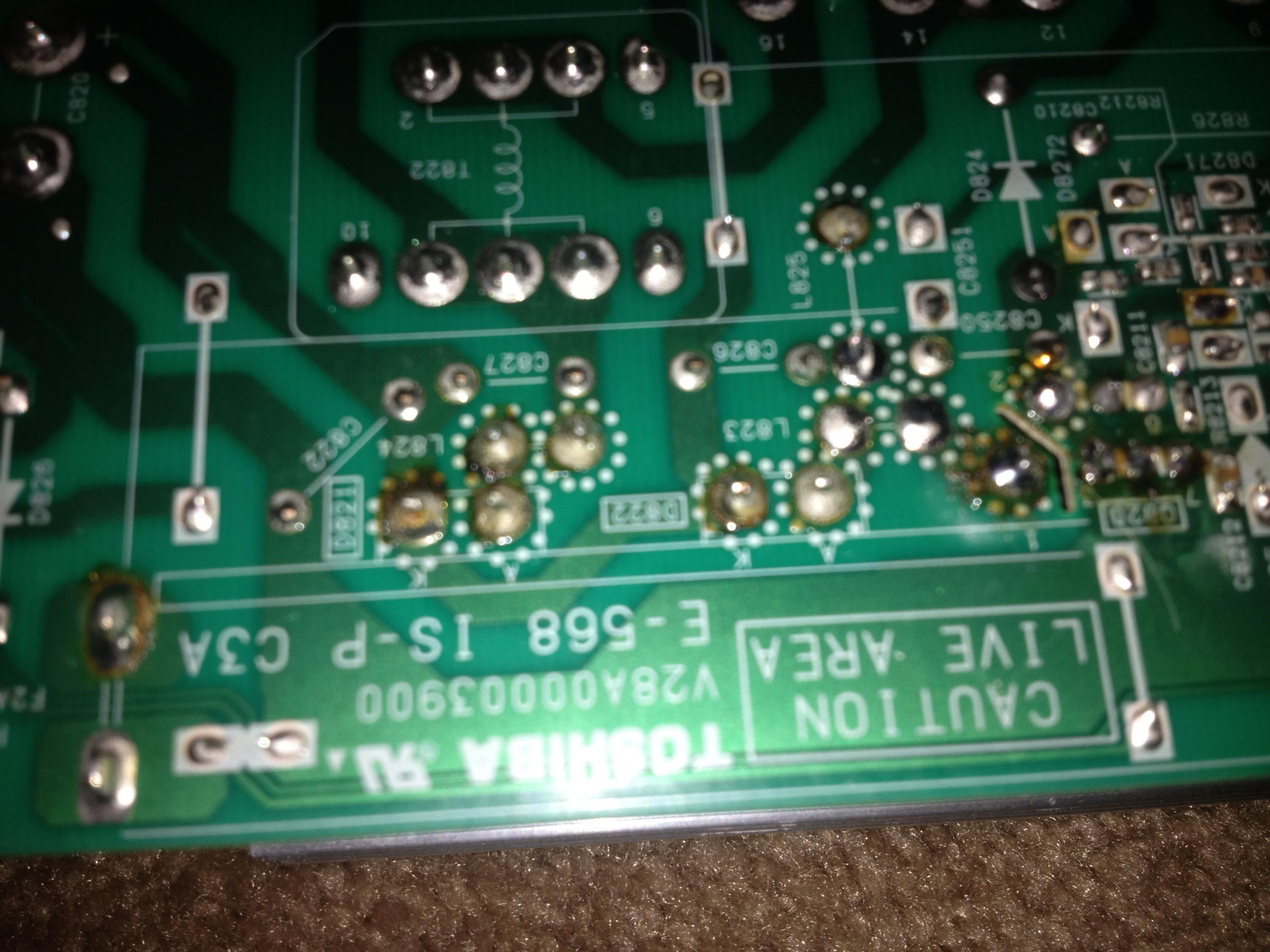

Can you provide pics showing the burns?

This the picture of the rectifier diodes with the burn mark on the K pole.Comment

And here is the burn marks on the other side. Ignore the big middle one if you can that was from soldering. The one pole didnt want to take the solderComment

The pict above is some of the burn marks. Ignore the big one in the center I did that cause the one pin wouldn't take the solder.Comment
The picture isn't the clearest, but those don't look like damaged components. It's probably flux residue.Comment
I know its hard to get a good picture of it. It just looks like it was from the solder joint getting hot cause the same kinda burnt look is on the heat sink solder joints to the board. How can I test the diode that's next to one of the ic on a heat sink.Comment
