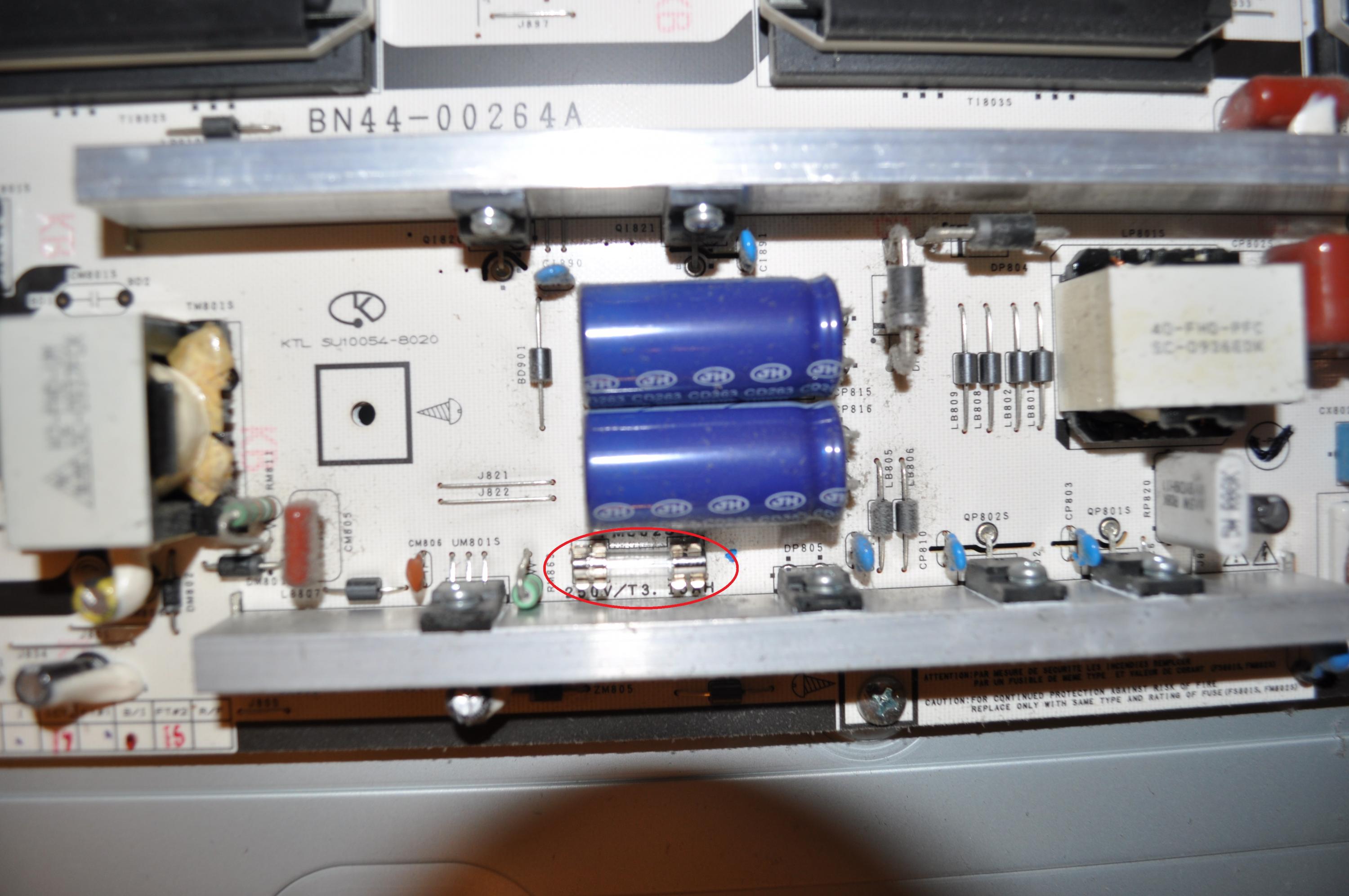

    Samsung LN40B630N1F PSU Problem
    I just picked up a Samsung LN40B630N1F that will not power up no lights on the front at all. When I opened it I found the fuse noted below in the picture blown. I replaced the fuse and as soon as I put AC power to the board the fuse blew again. I thin pulled the board out of the inverter sockets and disconnected it from the main board put AC to it and the fuse blew again. With the fuse removed I have around 160vdc volts across the fuse sockets and about 33vdc to ground both sides.

        Re: Samsung LN40B630N1F PSU Problem
        It's dead, Jim... You'll likely have to replace a few resistors and diodes around them, but it's transformer isolated so the controller IC should be OK.

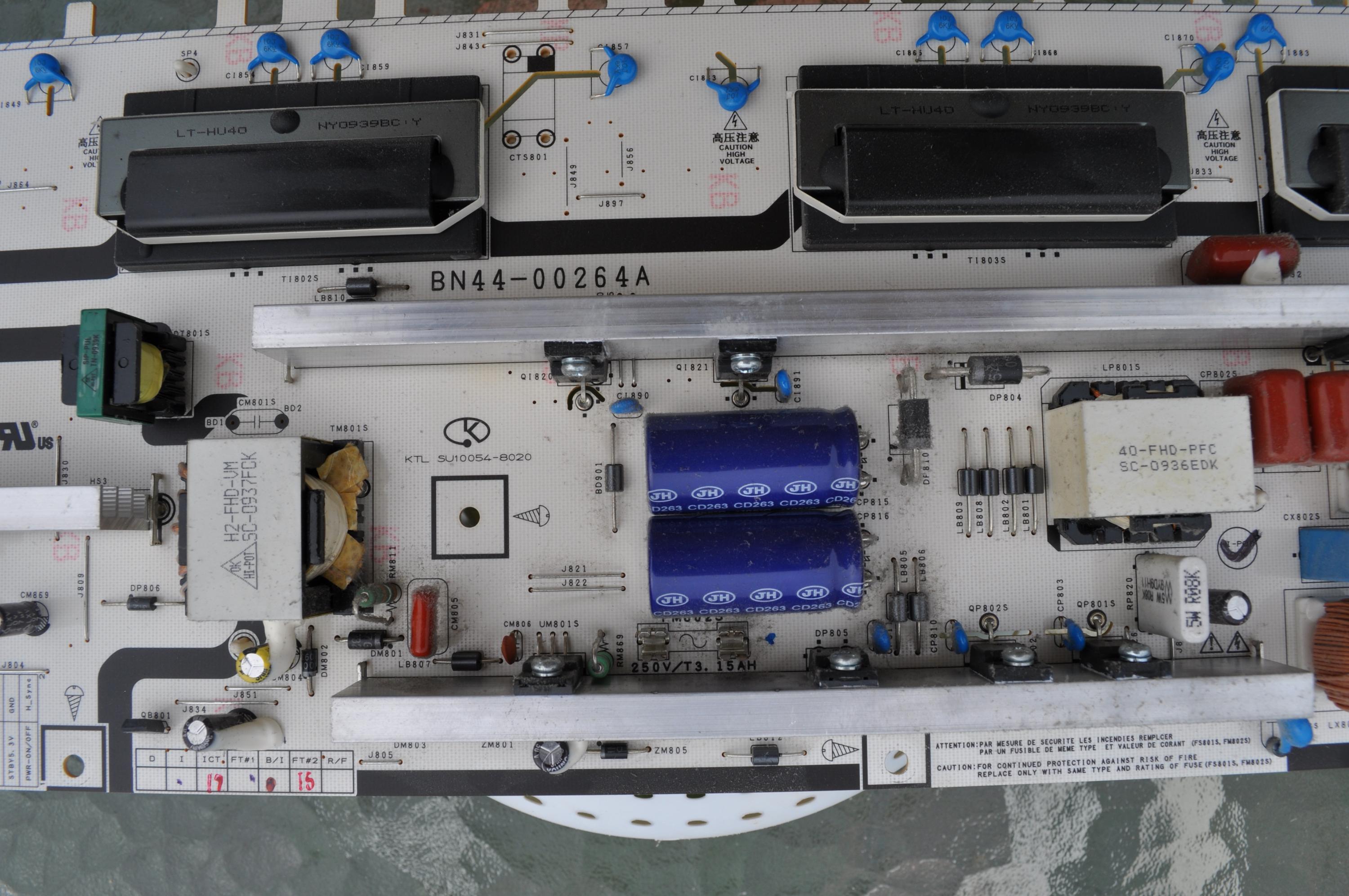

                                  Is your board # is BN44-00264A? If it is then take the resistance readings as shown in post 3~10 and report the readings.
