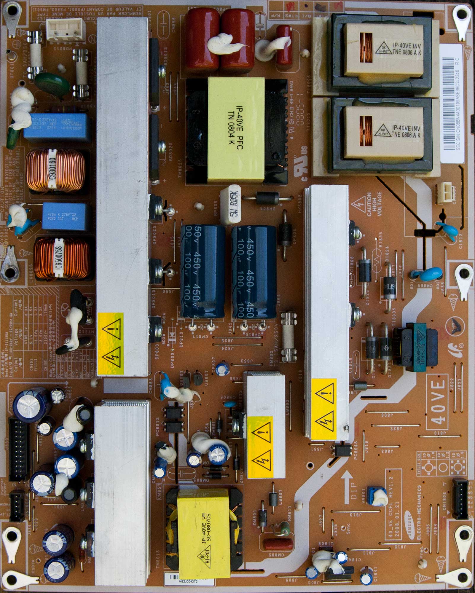

    Hello I got this tv today, It has already been worked over by someone. They replaced 4 caps in the primary (nec replacements read .02 esr) all the other larger caps read .01, there are three small caps (about 1uf) two read .33 and one is .46 Im not sure if this means they are bad or not, still trying to get used to the blue esr meter. I get standby power (5v) chime when I push power on, however no light below the logo like my other samsung.
    I have 12v going from power supply to inverter board on top harness. All the transformers on the inverter read the same EXCEPT the vertical one in the center of the board it is reading as shorted across the side with 3 leads, I haven't had time to unsolder that one yet and see if it is the transformer or something else.
    They seem to have damaged the flip latch for the lvds cable leaving the main board any one got an easy fix for that? I will post more testing tomorrow after I find the test leads for the oscilloscope.

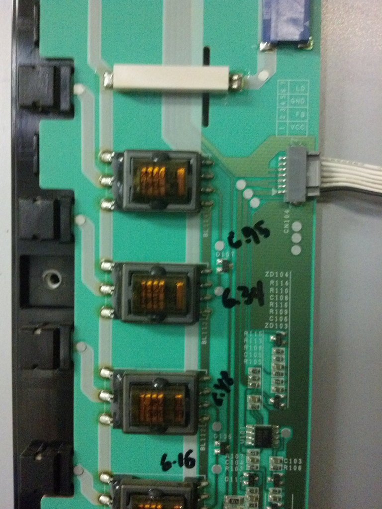

                I just finished testing all the feed back points, as described in that video. from top to bottom

                  393vdc: That is good, the PFC Voltage booster is working. I am not sure about those voltage reading on those test point yet, per video, they should not be that high.
                  Can you take close up at one of those test point you use, also the small connector on the balancer board so I can see what kind of signal names on those pins of the connector.

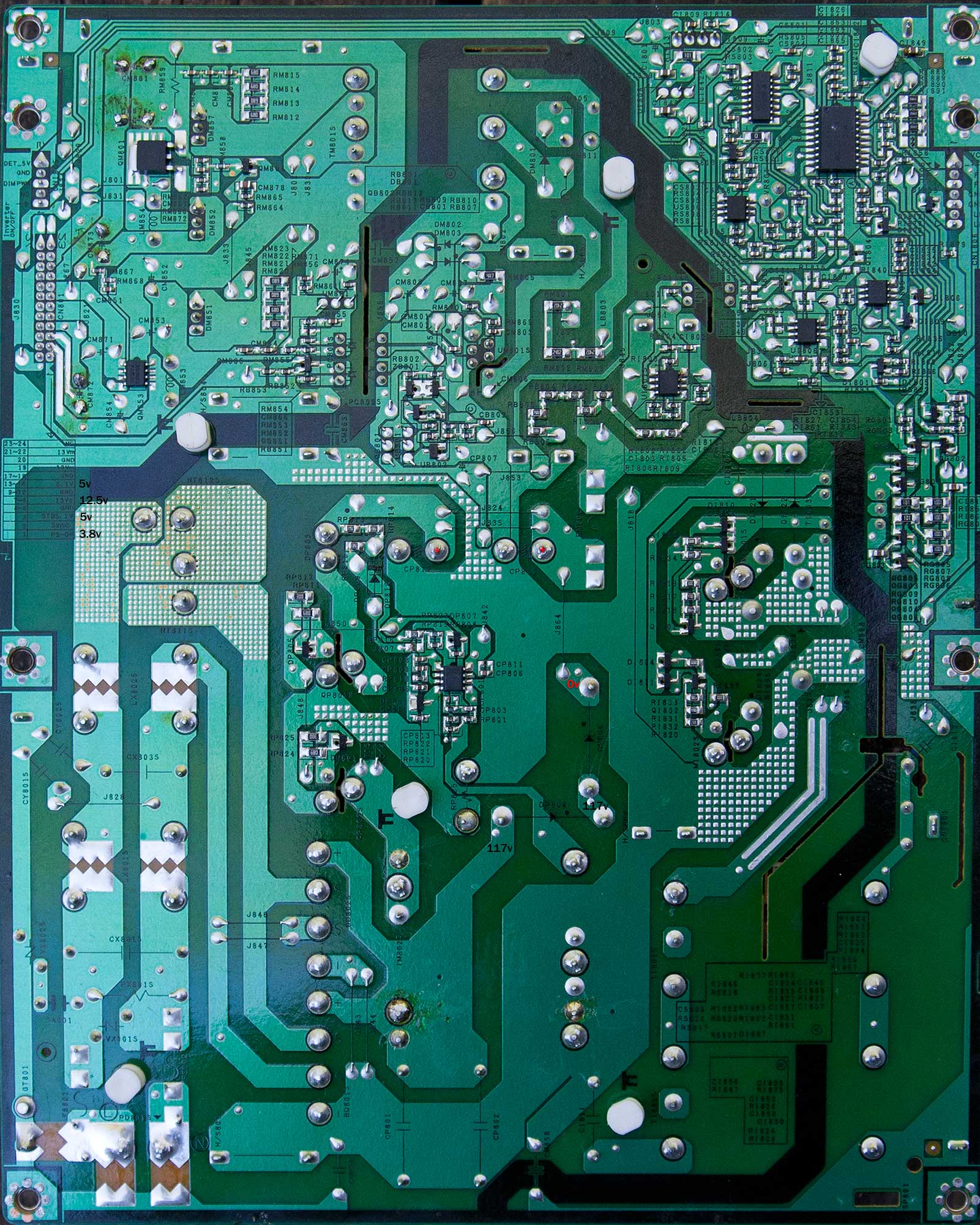

                  Here is the diagram BN44-00199A with the help from Tom.
                  Check the voltage on the power supply board connector CNI806 FB, LD, vcc pins as shown in the diagram, at TV off and at TV ON, the voltages may appear real fast.

                    Ok here is the closeup
                    it reads
                    LD tv off no voltage either side tv on 3.86 v on power supply side tested again and saw a high of 6v
                    GND
                    FB tv off no voltage either side tv on 18.8 v inverter side
                    VCC is 12v with tv on 0v off with cord plugged or unplugged
                    do i need to do it with the cable plugged in as well? only have 12v with the cable plugged in.

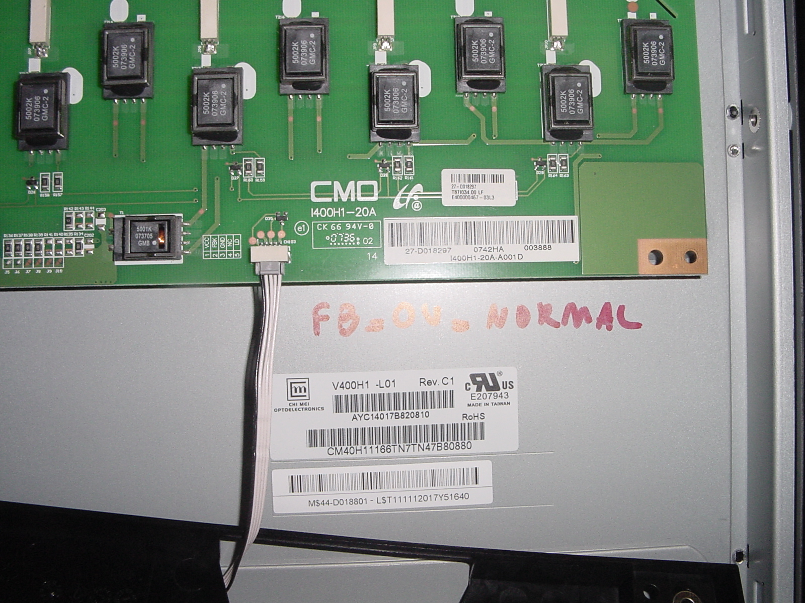

                                        FB DC reading on working Inverter board.
                                        LD should stays HIGH:
                                        https://www.badcaps.net/forum/showth...=LD#post353822 POST23.
                                        And this one:
                                        https://www.badcaps.net/forum/showth...=LD#post349300
