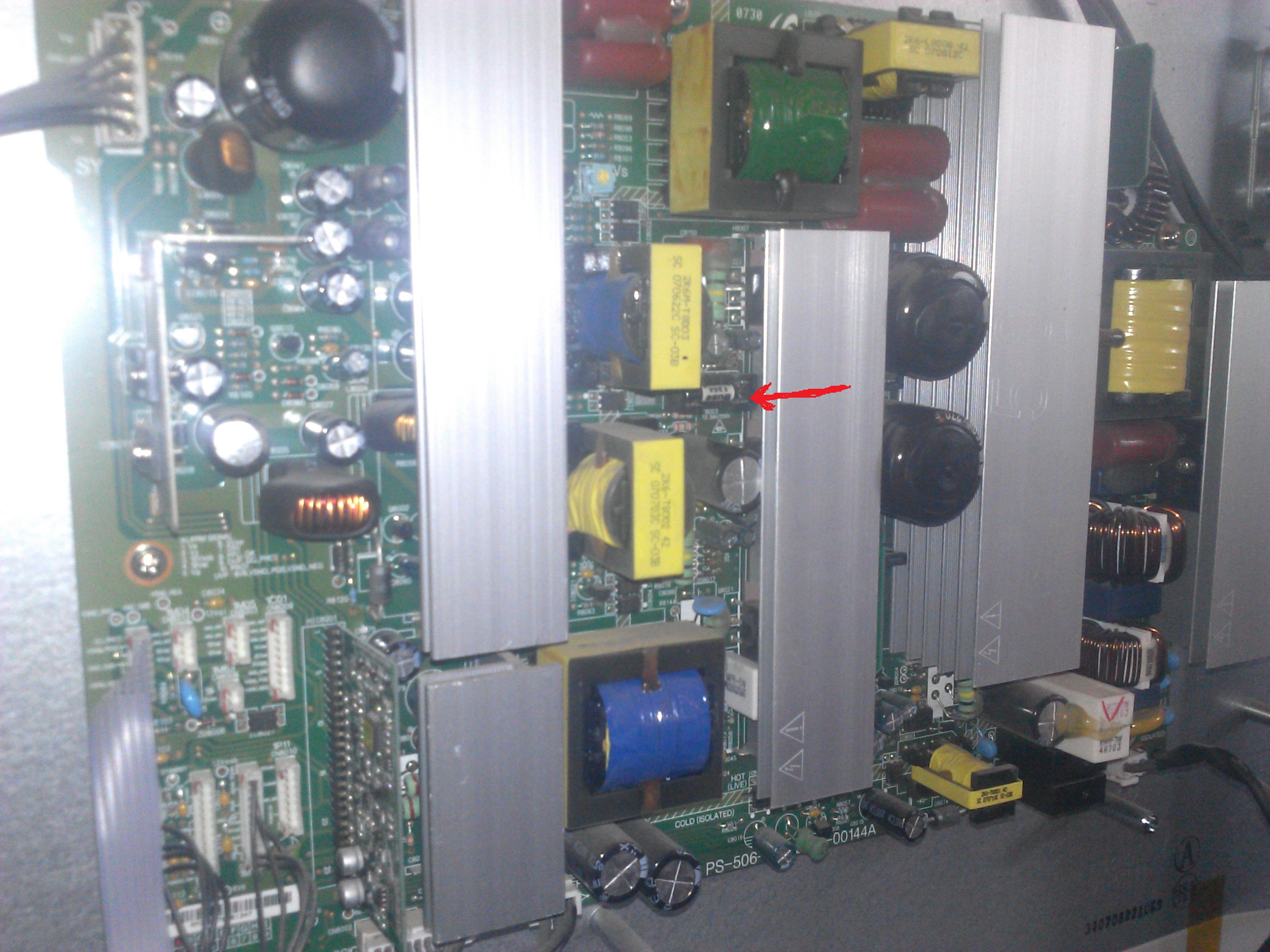

            Hello Everyone,
            I am a newbie this is my first post and this thread seems to be the closest to the problem I am having with my Philips Plasma 50PFP5332D/37.
            Power on light comes on blue, you hear the click and then red light flashes 6 times.
            I found a problem fuse on power supply board (see pic with red arrow showing fuse) and replaced it with new one. Powered on and blew fuse right away with same red flashing light. Now I am stumped Does anyone have any advice on how to troubleshoot or best guess problem from experience? Any help greatly appreciated
