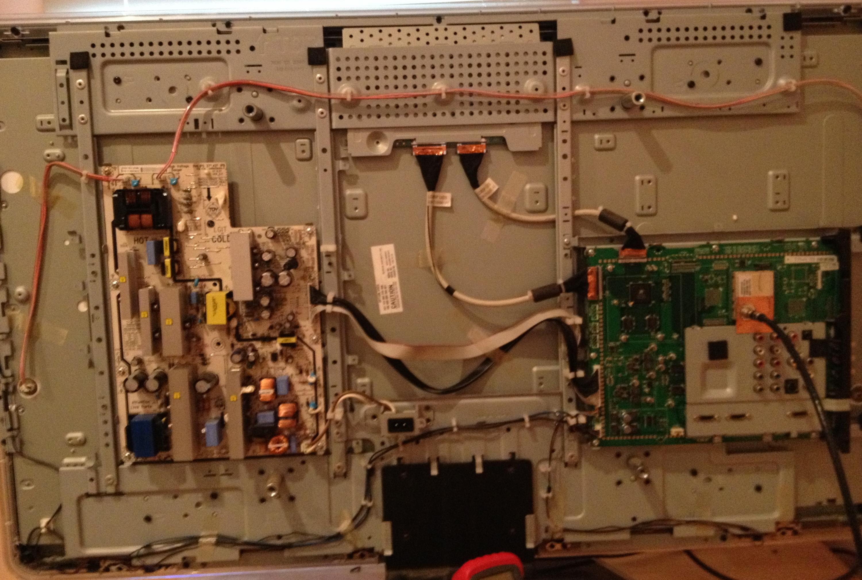

    I am trying to check the T-Con board for any visual defect in an attempt to revive a dead LCD TV. Both PS and SS boards showed no visual damage and they were easy to remove. The T-Con board though seems to be under a riveted subframe holding both PS and SS boards. Before proceeding to remove it all, I was wondering if there is an easier way to access it.(Shown on 1st picture)
    No indication in the Service Manual for this TV set on how to remove the T-Con board. It is shown as an intrinsic part of the subframe or the LCD panel.

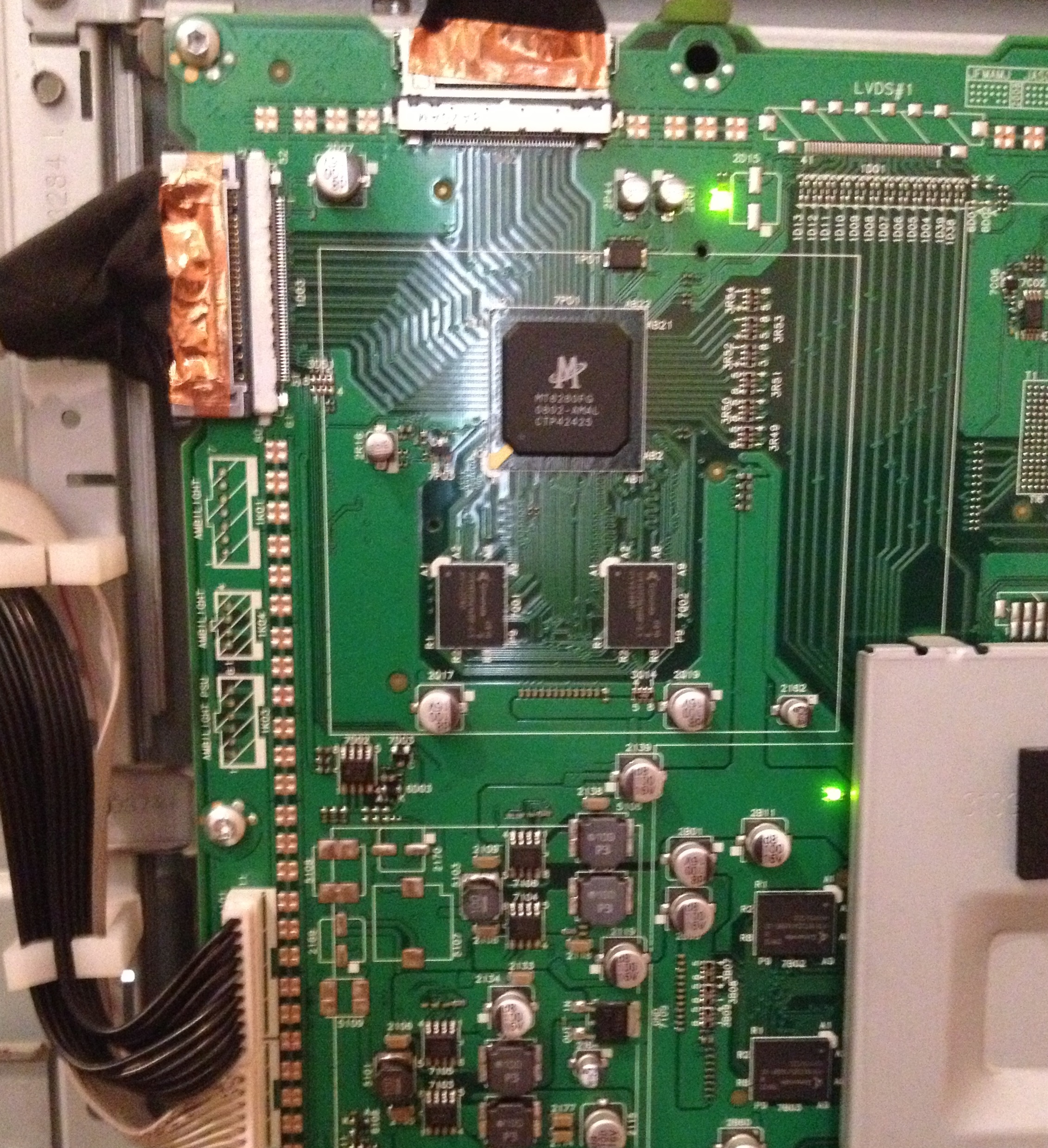

    Middle LED turns on (GREEN) on SSB (Main Board/SSB 313912363528V1 WK744.2) (Shown on 2nd picture)

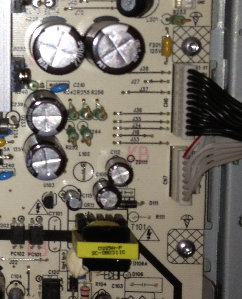

    3v3 measured at jumpers J38 J27 and J37 (Jumpers Shown on 3th picture)

    3 seconds later top SSB green LED turns on followed by the backlight (Shown on 2nd picture)

    3v3 measured at jumper J38
    J27 and J37: 16 mv
    J36 27v8
    J35 and J34 14v2
    J18 11v9 and
    J33 0v5
    On the SSB both LEDs remain on, steady green and the SSB CPU is hot to the touch.

    Since no one dared to provide a single comment, I'm glad to report that I have found a way to reach n remove the T-Con board by removing few screws holding the top of the subframe.
    Have found blown SMD 3A fast acting fuse on the T-Con. Tried to replace it first with a regular fuse and that has fried the PSB. Got both boards (used) on eBay, replaced them and I got the TV to work tonight. Buying used TV parts has its shortcome: I have to send back the first $19 T-Con board for it was sold defective (only generating a bunch of vertical colored lines). the second one, bought for $21 was good.
