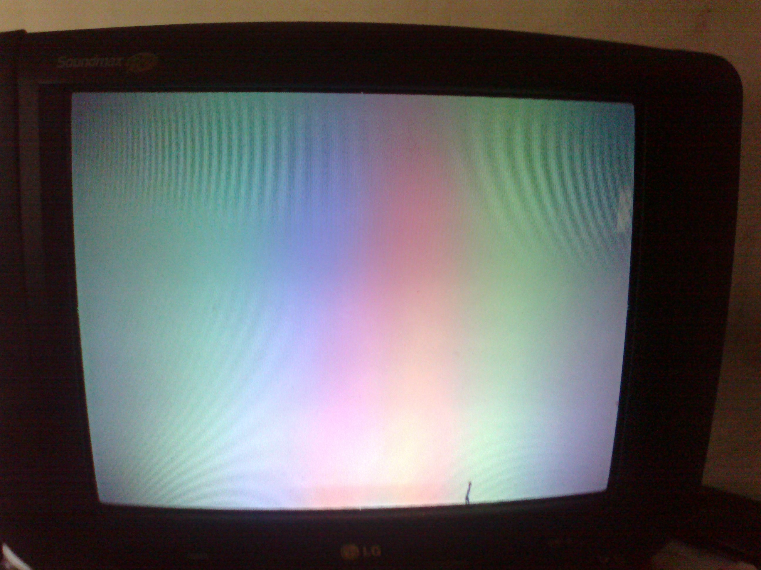

    LG CT-21D31KE Tv, showing green, blue and red vertical lines but sound is ok.
    Hello all, there is a Lg CT-21D31KE tv i am working on presently, it shows some green, blue and red cvertical lines only no other picture. but it produces sound. Can any give me any suggestin?
    Re: LG CT-21D31KE Tv, showing green, blue and red vertical lines but sound is ok.
    CRT? It sounds like the beams are not converged and you have no horizontal drive. Could be bad caps I have heard of this with other CRTs.
      Thanks Tom, apart from caps, can any other cmpnent cause it, like the line transfomer?
        I don't know much about CRTs (never repaired one), but I don't think it could,. Can you show a picture of the fault?
          That is it Tom.
            To me, that looks more like FOCUS voltage is bad, which can be LOPT or FOCUS divider. Try adjusting FOCUS to see if picture changes, if it does then the FOCUS divider may be OK and it is the LOPT at fault due to low FOCUS voltage.
              I have adjusted the focus and the picture changes but i don't no what's LOPT can you please explain? Thanks.
                LOPT same as line transformer / flyback.
                  Or, the high voltage transformer
                  Ok, have you checked all voltages, B+, etc...?
                    Ok. Thanks for the explanation, i have tested all voltages and they are all ok. I think i should replace the LOPT then.
