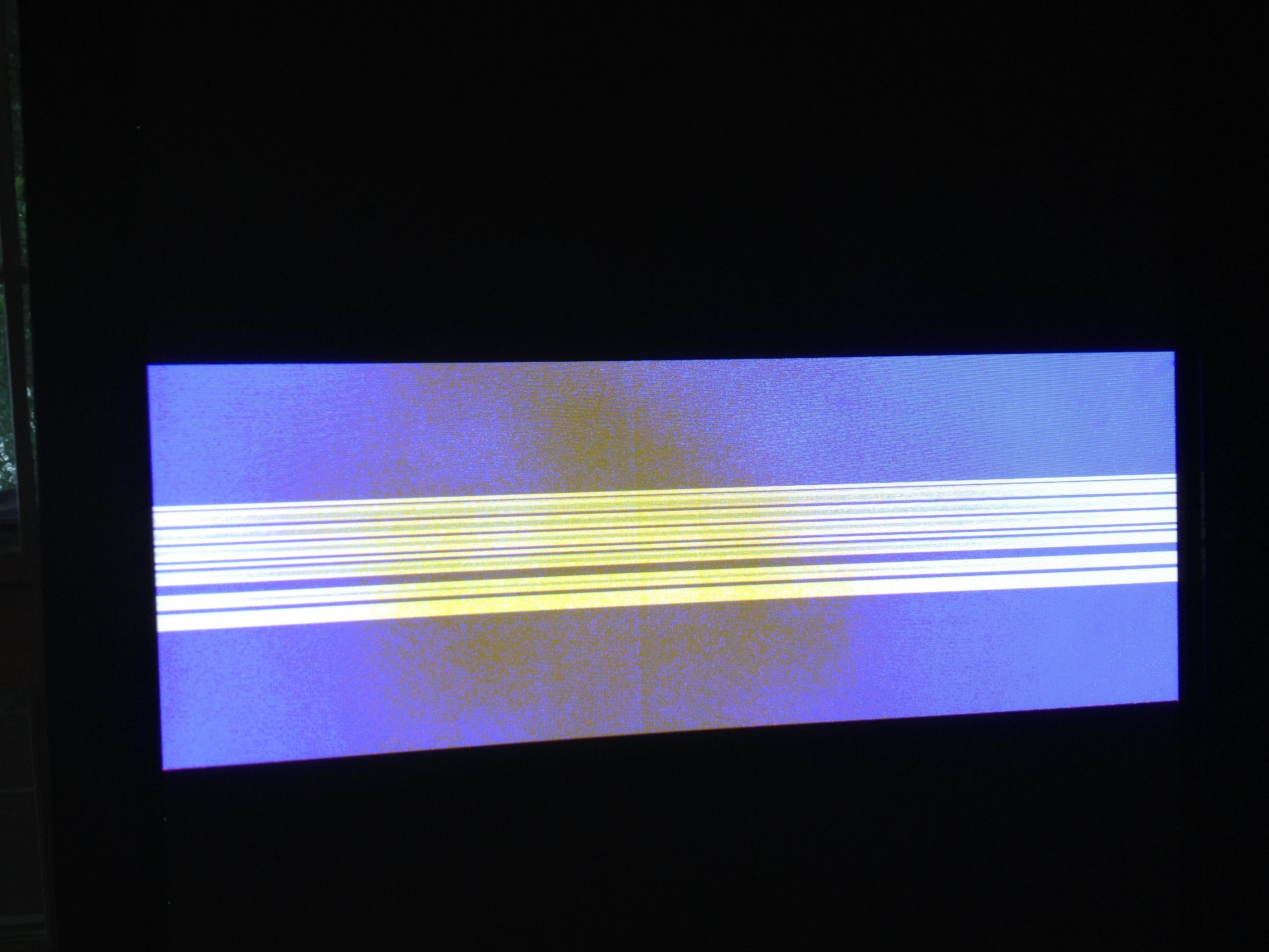

    Hi guys. I'm away from home at sisters and her friend brought over this plasma for me to look at. Posting from my phone so hopefully the pictures attached. I can pull the back off tomorrow if needed. Would like to troubleshoot here so it doesn't have to travel 300 miles back to my house. Anyway, all it shows when powered up are these vertical lines with a little snow around the edge of the screen.
    Thanks in advance for any suggestions.

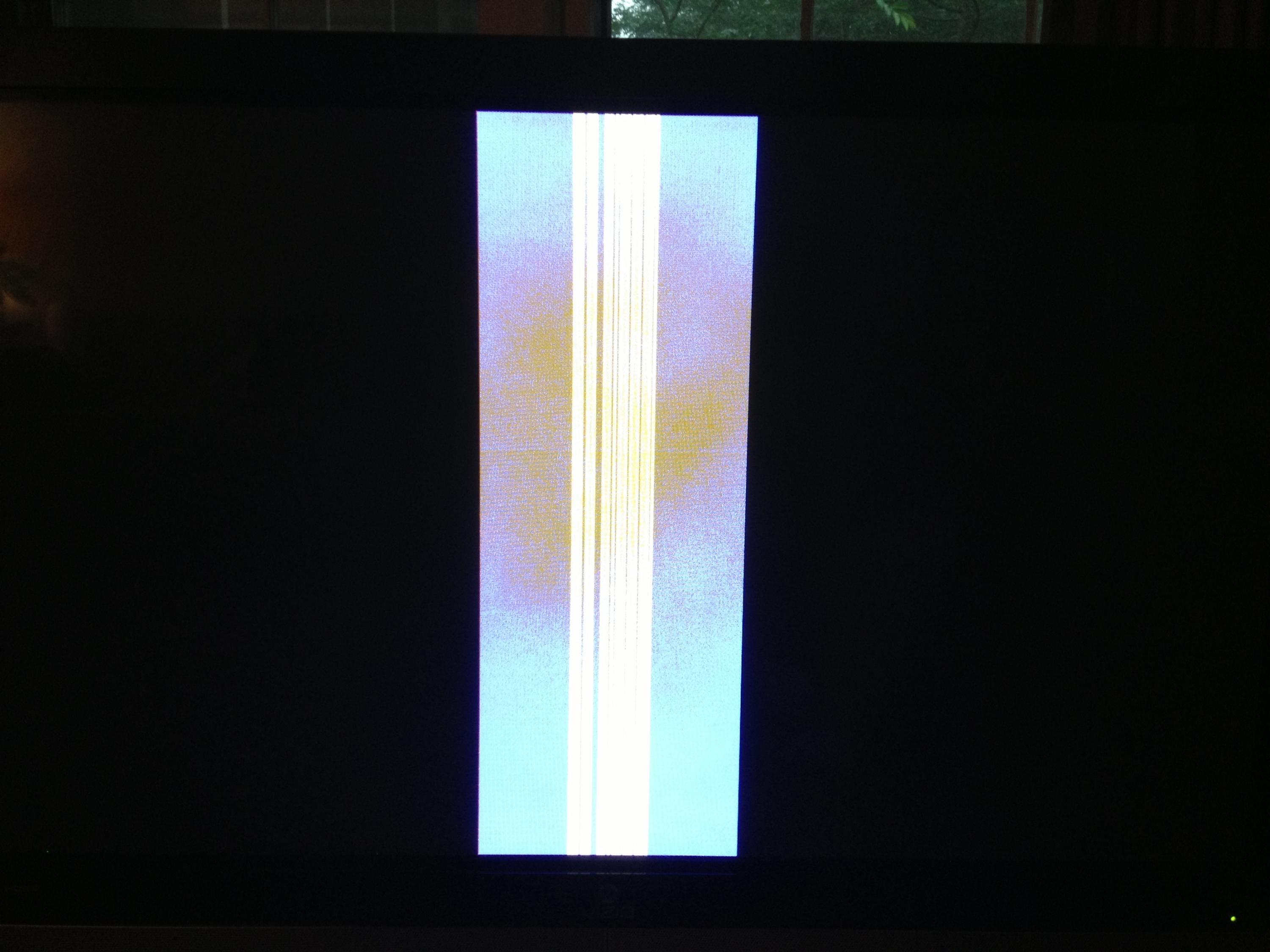

    Re: Vizio P50HDTV10A
    Looks like my phone posted this sideways. It's actually a vertical line
    • aaronwt6
      • Apr 2013
      • 855
      • US
      Looks like I got it that time. Dead center of the screen.
        Buffer board, quite often some FETs go bad (shorted) on them.

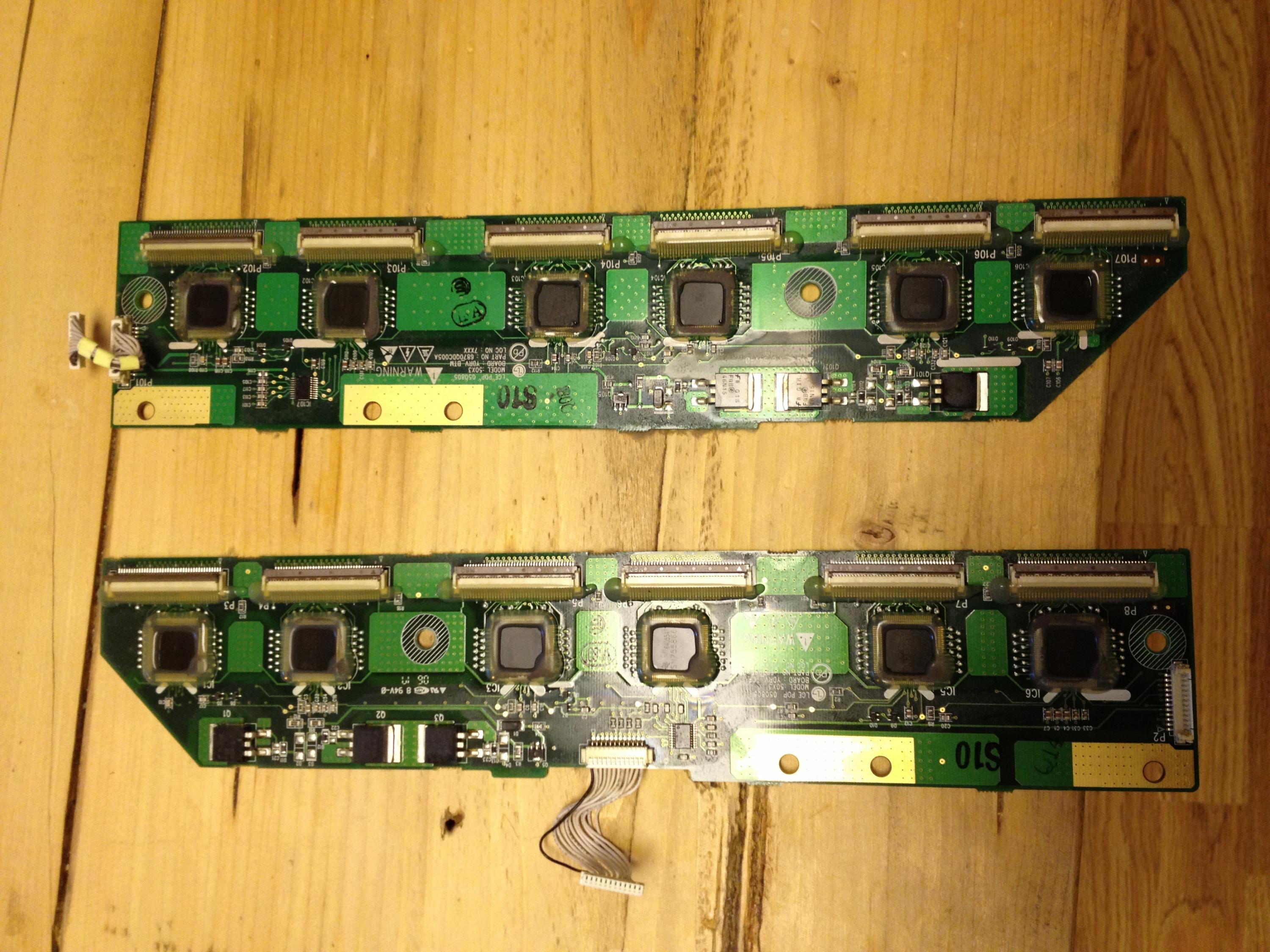

                I'm going to have to call it a night but I see I've got a Y upper, Y lower, XC, XL, and XR buffer boards. They only run $10-$15 each so I just need to be sure I'm getting the right one.
                    If you're going to replace boards you'll need to replace the Y upper and/or Y lower, you can check each for shorts to see which are bad.

                        No obvious damage on these. If you get a chance, please let me know which spots to check for shorts.
                          Test Q1, Q2, Q3 etc on one buffer, Q101, Q102 and Q103 on the other.
                          The X-buffers can't cause this fault.
                            Upper, all three show open. Lower, all three show shorted. Testing between the two connected legs. I guess it's probably just one shorted right? And they are wired in parallel?

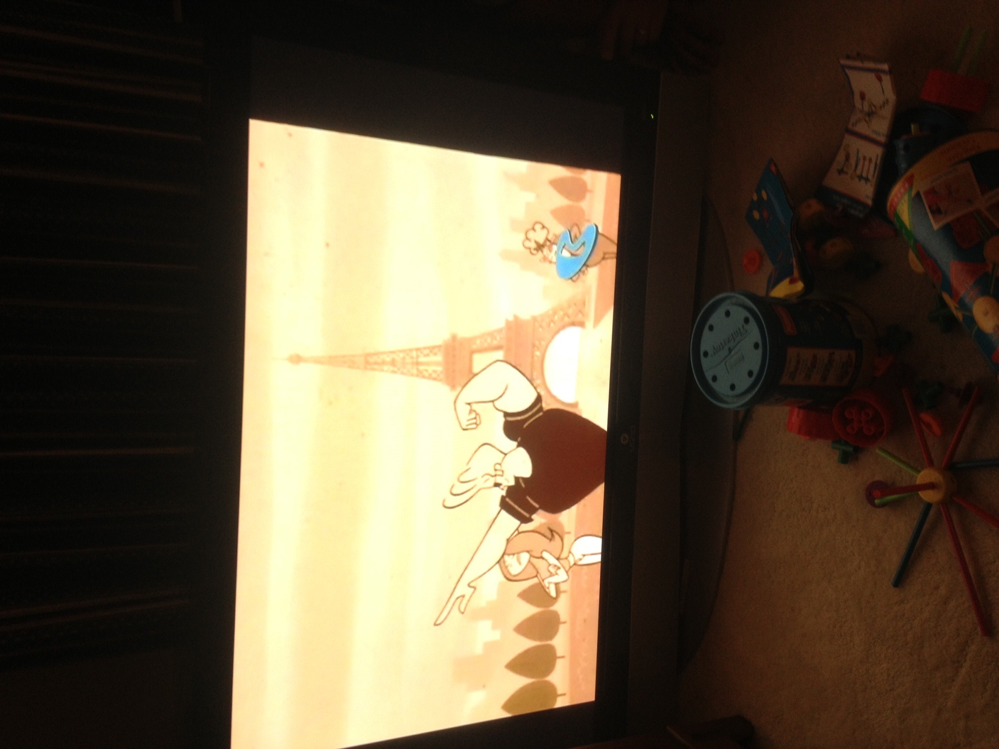

                                      Thanks everyone for the assistance. Installed the new lower Y buffer today and its up and running. Tom, as always with the Plasmas you're the man!
                                      Horrible pic but I was in a hurry after 6 hours of driving and another 2 to go.
                                        Thought that I would also add that it took me about 3 tries of connecting the buffer board ribbon cables to get the picture to look completely right. Had horizontal lines in a few areas. I basically guessed which ribbons corresponded to each area and re-seated them. I know this has been mentioned plenty of times previously but just figured I'd mention it. I knew from reading here what to do when I saw them.
