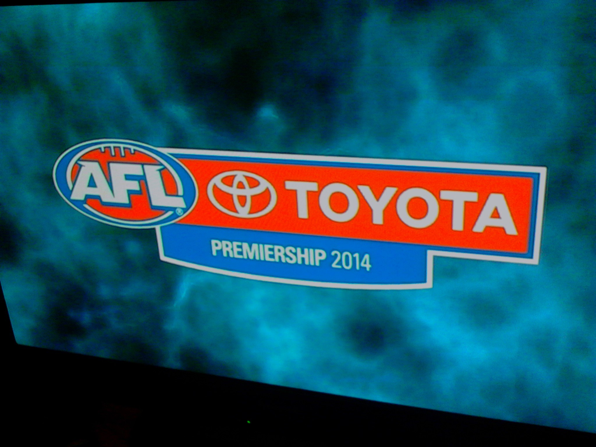

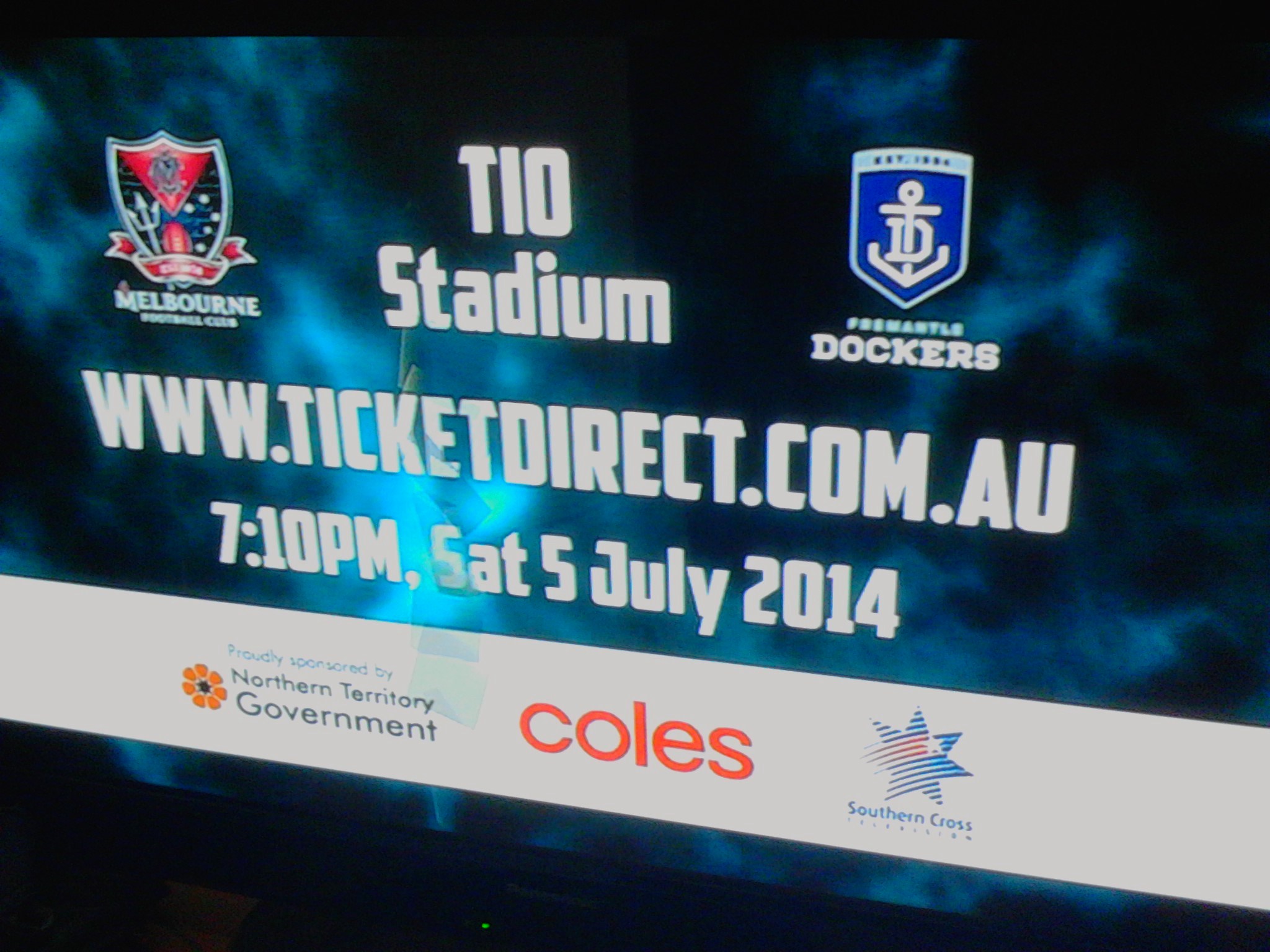

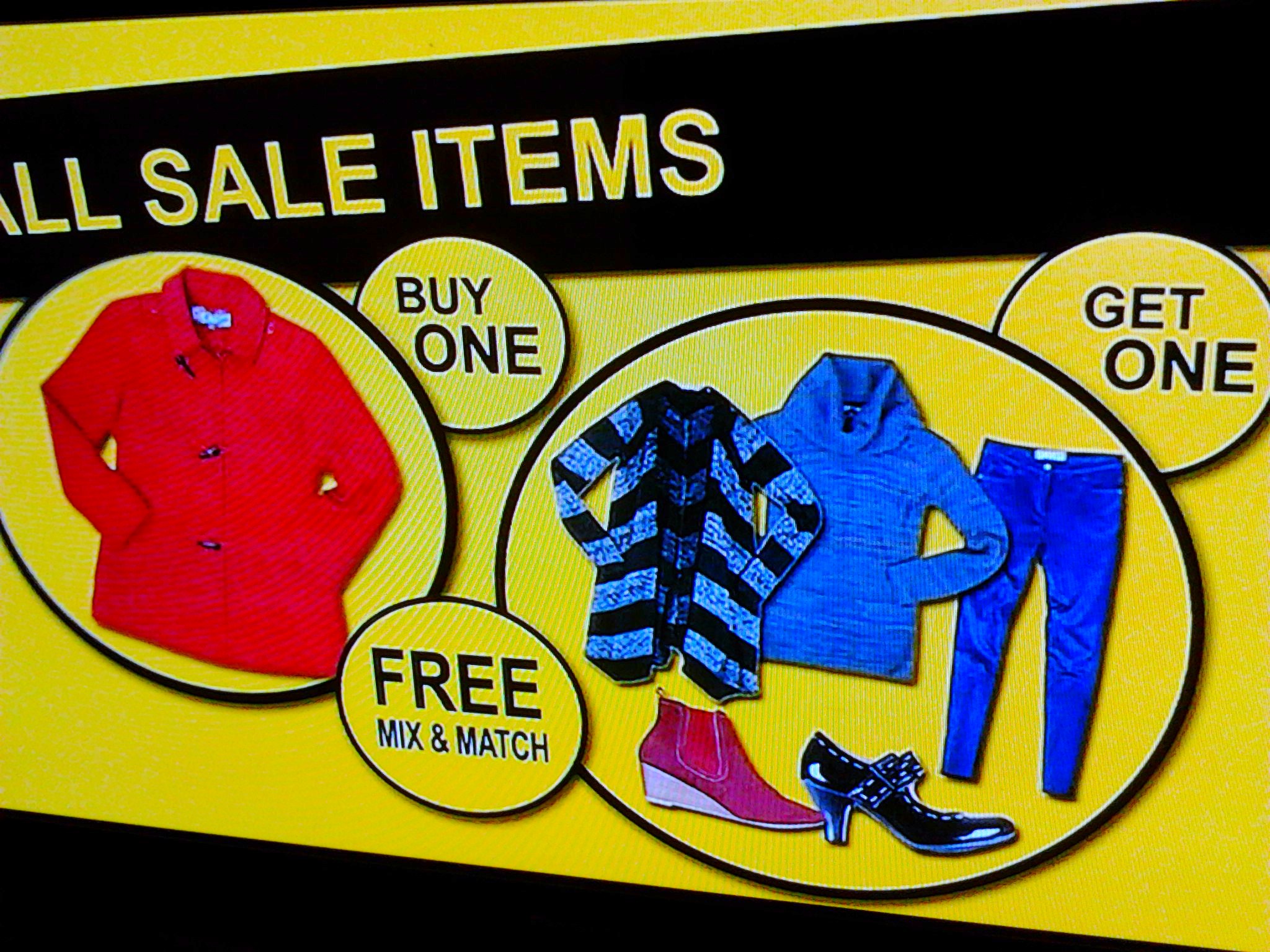

                  Some more video a bit longer and is a good example of the change in display. TV station off for the night with still slides One looks quite normal.
                  http://youtu.be/vDtzIDV1YxI

                        Well, it's been a long time coming but this TV is fixed. Well, provisionally.
                        Quick summary,
                        Started with SOS4 - shorted SS TNPA5072AC, replaced the shorted transistors.
                        This then revealed SOS1 - bad A board - later discovered corrupted FLASH IC9304 (panel addr data)
                        Purchased new Zealand A board and did full eeprom swap, ordered new OEM IC9304
                        This gave me the original Australian version board required.
                        SN had shorted Q451 DG501, used a DG502 I had, that fixed that.
                        had corroded ribbons from the A board, replaced them.
                        Ended up with bad discharge and image issues.
                        had no real idea there.
                        replaced C buffers, no change
                        Disconnected the right C board and picture was improved, appeared panel was not powered enough similar to a failed SS.
                        So got another board (SS) - fixed!
                        So lesson here was using what I thought was a reasonable substitute IGBT, IRG7S313UPBF caused me grief (not proven yet ) RJP30E4 were the originals.
                        TV has 6000+ hrs and with all the abuse it's copped ripping things in and out happy to say perfect picture.
                        $$ too embarassed to say but given the surgery I did on the A board, amazed i pulled that one off.

                          Well done!
                          You know if you had a scope you'd probably see the SS waveform looking poor and that'd save you a ton of time and money on a project like this.

                            Cheers, thanks.
                            yeah I was doing some self analysis and a scope was one thing that crossed my mind. The other was I should have just sourced the right parts. TBH I expected this to be a quick 4 transistor replacement.
                            Good example though if you're stuck for an A board what can be achieved.
                            Also exposed 1 cause for a 1 blink.
