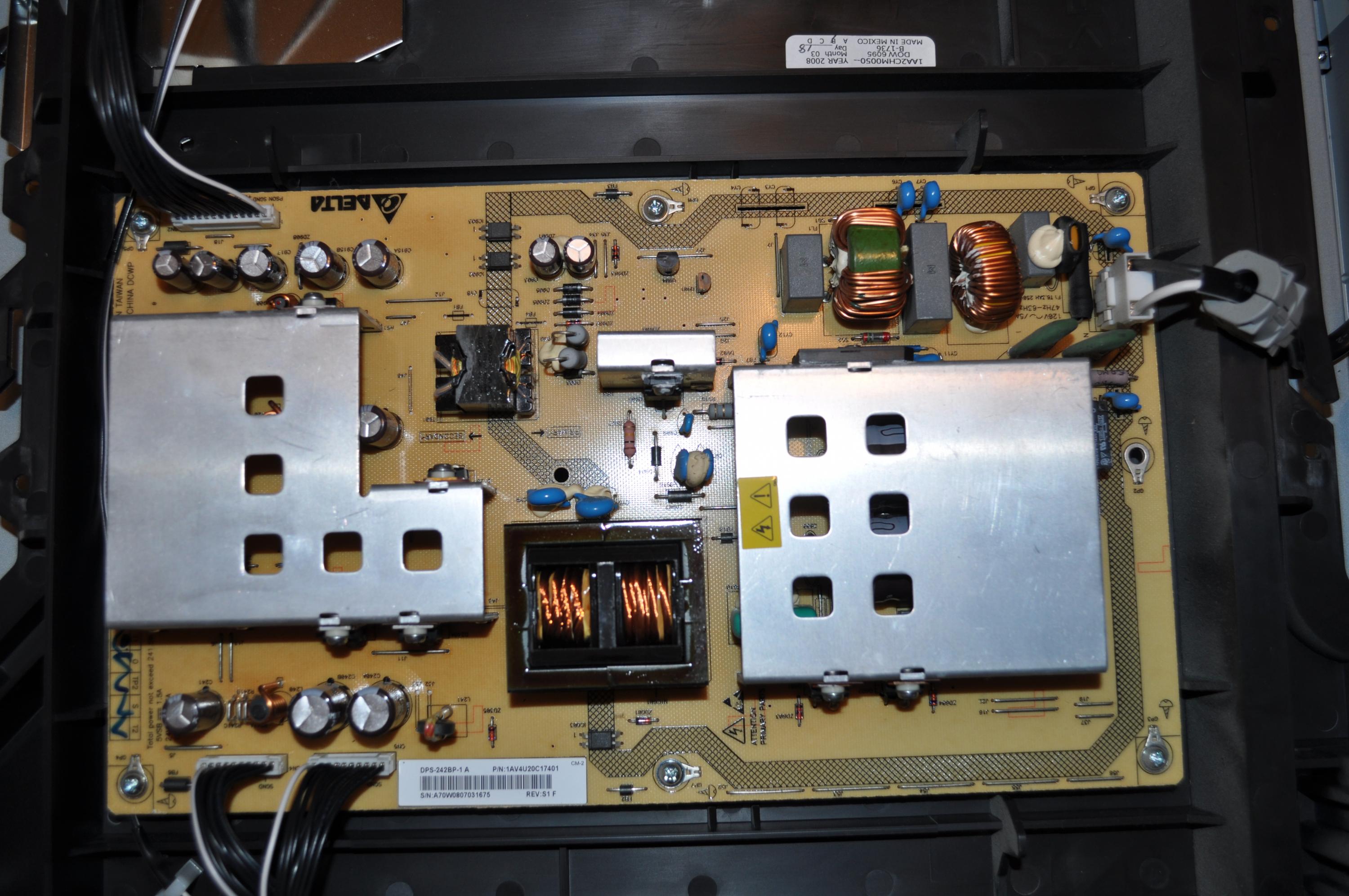

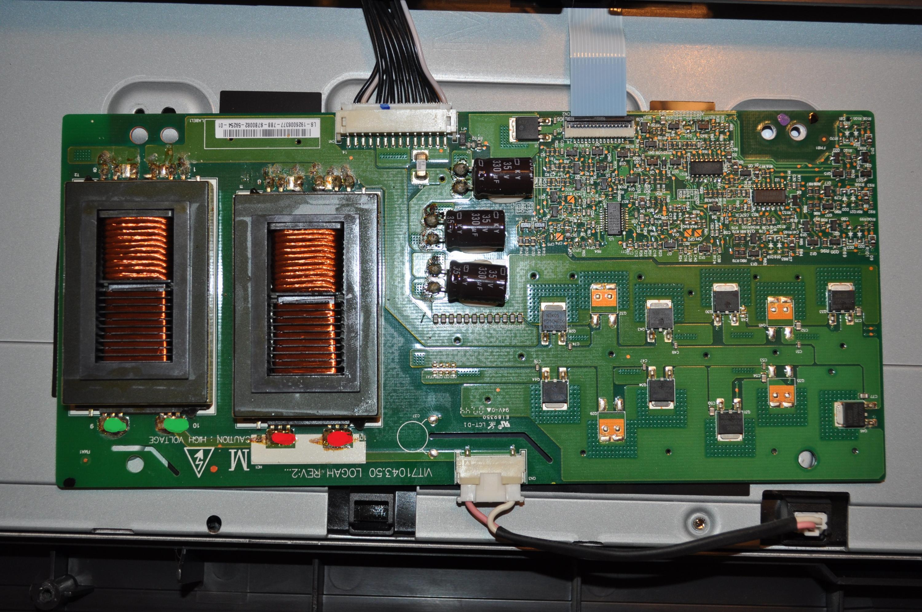

    Picked up another Sanyo DP42848. Set turns on for about 1-2 seconds appears to have backlights on left side of screen (slave side) but not the right side. I suspect a bad master inverter?? I have tested the PS and here is what I have:
    24V 23.89vdc
    SGND 0
    12v 12.09vdc
    SGND 0
    5v 4.99vdc
    SGND 0
    PSON 4.88

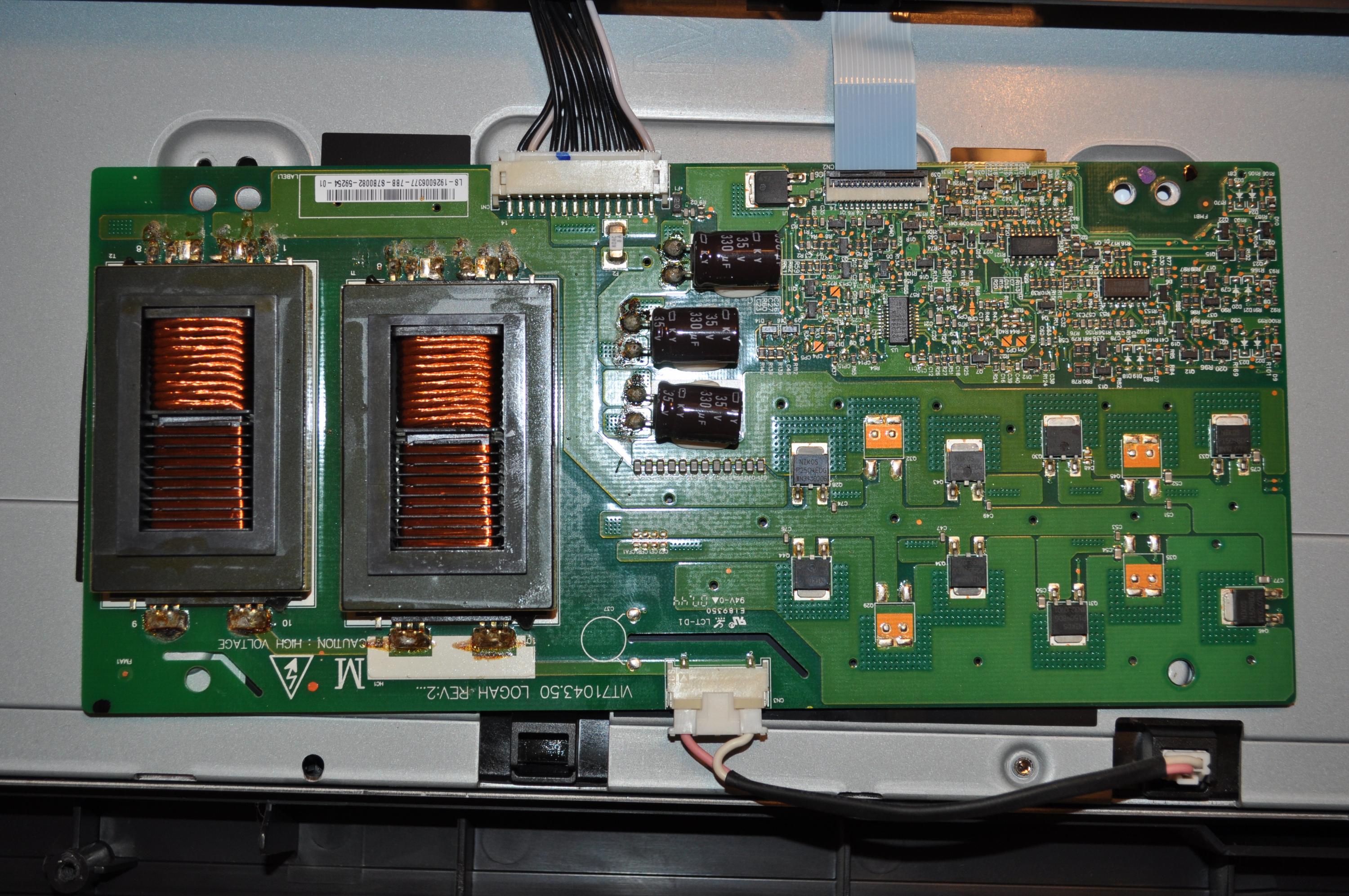

    Pics

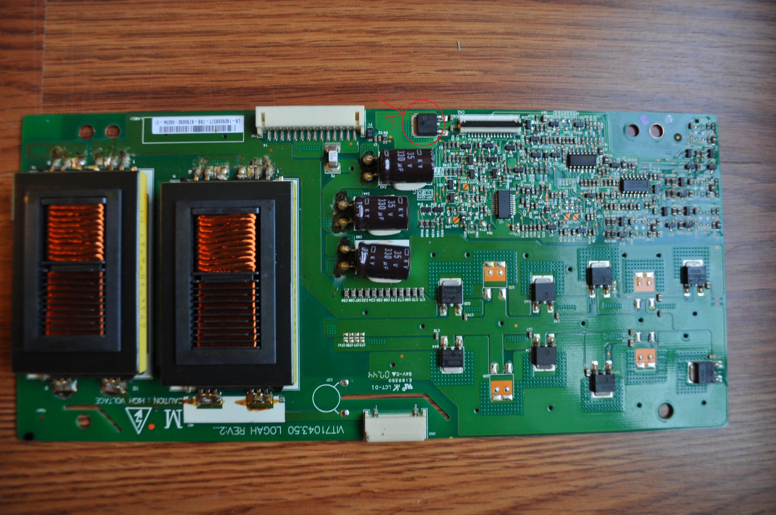

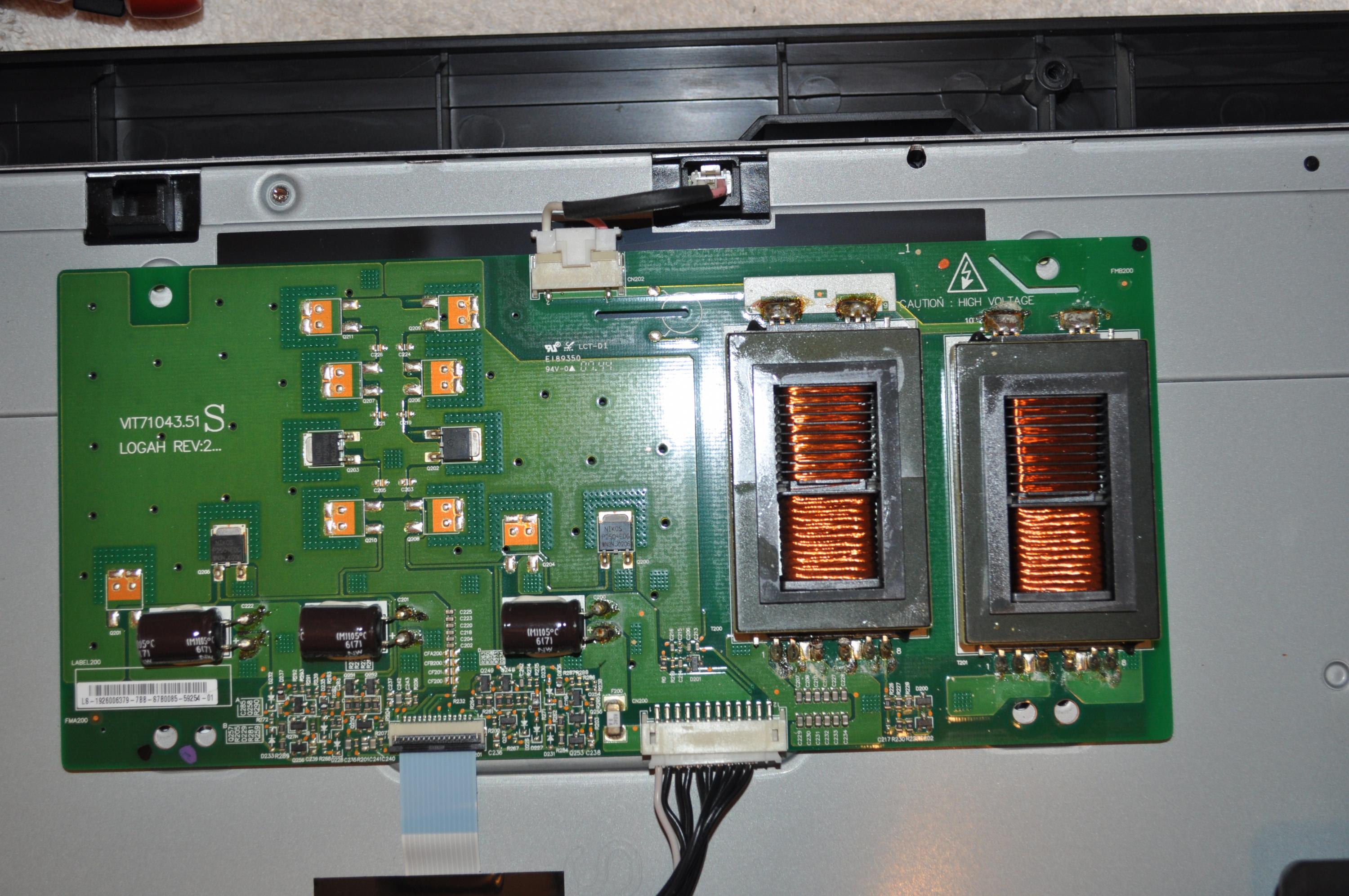

      Ok I am adding one more pic: I have tested red to red to be .2 ohms and Green to green open. Also tested the slave inverters and got the same results.

        Just for my reference. Does the master support a bank of lights on the one side of the panel and the slave the other. Or do both supply the same bank of cffl's? I'm not clear on the function of the master and slave inverters.
          Re: Sanyo DP42848
          Usually they drive opposite ends of the same bulbs. Bad master, no light, bad slave, half panel lit up briefly.

              Ok changed the Slave inverter same issue.
                Re: Sanyo DP42848
                You had light on the slave side. While rare for this to happen if anything it indicates a good slave. I've never seen it happen before, but my first bet would have been on the master, due to no light from that side. On most sets, the reason a bad master will result in no light emitted is because the master controls the slave, but perhaps it's possible to have a partial failure of the master inverter...

                  Since I have the spare slave now do you think changing the inverter coils themselves would be a bad idea? They are they same on both side I can just de-solder and re-solder.

                          I think you have that inverter controller IC (18 pin chip?) which commonly fails. Did you check the fuses & FETs?

                            Here are the Fets...Fuses all good.
                            ( For the sake of time saving all the fets test within a few thousands of each other except one that has a "5" designation on the board.
                            2.539Mohm
                            10.07mohm
                            2.224Mohm
                            "5" tests
                            7.14k
                            10.29k
                            3.148k
                              Re: Sanyo DP42848
                              #5 is the +5V regulator. Check, with set powered, voltage on all three pins, red probe on each pin and black on ground/chassis.

                                Re: Sanyo DP42848
                                23.8
                                0
                                4.915
                                  Re: Sanyo DP42848
                                  Seems OK then.
                                  F2 on master and F200 on slave ... what voltage on each end?

                                    Re: Sanyo DP42848
                                    23.99 all sides. When I powered up set I did hear a slight buzzing form the Master side

                                      Any way to test that IC?
                                        Re: Sanyo DP42848
                                        You can check each of the FETs gate to source for shorts, the IC can make shorts appear if it is bad. But otherwise you really need a scope to check the drive waveforms.
